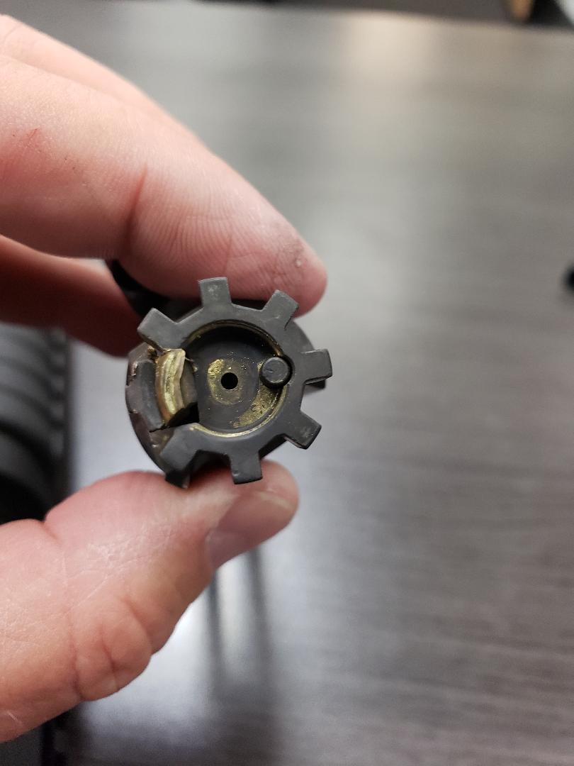

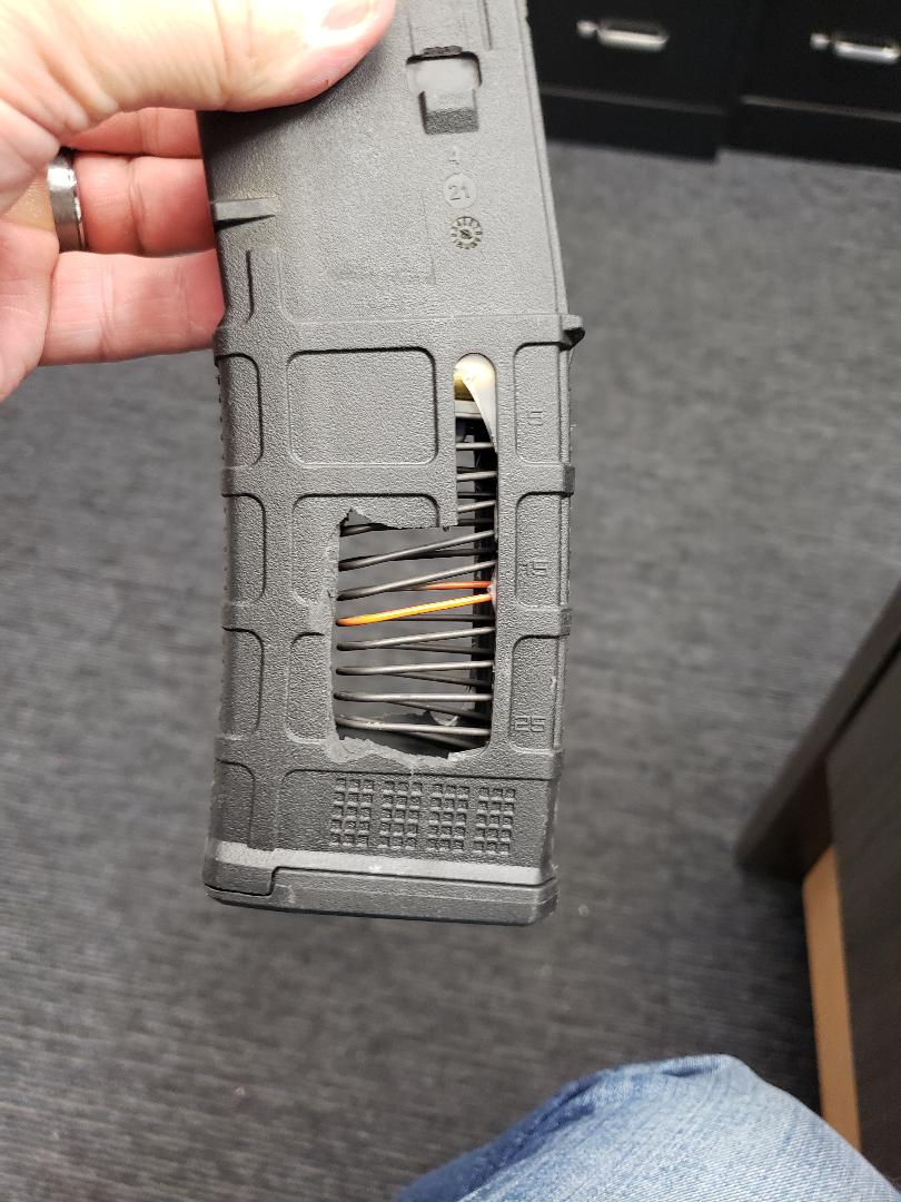

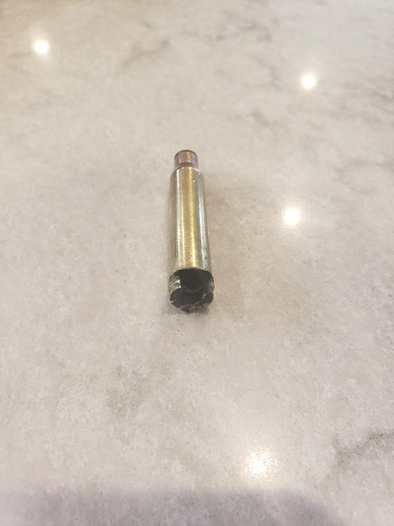

    Hey guys a buddy of mine was out shooting a brand new AR-15 the other day with brand new factory Remington ammo. First 30 round mag was smooth, then bang, bang, and then rifle blows up. The upper was of unknown make, but either 5.56 or .223, and ammo was brand new Remington .223 ammo. They stated all projectiles had left the barrel, so I don't think this was caused by a blockage. Seems to me the case head just gave way. Would love to hear thoughts on this.
    No signifcant injuries, minor cuts on chin and face from p-mag blowing as seen in pics. P-mag still seems functional believe it or not even though its missing some plastic. Upper sustained minor damage, no damage to lower at all. Upper will be thrown out.
    By the way we had to use a punch and a hammer to get the bolt out of the chamber, it was locked up tight. That's why you see some damage to the area with the silver in the above picture.

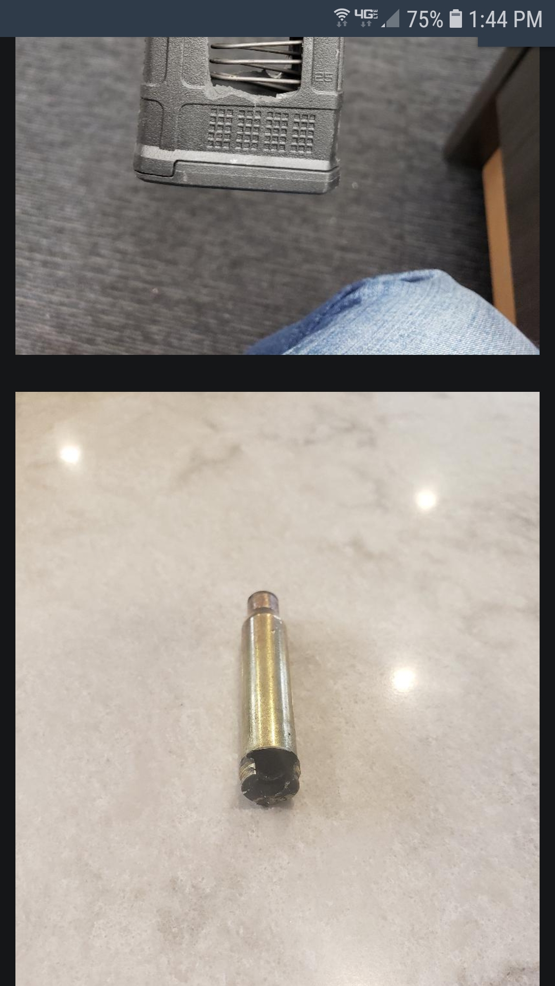

    Extractor too sharp cutting case.
    Heard of something like that occurring in M1/M1A designs.
    Doesn't make sense to me though as case head is usually solid brass, not like you are cutting a balloon.

    Semi-related, funny you should mention balloons. That's how cases used to be made; the brass was "ballooned" into shape instead of having a thick, solid base. Which did lead to extractors ripping them open sometimes. But that technique hasn't been used in a long time, so maybe just a bad lot of weak ammo?
    @79steeler How did the Pmag blow up?
    I've seen many magazine failures, bot rifle and pistol, do that over the years. All the pressure has to go some direction and it is best when it gets channeled down instead of back in the operator's face.
    That's what I thought. Looks like the windows were the weakest points and the pressure popped through them taking the walls with it?

    Look at the flash hole size..... flash hole is way way way oversize. If it was that way when the primer ignited, hello detonation and extreme overpressure.
    All the signs are there for that, and it would not be the first rimingtun round to do that.....

    I just couldn't tell for sure from that picture. I own no rifle ammo in a Remington box for many reasons. The last 12 Gauge shells I got with their head stamp are less than desirable for shooting.
    In creating subsonic rifle ammunition, using pistol powders, one method involves opening the flash hole.
    There is a very implicit warning in the articles describing what happens when full power loads are reloaded in cases that have oversized flash holes.
    Further warns to crush the case mouth with pliers to keep the cases from ever being potentially reloaded full bore again.
    That flash hole is visibly oversized, and there is no way to disprove it happening when the fragment blew out or that being the cause of the overpressure, but
    Oversize flash hole gets my vote. jmhe

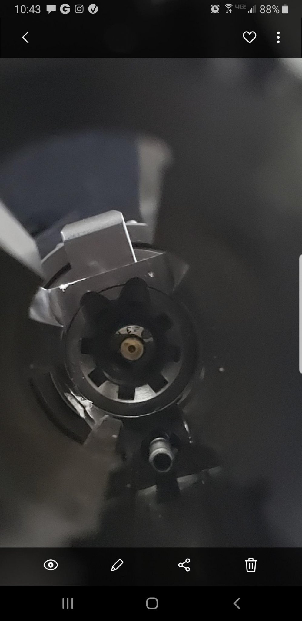

    It would be interesting to see a borescope view of the bore.
    All projectiles are probably clear now. If a squib was forced out or a neck was left behind there should be 'Marks'

    After the mishap the bolt was still locked, case was still in the chamber (most of it anyway).
    Bolt did it's job.
    Gas blew small parts up.

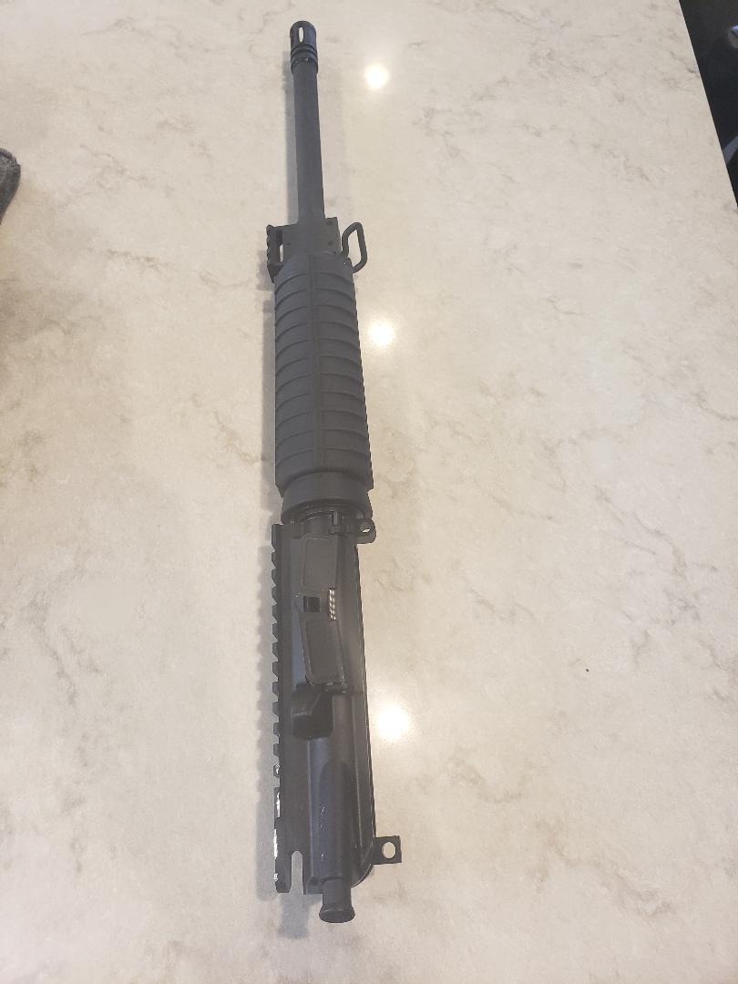

    I just noticed the dust cover.
    That bend probably indicates the amount that the upper and possibly the lower blew out during the malfunction. It's way too much, so far I wouldn't shoot that upper for fear of metal fatigue even if everything else checked out ok. The lower isn't as stressed as an AR upper but if I had a spare lower, if would swap parts and retire it too. Maybe use a "gun buy back" to get some money out of it.

    grab a cheap dust cover and bend it out.
    Did the upper bend?
    My guess is the dust cover was open when it happened.
    It ain't now.
    I think you are forgetting the pin, that makes it much harder to bend.
    If you look at the dust cover and imagine it in the open position, it got pushed out hard. There wouldn't be enough gas coming out between the upper and lower to do that, the upper moved A LOT. The lower probably moved too.
    If it wasn't the malfunction that bent it, someone probably intentionally bent it which makes no sense.

    With the bolt remaining locked, case in the chamber AFTER the boom,
    case measurements should still indicate a good fit to the chamber.
    Take an AR, drop the bolt, look at where the gas would go.
    This case let loose just in front of the dust cover.
    The Upper did not bend out that far.

    The case head failed, the bolt was in battery.
    Possibilities:
    1)Bad ammo, overcharged, undercharged or defective case head.
    2)Bad barrel, not enough case head support, chamber bevel machined to deep.
