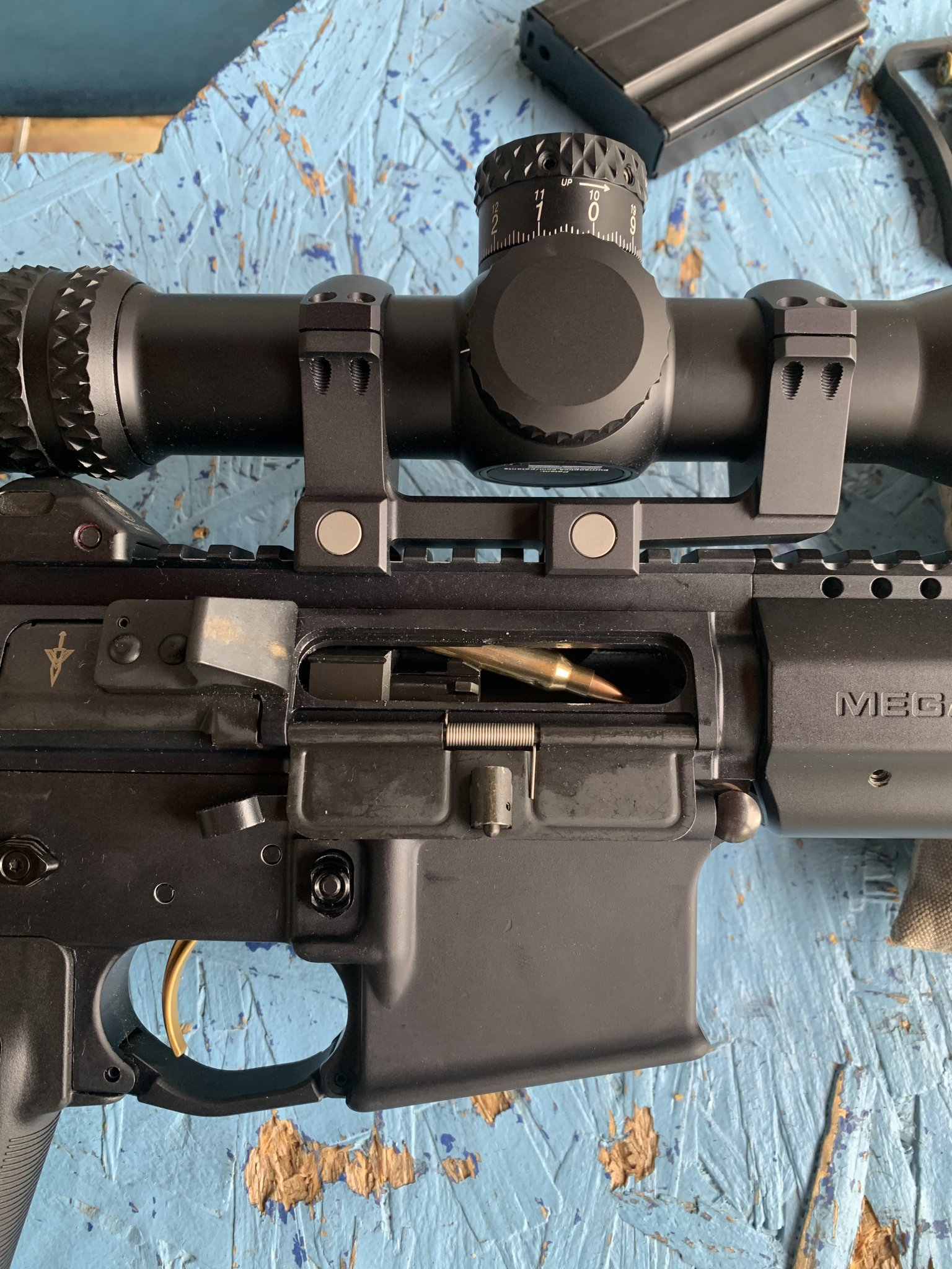

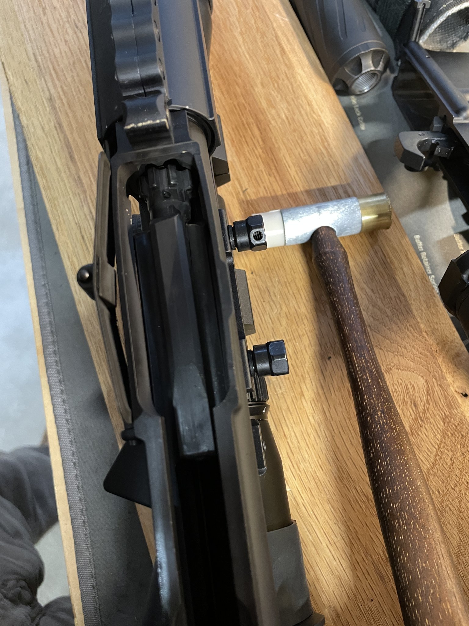

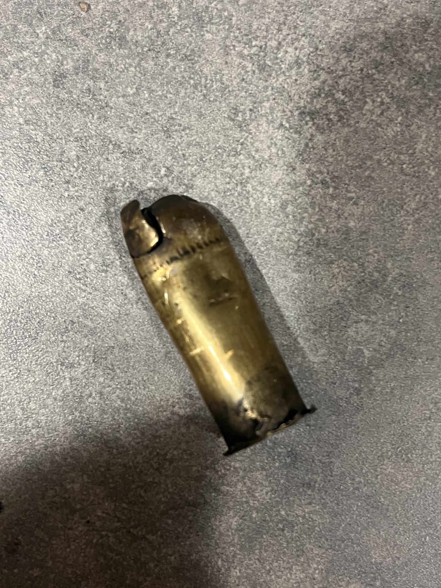

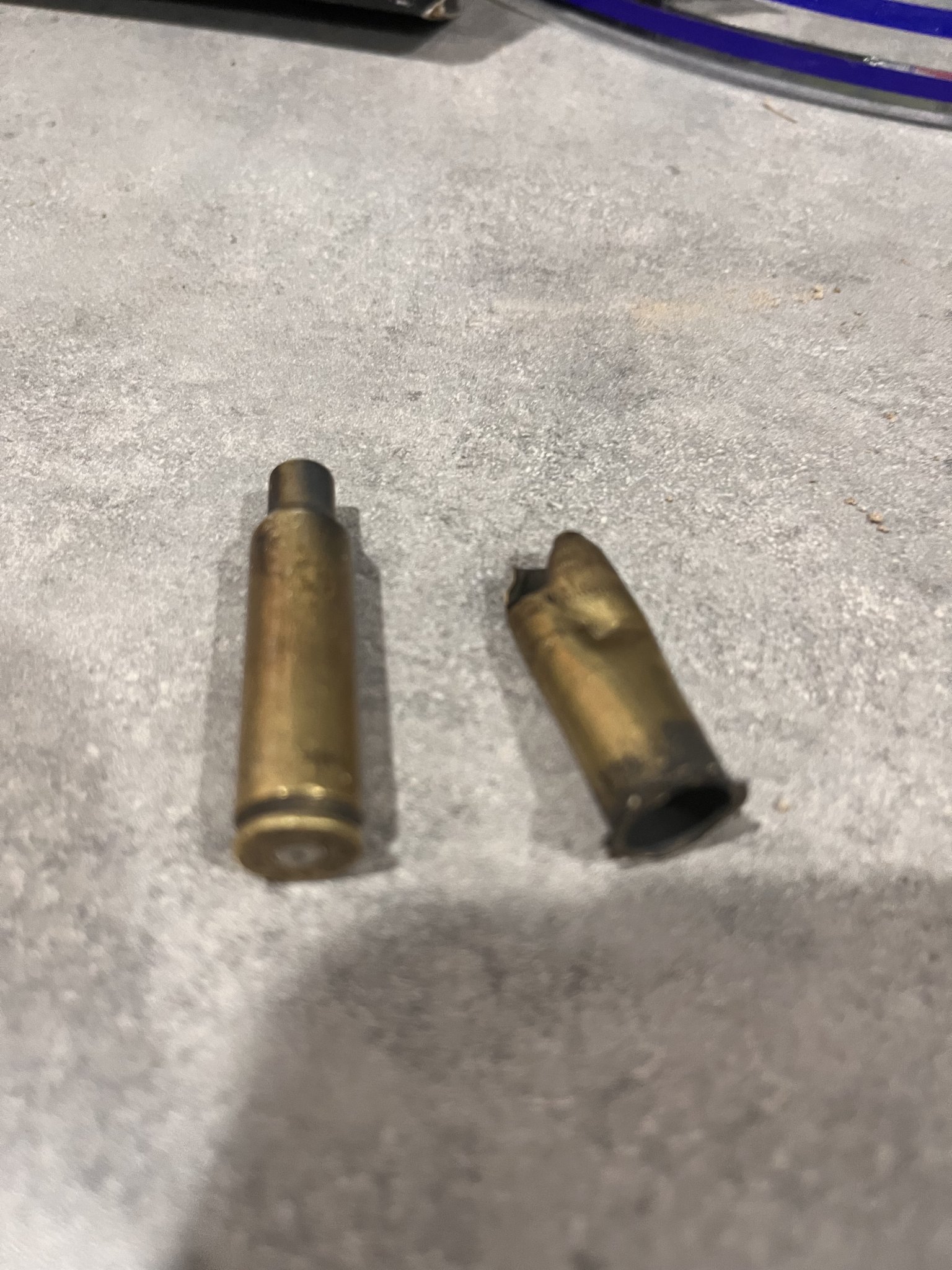

This is absolutely fricken crazy! This just happened to me last night on a thermal coyote hunt, and until I started searching and found this thread, I had no clue what an OOB Discharge was.
Here is the scenario in short........ This is a 6 X 6.8 custom chamber AR 15.
I had a coyote coming in and it hung up. I squeezed the trigger and click. This makes sense as I realized I hadn’t racked a round since getting out of the truck. So, I rack one in (remember it’s pitch black darkness) without any oddities with the chambering. I squeeze the trigger and distinctly heard 2 rounds go off. The first was a normal suppressed sounding round but milliseconds later a very loud boom! My mag was destroyed. After inspecting, I found the first (normal) brass from the first round in my brass catcher and it looked normal. The blown up round was found on the ground.
I lost sleep wondering what I did wrong and how it could have physically happened in the first place.
Here is my theory: I chambered a normal round which went off normally. The bolt extracted that case and dumped it in my brass catcher, the bolt picked up a cockeyed round that was not in a normal position and somehow blew it up. The round that blew up is pinched and almost flattened……see pics
The barrlel/chamber looks fine, but the upper is smoked and the bolt is jammed hard in the carrier. So new reciever and BCG was done today. I'll test fire tomorrow....hopefully without flinching bad :cool:
I need to figure out what happened so I can try to do every thing to prevent it from ever happening again.
Here is the scenario in short:
So it fired & ejected a 223, next round went boom.
Are you 100% certain a 300 BO round didn't accidentally get loaded in the mag.
Barrel clear???
In that case are you 100% certain a regular 6.8 round didn't find it's way in your mag?
Only other thing I can think of would be if you used SSA brass & the neck just let go causing an over pressure.
Good questions, but the first round went off normal, and the second round blew up before getting to the chamber (I think) based on the flattening of the brass. But then again, the bullet had to have found it's way down the barrel or through the mag???
Also, it couldn't have been a regular 6.8 as the neck needed to be sized down for the bullet.
Yeah good point. A 300BO will chamber in 223 because it's so much shorter. 6.8 in a 6 x 6.8 not so much.

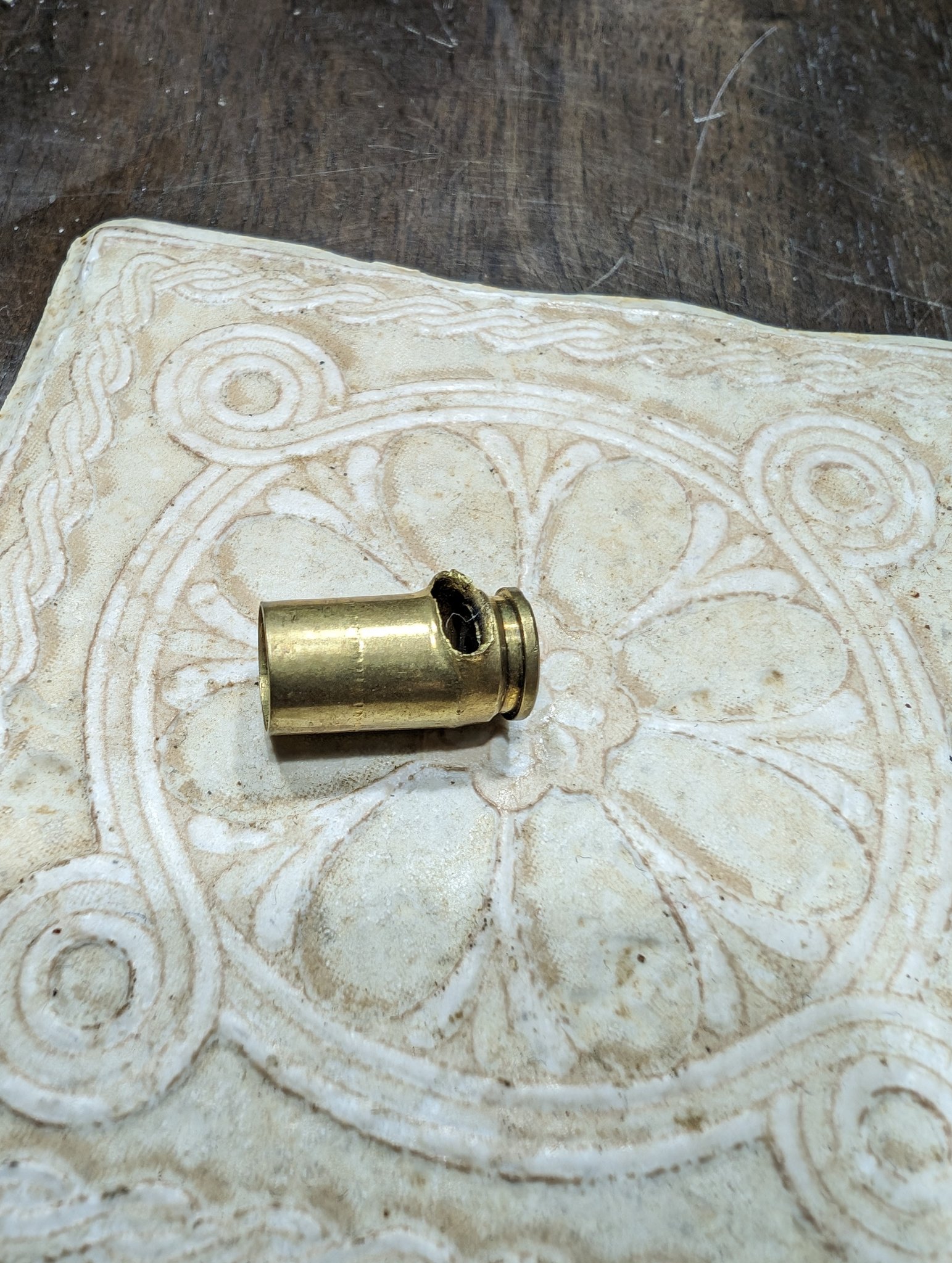

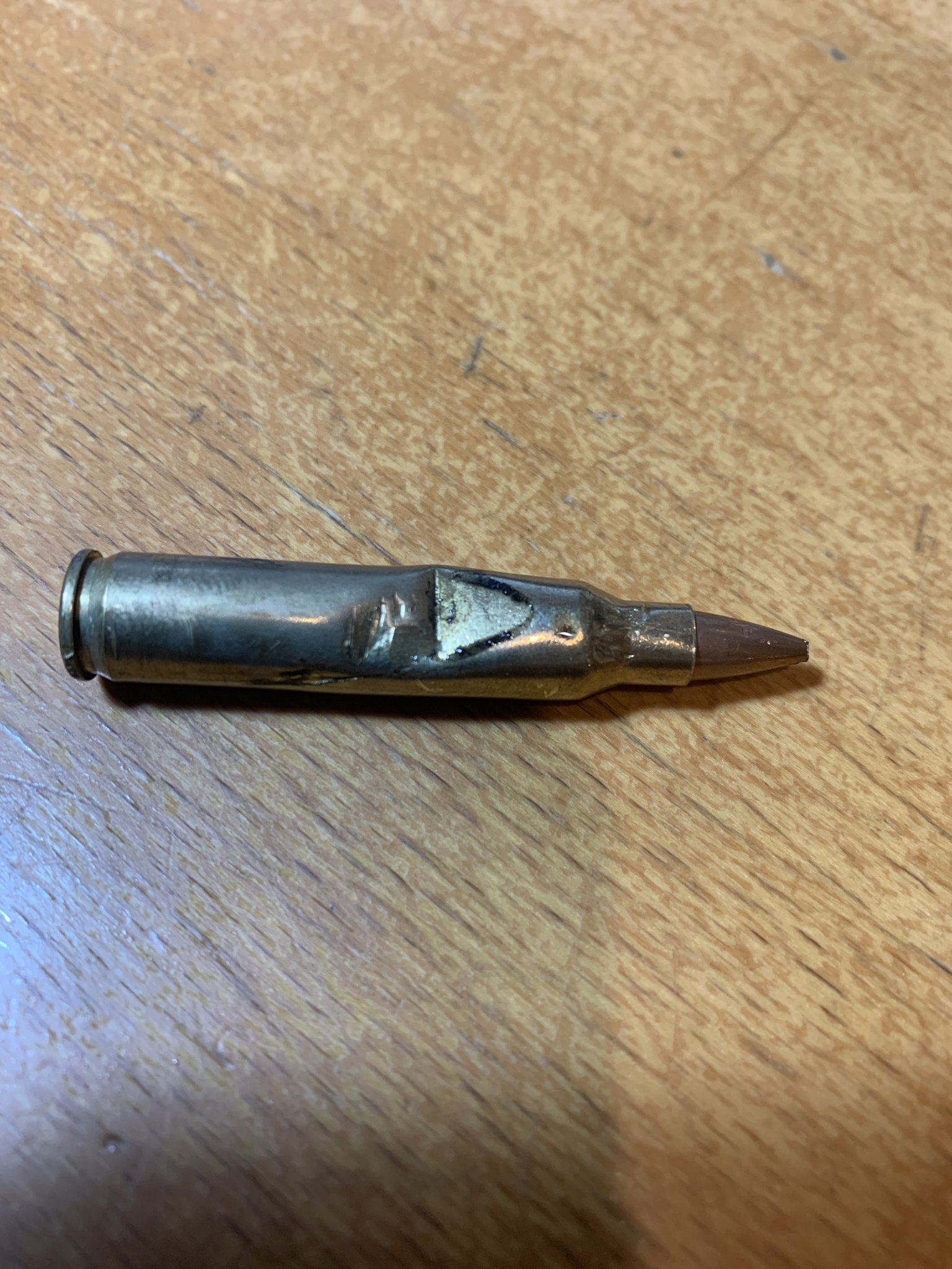

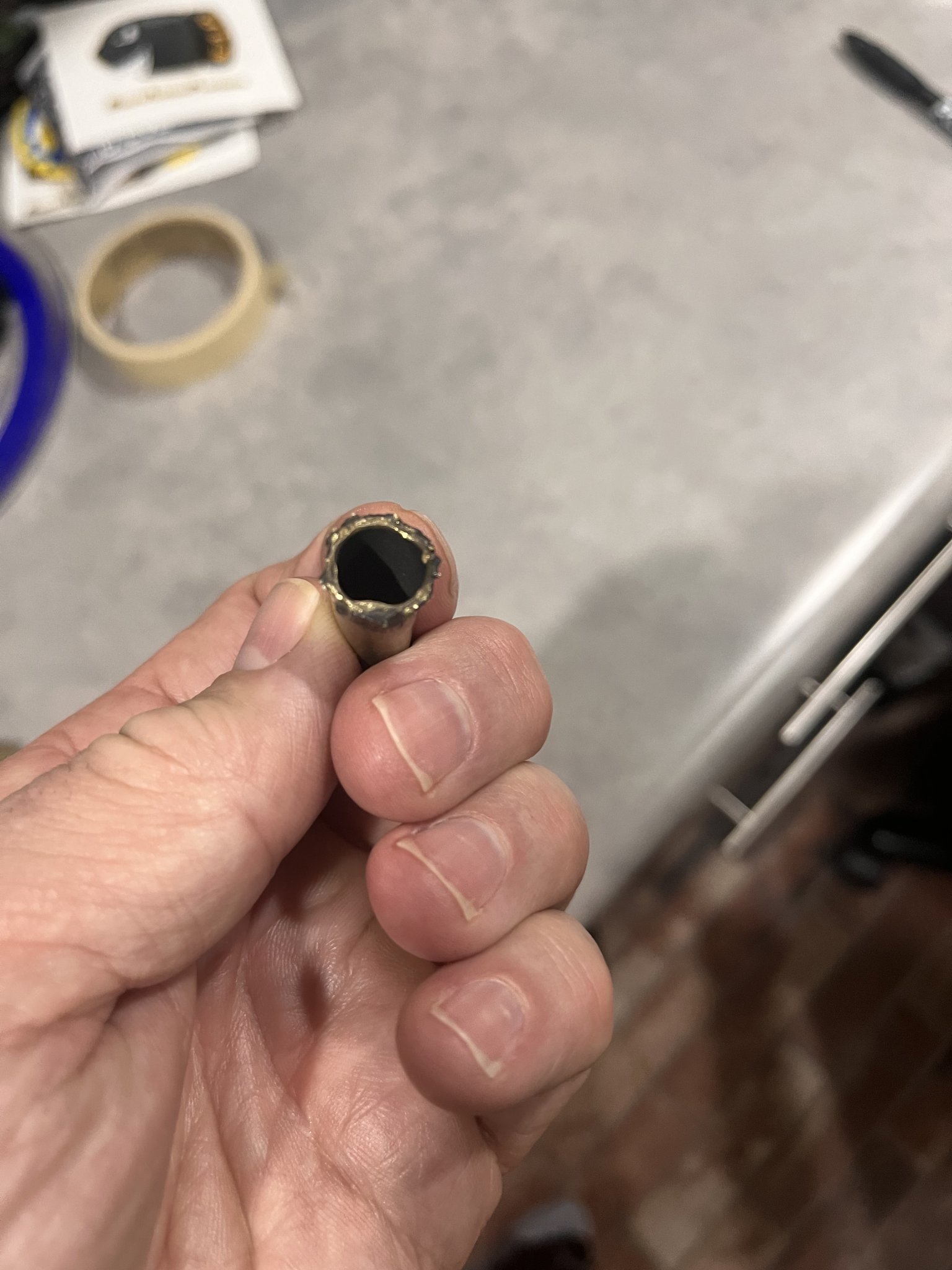

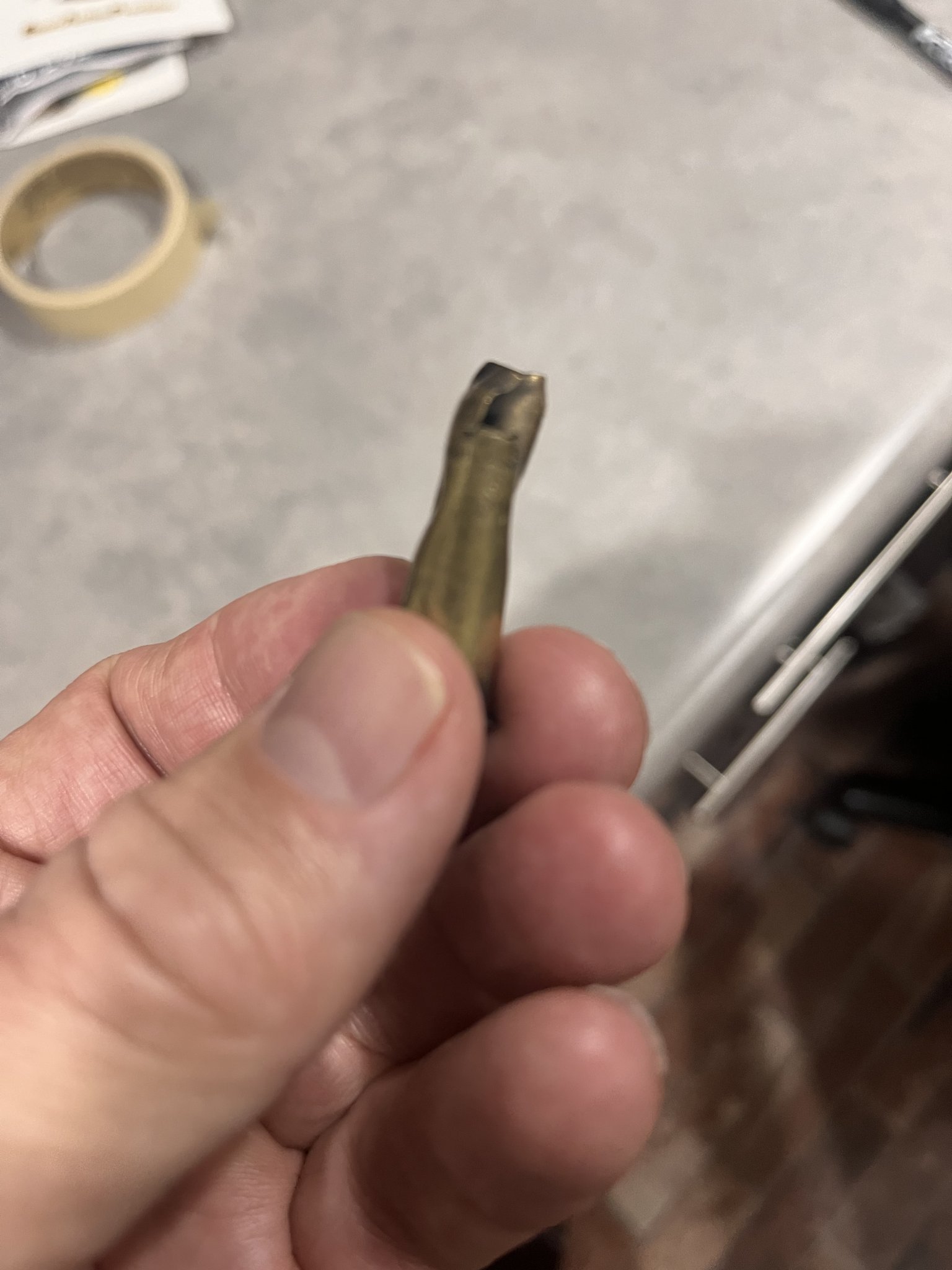

Pictures are pretty grainy, but it looks like the case was in the chamber by the way the back end is rolled open.
I'm leaning towards the neck letting go (cracking cicumferencialy) & trying to follow the bullet. This would result in a big pressure spike and some of that pressure would blow back down the outside of the case. That would be the only way I can figure the case carcass ejected. There was no rim.

Here are a few more pics...
Maybe a common denominator is self-assembled AR's in Wild Cat calibers....who knows, but this event has really got me questioning the AR platform.

Just let go of the out of battery idea. If the cam pin didn't shear it's not possible for the firing pin to reach the primer till the bolt is locked. The AR is actually a very sound design in that regard.
The odds are super duper slim, but not impossible that you had a weird cockeyed jam that somehow set it off. I would expect the blown case to look different than yours though if it was completely out of battery.
Something like a bolt over ride, but damn the odds are slim with a fatter bolt & case. Those bolt overs or should I say under are nasty. Luckily mine didn't go boom. 223 barely fit up there & I had a hell of a time getting it out.
The neck is completely missing on your case that went boom, IMO that's a pretty good clue.
Take a good look in your chamber to see if any of the missing neck is still in there.
Is your cam pin broken? If not it didn't fire out of battery. At least not via the firing pin.
Hell I seriously doubt doubt even a broken cam pin would enable OOB firing pin strike. The top half of the cam pin would need to be completely dislodged before I'd entertain it. The cam pins usually shear at the firing pin bore & cant come completely out due to close fit to upper. The firing pin in that case will not let the cam pin turn. It would bind the firing pin up, but the cam pin will be forced to follow the cam path.

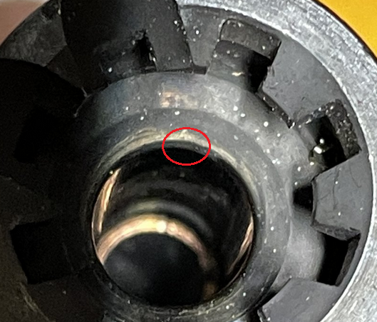

The chamber looks really good a clean. Thinking about it more, the bullet had to have made it down the barrel. The upper has a gouge in the top but I think that was from all the brass and other shrapnel not the bullet.

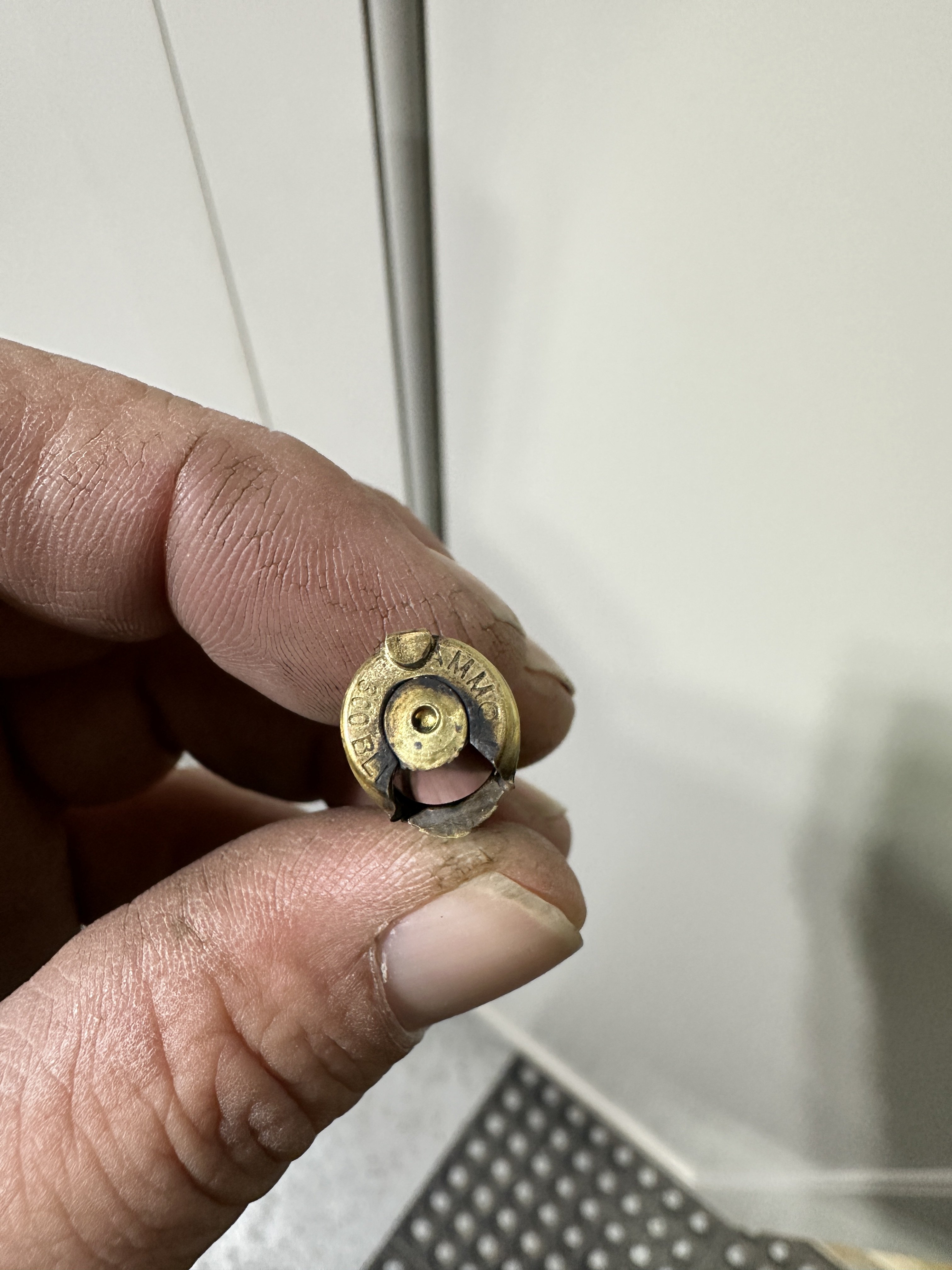

Was the case head stuck in the bolt? Any damage to the bolt lugs or extracter?
Without being able to put eyes on it my best guess is still that the brass separated at the neck to shoulder junction. The results fit that theory better than anything else I can think of.

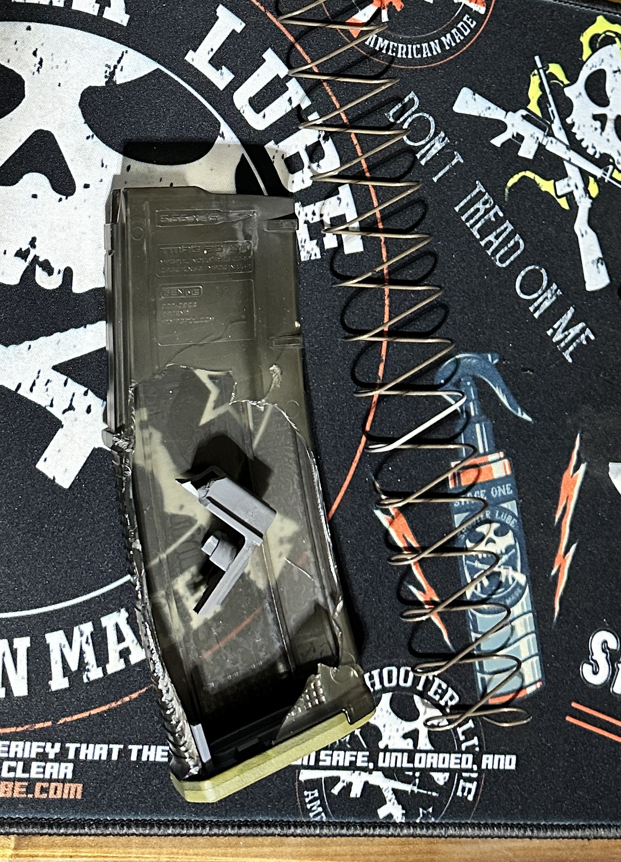

I had a coyote coming in and it hung up. I squeezed the trigger and click. This makes sense as I realized I hadn’t racked a round since getting out of the truck. So, I rack one in (remember it’s pitch black darkness) After inspecting, I found the first (normal) brass from the first round in my brass catcher and it looked normal.

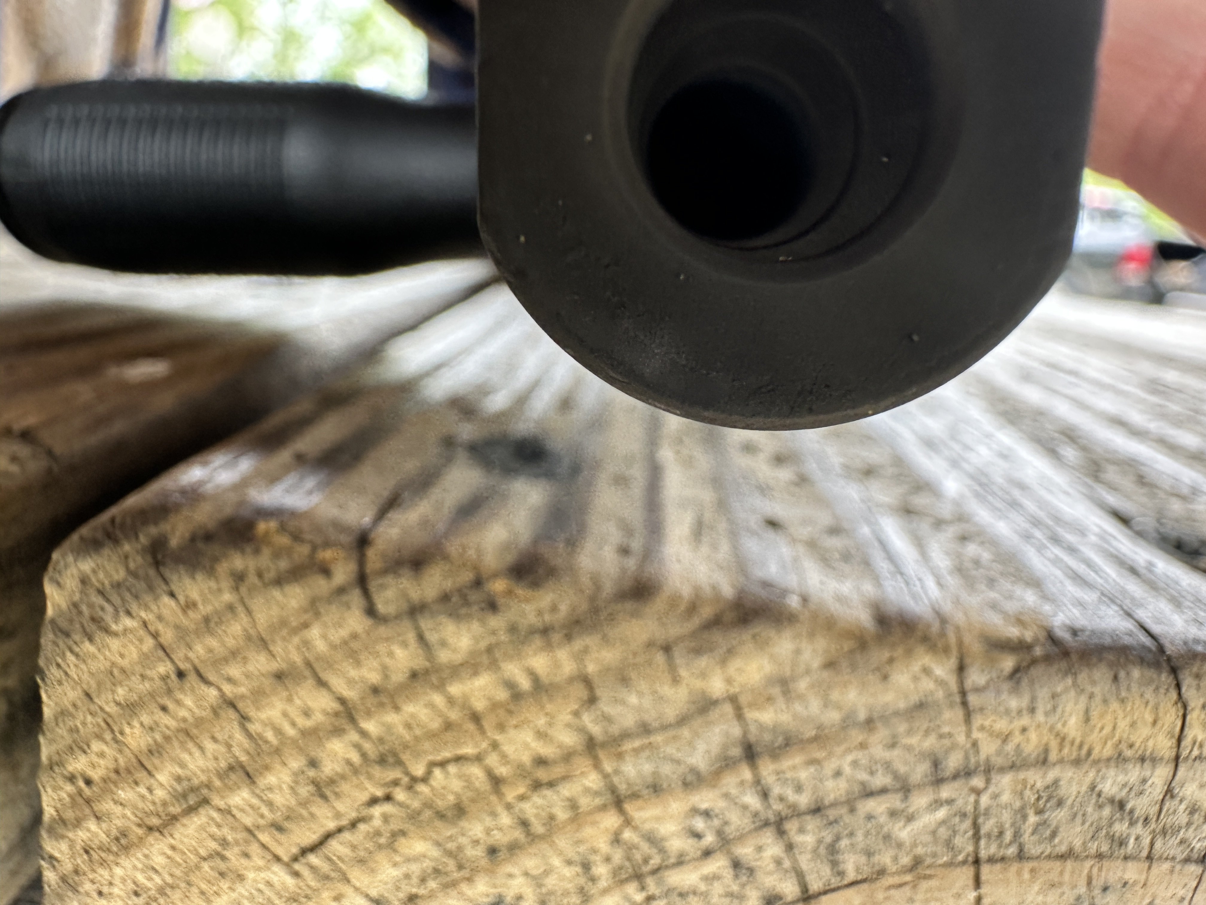

The first round was a squib with only a primer to propel the bullet far enough into the barrel to chamber another round. CLICK!!! YOU rack one in, which EJECTS the spent squib case into brass catcher. Squib bullet comes out suppressor, 2nd goes kaboom. Did that bullet exit barrel too?
Your rifle was exploding by the time the first bullet came out. I'm betting you only thought you didn't have a loaded chamber when it went click.

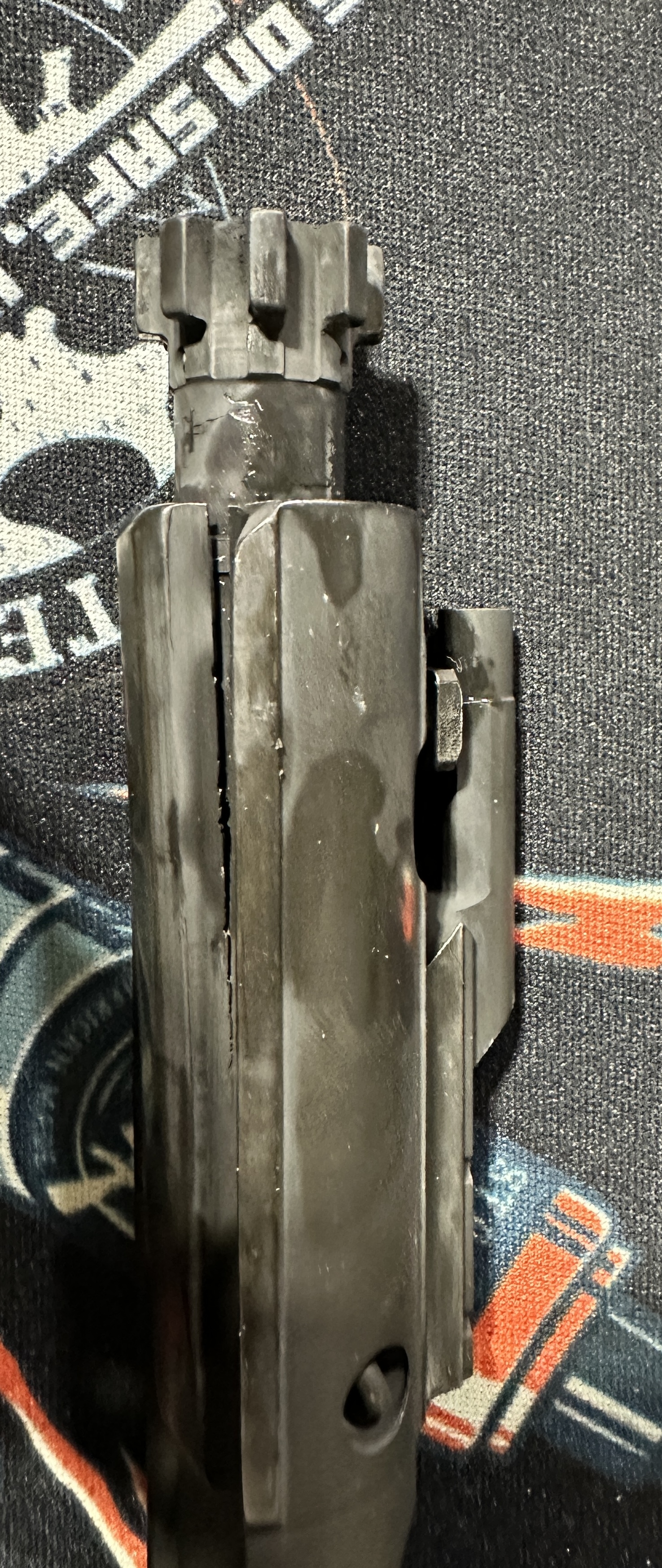

With the damage to the carrier like that I'm leaning toward a barrel obstruction.
And it wouldn't necessarily have to be a second round to do it either. If the bullet didn't make it past the gas port and the bolt didn't unlock then all that gas is now trapped.
But I'd also suspect in that case for the lugs to be sheared. It almost looks like the bolt couldn't unlock, lugs held and the pressure escaped through the firing pin hole? But that's a lot of pressure.
To have the carrier ripped open like that with intact lugs is a bit of a head scratcher really.

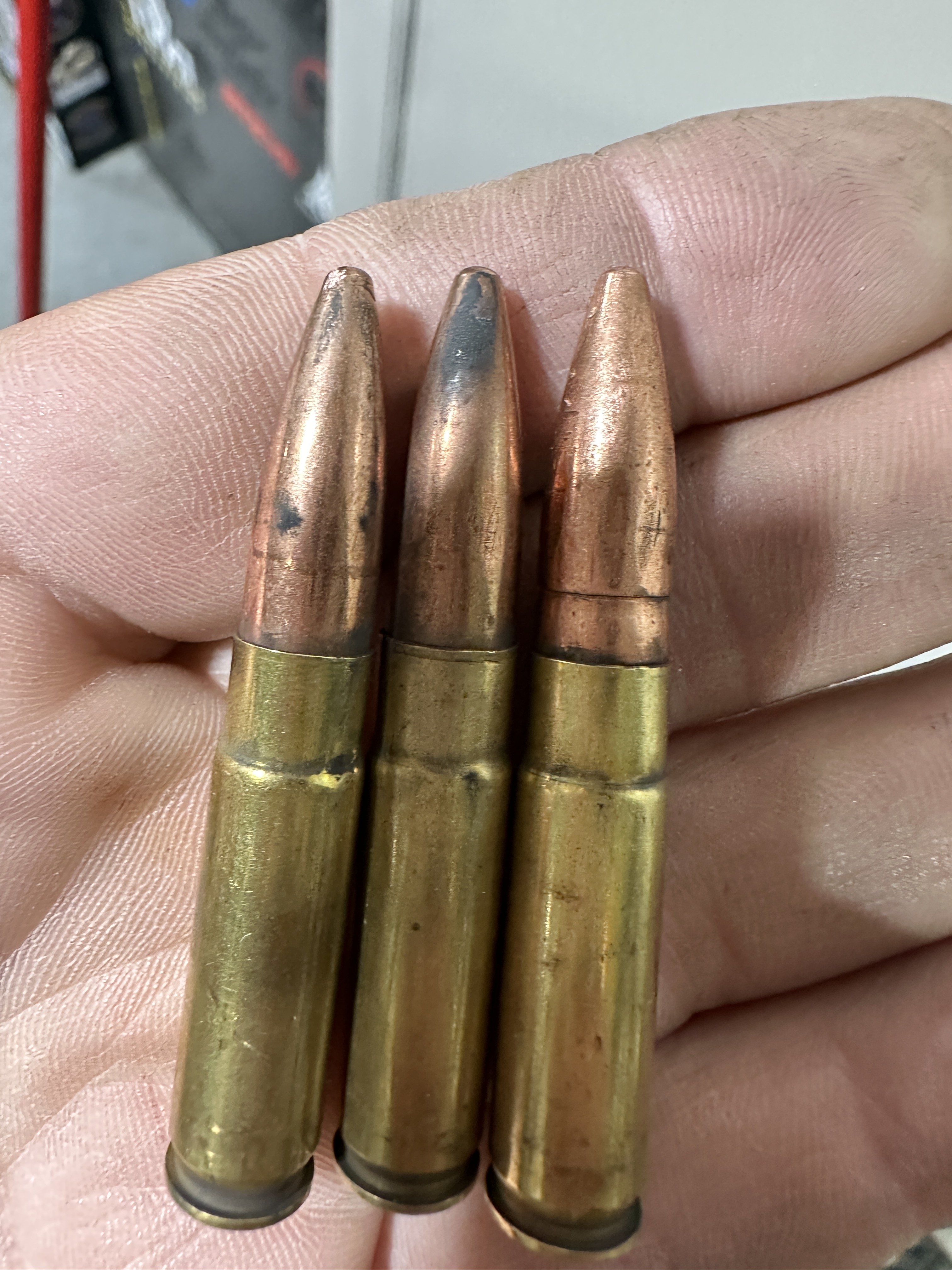

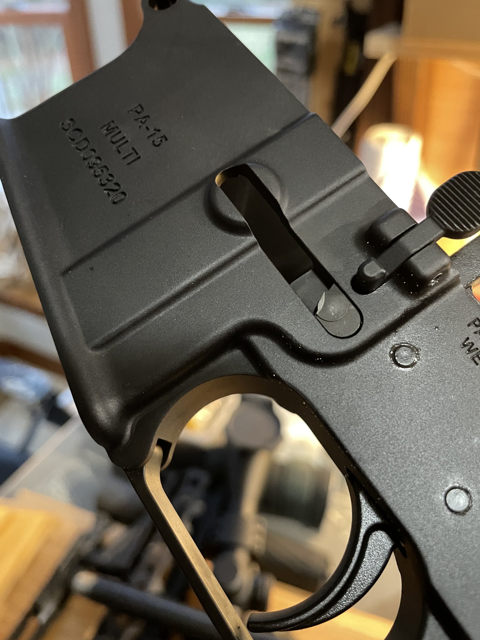

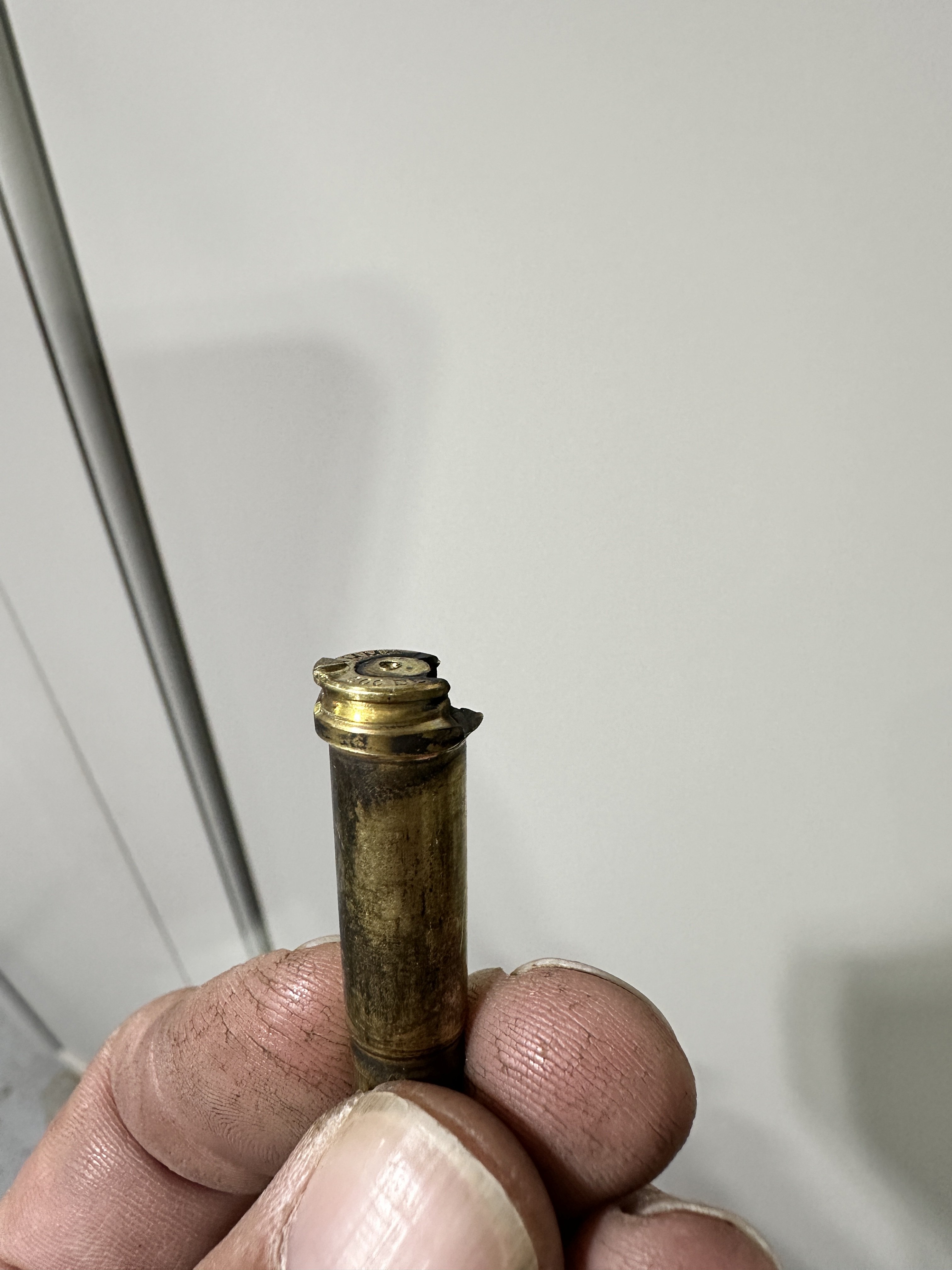

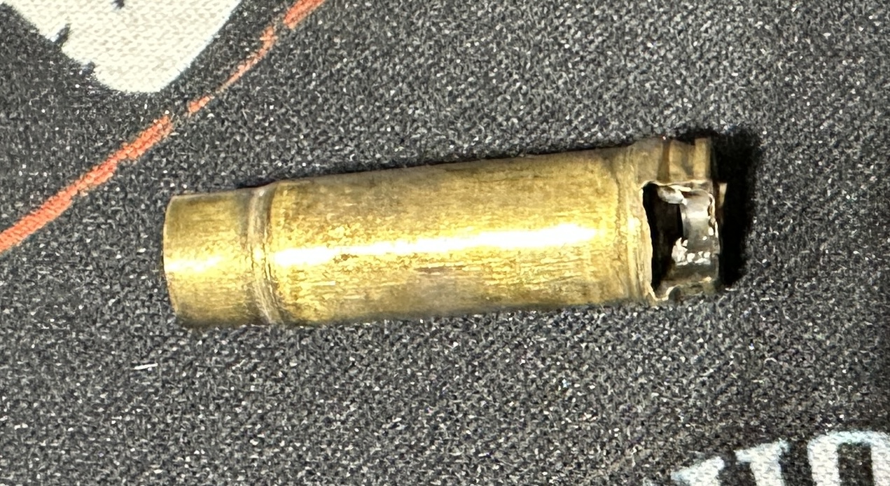

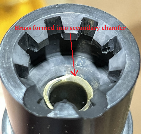

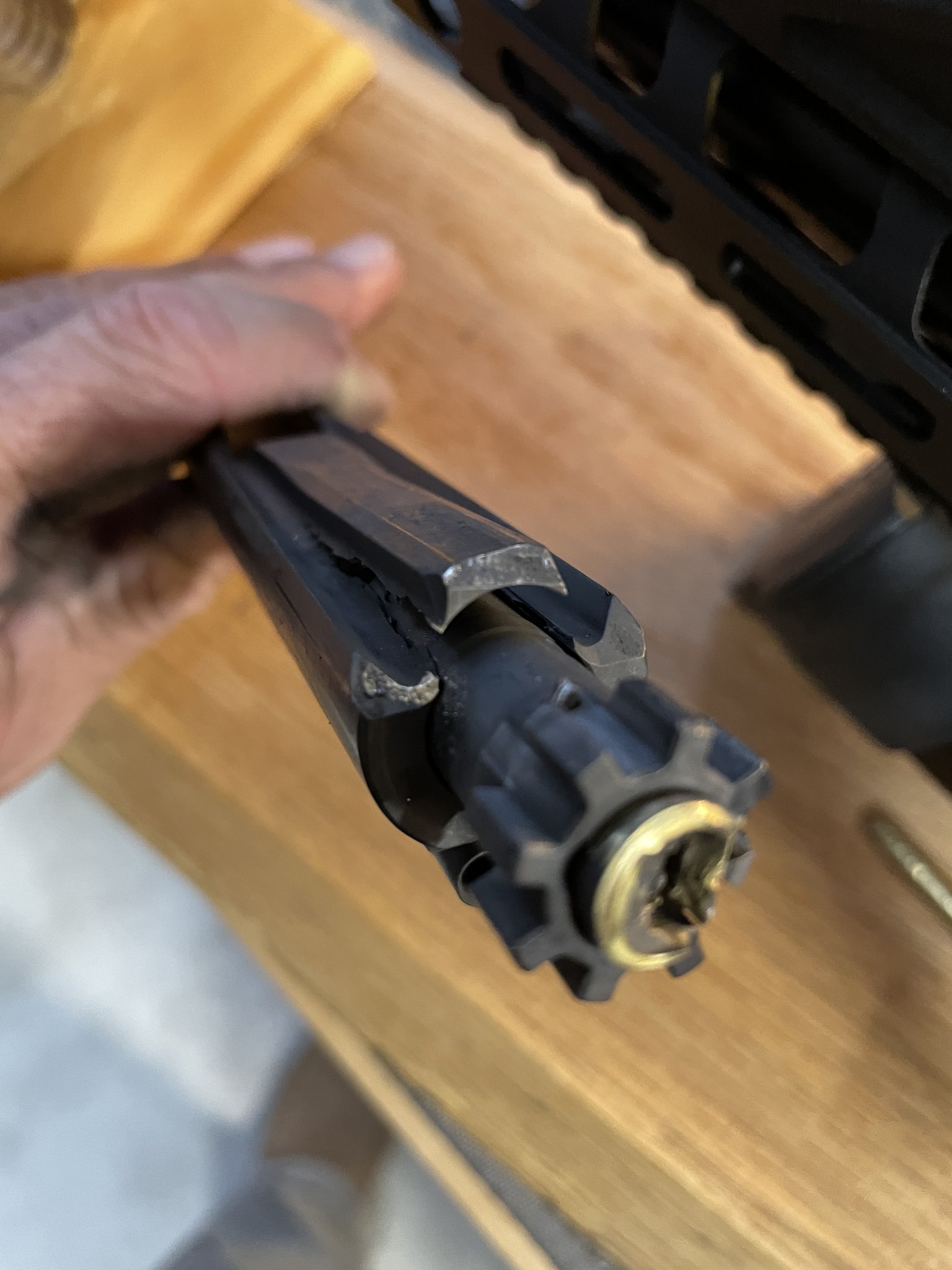

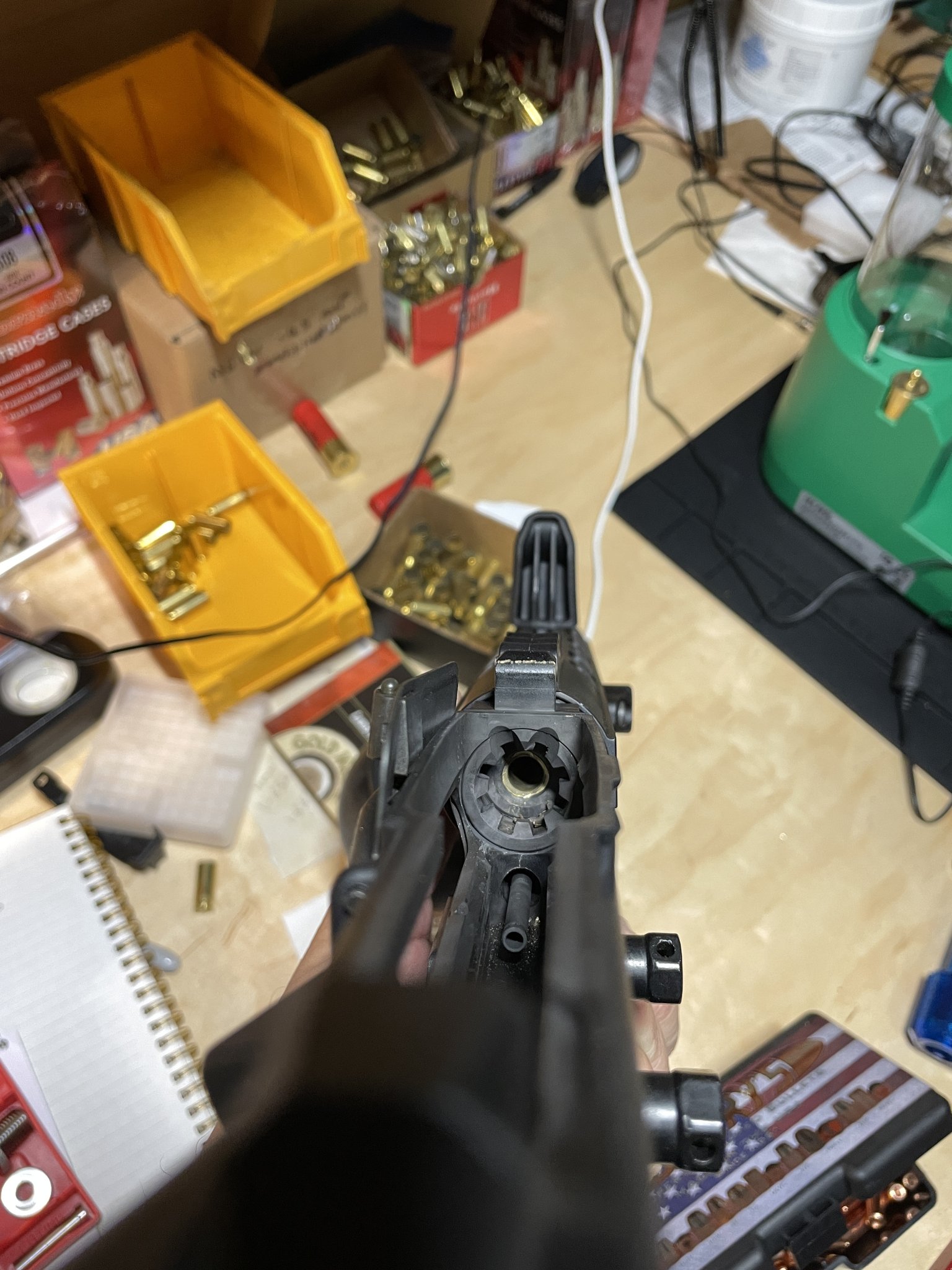

After 40 years of reloading, I think I finally screwed up ..... I think.
I was working up a new subsonic load (300 blackout) for one of my rifles, just a plain Jane AR15 that I've had a few years. I saw a load on Ultimate Reloader on YT and thought I'd give it a try. Berry's 220 gn plated bullets over 9, 9.5 and 10gn of H110, COAL 2.230", loaded 10 of each.
First shot .... BOOM! Thought I'd lost my hand! I rarely shoot with my left hand on the magazine but this time .... yep. It blew the mag to pieces.
You can see in the photos that the case head is still in the bolt face (bolt and upper are toast), the rest of the casing is in the chamber. It sent the bullet and thankfully didn't blow up my suppressor.
I have no idea what happened. My first thought was a double charge, still leaning towards that. I pulled all the others I loaded today and they were all on the money so my powder measure was working fine. I've mic'd a random selection of the bullets, they all measure .308-.3095 (is that acceptable??)
Would a bad case (head separation) be so catastrophic? It tore the bolt apart!
So clearly my upper and bolt are history, would you scrap the barrel too? The lower looks very slightly bulged at the mag housing and it broke the mag catch arm off but seeing as this component doesn't (normally) take any force, and you can by heavily skeletonized versions and polymer ones, I'm thinking I'll be ok to use it again, what do you guys think?
When I pulled the bullets I double charged one just to see if it was possible. It was, kind of. Two loads fit in but with a 220gn bullet it's a very compressed load and the round wouldn't stay at the set length, easing the bullet out a fair bit. It would still fit in the mag I think (didn't try) but I think it would have been noticeable in the box.
So, thoughts on what may have happened and thoughts on reusing the barrel and lower appreciated.View attachment 8279067View attachment 8279068View attachment 8279070View attachment 8279071

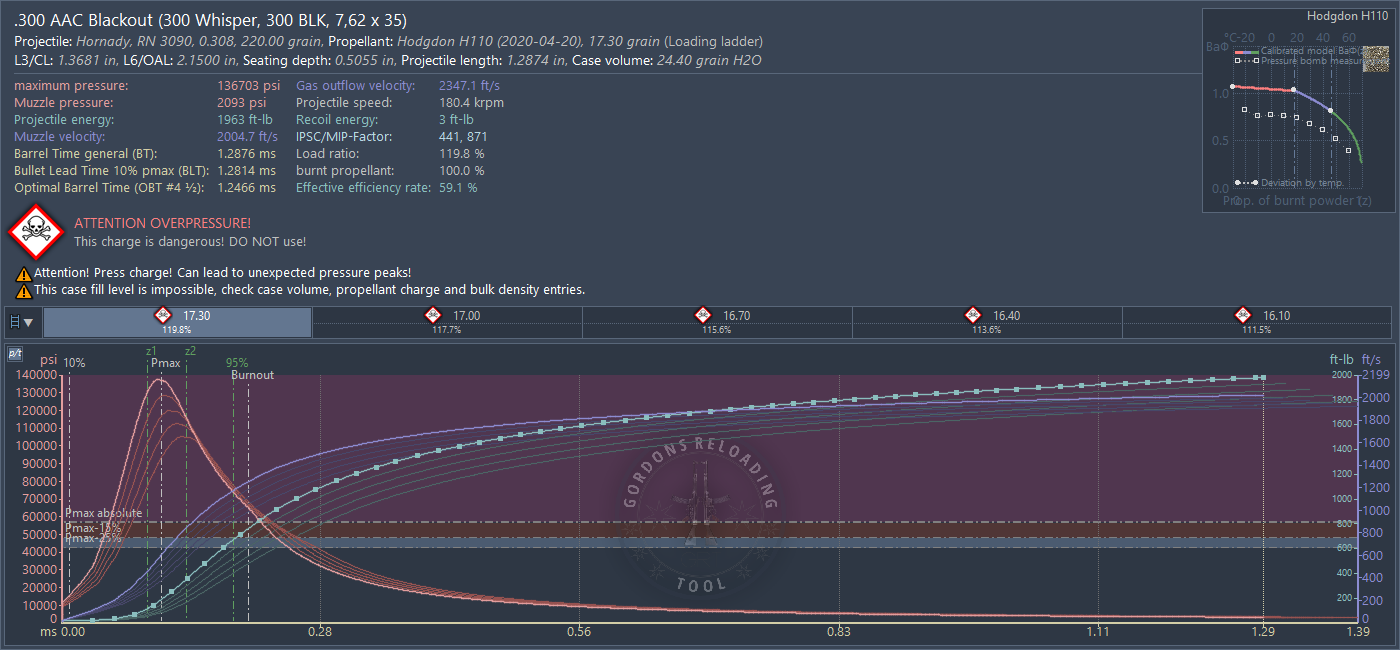

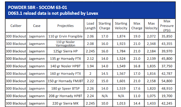

For what it's worth, I just entered your listed load data into GRT( with the exception of the projectile which was swapped for a 220 grn Sierra HPRN) & the pressure came out at 23KPSI & change for the 10grn of H110 but, 144KPsi at 18.8 grn which was the highest extrapolation calculated.
From the damage you've shown, I would imagine you've double charged & are a blessed man indeed.
Reactions: Southernspeed
Thanks for the info. Yep, definitely a double charge. I’ve seen a few guys on YouTube who have had exactly the same result from double charge remanufactured ammo. Fortunately for them the ammo companies fully reimbursed them and the gun companies gave them new rifles.

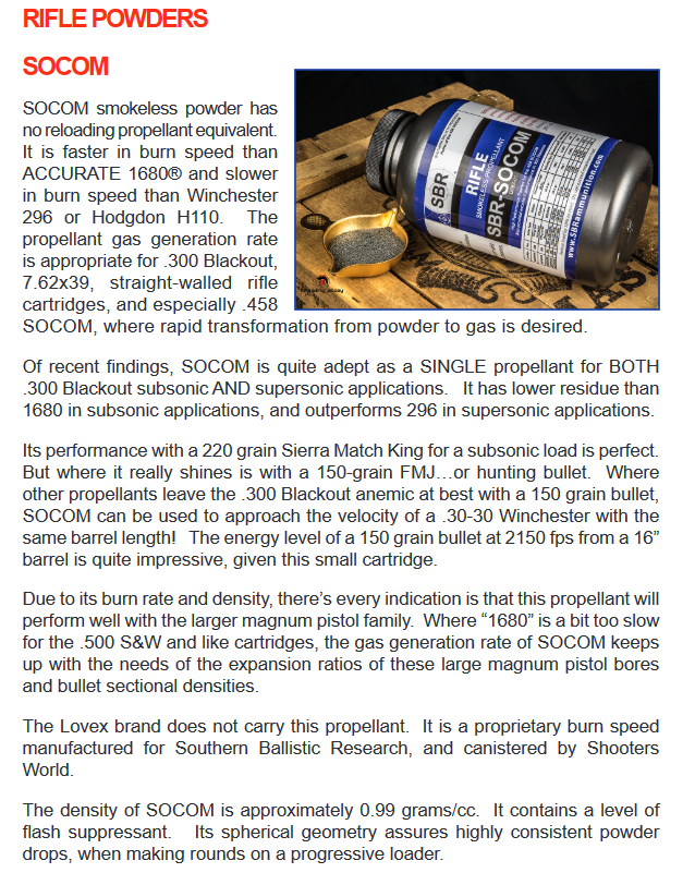

OP @Southernspeed - I don't have quick load. I use GRT, it's free BTW so you may want to check it out.
They didn't have the Berry's in the bullet catalog so I used Hornady 220 RN 3090 with COAL set at 2.150"
The highest charge it would register pressure for H110 is 17.3gr @136,703psi. Beyond that it just said "you'll shoot your eye out kid"
Simulation below for 17.3gr charge. I played around with max load length & up to 18.3gr & any way I try it a max compressed load is over 100,000psi.
This could've easily been a double or near double charge of H110.

  • No one has mentioned this yet, but I see a secondary chamfer on your barrels chamber. From what I see your chamber has less support at the .200 line than mine (BA 8.5 300BO). @Southernspeed - please drop a loaded round into your barrel & try to get a picture of how much case is exposed.

@Southernspeed - Obviously your upper & barrel are trash. I would replace the lower also. If the mag catch sits just a little lower than before you'll be fighting feed & bolt override issues. Not worth it.
I would also highly recommend Shooters World Socom powder for Subs instead of H110. The Socom was specialty formulated for this & It's excellent for supers also. With a full case it gives me 1875 with 155 eldm's from my 8.5" barrel. It's also my go to powder for 350 Legend.
View attachment 8287386View attachment 8287388
Thanks for that. I use H110 almost exclusively for my 300BLK loads; with Accurate 1680 substituted for subs when I can find it. I typically use 9.5-10 gr. for subs depending on the bullet, and 19-20 gr for supers, again, depending on the bullet I’m loading.
Will try that powder if I can find it locally.

I bought some SOCOM , looks identical to H110. I’d have to check my notes but I think I used 10.4 for avg 1050fps but I had function issues. BUT I had just rebuilt this rifle and although it ran 100 rounds of S&B subs just fine, I’m wondering if I didn’t get the gas block aligned correctly. I’ll check on that and go from there.
@357Max I tried out the SOCOM and had issues with it. Have you used it for subs in a gas gun? I tried 11, 10.5 and 10 grains. 11 were super mostly and would cycle the gun sometimes but sometimes it wouldn't pick up a new round and didn't hold the bolt back. 10.5 would eject rounds but would close the bolt on an empty chamber everytime. These were Berry's 220 projectiles.
I'd just put 90 S&B subs through it and it ran fine. I'm guessing SOCOM just isn't 'gassy' enough for 300aac subs?

Could have been an out of battery explosion. That listed load definitely would not have done that. I dont think a double charge would have . I load the 200 grain smk's VERY hot, actually close to your double charge and only get slight ejector marks.

Did you ever come to a definitive answer as to what happened? I know this is an old post but I had something almost identical happen a couple weekends ago. Shook me up so bad I haven’t shot since (and I’m a 2-3 times a week at the range kind of guy). I’ve been reloading for close to a decade and never had any sort of incident, I’m always extremely diligent and double and triple check everything. Anyways, I had shot about half a mag of 220 gr subs and suddenly I was damn near deaf. Took me a few minutes to get my bearings and then I realized my mag was in pieces and my bolt was welded forward. Luckily my can was fine but I couldn’t get the bolt to open. When I got back home and finally got it open (took a ton of beating with a wooden dowel) it looked almost identical to yours). I’m 99.9% sure I didn’t double charge and I’ve had squibs in the past but always realized before shooting again. I’m so consumed by figuring out what happened that I don’t feel comfortable shooting again until I know what caused this.
(Edited) Looks like a case head separation. How many firings on that brass? Cut that piece of brass open with a dremel and you will see a stretch line around the base, right where the failure occurred. Now, get a thin piece of wire and curl the end into a J. Cut the short end into a sharp point. Drag it across that line and feel it catch. Do this to the rest of your brass and cull any that you feel catch. Or, trash the lot and get new brass.
I culled this one before it became a problem.
Edit- Cereal-killer’s issue isn’t a head separation, but I’m leaving the rest here as a reminder to everyone to check your brass…
Eh, I've had over a dozen case head separations. They aren't exciting at all, just a lot of smoke and the next round won't feed because there's still half a case in the chamber. Most of the time you still hit exactly where you were aiming.
Looking at more than the one picture of the piece of brass on its side, yeah that’s more than “just” a case head separation. I mean, look at how much brass flowed to create that ejector mark. I assume that if the barrel is clear and undamaged, and the can is undamaged, that it wasn’t caused by firing into a plugged barrel. But, it was a case rupture, which points to overpressure, somehow…
@Cereal_Killer and @TonyTheTiger
No (reported) damage to barrel.
No damage to suppressor.
Extractor ripped through case.
Massive brass flow into ejector.
BCG moved enough to rip extractor through brass, but locked up before opening.
@Cereal_Killer, what are those circumferential line around the bullets on those unfired cases?
Maybe I’m too clean, but those cartridges look really dirty.
Untethered hypothesis time. Dirty (?) brass sticks in chamber. BCG moves to extract, but rips case because of stuck case. Residual pressure in system blows out magazine. However, I don’t think this accounts for the brass flow into the ejector.
This is some sort of overpressure event. I've experienced this on a 1911. I bought a used Les Baer and broke out my 45ACP toolhead to load up a powder ladder. I loaded 80rds over all. At the range I shot the first 5 rds over Chrono. Then loaded the next 5 rds. On the second round, I experienced an orange fireball in my face and shock to my hands. The slide was locked in battery, mag blown out the bottom, and the grip panels broke the lower grip screw heads and blew outward. I had gas burns on my face and was bleeding. I later squeezed a piece of brass out of my cheek like a zit two weeks later.
I went home and pulled the remaining rounds. I was using new virgin brass, A#5, and 200gr FMJs. I pulled and weighed each remaining round. All were to spec. I never found the cause. I was able to get the slide out of battery, replace the grip screws and luckily the gun is fine today. My theory is I had powder bridge in the Dillon thrower and dumped the extra from a previous charge, resulting in an overcharge. I don't remember seeing a lower than normal velocity in the 7 rds I fired tho.
The piece of brass that locked the slide up looked very similar to cerealkillers blackout brass. The unsupported web was expanded and blew out one side. Straight down through the mag. The case head had stretched to an abnormal size. Somehow a piece of brass had found its way straight back into my face.

Definitive, no. I can only go with the most likely scenario which was a double load. The pressure created by the double load is wild. I have no doubt that contamination with some left over pistol powder from a previous load run would do the same or indeed a barrel obstruction. In my case, I hit the target and barrel wasn't damaged so I ruled out an obstruction. Left over pistol powder, very slim chance of that but I really doubt it and it's never happened since so a double load is my guess. As it was on a progressive press, I'm still not sure how I did it but ... that's the most plausible scenario. Good luck with your analysis !
