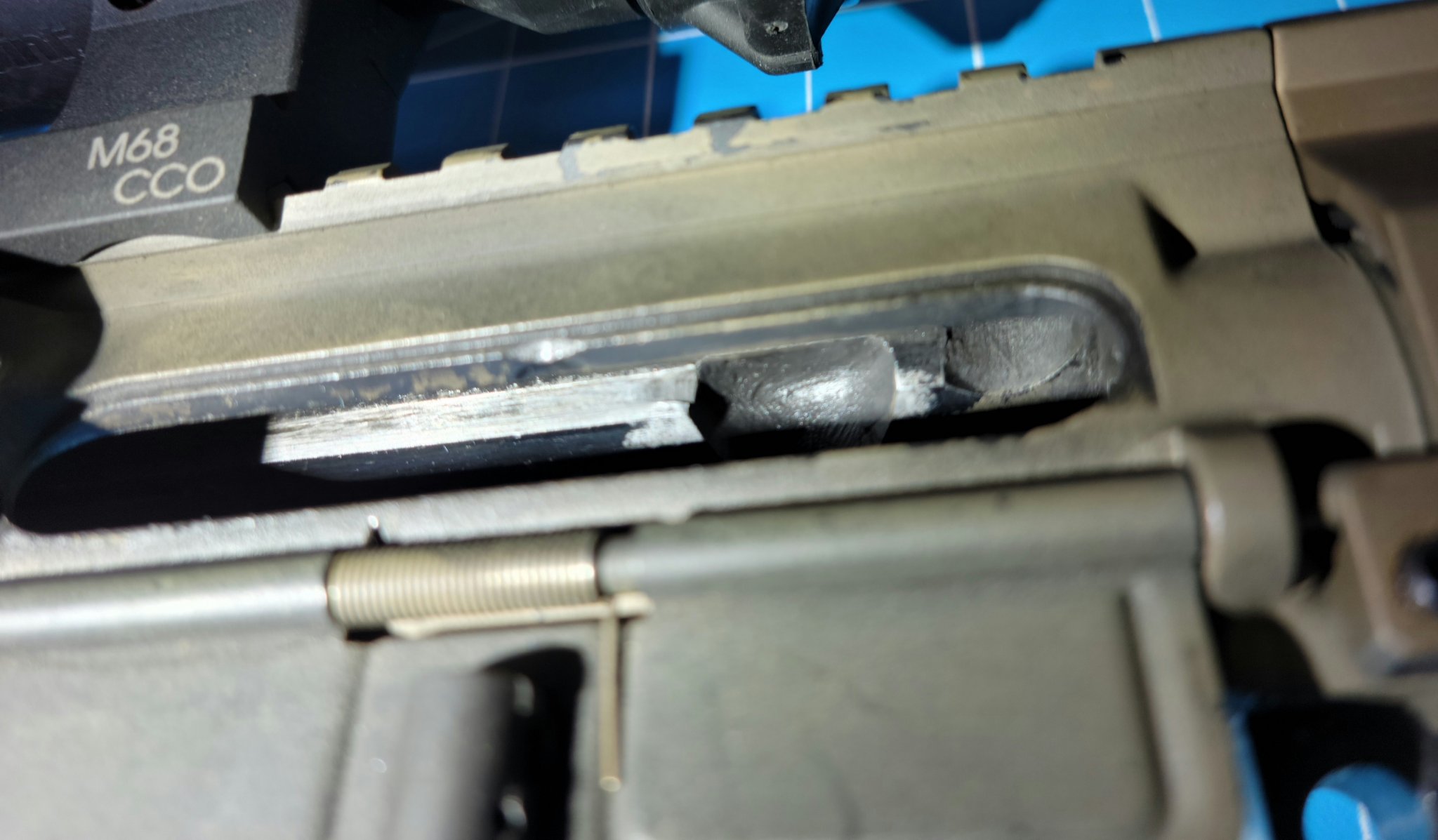

I blew up my rifle!

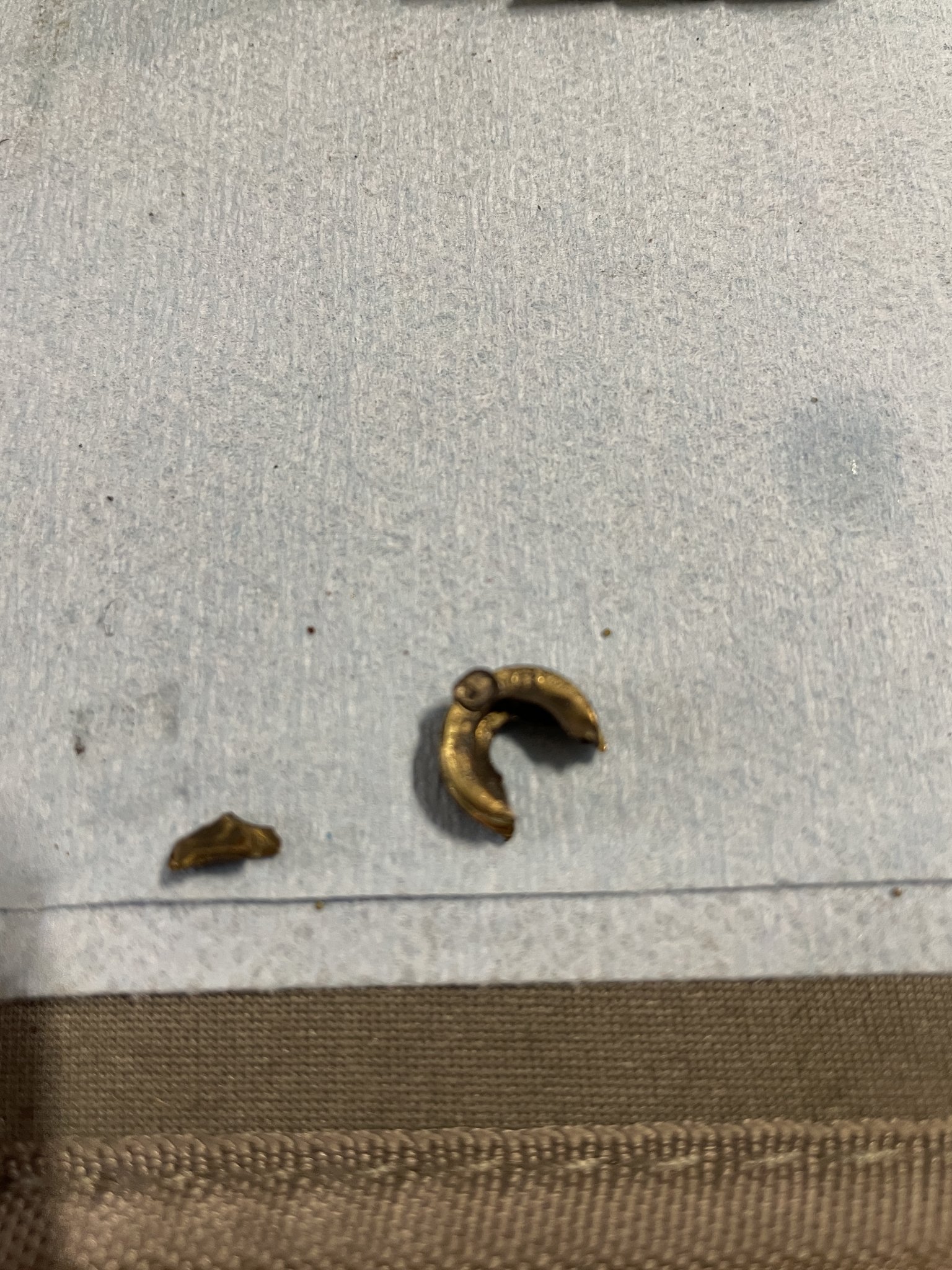

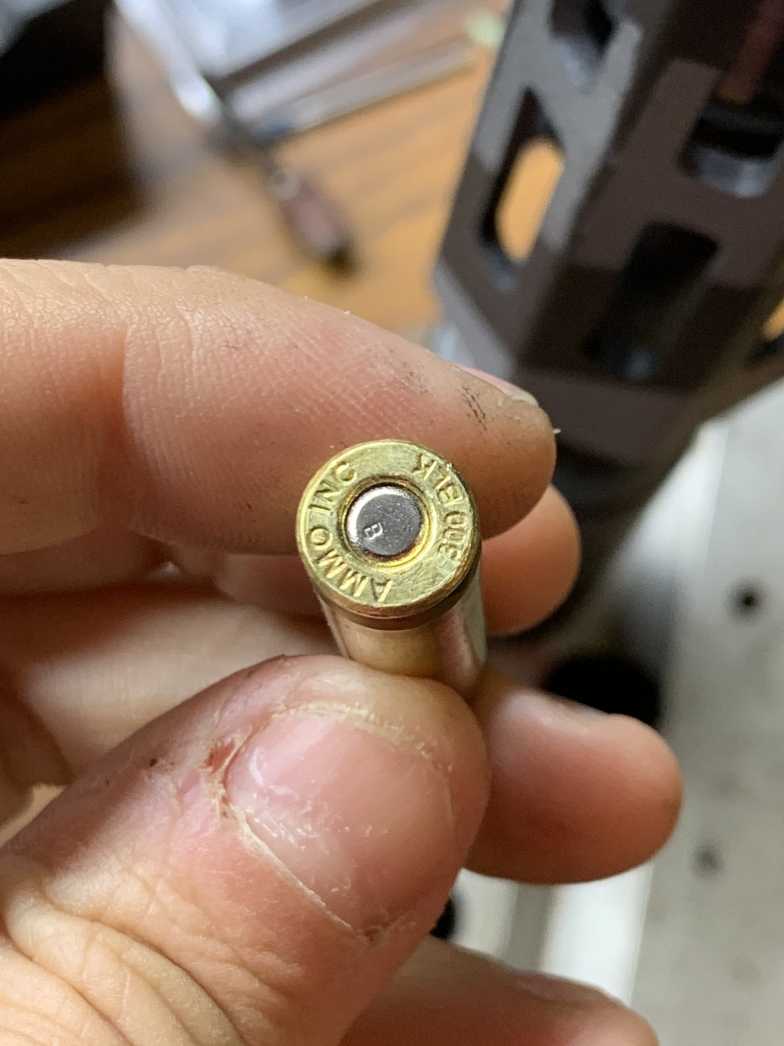

Could it be that if the bullet had a flattened portion in one spot, as shown in the pictures, could it have caused it to expand slightly in another part of the bullet and that may have caused a pressure spike?
To answer several comments, my brass is a mixed bunch. For some reason I didn’t keep track of newer and older stuff, unlike all my other rifle brass.
The brass I loaded up yesterday was all fired through a Ruger Ranch last week. Some of it has 2-3 firings, some of it was new factory before going through the Ruger.

See my pictures and feel free to post any of yours from any AR or BCG that you own. In both images I posted the firing pin is fully exposed to the primer.
If this was an “out of battery” (or… early?) detonation in an AR the bolt lugs would have been sheared.
Most likely what happens is when the case hangs up (due to the brass issue) the bolt is trying to rotate into place before it's all the way past the lugs on the barrel extension thus increasing the drag even more until it reaches the critical point where the firing pin is exposed.
In this situation, and it explains why, the carrier is split like a banana. The bolt itself acts like a wedge in a piece of firewood. The sequencing of events gets all messed up and the bolt gets subjected to the full force of a detonation (and gas) without having the lugs fully locked up, which resulted in a split carrier---the exact same as mine.

Is that brass too long maybe? The neck looks long in the pic. It would have to be either pistol powder, trash in there to cause out of chamber detonation, or brass jambed up so much it made double pressure to do that I would think. One of those 3 things is the only thing I could see doing that.

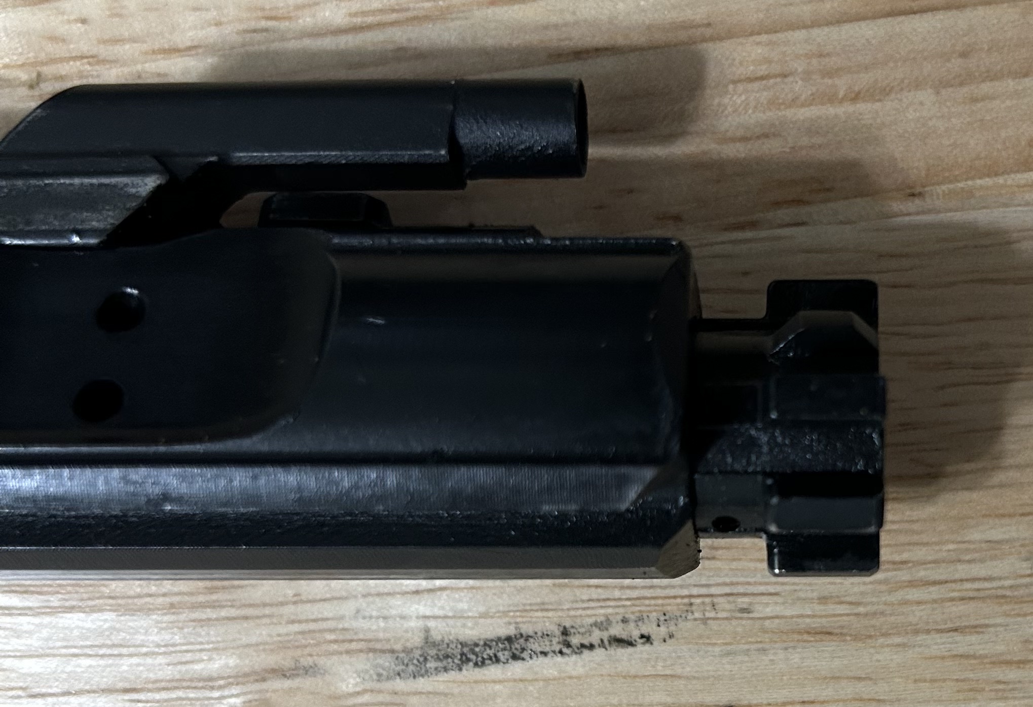

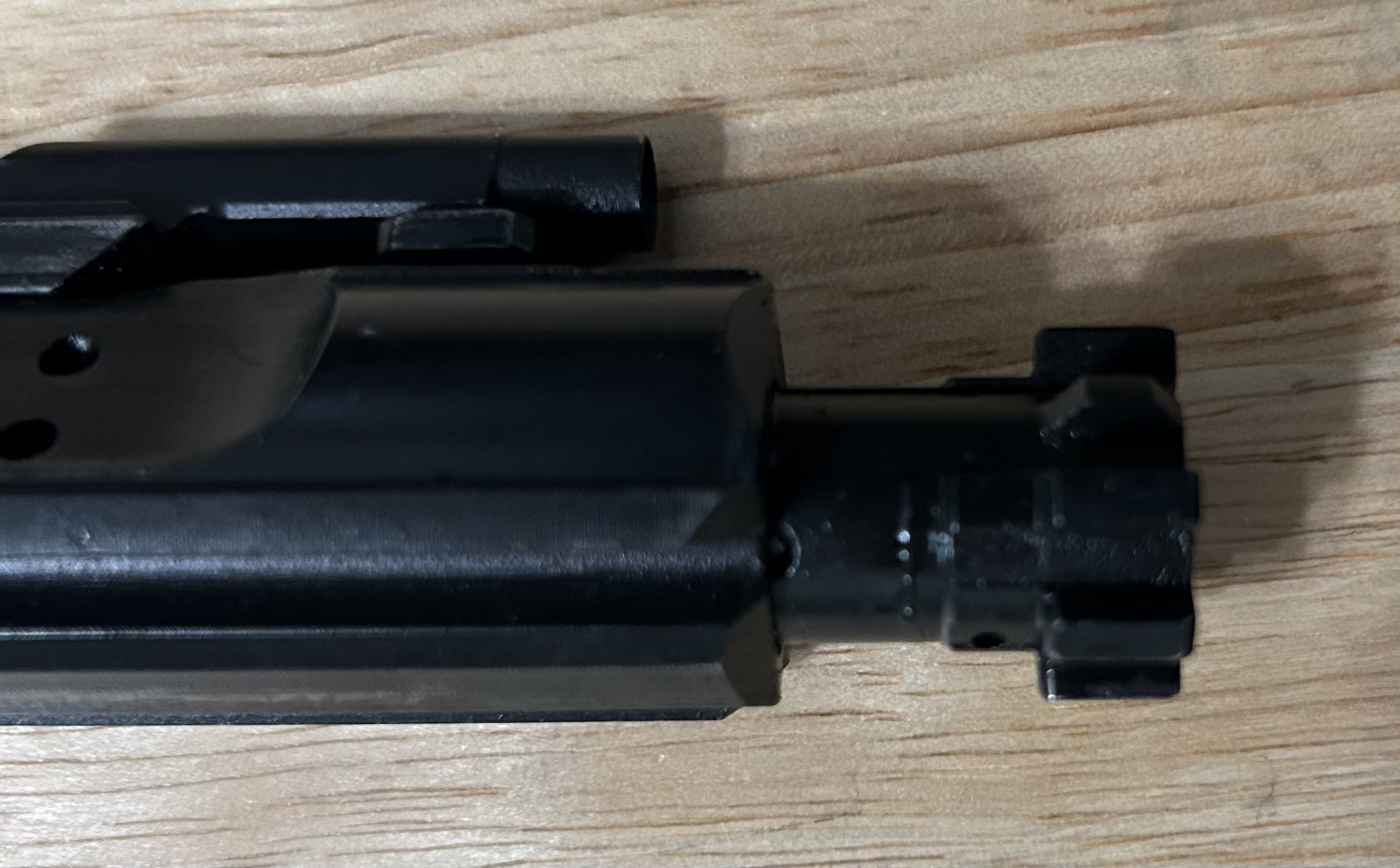

One image is the bolt fully closed all the way. The other image is when I push on the firing pin. The gap there is maybe 60-70/1000.
Anywhere in between there the firing pin can make contact with the primer.

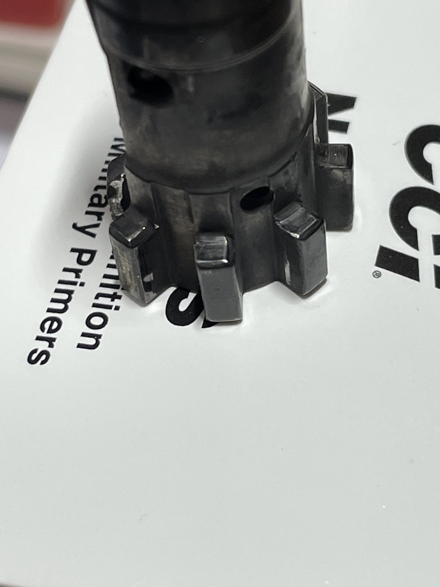

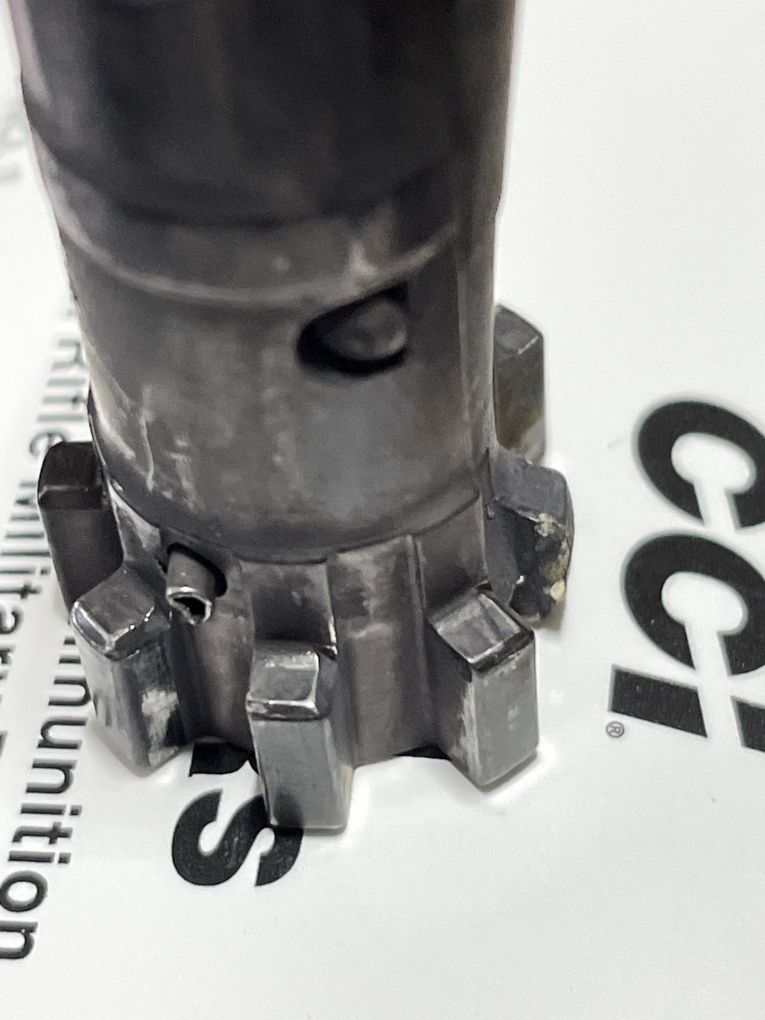

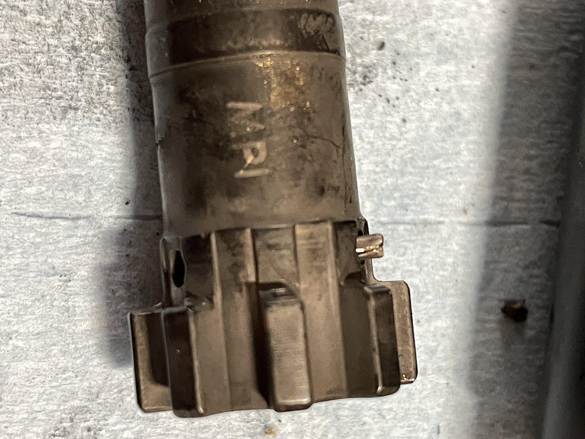

Just to add more fuel to the fire .... some photos of the bolt. Notice the roll pin hanging out. It has wear on it too though I've not noticed it out before. I wonder if that had anything to do with it. Split the bolt in half too! And what's left of case head.
Maybe evidence of contribution to out of battery? Just a wild fkng unqualified guess.

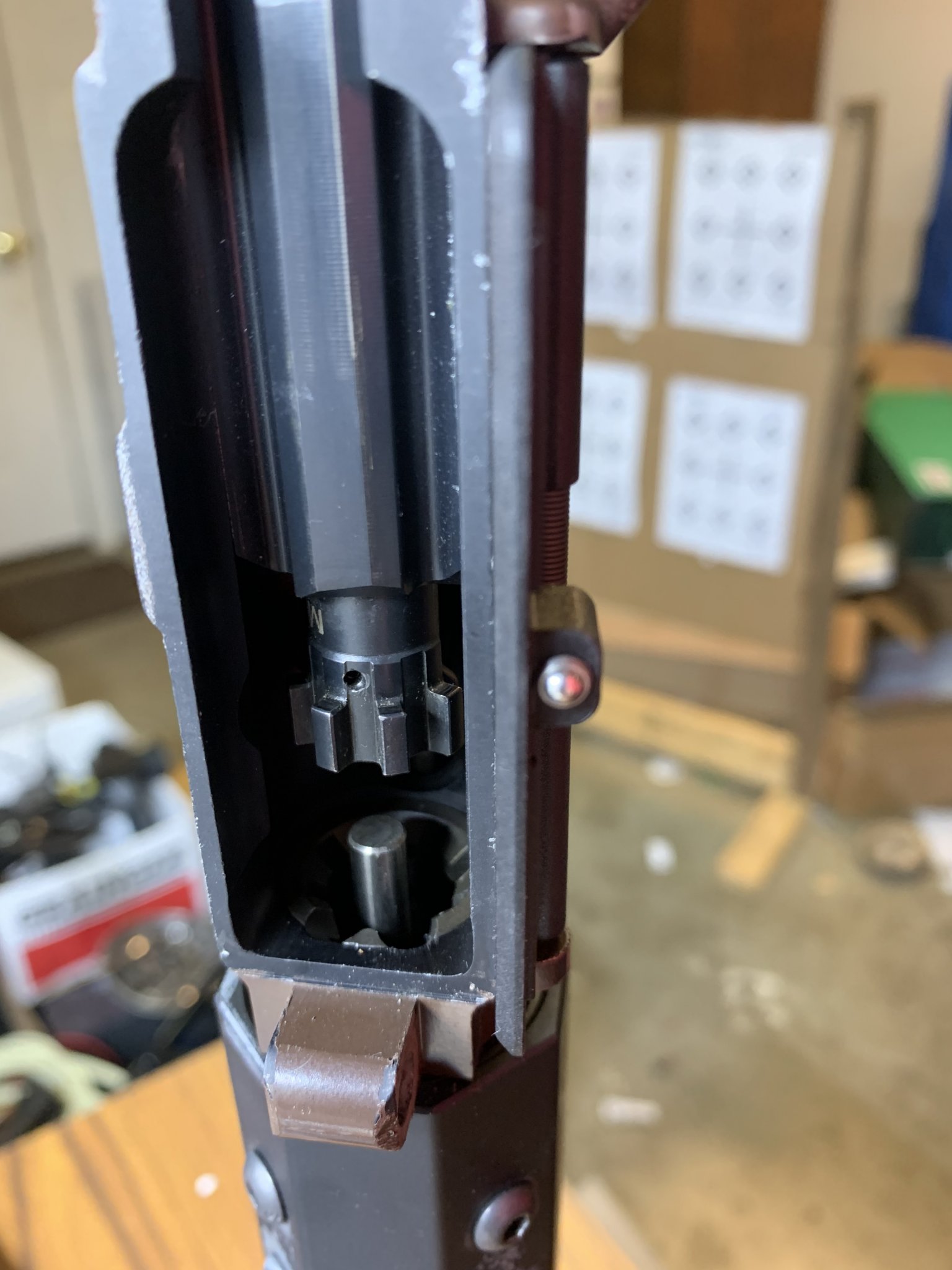

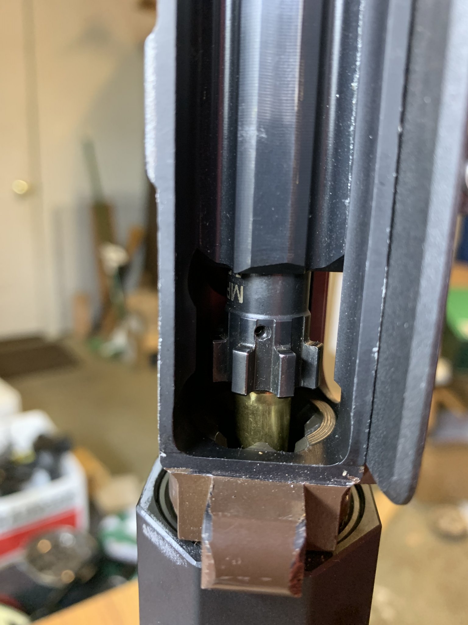

I had to test the OOB theory out for myself. My test probably isn’t perfect, but it was the best I could do at home.
I took a rod that was longer than the barrel to act as the bore/chamber obstruction and put a primed case on it(rod runs down into a bench block). Then I closed the bolt to the fully seated point just before the bolt starts to turn, and dropped a rod into the firing pin. I did this twice and it didn’t even mark the primer.
In that test it wouldn't.

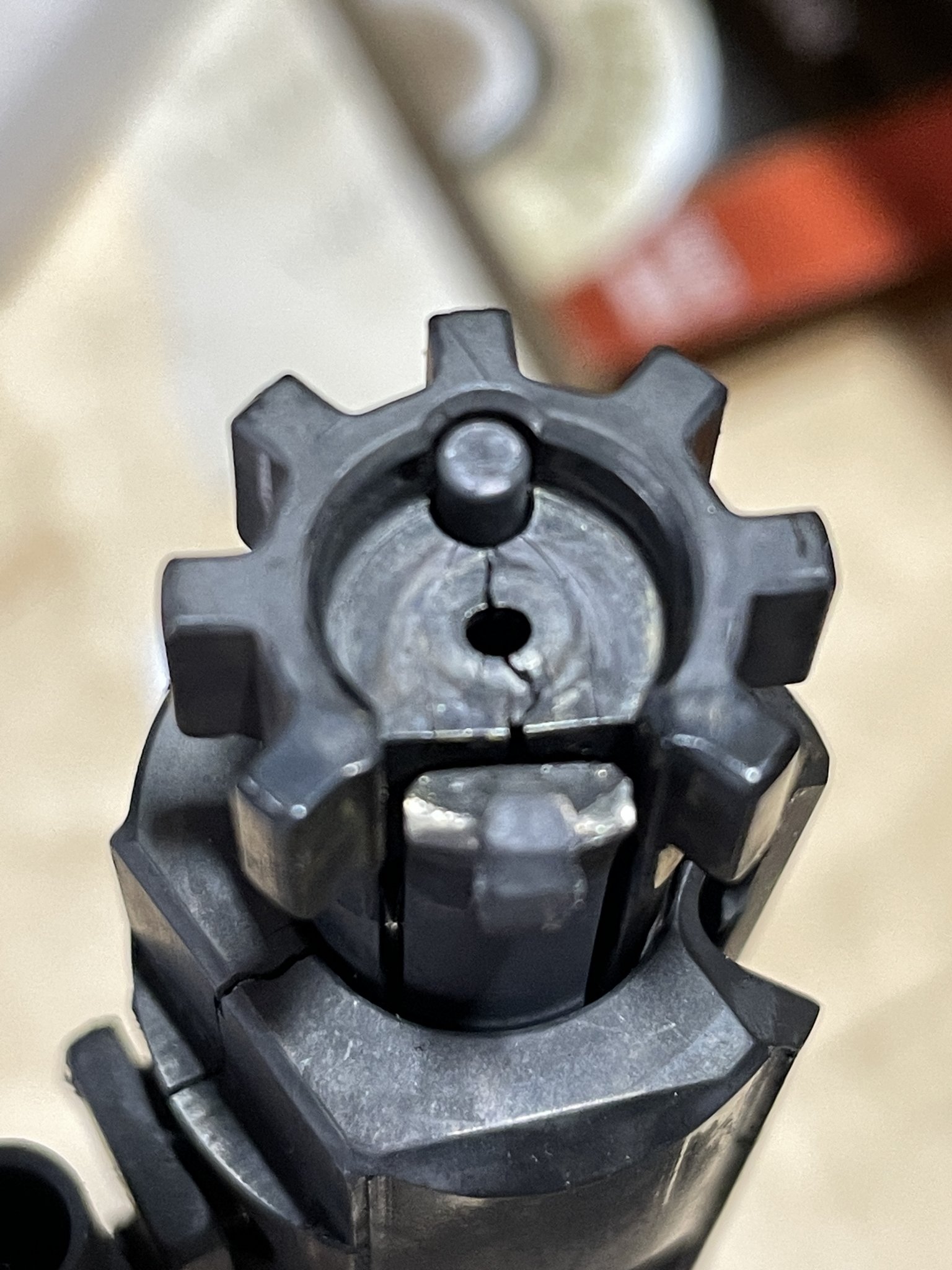

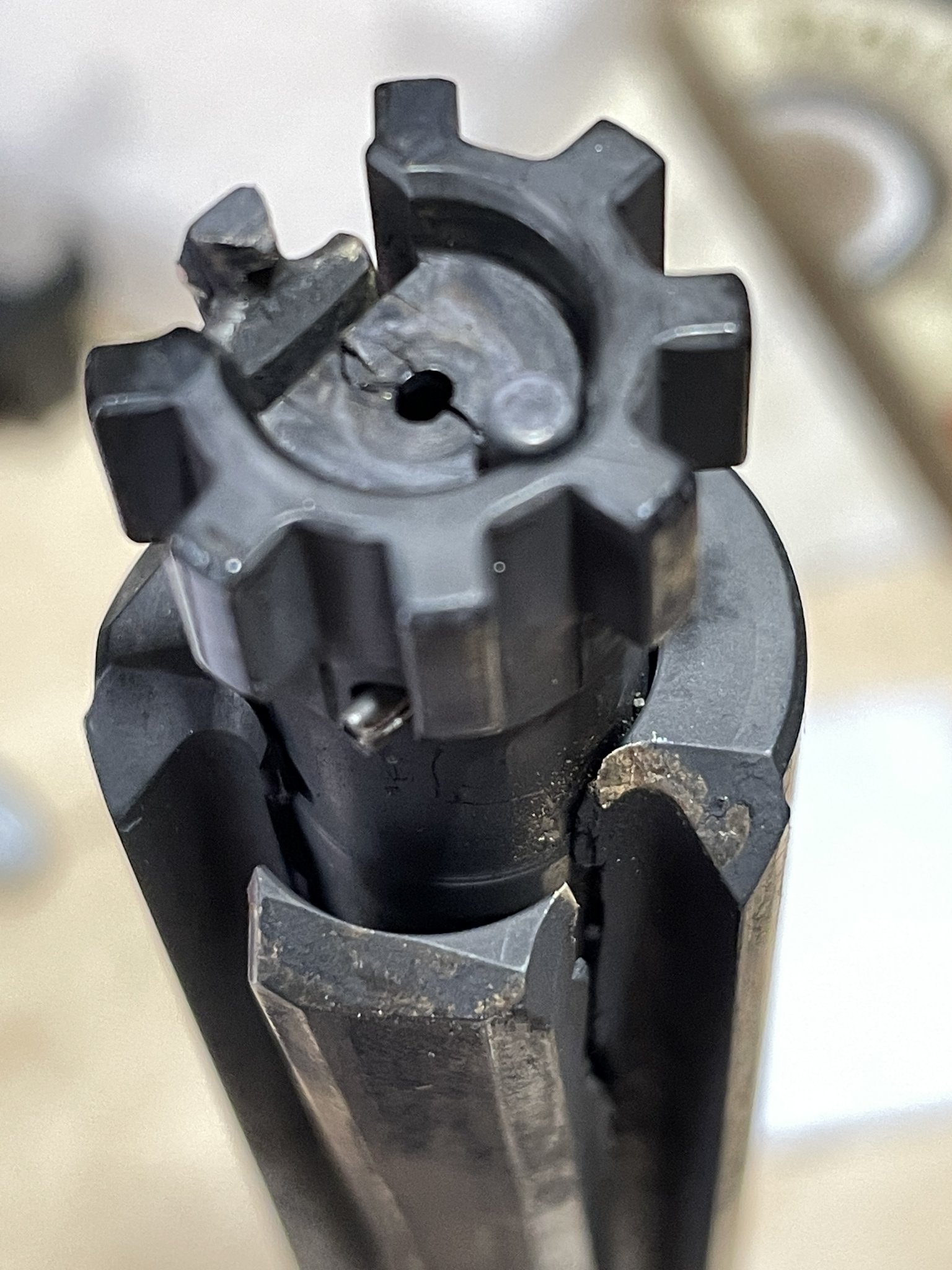

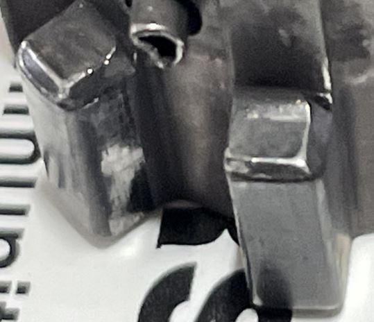

Can you post a pic showing the back of the lugs? I am just curious if that would show anything...
If the bolt retracts into the carrier any more, the lugs would be locking up.
What I have been saying all along is that the timing of everything would be out of whack.
My hypothesis is that the bolt was actually experiencing pressure from an out of spec round forcing it back into the carrier before it got to that point. It slowed down the timing of everything until the point that it went 'home' or just beyond the point of where lock up is possible inside the barrel extension.
So it would be like the lugs were bound up on the extension for a split second until it got just beyond...and that's when it let go and detonation happened. I am not talking about being fully disengaged, but rather (possibly) partially engaged.
Yeah, I’m not saying it couldn’t happen. The rod I have in the bore runs all the way out to the bench and is pushing the bolt back. I guess I could try to see exactly how much rotation is needed to get it to indent the primer, but his setup could be way out of spec, so that probably wouldn’t tell us much anyway.

The OP's bolt lugs were obviously engaged in the extension when the overpressure occurred. Look at the picture of the back of the lugs. They are deformed.

Did you see the picture of the back of his lugs? Obviously it was in battery when fired.

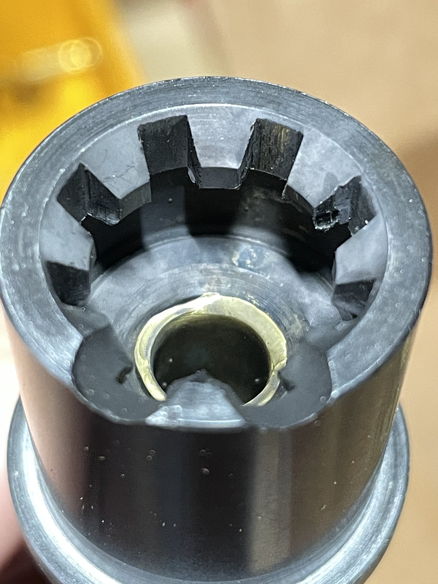

Are the back sides of the bolt lugs worn down/beveled normal?
Would that reduce lockup strength. Is this tapered on the locking side?

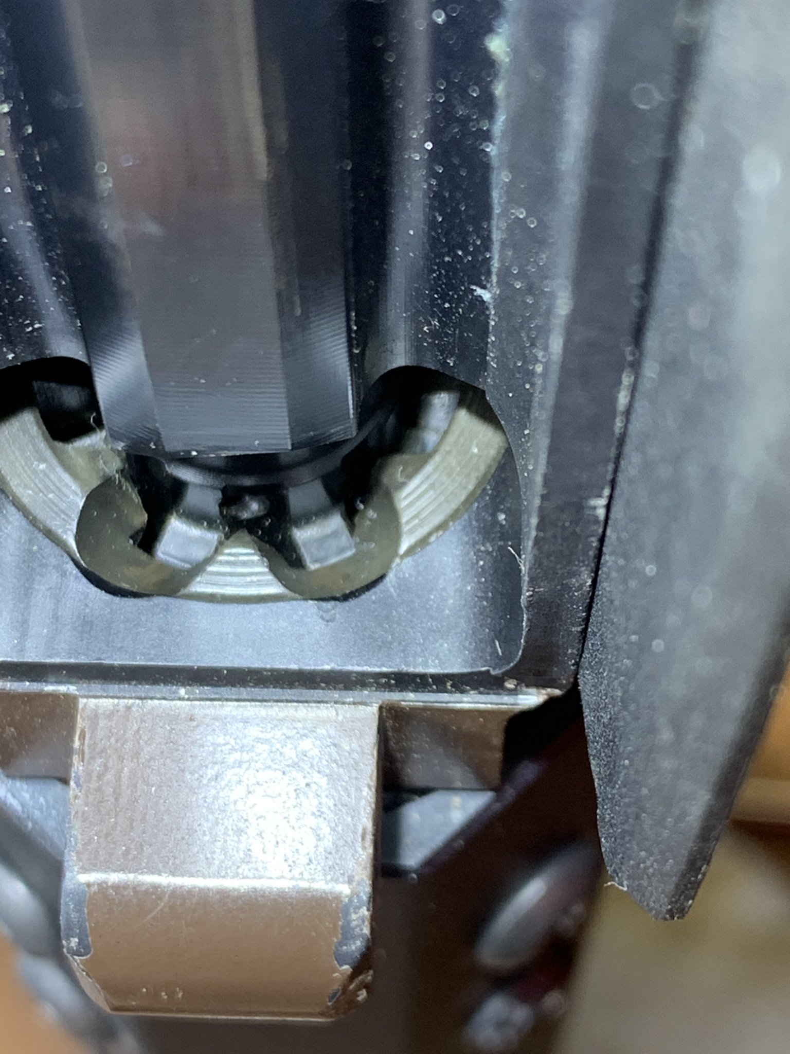

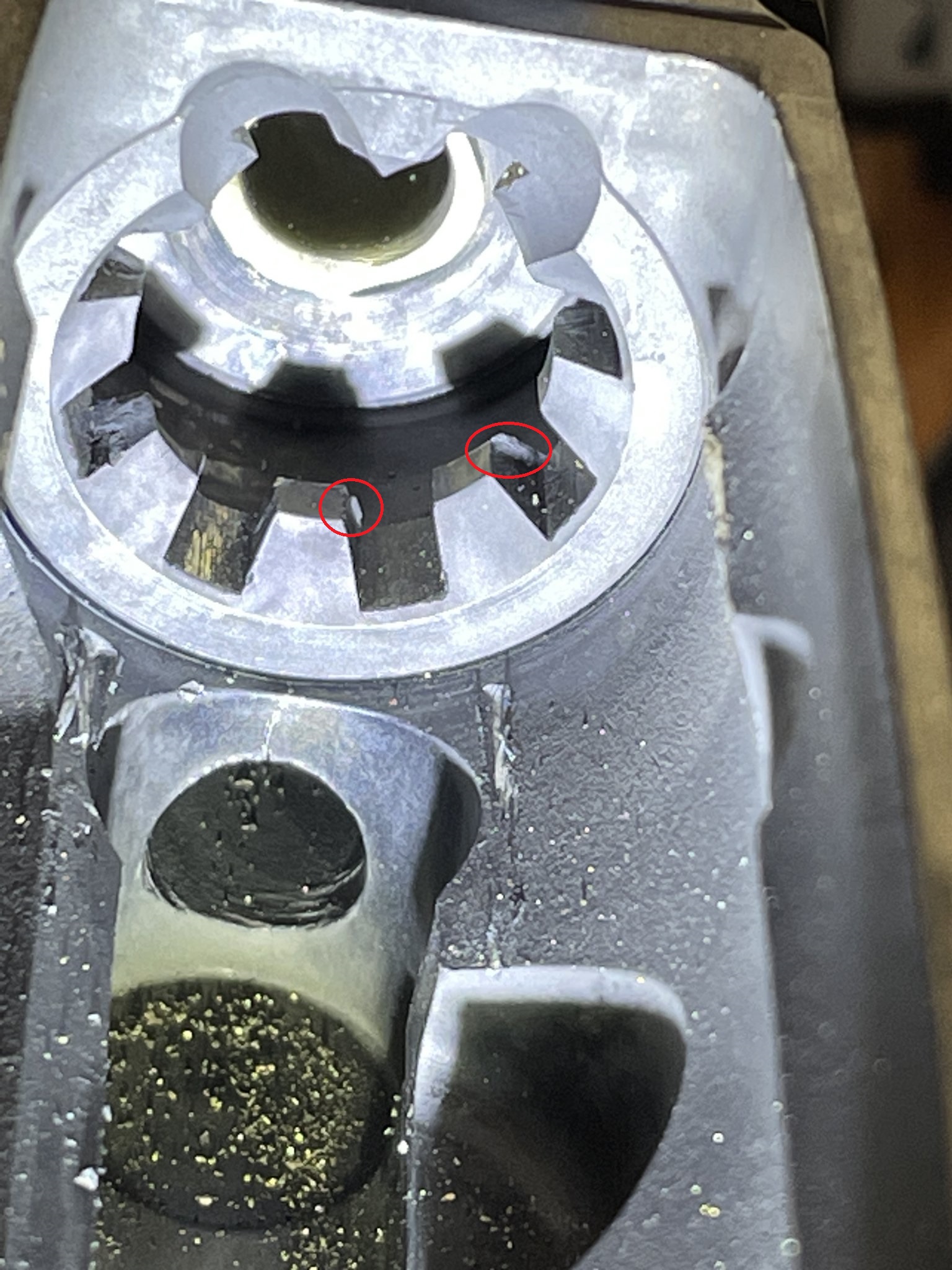

Also noticed the potential galling on the extension.
Bolt blows open early due to poor lock up would be like an OOB.
With your load is fill percentage is about 50% ?
It's quite likely that the tapered part on the back of the lug was done during the explosion. Once it rotates close to open with 100,000 PSI pushing on it that portion on the edge could shear off. Might have been that way to start, but that is severe wear.

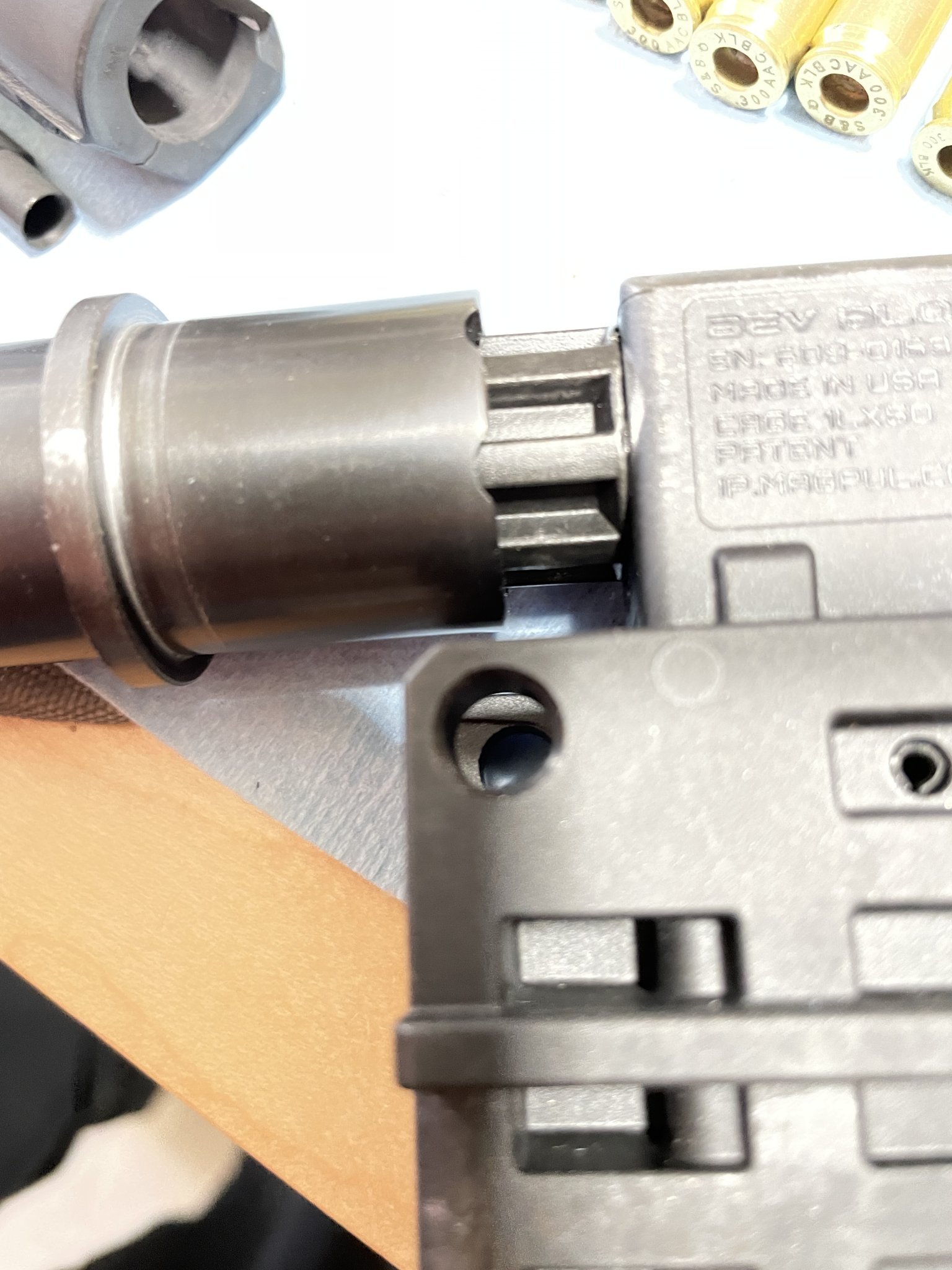

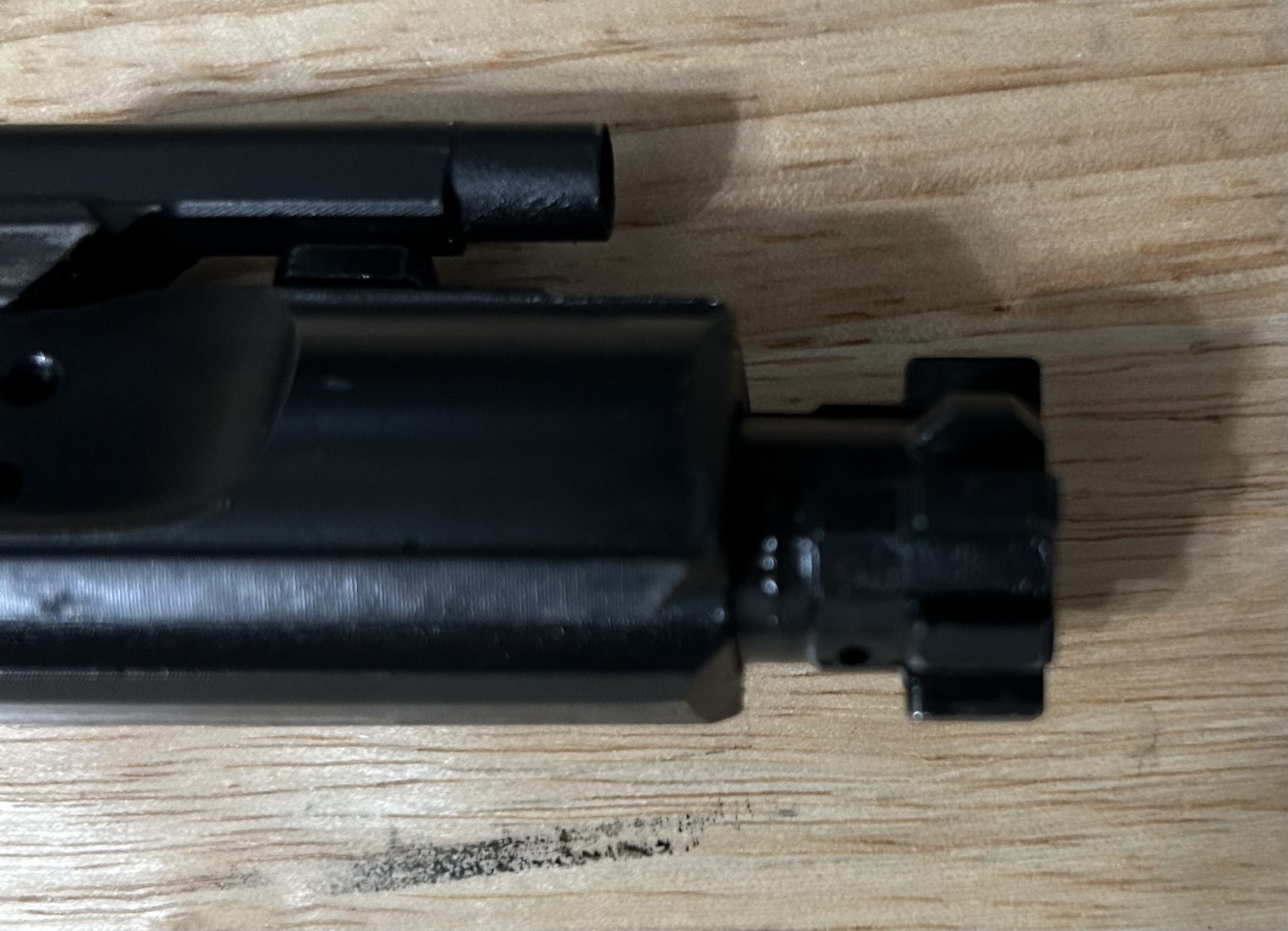

I took some pictures, as it is easier to describe with images.
First is a bolt carrier group with the bolt fully extended. This is the configuration of your BCG when the bolt is "open.' The lugs are rotated such that they can slide in and out of the barren extension. The firing pin cannot extend beyond the bolt face.
The second image is the bolt fully closed. The lugs are fully rotated into the "locked" position, the bolt has reached the extent of it's travel into the bolt carrier, and the firing pin can protrude beyond the bolt face. This is essentially the condition of a properly functioning BCG when locked and ready to fire. (There may be some gun to gun variation in how far the bolt travels into the bolt carrier, based on the interaction of the bolt carrier and the barrel extension.) It is in this configuration that the floating firing pin, using retained momentum from the cycling of the action, leaves a "witness mark" on unfired cartridges.
This third image (below), however, shows the bolt fully rotated into the locked position, however, the bolt has not reached its full travel into the bolt carrier body. This represents the condition of the bolt at the exact instant that it is fully locked into position. What is notable about this configuration is that the firing pin cannot extend beyond the bolt face.
Why the visual essay? This is to show that the firing pin, in a properly functioning ar15, cannot hit the primer of a chambered cartridge until the bolt is fully locked. About the only way for an out of battery detonation in a properly functioning AR15 is via slam fire, caused by a "proud" primer.
The beauty of this exercise is that anyone with an AR15 can do the same thing and prove the point to themselves.

Lugs intact, none sheared off, bolt blown to bits (almost).
Extension damage shows at least partial lock up.

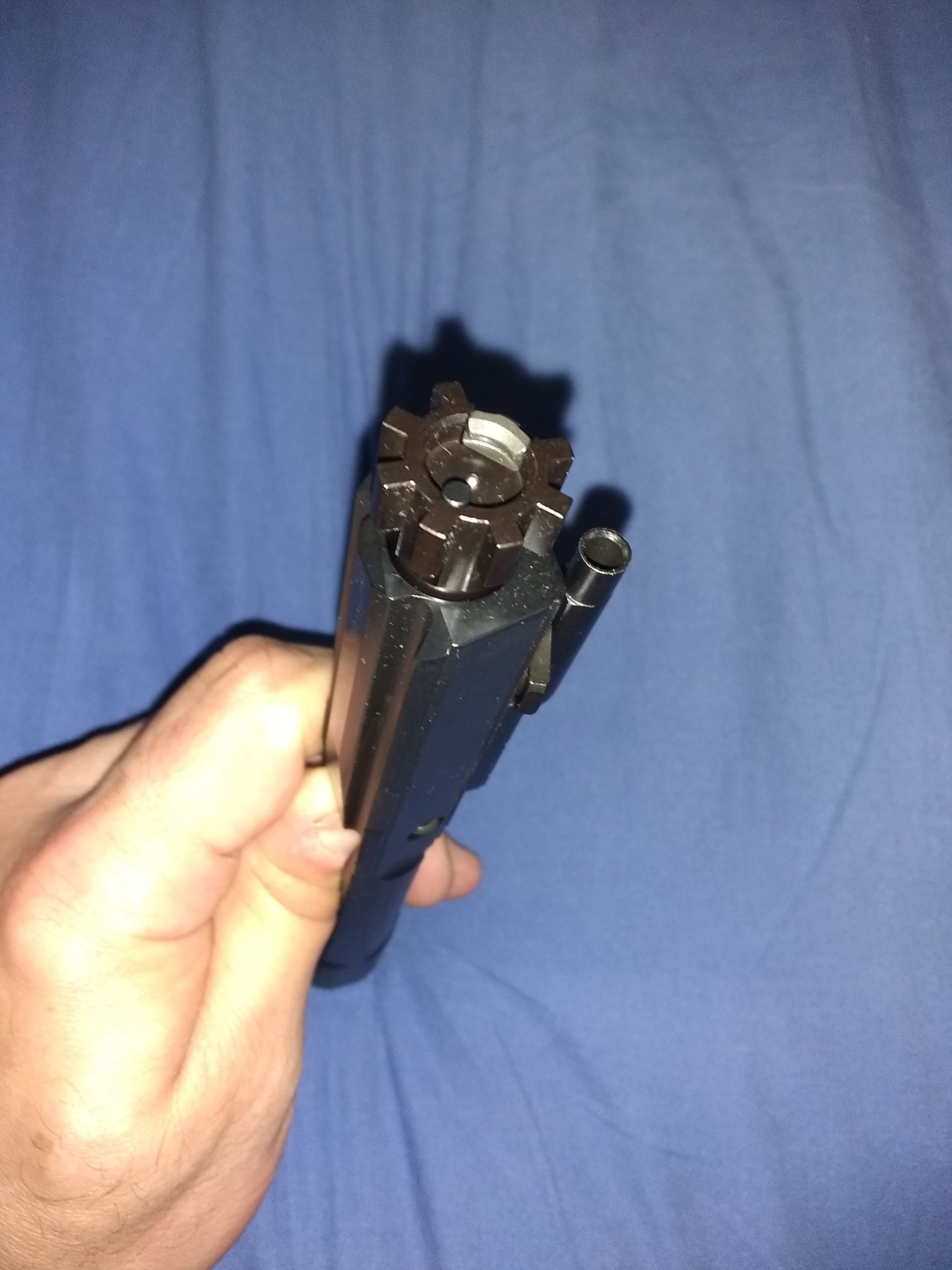

This is a brand new in the box Radian BCG. I pushed the bolt all the way in to the fully seated position, then I pushed the firing pin with my finger. Reference my posts earlier where I put up pictures. This is equivalent to your 'position 3'.
The firing pin absolutely protrudes enough to contact the primer. I wouldn't rule out a proud primer, but on my BCG that I am using for illustration purposes, in the fully extended but still in lock position the pin is absolutely protruding more than enough to strike a primer.
