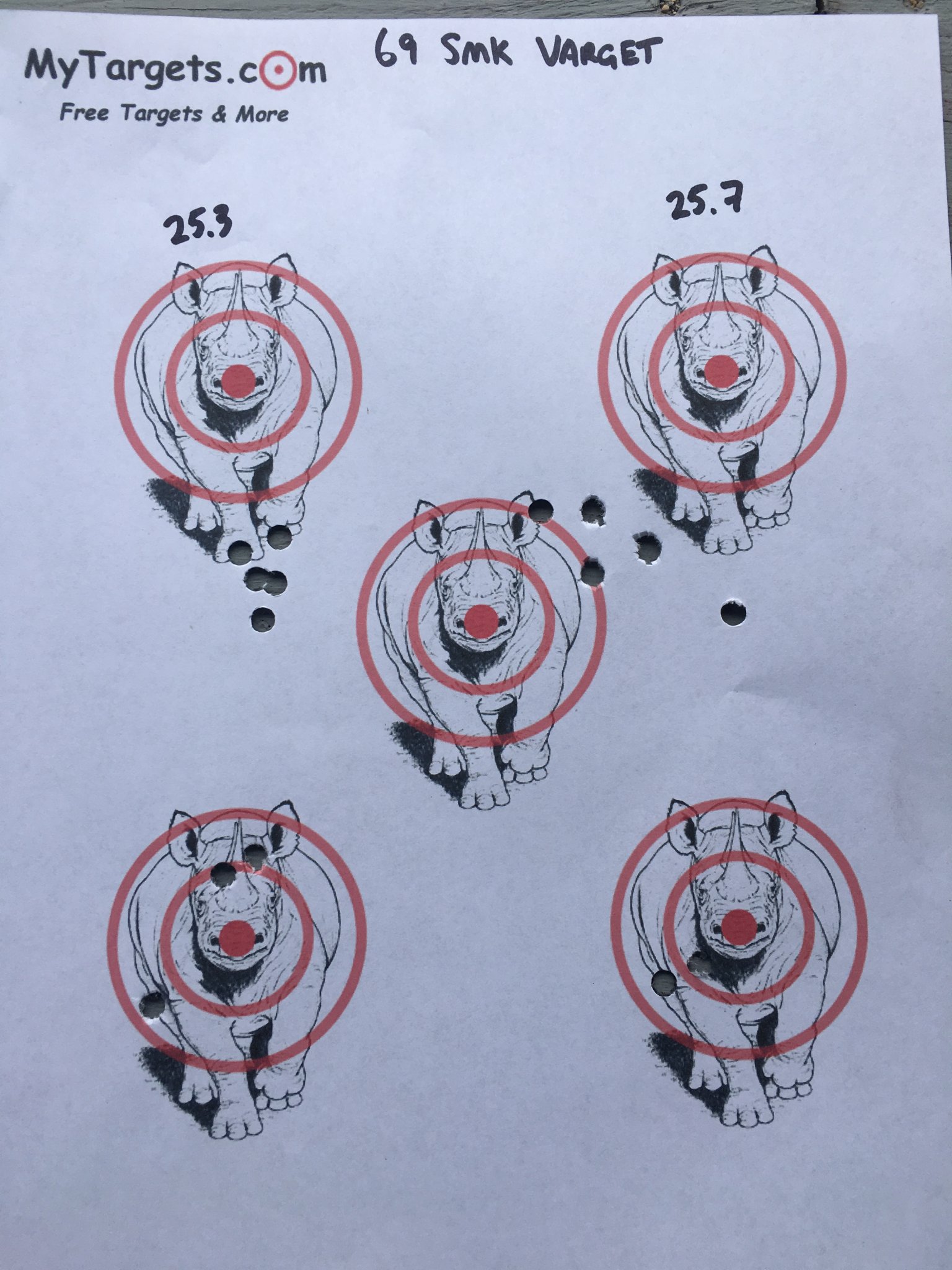

    I recently scoped my 18" Noveske. Before, I had been shooting it with an ACOG or Aimpoint, and I had no issues with the precision. However, in using a 3-18, I cannot seem to consistently break 1 MOA with any ammo, including a full hand load workup. Both 69s and 77s, no consistency. Ive also gone lighter, and the same shit. I'll shoot 4 shots touching, then the 5th will be 1.5 inches out. I will then try that same load the next day, and cannot get within 1.5 inches on all shots. Mount is solid as can be, and nothing else is loose on the gun. So, a few questions:
    Is this the best I can expect from a Noveske barrel?
    Is this typical for an AR platform?
    Do I have a bad barrel?
    Do I just not know how to shoot an AR?
    I am a sub .25 shooter on a good day with a bolt. Trigger mechanics are very good, attributed to archery. I've tried loading the bipod, not loading, and every combo of position behind the gun.

    I think some of the precision issues are related to my shooting, but what I mean by that is shooting 1” when I should be getting ¼”. Some of these groups are so out of control, I cannot attribute that to me. This is what I’ve been seeing in a 69 smk varget workup
    I don't shoot with a bipod worth a shit.
    I am either sling prone, or off a sandbag/ruck, preferably with a rear bag.
    Really, I think it is about tensions with the AR. The whole damned thing is so flimsy and twisty that EVERYTHING vibrates when you fire it, and because it is all metal, there's very little to dampen any of it like you have with a conventionally stocked rifle.
    The trick to shooting it well is to execute all other fundamentals, but ALSO to do so with exactly the same tensions and weights affecting the rifle. The weight of your head on the gun, amount of pull of your right bicep on the rifle, position of the rifle on the bags, your shoulder contact and push on the buttplate, how much you are or are not twisting the grip...etc. etc.
    All of that, and more, is why I think the Accu-wedge can matter for the AR, particularly for sling shooters: it has NOTHING to do with the rifle, per se, but it DOES make for a little more consistency in position of the shooter, because it eliminates some of the play between receivers that affects position.
    Oh, and I will say that AR's can be just as finicky about bullet choice as anything else.
    Try a Hornady 75 BTHP, a Berger 73 BTHP, and a Sierra 69 or 77SMK (NOT the TMKs). If one of those will not shoot with Varget, you could have a rifle issue.
    Make sure the gas tube is floaty-like. The Carrier, less Bolt, needs to shut on the tube, and not be under tension. When shut, the tube should still be able to move a little in it's star hole in the receiver...and that hole has to be kept clean-ish as well.
    But take that damned bipod off, fill a trashbag with sand or dirt, and shoot off of that with a rear baggy of rice-in-sock. It's more better, I promise. Get SOME position built that lets you lay the entire weight of your head on the stock, and puts you solidly behind the rifle, and feel free to pull the rifle into your shoulder a little.
    -Nate

    You have me seriously confused. You shot the same rifle before with an ACOG or Aimpoint and it shot "precision"? What does that mean?
    Was it ever sub-moa with you shooting it? How many rounds through the barrel?
    Have you used the scope on a different rifle to verify it's good? What brand? What brand of mount?
    Try dryfiring off something steady and note if the crosshairs jump when the hammer falls that they go to the same location on the target each time.
    I would definitely shoot off sandbags or something other than the bipod as you say you will try. I just read today about someone having 4 inches of horizontal at 100 because their scope base was loose. If you haven't reverified torque settings, you just think it's tight IMO.
    I should have worded it a little differently. I meant that I never was able to discern any precision issues because with the 1x, 3x or 4x mag, I was shooting distances between 100 and 300 yds, and I was simply hitting the target, not shooting groups. It seemed that the rifle was shooting well because of that.
    I will definitely shoot off something other than the bipod. I do believe my problem definitely is accentuated by the longer lock time as I stated above. If the barrel is a semi turd, my fundamentals aren't helping by any means. Time for some real practice.
    As far as the mount, the first thing I do before I leave the house or the night before is check my torque on the rail and the rings. This particular mount is a Seekins MXM mount, which is a rock solid mount. I am so confident in this setup that I don't even consider there is any movement.
    Oh, and the scope is a Sig Tango 6 3-18x44. Tried it on another rifle and it seems to work fine. Returns to zero and tracks. Barrel still has some time left in it. I don't think I have much more than 1k thru it if I had to guess.
    So after rebarreling another AR and having my upper tested by Noveske, it looks like I was having issues with my muzzle devices. Guns shoot very tight bare muzzle or with a direct thread can, but the flash hiders seem to be hurting the accuracy. Already talked with the guys, and we are gonna try to fix it together.
