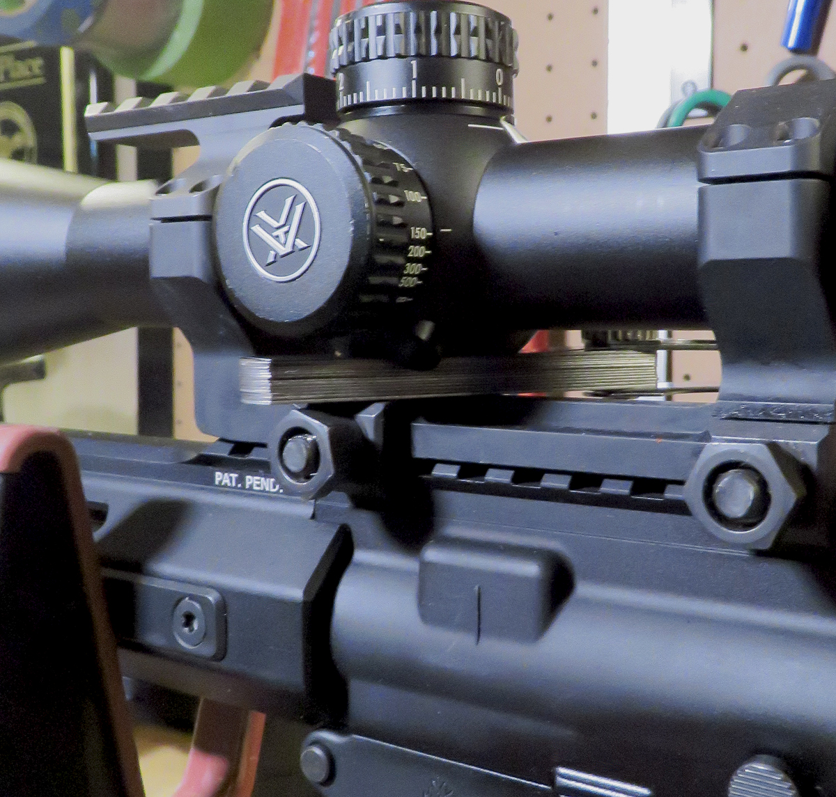

I don't use levels for the most part when mounting optics. I put the rifle in the vise, attach the mount, and use feeler gauges to level the bottom of the turret globe to the mount (ostensibly to the top of the picatinny rail too) and then torque the ring caps down.
I know it's not the most in vogue method but it's how I've been doing it for years and it's been working pretty well for me. If I'm feeling froggy I'll check it against a plumb line and level put on the pic rail.

Thats basically what I do as well. I level the scope in the one piece mount using feeler gauges or the leveler that comes with the mount. I then install the scope/mount on the rifle. Been doing this for 20 years now.

I use Allen wrenches, I can usually find one that with a little twist gives me the parallel reference that will not get stuck.
Arisaka makes an inexpensive sine bar level kit for squaring the mount to the scope, the Allen wrench works well, and so do the feeler gauges.
And I like using the plumb/level line to add my bubble level. Then I know everything is pretty much perfect.
