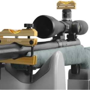

So was not familiar with the wheeler system so I googled it. How are you getting the barrel clamp level square to the rifle?
You pull the scope off, put one of the fixed level on the rail so the gun is level (I use a vise to hold it in place but it’s not necessary).
Then you put the barrel level on the barrel and use the little screw adjustment until it show level (cause we already leveled the rifle).
Put the scope back on and level it to the gun….or not if you are trying to compensate for some degree of natural cant.

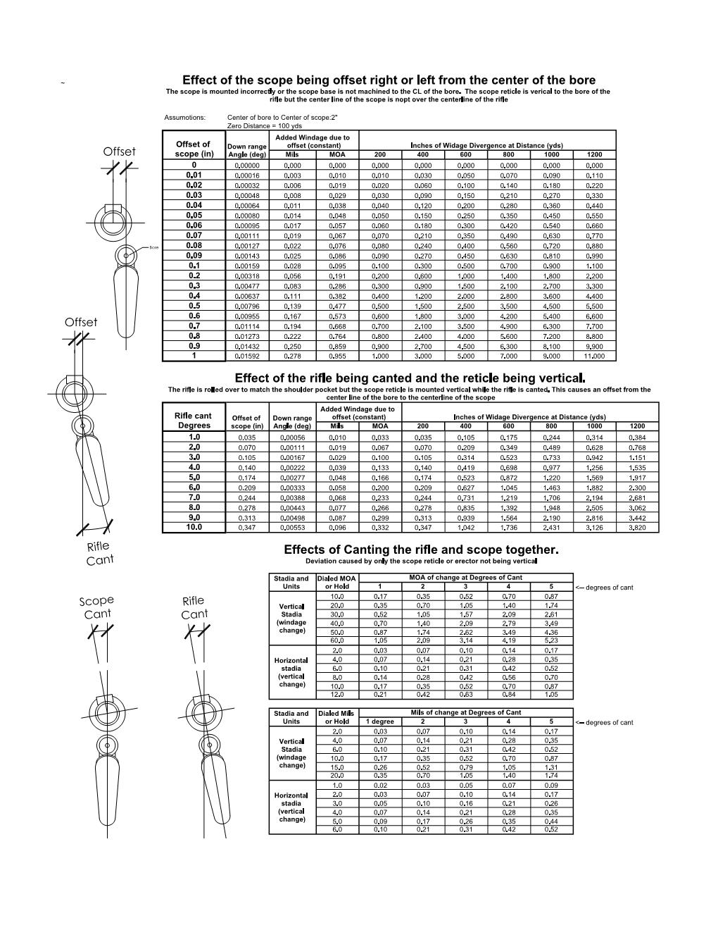

Collected these from lordy knows when.
Have I read them?
That’s a totally different matter.
  • Effect of Rifle Cant on Point of Impact at Low and High Inclinations.pdf
  • Estimation of Shot Error due to Rifle Cant.pdf
  • Effects of Scope Offset and Cant - Examples.pdf

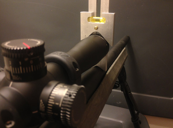

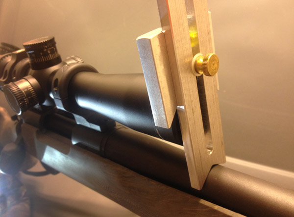

To level the rifle, I use this EXD tool from brownells, a sturdy tripod, and the edge of my neighbor’s house:
(not my pics)
This tool plumbs the two circles (barrel & scope objective bell). Yes, the bore of the rifle may be not dead center, the scope bell and/or barrel are not perfectly round, and yes, the level might be off. I don’t think I can shoot the difference and the longest I shoot is 500-600yds at 4” targets. Mostly 450yds on in.
After using the EXD, then lock the tripod head.
Level reticle using the edge of neighbor’s house about 60yds away. Keep the rifle level the long way the best you can.
Then put the EXD back on the gun. Holding it against the scope, you can see through the slit at the edge of the house and also look up at the EXD to confirm the setup is plumb to gravity
Tighten.
Double-check that EXD and reticle still agree.
Done.

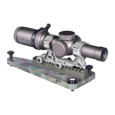

The best way is Frank’s way, using a super heavy fixture.
