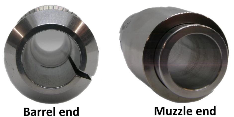

I did this with a Tikka T1x, works rather well
I was thinking more along the lines of a fully adjustable version after one time install.
Automotive wheel weights. Lead Tape. Etc. Even a hose clamp.
Be aware that barrel tuners do better with some adjustability built into them, environments change.
I tried them all in NY. They all worked, but the hose clamp left no traces. Mark the setting with a small center punch dot (Witness Mark). Multiple dots are OK, just don't lose track of which is which - inscriptions give it all away.
Best compromise is a small adjustable along with a larger semi-adjustable, so you can set it up for different loads (LR vs Varmint, etc....)
Big masses are too hard to adjust. Smaller masses require more adjustment. With small masses, expect to re-tune with each session. I gave it all up, set an accepted limit on my accuracy, and moved on. The conclusion, they are a very effective waste of ammo and bore life. I don't win matches, I never intended to. My only real competitor is myself.
