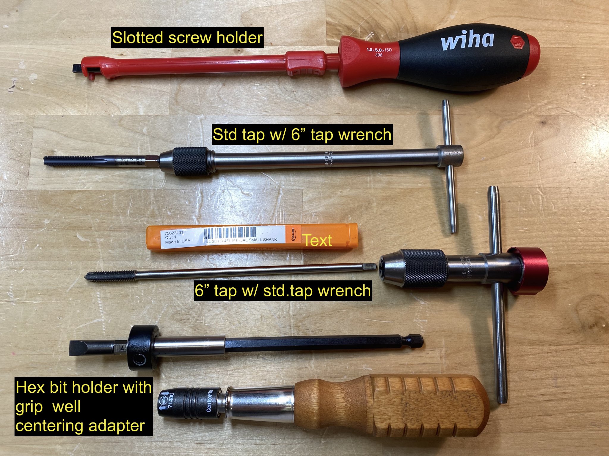

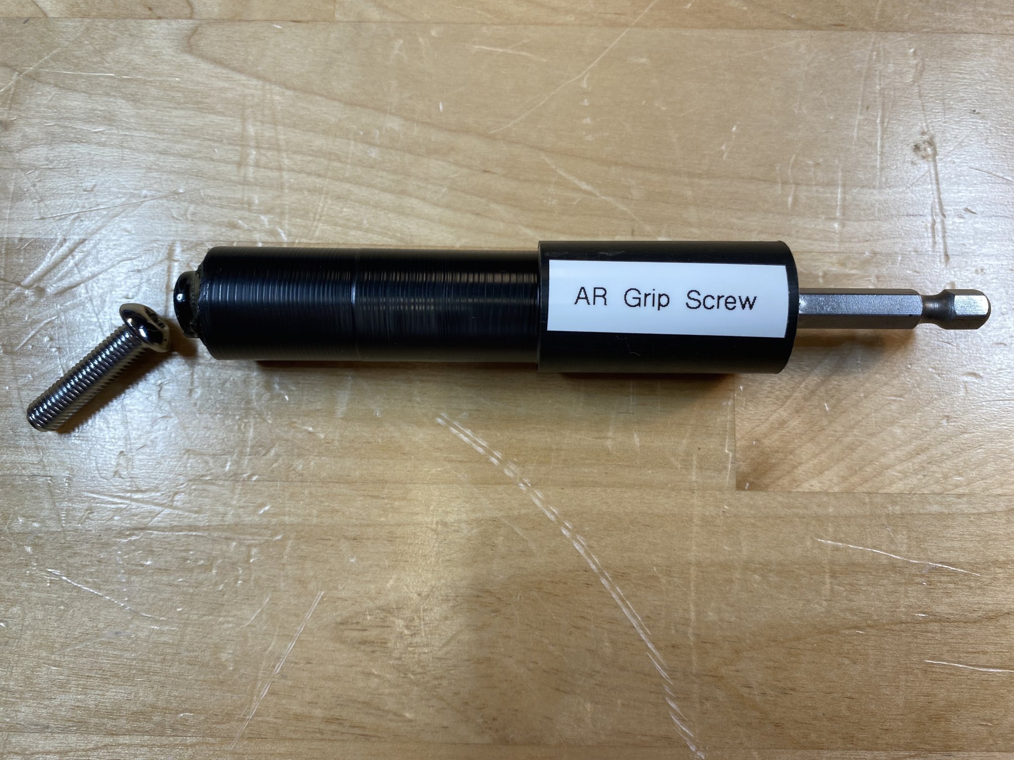

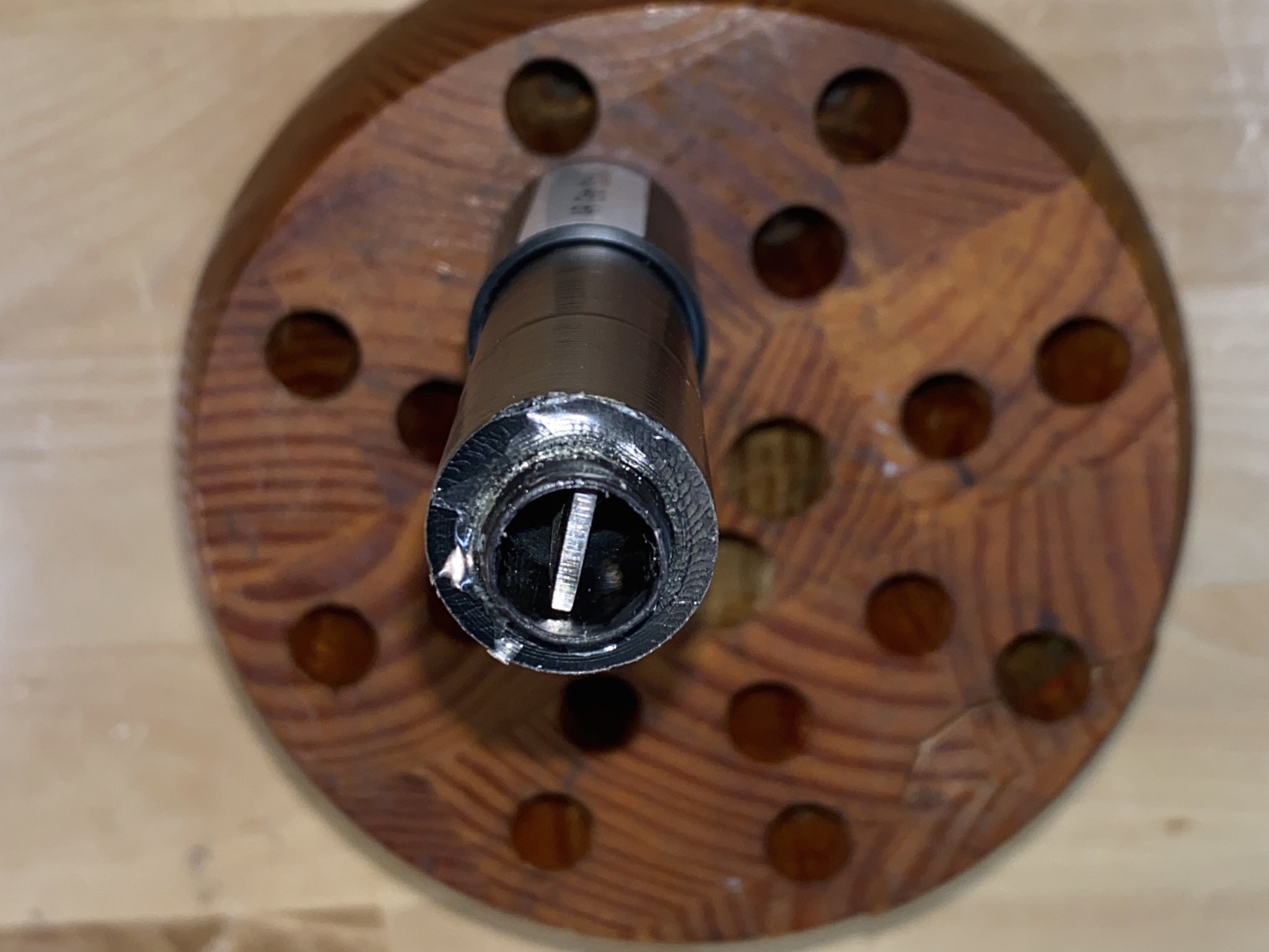

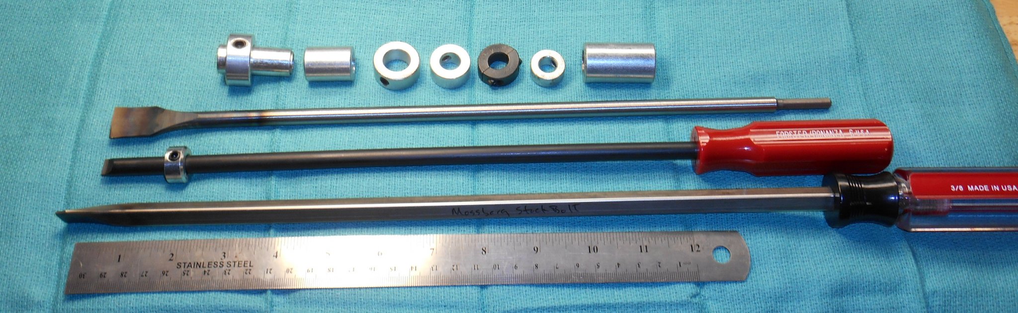

For installation I do use a few tools to hold the slotted fasteners as well as either a hex / torx fastener as keep the fastener
fairly well centered to decrease the chance of cross threading the fastener. The Delrin slotted adapter has rubber fastener head retainer to keep it from falling off during the proces. The Wiha too is pretty good but the magazine well is pretty narrow down deep which only allows a few turns of engagement before you have to release it from the tool.

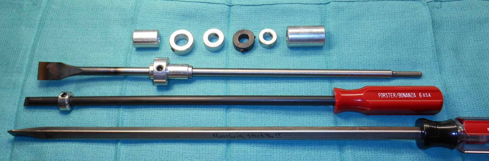

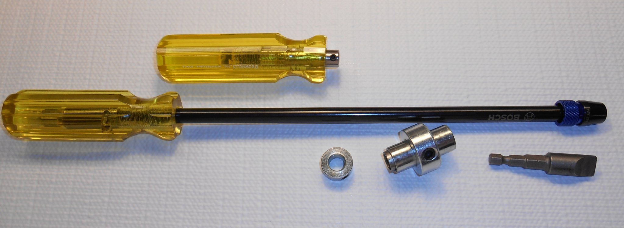

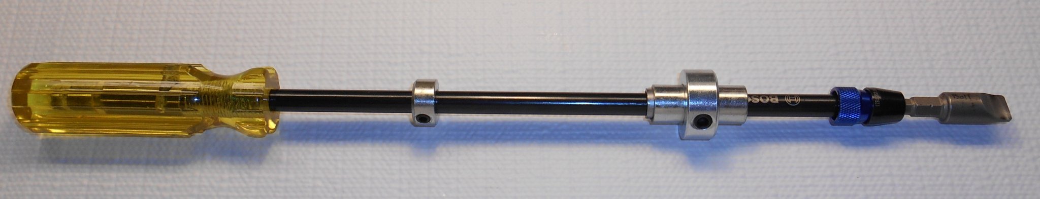

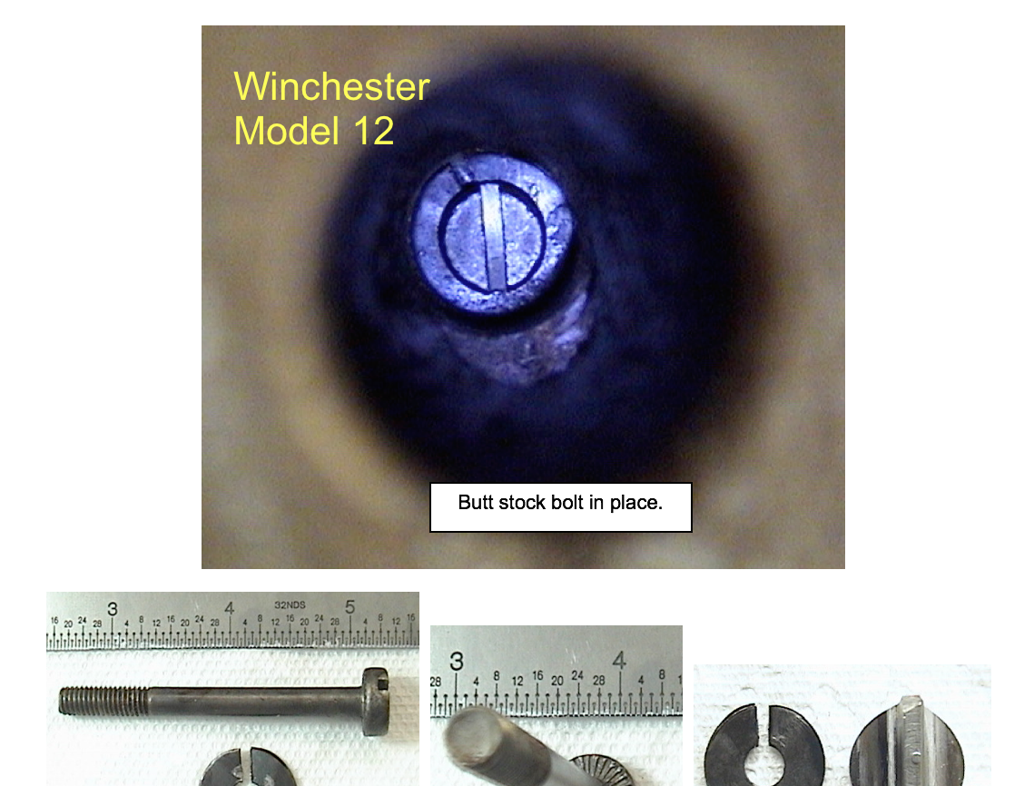

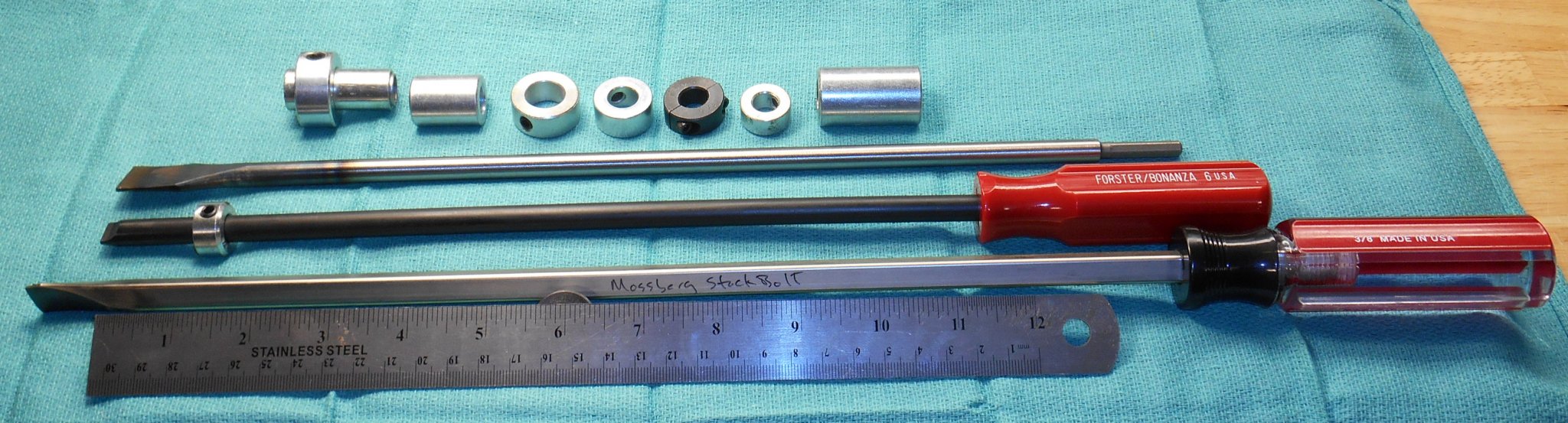

^^^ I am generally risk averse when it comes to screwing up (pun intended) simple gunsmith projects. Which is why I use those centering tools, a lot less commotion then cross-threading a fitting. Same situation with shotgun wood butt stock retaining bolts that can break thru a beautiful gun stock if the slotted screwdriver is not seen / set into the bolt slot. Old gunsmiths used to wrap tap about the shaft of their favorite butt stock screwdrivers to center the driver shaft to avoid that situation. I fabricated an entire system of stock bolt centering drivers with variable diameter fittings to keep me out of trouble disassembling / assembling expensive gun art.
