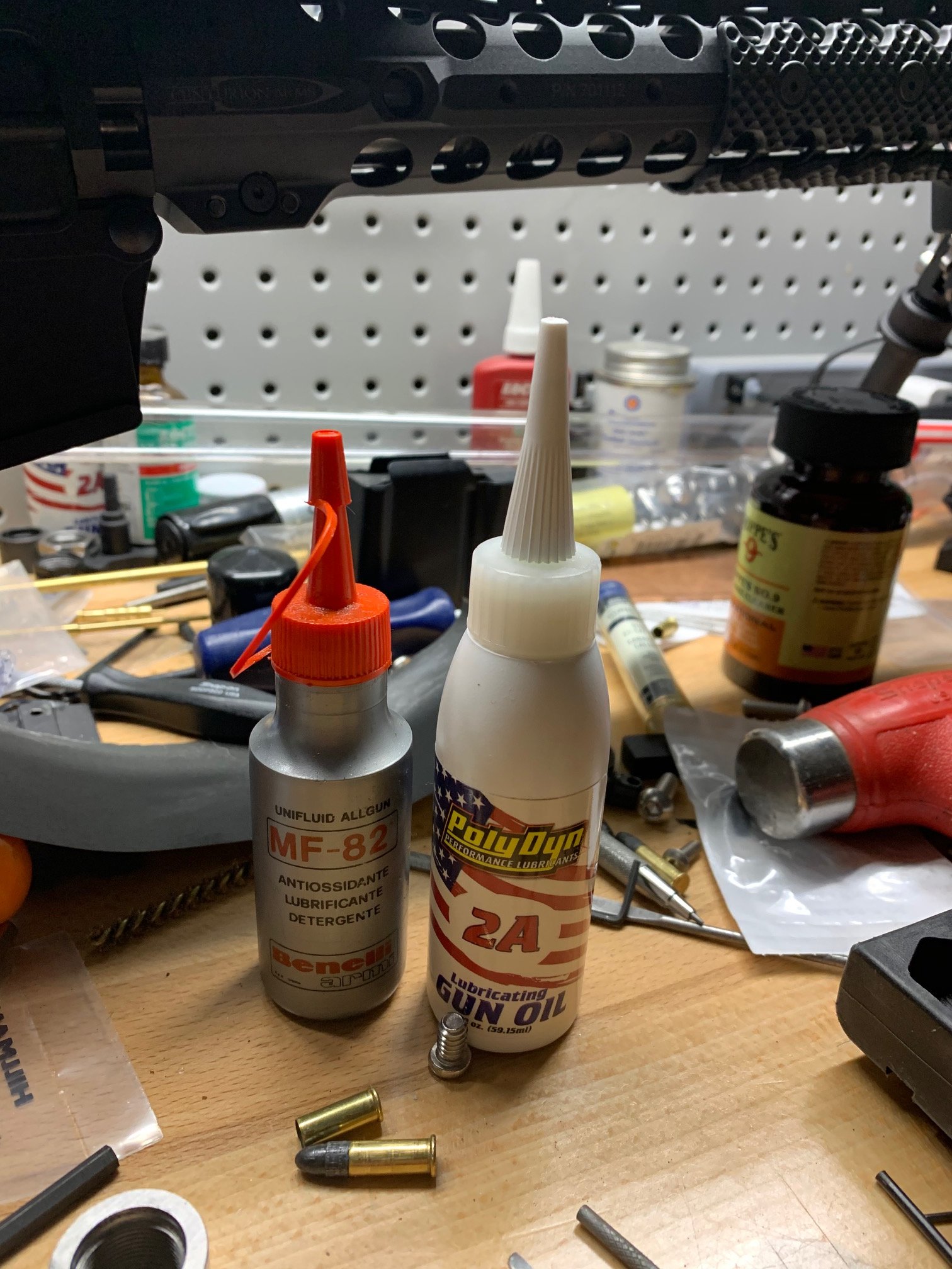

I used to use Benelli MF-82 on AR's. It was obviously intended for inertia shotguns but is light weight and worked perfect on my AR's. Unfortunately it only ships with Benelli shotguns & is not available in the US.
When I started getting low I went hunting for the best replacement. I tried a few and Hoppe's Elite Black is my second favorite.
My favorite hands down by far & the best damn gun oil no one's ever heard of is Polydyn 2A. It is a polymer based lubricant (not CLP).
Polydyn is a Veteran owned company & it's 100% American made in Houston TX.
While searching for the best Gun lubes I remembered Polydyn and thought well hell I wish they made one. I was very happy to find out they do.
They absolutely suck at marketing it though.
I have been running it for a while now on AR's, bolt guns, & pistol slides. It has not disappointed.
