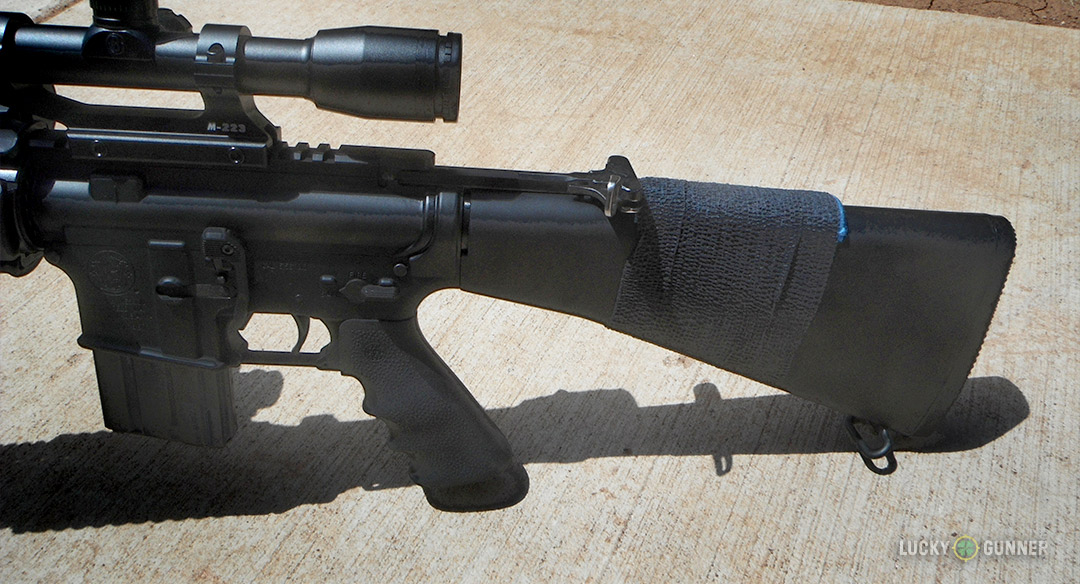

    A picture is worth a thousand words.........

    I found 3m rubber sticky pads on amazon for $5 that were 1/8" thick. I stuck two of them together, cut to shape and slapped them on the stock. I don't know what kind of mess it's going to make when I try to get them off, but they seam sticky enough that I'm not worry about them falling off and they're the perfect height for me.
    Slick enough not to pull at the beard either.

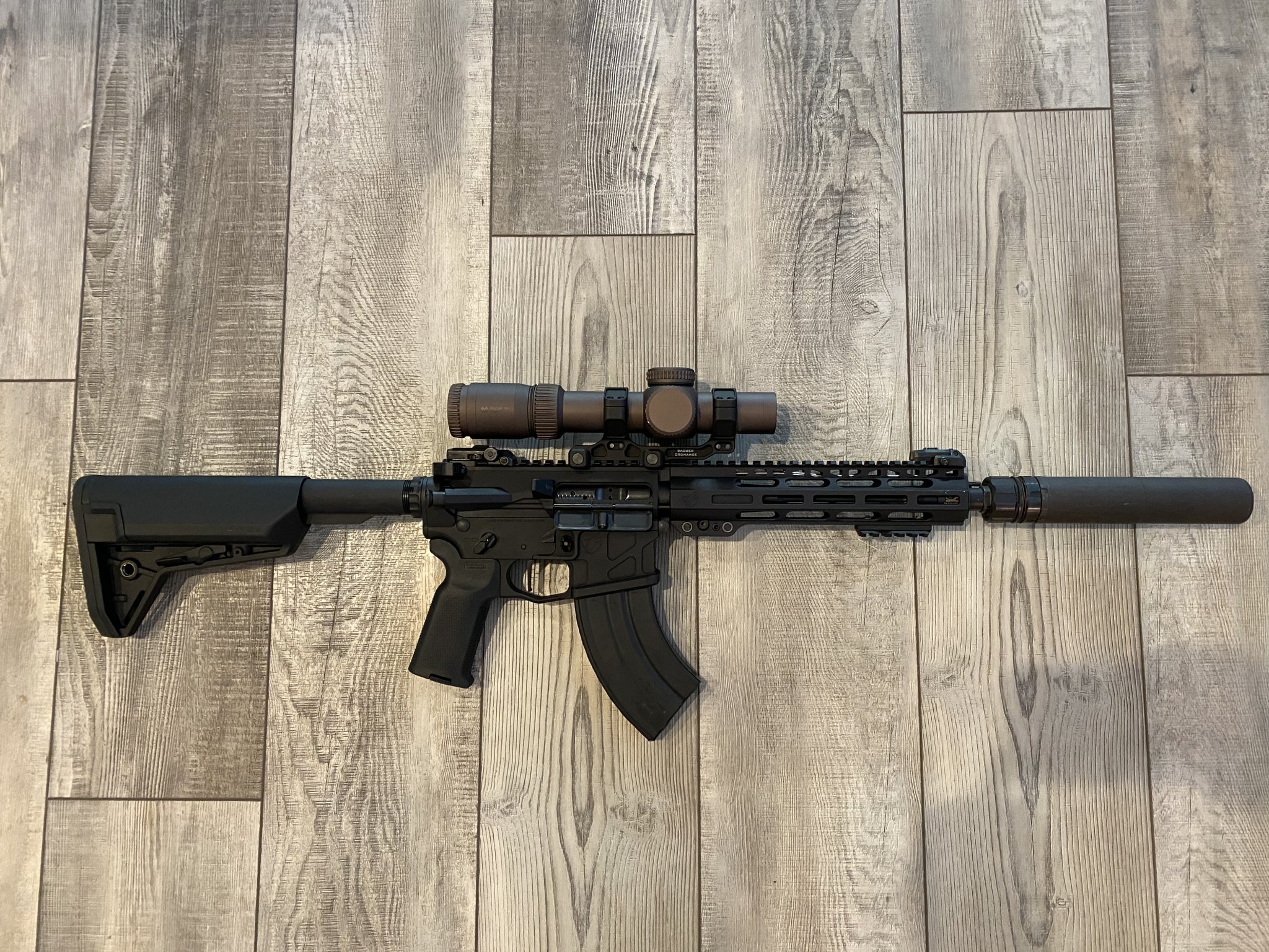

    Yeah, my guns are set up as below- at least as far as scope position is concerned. For optimum length of pull first, then for eye relief. The scope sits where the scope sits. I’ve never had an issue with the charging handle, though I do have the benefit of being right handed. A BCM gunfighter with medium latch, or even better the BCM 3x3 ambi latch, makes charging from one side easy. As for neck, I give ET a run for his money...
    What stock are you running on this fine weapon?
    It’s the factory stock from a Ruger precision rifle. I really didn’t like it and replaced it with a Magpul PRs on my RPR. But, waste not, want not, I threw it in a drawer. Being cheap, and having found a solution for my major gripe (razor sharp edges on the bottom-resolved with a 3D printed bag rider I found in the giant RPR thread), I put it on this new ar build. The jury is still out on whether it gets replaced with a PRS. But, the price was right so what the hell.
