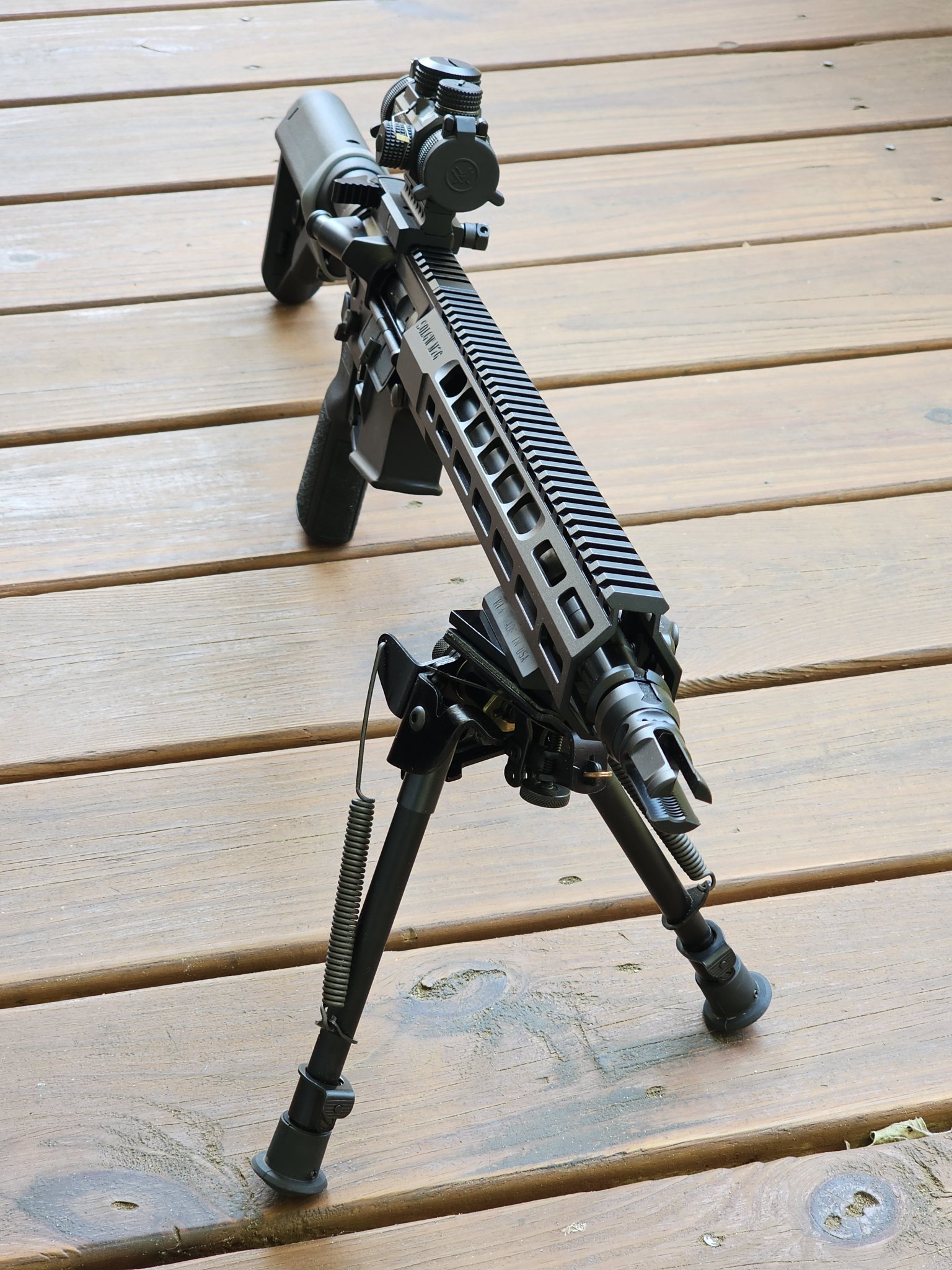

A little off-topic fellas but, I ordered a Harris Bipod M-Lok Rotating Adapter & I really like it. The Harris Bipod I have already swivels & this Rotating Adapter is awesome...

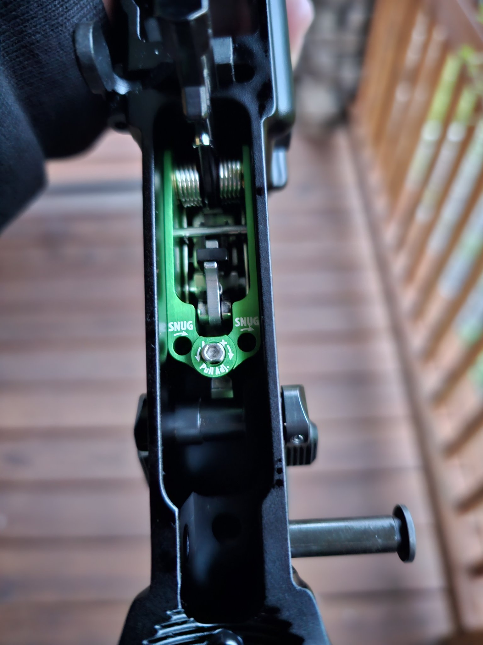

Here's a MBT2S that I changed springs. Had to remove pin and peen back in place.
