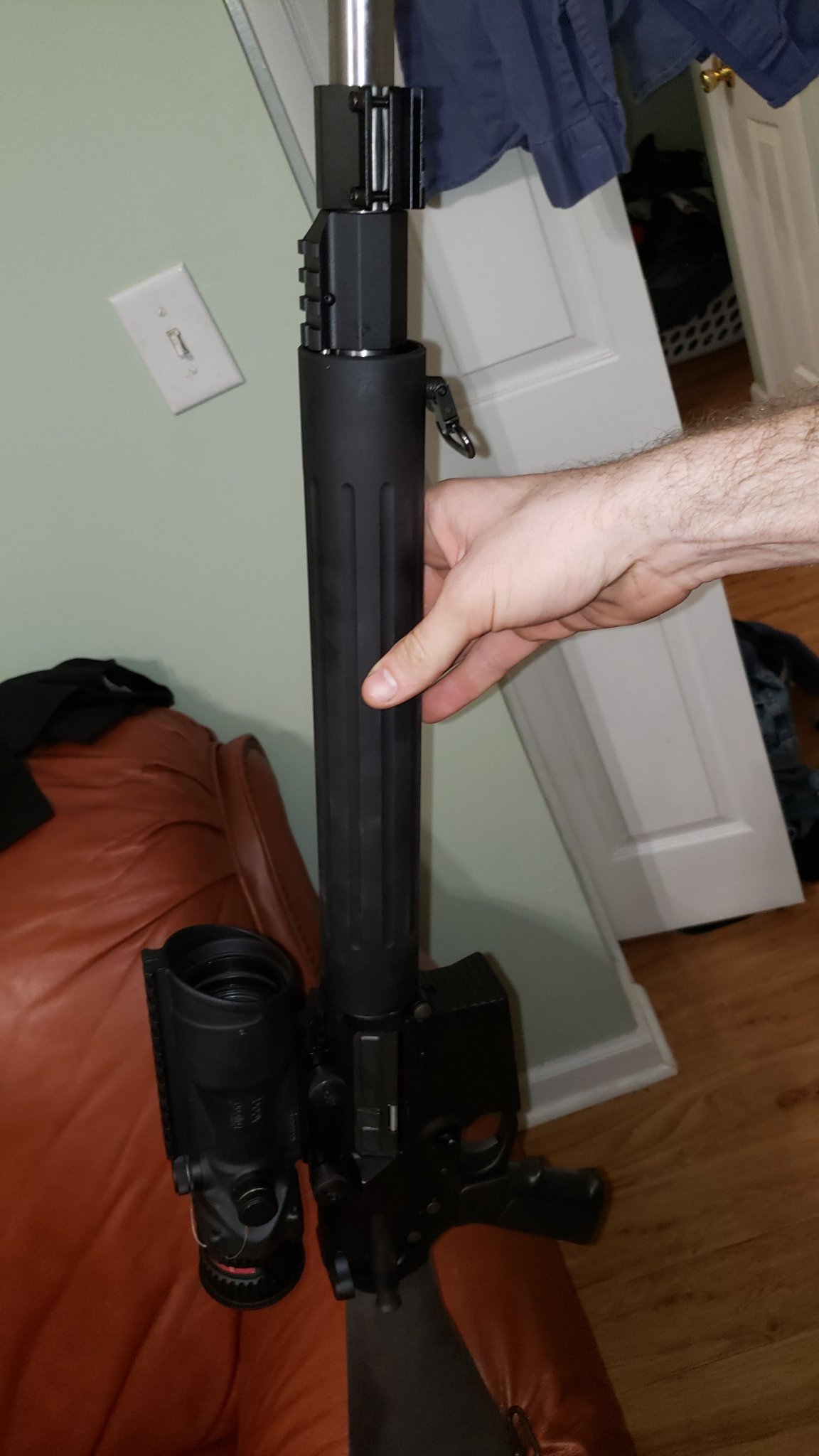

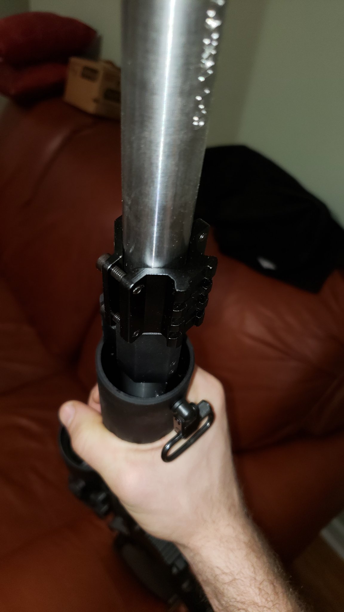

I'm looking to mount an Atlas BT46-LW17 bipod on a DPMS G2 Bull. It has a free floating aluminum tube handgaurd, 0.920 stainless bull barrel. The barrel clamp rail would be simplest, but I've heard possible accuracy issues with thermal expansion may occur. Pics attached show the clamp rail installed - it's the double vee style. Any thoughts would be appreciated.

I wouldn’t want a bipod attached to a free floated barrel. It would be too easy to cause poi shift simply by loading the bipod. I would look toward mounting the pic rail to the bottom of the hand guard in some fashion.

Good to know. Any thoughts on handgaurd mounting, maybe an adjustable gas block with a lower rail, or drill and tap the hand guard for an adapter?

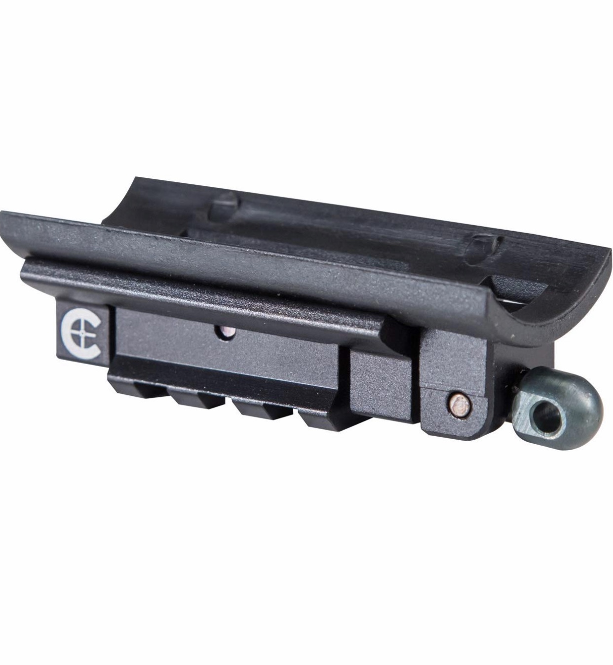

You can run something the Caldwell sling swivel -pic rail adaptor on your present hand guard, assuming that’s a conventional sling swivel stud in your first pic.
I definitely would not attach anything to the barrel itself for obvious reasons.
Here is what the adapter looks like; they’re available non Amazon
Thanks for all the help! The Accu-Shot BT15 rail adapter contoured nicely to the handguard tube. I drilled and tapped for one more 8-32 screw and it bolted right up. I'll probably change the handguard tube soon, but I'm having trouble finding an Mlok tube to accommodate the 0.936 adjustable gas block. Samson has a Keymod tube, and SLR has an Mlok that may just fit.

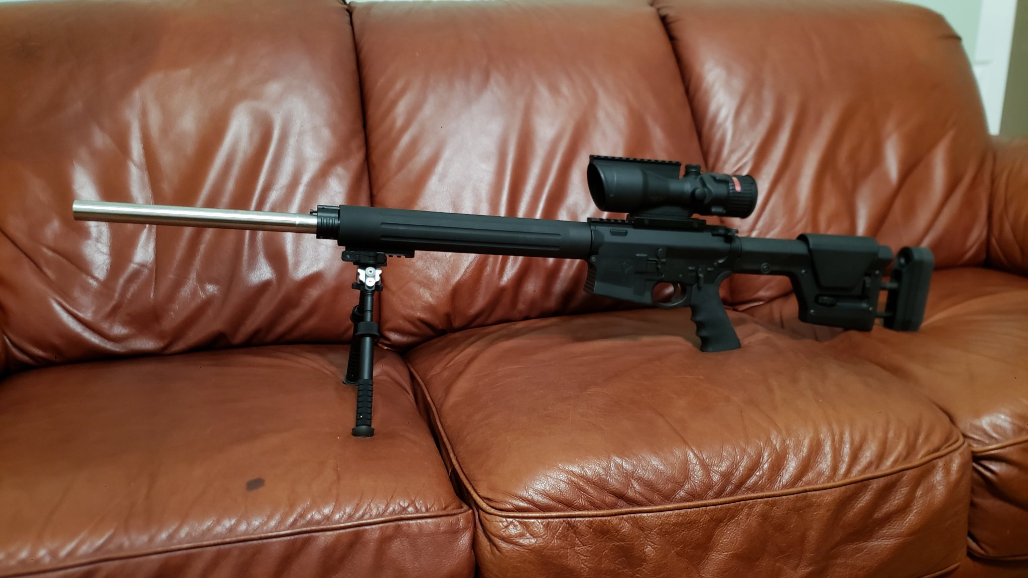

Installed a 10 oz. heavy buffer, Hogue grip, Magpul PRS stock and SLR Sentry gas block. (Sorting through long range scopes right now; the ACOG is temporary) Here's where it's at right now->

I realize this is an old thread, but hows the BT46 treating you? I just put together an AR10 and I'm wondering if that's the way I want to go or if I'd be better off with the 7-13" version. I mostly use 20 round mags for what its worth.
Young buck it's worked very well for me. Feet do rotate, simple ball detent locks on the feet. Very precise, definitely on the light side. I shoot prone for the most part, so that rail adapter and mount bring the 25 round PMAG around 1.5" off the ground at the 7 inch position when shooting flat. I'm 165, though, so that puts me closer to the dirt. The minimum position of 7 on the BT47 would most likely work if you're shooting flat to upwards, but I find the height range on this one to be right in the middle for flat shooting, with 2 inches above and below for differently inclined shots.
