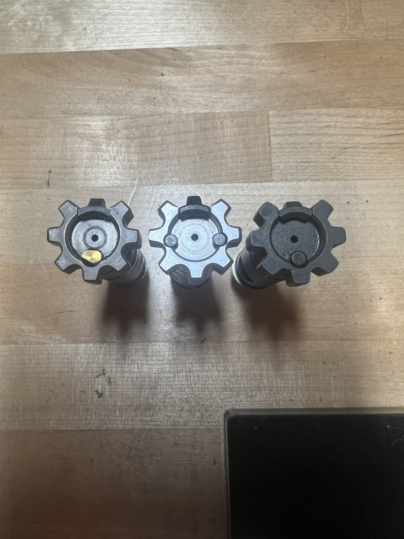

The two on the left are LMT and the right is an Armalite. I had constant swipes with the single ejector Lmt. I believe it is because the ejector has such a large diameter and it ends up under so much of the case. Swapped to the double ejector and they’re gone with all but the hottest of loads. Even some that I ran too hot and popped primers on only give a slightly shiny smear, no edges or burrs. I believe the smaller diameter and more outboard position helps greatly. They’re mostly under the rim. The Armalite bolt is the middle ground and I have never had any real gripes with that design. If I had smears, it was too hot anyway.
All of these run the .068” or whatever the original(small) firing pin diameter is. I’ve never had cratering issues.
Reactions: RldrNewby

The bolt with the dual ejectors in that pic is a really interesting design. I kind-of like it. Almost looks like each ejector is partially rebated into an area of the bolt where the case doesn’t even make contact, which would reduce the surface are of the case that gets exposed to forces great enough to allow brass flow. My DPMS Gen2 7.62x51 OEM proprietary bolt has dual ejectors, but they are much nearer to each other, & not recessed into the bolt face, & just as prone to swipes as the single ejector types.

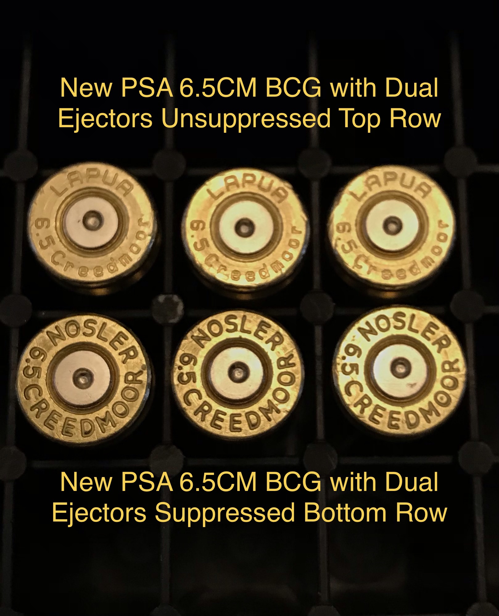

Update:

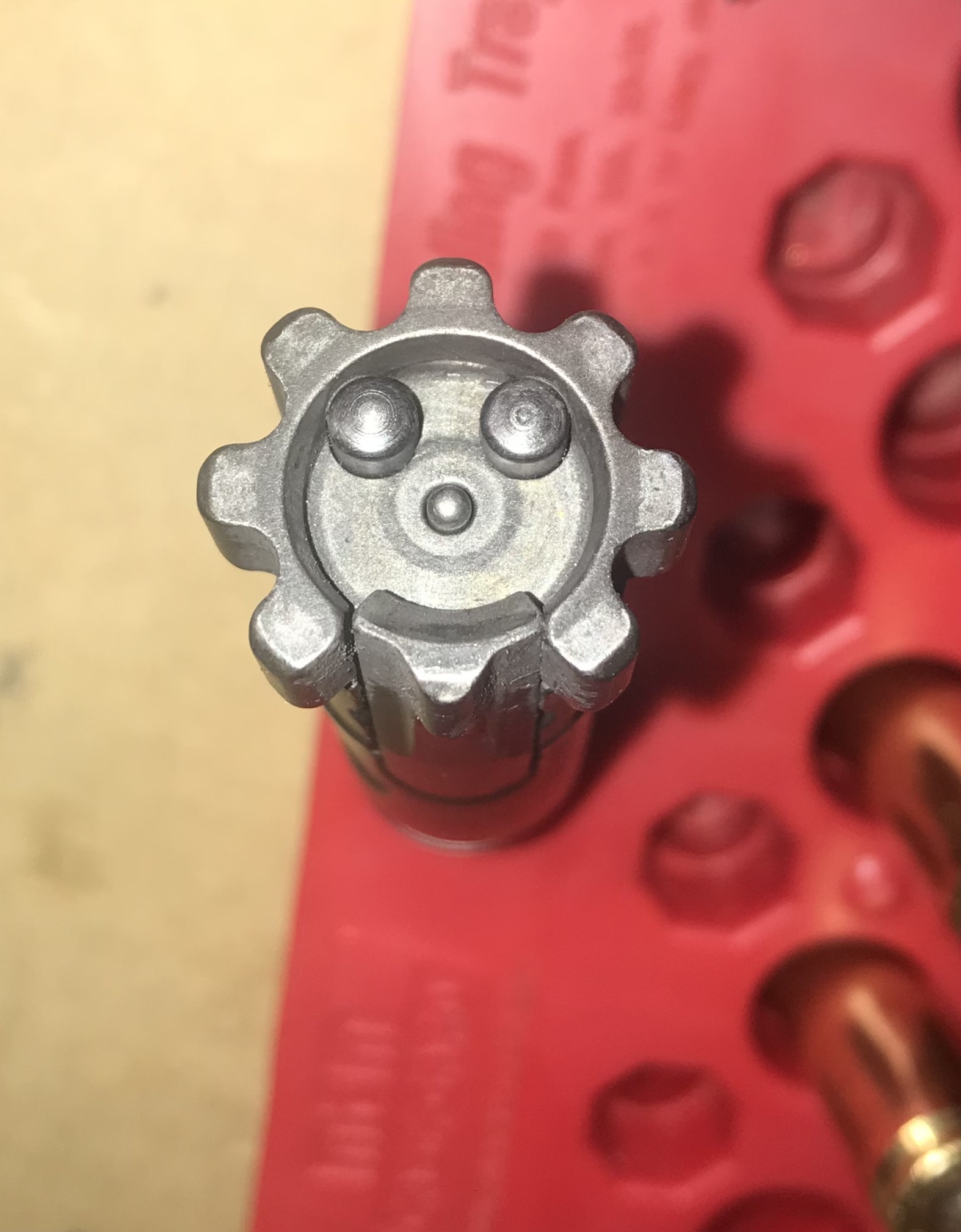

Issue seems to be fixed now on the Aero 6.5CM build. Ordered a Palmetto State Armory 6.5CM Small Pin BCG with Dual Ejectors partially rebated into the portion of the bolt face that doesn’t contact the case head. Was able to run a quick test using Lapua Brass un-suppressed, which was previously in the worst shape of all brass un-suppressed. In all fairness, the Lapua load was slightly hotter than the Nosler load, by about 25-30fps. I also shot a few Nosler Brass, with the suppressor on, which previously gave me burrs on occasion. The new BCG made a world of difference for the better on both brass makes. All the preliminary measurements I had taken of the new bolt were the same, to within a couple thou, as the Aero OEM BCG, so I don’t believe the smears & glinting were a headspace issue. Thinking maybe it was more of a difference in the bolt face & ejector design? Who knows. Workin fine now, & I’m happy with it.
The pic below is how the PSA’s Dual Ejector design is layed out.
