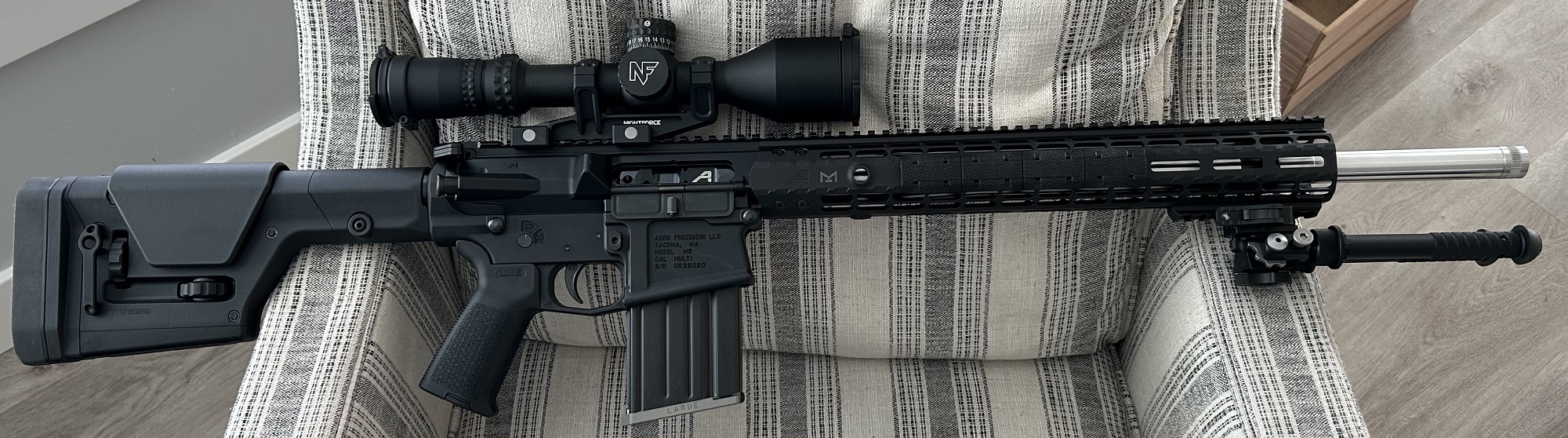

I recently purchased a 'used' Aero AR10, built by Compass Lake. Looking at the barrel through the borescope leads me to believe the gun was only fired by CLE after assembly. The rifle was built in 2019, 1 of 3 for a single customer. The rifle is a joy to shoot. I've only 82 rounds through it, just starting load development. The basic specs are:
Aero enhanced upper
Aero lower
Aero black nitride BCG
20" Kreiger 10-twist barrel, .875" gas block journal
M118LR chamber
Adj gas block (I installed this)
PRS stock
VG6 Gamma muzzle brake (I installed this)
Geissele NM trigger, with light match springs
I've acquired 3 new LaRue magazines for the rifle but am having an issue with all of them. The 2nd to last round will not feed from the magazine, the bolt normally skips over the top of it or pushes it forward 3/4" then jumps over the case rim and jams into the body.
Is there a standard for the magazine feed lip spread or how much of the magazine should extend above the lower receiver?
I'm shooting reloads with COAL of 2.800". The feeding issue happens while; shooting from a loaded magazine, loading 2 rounds in the magazines and pulling back the charging handle or releasing the bolt, or slowly closing the action with the charging handle. Any guidance on determining root cause will be GREATLY appreciated.

I put a magazine in the rifle with a couple empty casings, like pictured above. When slowly closing the bolt there's definitely less than .010" of contact with the case rim on the right side, 2nd from empty. When doing the same with the last round in the mag there's more than double that.
I think I'll order some sample mags from ASC and Duramag, these appear to allow the longest COAL. In the meantime I may try and tweak the feed lips on the Larue mags.

With the magazine inserted there's roughly an additional .010-.015" that I can push it upward before the mag catch bottoms out in the slot.
Tightening/loosening the mag catch hasn't made a difference as it already positively locks in the mag slot. The mag catch is flush with the top of the hole in the frame, it can't move up any highter.

I received 2 ASC and 2 Duramag magazines. The Duramags position the rounds much higher so there's .020-.030" of contact between the bolt lug and the case rim. Hopefully these will function fine. The ASC mags don't allow an empty case to sit flush against the feed lips, these will never feed a round so they're being returned.
I called Larue about their magazines and they said their M110 pattern lower is different than my AR10 pattern Aero lower. Will the differences actually affect magazines?

Thank you for the reply.
I did order a couple ASC SR25 magazines but the cartridges didn't sit flush against the lips, the casehead was gapping about .020". I looked around and couldn't find any KAC magazines anywhere. I put another 50 rounds through the rifle today without issue using the Duramag magazines.
