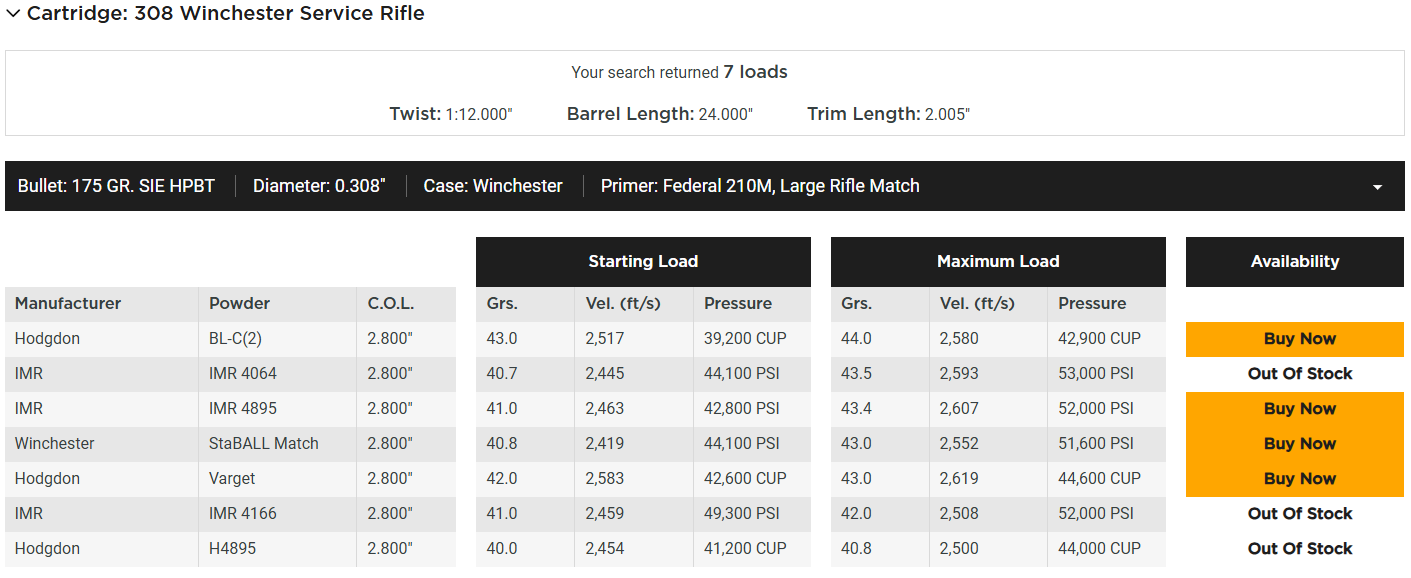

I'll paste in some of the Hodgdon web site data for a 175 grain load and you will see the list of other powders for the Service Rifle as well as the bolt guns.
You can see that the Varget should have shown you something in the neighborhood of 42 to 43. I would tell you to try H4895, but you cannot find that these days and I honestly don't think the odds are it will solve your issues based on what we know now.

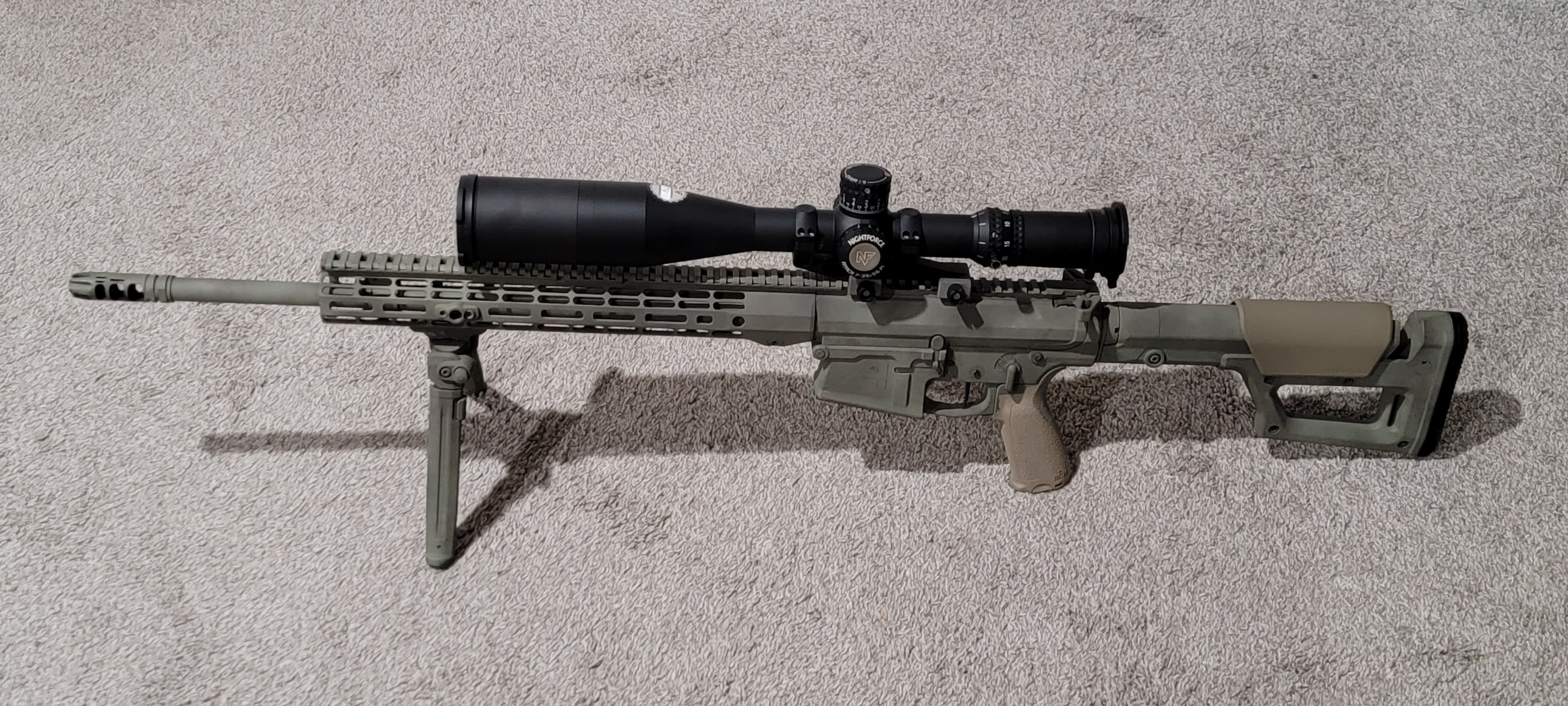

I guess I missed a bit in my post trying to give all info.. yes it is 308.. This is a brand new build and thus far we have only shot that bullet out of it.. I had started with it because of the BC and wanting to try long range with it.. If you have another suggestion on bullets I am all ears.. We did try factory load for Horniday ELD-M 178gr rounds.. the results were not good.. you mention a FGMM factory loaded bullet. what is that one?

Original poster's rifle photo shows it on a bipod. Take that off and build your most solid, consistent firing position off sandbags (fore-and-aft).

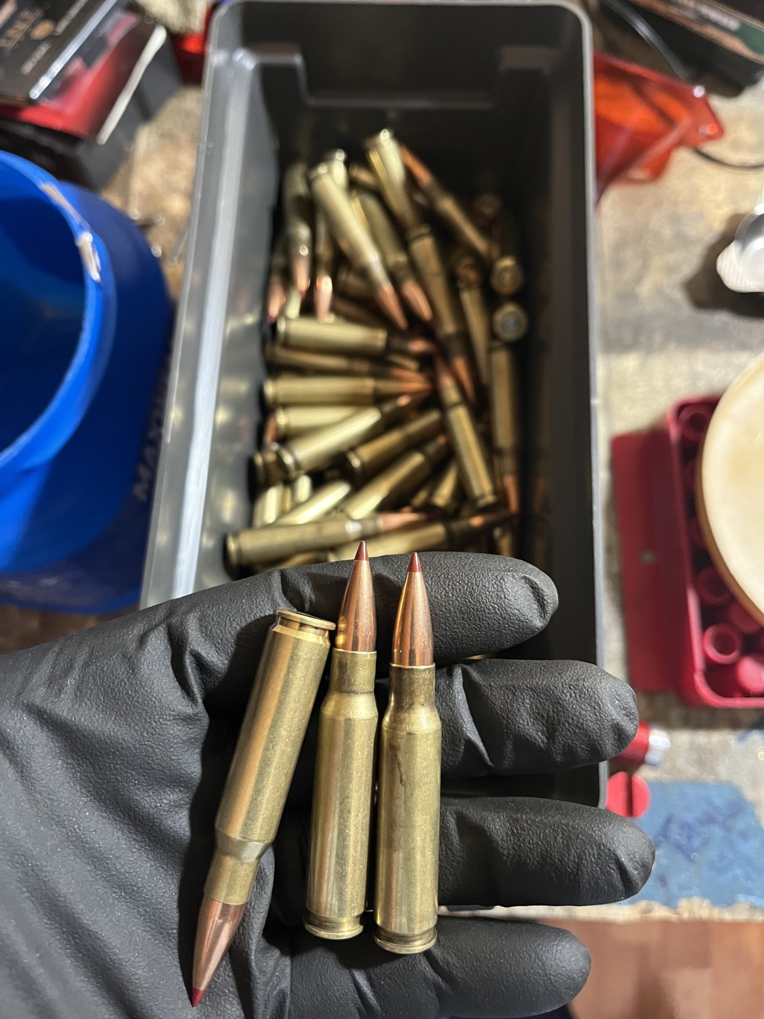

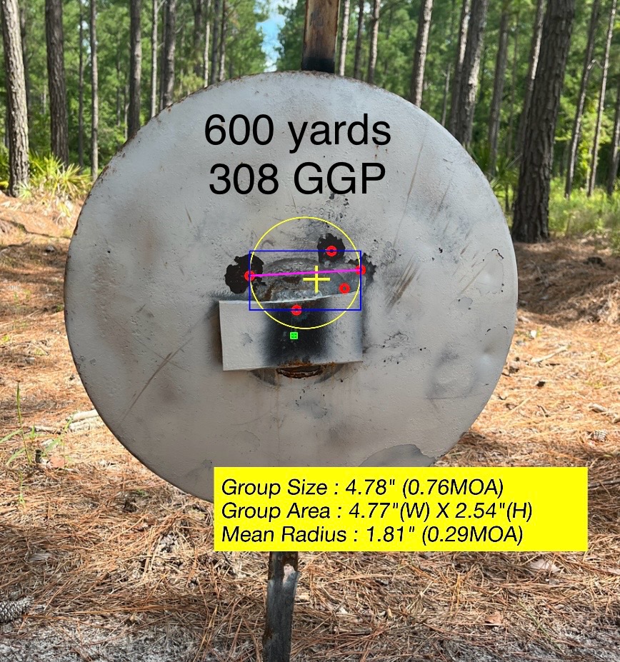

My best load with the 178eldm was just under MOA with 41ish grains of Shooters World precision. I ended up with much better performance with 168eldm. Sub 3/4MOA with 43.6gr SW precision. 168 SMKs were the best. 1/2MOA but they fall apart at 700yds.
I've had great luck with A2495 with the 168s as well. It's a similar burn rate to H4895, but it's actually on shelves.
This load is
FGMM brass
40.5 gr TAC (work up to 42 in other brass)
178 Eldm
2.800 oal
Cci 200 or White River primers
You can substitute in 175 smk for the same load if your rifle is jump sensitive with eldm’s (mine have not been). Also Speer 180 BTSP are also stupid accurate and cheap with that same load. My proof cf 16” barrel will shoot it .5 moa.
I carry this rifle to 900 very often and it’s always the same. TAC is more temp sensitive and usually higher SD’s than varget but it’s accurate, cheaper, and easy to load. Give it a try

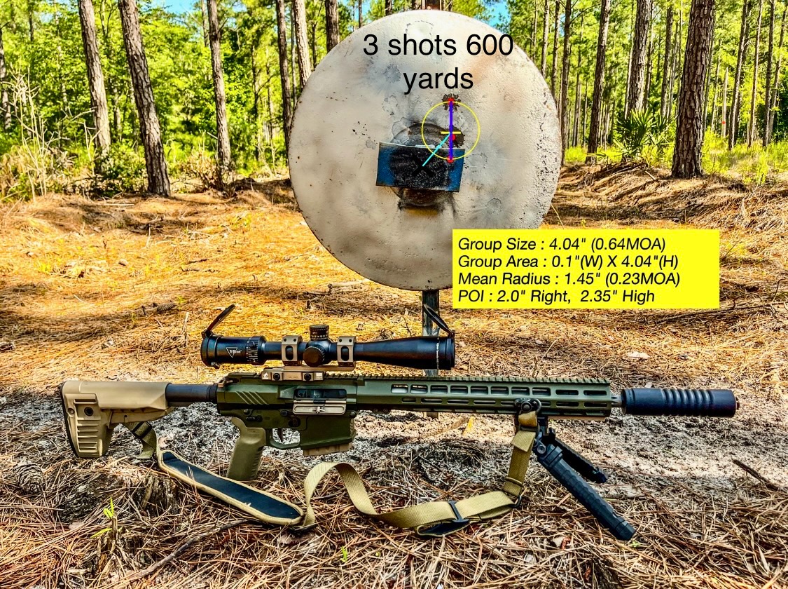

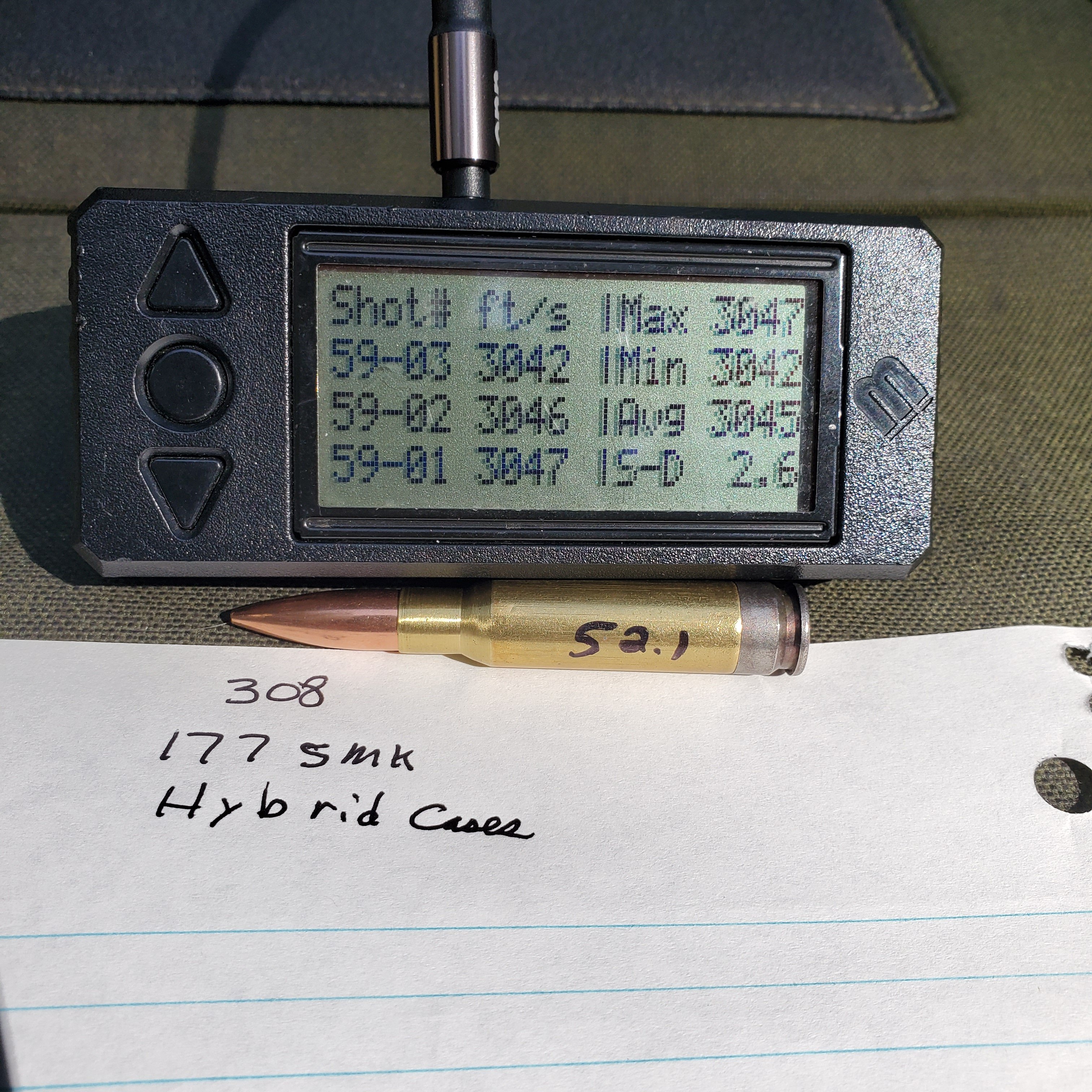

Power Pro 2000MR is my favorite 308 powder
I like 2000 MR in 308 auros and bolts but when hybrid cases are employed, bolt guns only, RL 17 with new 177 gr .545 BC gave me 3045 fps average velocity in a 22" barreled Rem 700 bolt gun 9 twist.
And 3126 fps for 177 SMK in the long barreled 308, for flat trajectory and 3800 ft- lbs of muzzle energy.

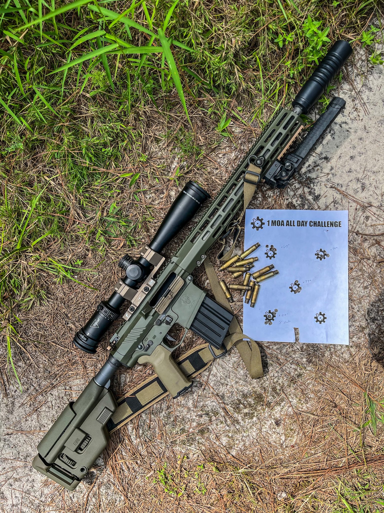

it just would not allign properly.. it would get close ish.. but never quite right.. the new optic is mounted.. will be trying it out thurs. morning.. replaced the cheap Primary Arms FFP with a NightForce FFP.. can already see a huge difference just in parallax adjustment.. let alone the rest of the optic.. so I am hopeful!
I have never been able to get either 178 bthp or ELD to shoot well in both 308s I have. That's just me though, I will echo other recommendations to stick with Sierra or Berger.
