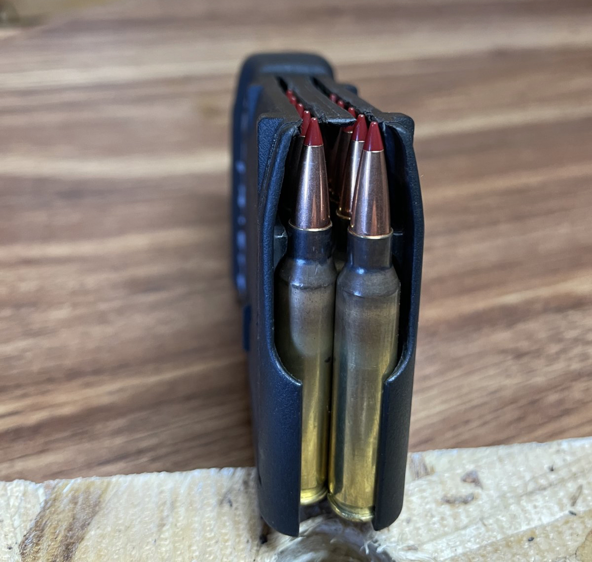

Hodgdon's load data lists 2.400" as the OAL, far greater than the AR mag length 2.260". So you'd have to single load in an AR or run it in a bolt gun.
I'd be interested to see how much velocity you could get from it in a bolt gun.

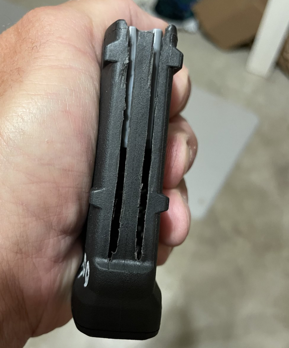

I loaded it into AR mags, no problem. I will have full review of it up in a few weeks. I loaded them at 2.300, which, at the case neck, the bullet was .221 in diameter. so its "barely" an issue. I did not crimp. AR mags are 2.380 wide. Polymer mags are 60k thick walls, thus 120k - 2.380 = 2.260. Stainless Steel mags can be made "thinner" because its far more rigid. So some steel mags have walls that are 40k thick, thus you can load mag at 2.300 right on the dot. People told me that some brand had thinner walls than that, and you could load to 2.320, so I bought some to see.
I can tell you right now, they shoot just fine at 2.300. I was also thinking about grinding down the tips 2 grains, to make them 60 grain bullets to give me another 20k or so, which would have been ideal perhaps. Ill see if that impacts accuracy whatsoever. You could also, go down to the minimum spec on the brass which is 2.230. That will give you another 20k as well (for contact on neck with no gap). So if these mags actually are 2.320, I will definitely prep the brass to 2.230 and that will be near ideal.
I think that full contact is at 2.350 or so, close.

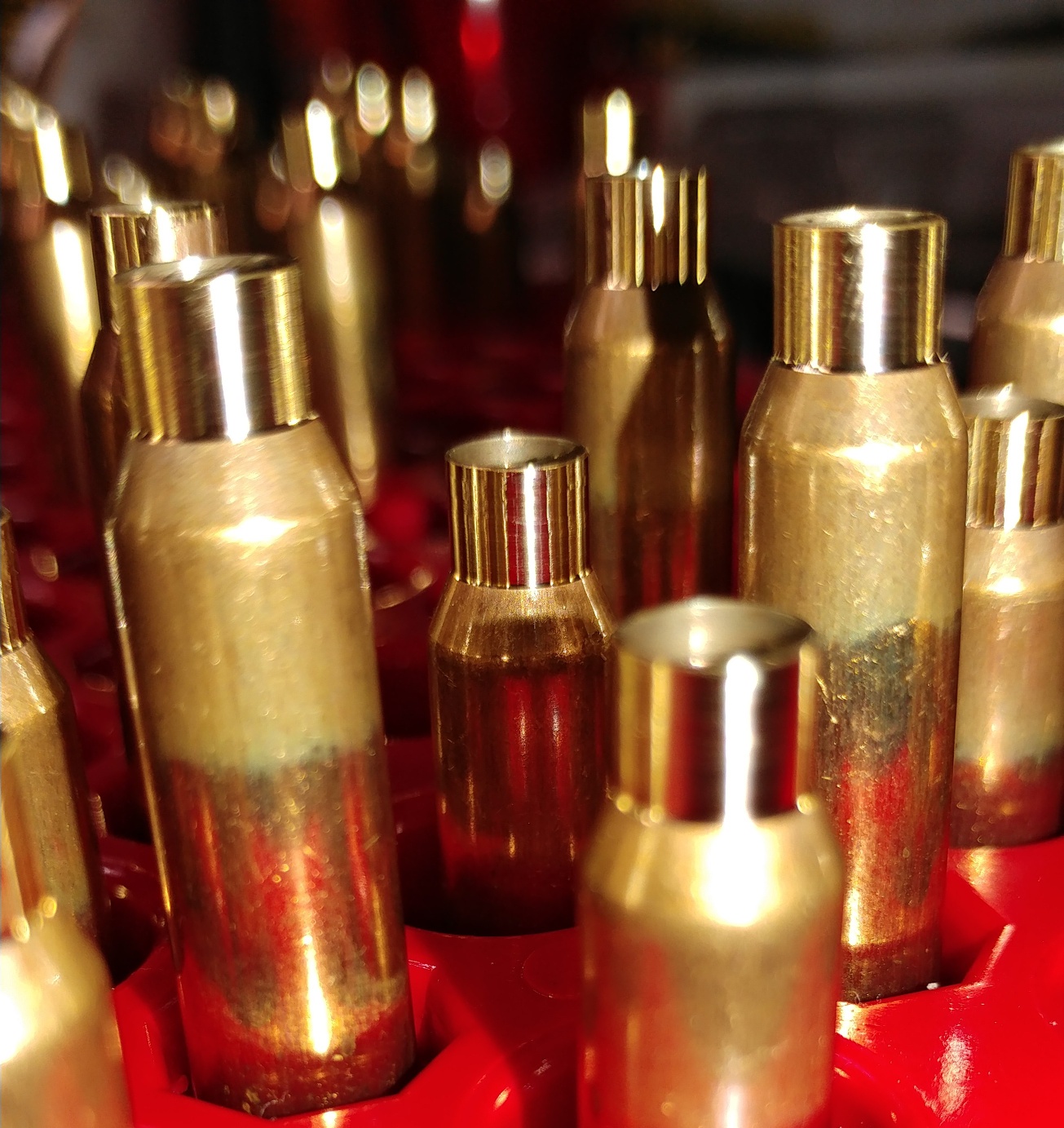

I loaded them into nicely prepped brass.
