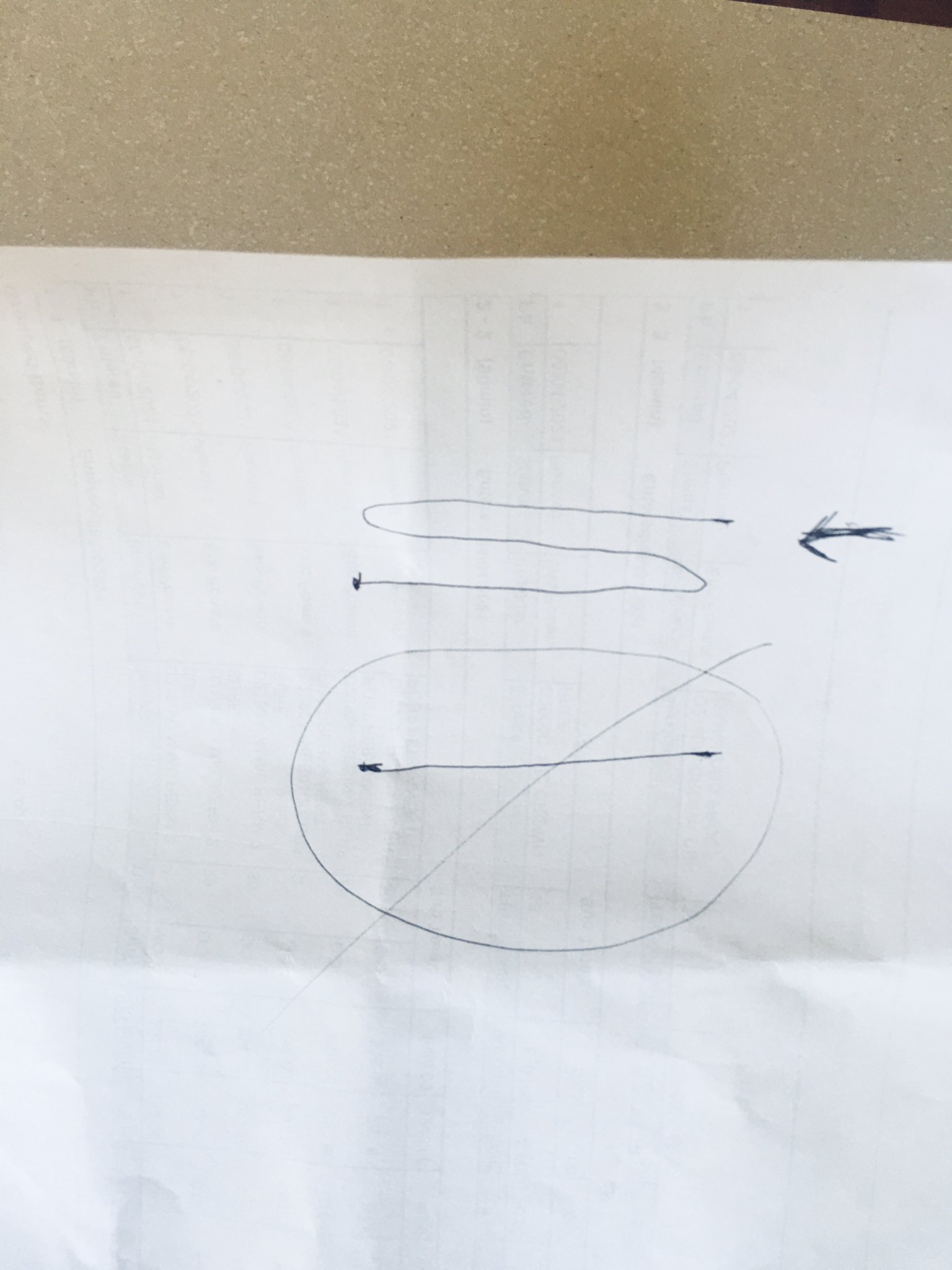

    what would happen if you double the length of the gas tube only?
    I’ve included a very quick sketch so it’s perfectly clear what I’m talking about...
    Will this work and delaying the unlock time so that the powder can all be burnt before your BCG attempts to extract the case and you get maximum charge without destroying your case.

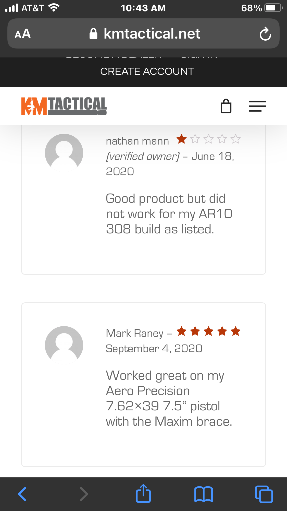

    OK I found what you’re talking about but it looks like it will not be long enough for the plus to gas system on my particular rifle but apparently that’s a better idea you just run a loop around the barrel pretty simple.
    Apparently it worked for one of them

    Those that have ever tried to run an A.R. 10 and have used other than the low pressure NATO caliber knows what I’m talking about.
    I’m talking dwelltime , more importantly delaying unlock.
    I’m not aware of any low pressure NATO caliber the AR-10 has been chambered in.
    7.62x51 NATO certainly isn’t a low pressure cartridge/chambering.
    Gas tube length will have little, if any effect on bolt lock time unless you really increase the volume.
    Port pressure, port diameter, and plug dwell time will have much more effect on bolt lock time.
    Port pressure can be controlled with port location from the chamber, as well as propellant and projectile combinations.
    The powder is already burned within a few inches from the chamber, otherwise gas tubes would be clogged, along with the internal expansion chamber between the bolt and carrier. You would have fiery particles of powder shooting out from the gas vents on the carrier as well. Powder is fully converted in the chamber area for the most part due to volume, pressure, and temperature. The nitrated pulp can’t stay below its flash point under those conditions, so it burns in a tiny fraction of a second before the projectile has even traveled much past the throat.
    If you’re talking about getting the most of the cartridge potential with specific loads, then ELGS with mechanical advantage adjustable gas balanced against reciprocating mass and spring weights are a place to look first.
    Do you have a current rifle that isn’t doing what you want or is this more of a theoretical solution for tweaking the gas system?
