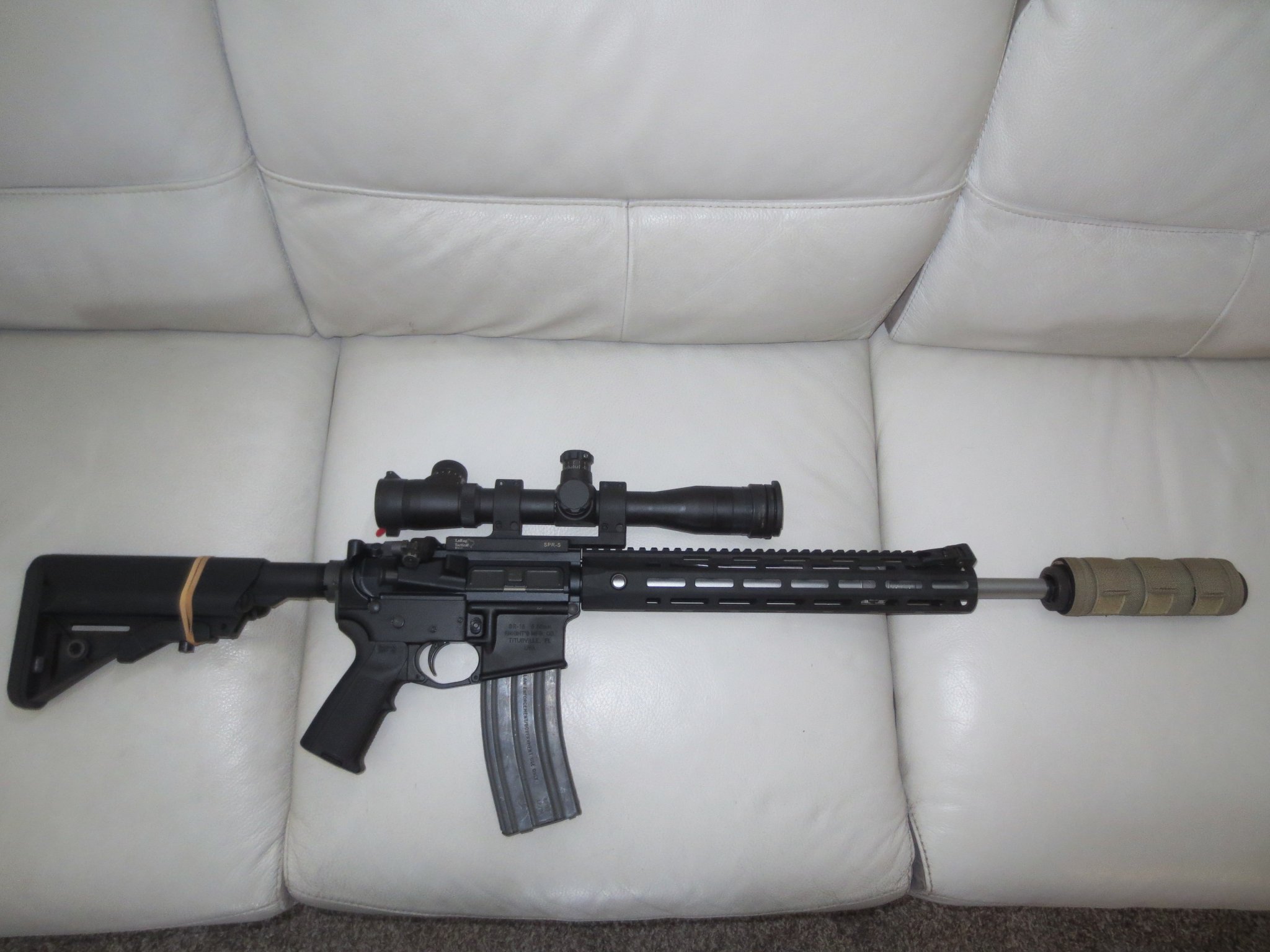

Lilja USN Recce M4 barrel, KAC rifle length FF rail, Geissele SSA-E, Geissele gas block, JP FMOS BCG. Receivers are Noveske I think. It has an ACOG on it now. The JP FMOS may sound like a splurge, but it's the key to reliability in my rifles. They'll work dirty and dry and the bolts are way better than stock ones. Bear in mind many high end barrel mfg.'s use JP bolts now when headspacing new barrels.
I just finished this one. Krieger barrel (this on and the above are both Wylde, above is 1/8, this one is 1/7.7). Same Geissele shit and JP FMOS BCG. URX4 mlok, Mk4 MR/T in a Badger mount. MUR1 upper and KAC lower. All have JP small parts and SOPMOD stocks. Oh, Magpul MIAD grips and trigger guards. Can is a Sico Saker. It has good performance and is a solid, relatively cheap can that locks up well. Lots of options for 'em too. And they don't add a bunch of length either, maybe 4" or so?

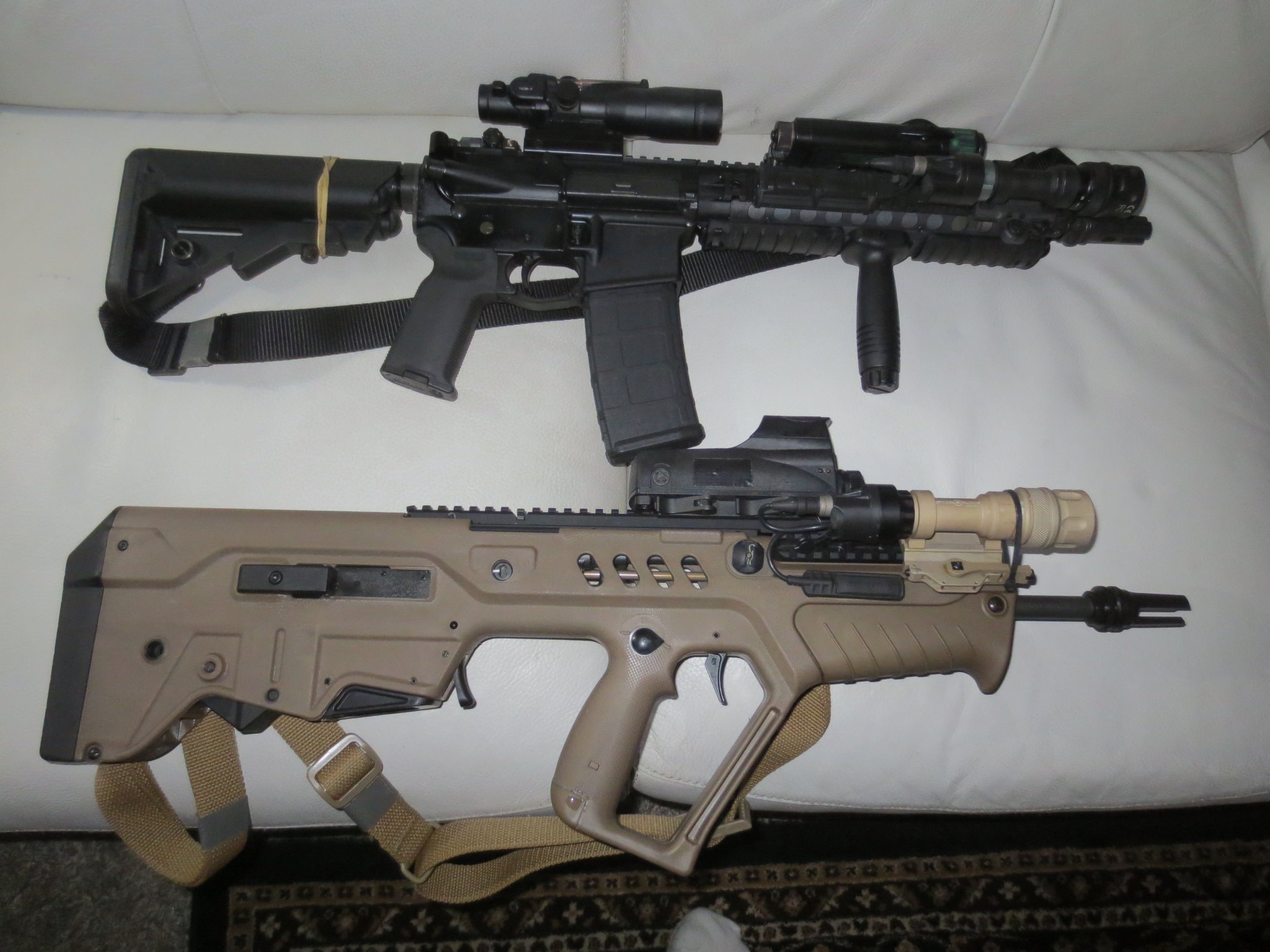

Finally an SBR compared to a Tavor. It's 11.5", the AR. It probably costs as much as the one on top since it uses a lot of the same shit. But that Tavor (this one is 9mm...) is the same length, no tax stamp, superior for CQB and you can take it out to the range and expect about as much from it as you could a milspec M4. You won't be shooting 1000m with any of these rifles, and 600 is a stretch unless you know what you're doing (I'm a former SDM instructor and the guy that wrote the ballistics section for the original courses at Ft. Lewis if that matters). These weapons were designed to work with a 25m/300m zero (or some other equally binary zero that takes advantage of the trajectory of the round for a close and long range zero with a relatively small max. ordinate of around a foot @ ~200m).
Judging by your post I'm sorta doubting you'll be tagging shit at 600, let alone 1k with a carbine, and I kinda doubt you have the appropriate gear and know how to do this properly and come out with something better than store bought. Please don't take this the wrong way, we've all been there.
IMO a Tavor would do all you need and you can score a SAR for probably $1400. Little more for an X95 if you gotta have the new one. Look on Gunbroker and you can probably score one with the trigger upgrade and all for same as MSRP. It's something to consider if HD is an issue and you want something reliable. I really fell in love with it, and my buddy, another infantry vet, actually likes it better than the M4 he toted. That's a LOT coming from him mind you, but I see where he's coming from. It's got a lot going for it. I wouldn't invest in more than a dot for one though, maybe an ACOG or magnifier if you gotta have it.

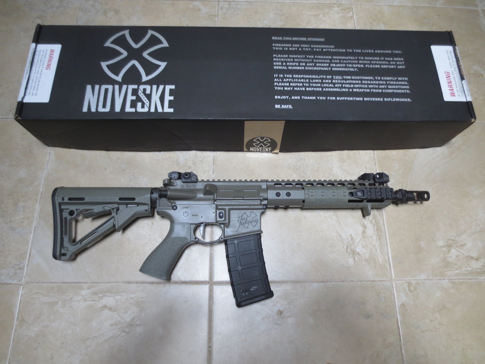

For $1836, you are well within the price range for a Noveske rifle. They probably make the best "plain jane" type AR out there. Rugged, lightweight, accurate, they just get it done. LMT makes a good rifle too. You can also get a KAC upper and put together a stripped KAC lower and have a complete KAC rifle with a higher resale value to boot, same goes with Noveske. Just so you know, your $1836 in parts assembled and sold in the PX here is just another $1k rifle... A complete "factory build" or one that uses all factory parts so as to appear as a factory build will always be worth more unless you find someone wanting that exact rifle --and trusting you built it right.
I really swear by pinned gas blocks. Noveske barrels come with a gas block already pinned on, something to consider. I've seen these others literally blow off the goddamn barrel before in trials. Fuck that noise. Adj.blocks are also something else that can seize up, fuck up or just plain not work right. If it doesn't work with a regular gas block suppressed or not and reliably every time, then something else is fucked up and your gas block is just a band aid. Only adj. block worth a fuck IMO is the Noveske switchblock, it's simple but really, IMO, still unnecessary.
