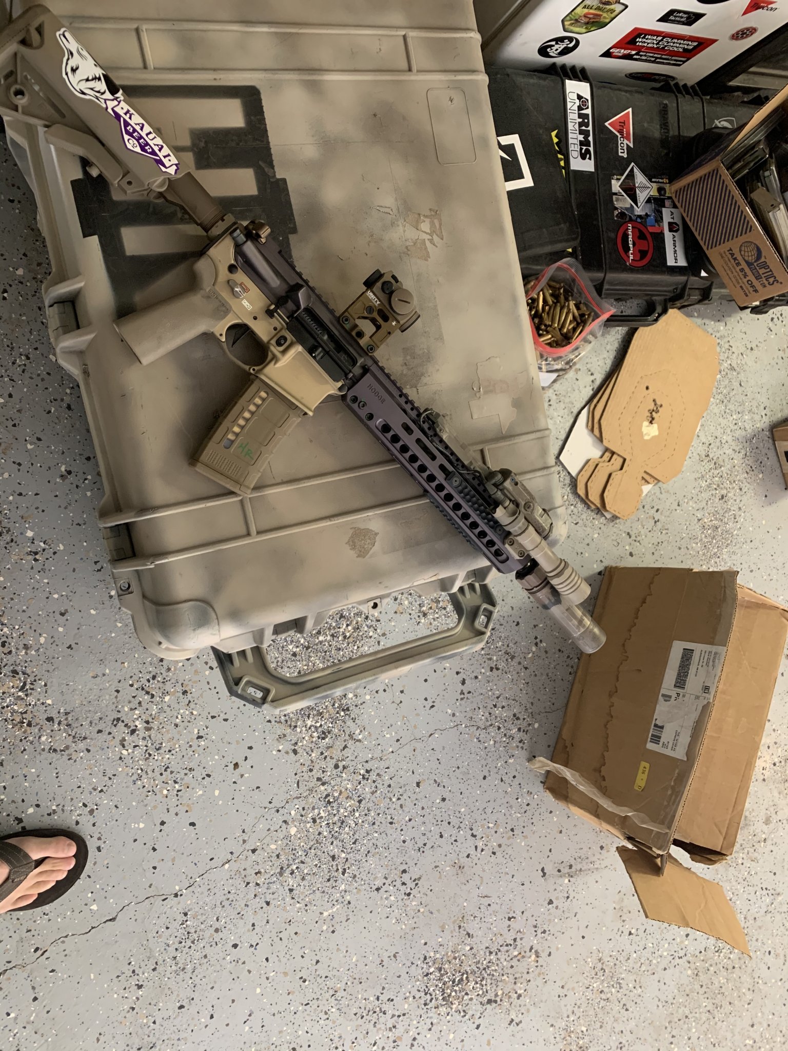

AR15 Build Opinions
Hmm interesting.
Based on the suggestions of the forum I have made some edits.
BCG 189$: BCM BCG
Rail: BCM MCMR 15"
Gas block/tube 60$: BCM gas block and tube
This way the core of the rifle minus barrel all comes from BCM which should remove the risk of mix matches parts. Also should save a good amount of money
Any thoughts on this?

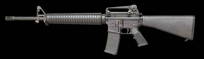

Just to clarify your recommendation is to get just a plain jain colt and not worry about any of the fancier gadgets and gizmos because
1. I'm not at a level to discern marketing and what really matters (fair point to that given how agonizing it was choosing a barrel... mainly barrel profiles lol)
2. A lot of the fancier stuff would just introduce needless variables for me to deal with while getting a solid foundation of fundamentals and provide a crutch for bad habits to hide in.
The only question I have is what rifle would you recommend since colt is no longer making ARs for the public? Also while this is a hobby of mine to learn to be the best shooter I can be and improve myself I also am seeking a good rifle for defensive purposes as well. Would you still recommend something like the Colt A4 for both range and home defense or would you recommend two entirely different setups because at this stage in my development the equipment I would need to get the rifle to do that takes away from learning the fundamentals too much and I would not necessarily understand all the trade offs I would be making with that equipment?

My point was that every rifle is different, and expensive is not a cure all. You can build a quality reliable weapon using OEM parts. An example would be Kotaboy32 on Youtube with his expensive vs budget build. The outcome was the budget outperformed the expensive build. I understand I lucked out with the Anderson results, but if in the end the outcome is good amd the reliability is there, then why does price make it better?
OP, this is the perfect example of when to stop listening to someone’s advice. Black rifle haven, school of the American rifle, primary and secondary, and more groups will go into the why. Pm me if you want. But this is some arfcom level advice lol
Interesting opinion. Why does everyone think more expensive is better. Most of the factory gun vendors get their parts from the same OEM. Kotaboy32 on Youtube did a good comparison of an expensive build vs budget, and the difference was minimal. Results are results, and as long as reliability is the same, then why spend more, unless you have a job like Tonto Paronto.20191227_112717.jpg
