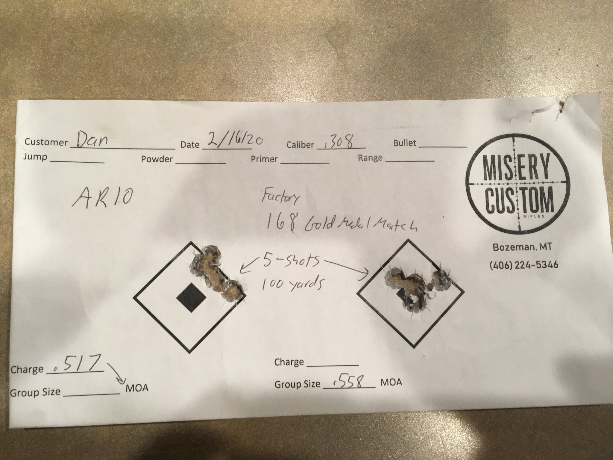

Over the years I have tried many high quality barrels, receiver, and handguard set ups trying to find an ar15 that shoots like a boltgun. I have built many ar10's that all shoot one little hole and are very predictable and consistent. I just can't seam to get a consistent ar15. It will shoot a 5 shot group at about .5 moa and then the very next group will be 1.5". Or Ill have 3 into a tiny little hole and two flyers that open the group way up. I don't get this problem with the many ar10's I've built. Everything is free floating, lots of handguard/ gasblock room, everything is tight, the gas tube isn't dragging on the bcg.
Currently I am working on two ar15's with bartlein barrels. one is a 16" and the other is 18", both 7 twists. The 18" is built on an aero precision enhanced handguard receiver combo, and the 16" is built on a larue stealth 2.0 receiver set. Both these receiver sets have the handguard mount directly to the receiver not the barrel nut. I have built many ar10's with bartlein barrels and aero enhanced uppers that just stack them every single time.
What am I doing wrong? Where do I look from here?

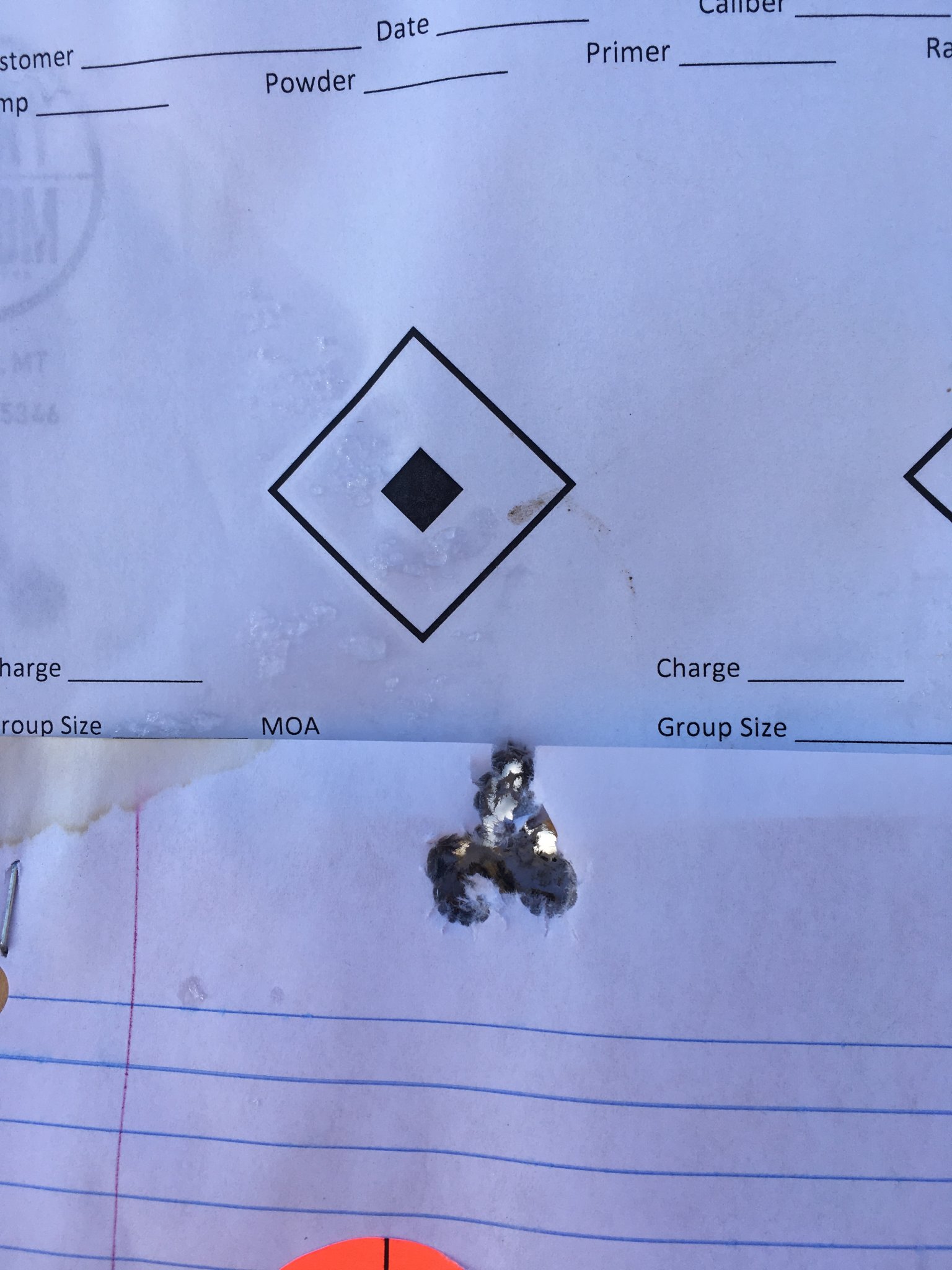

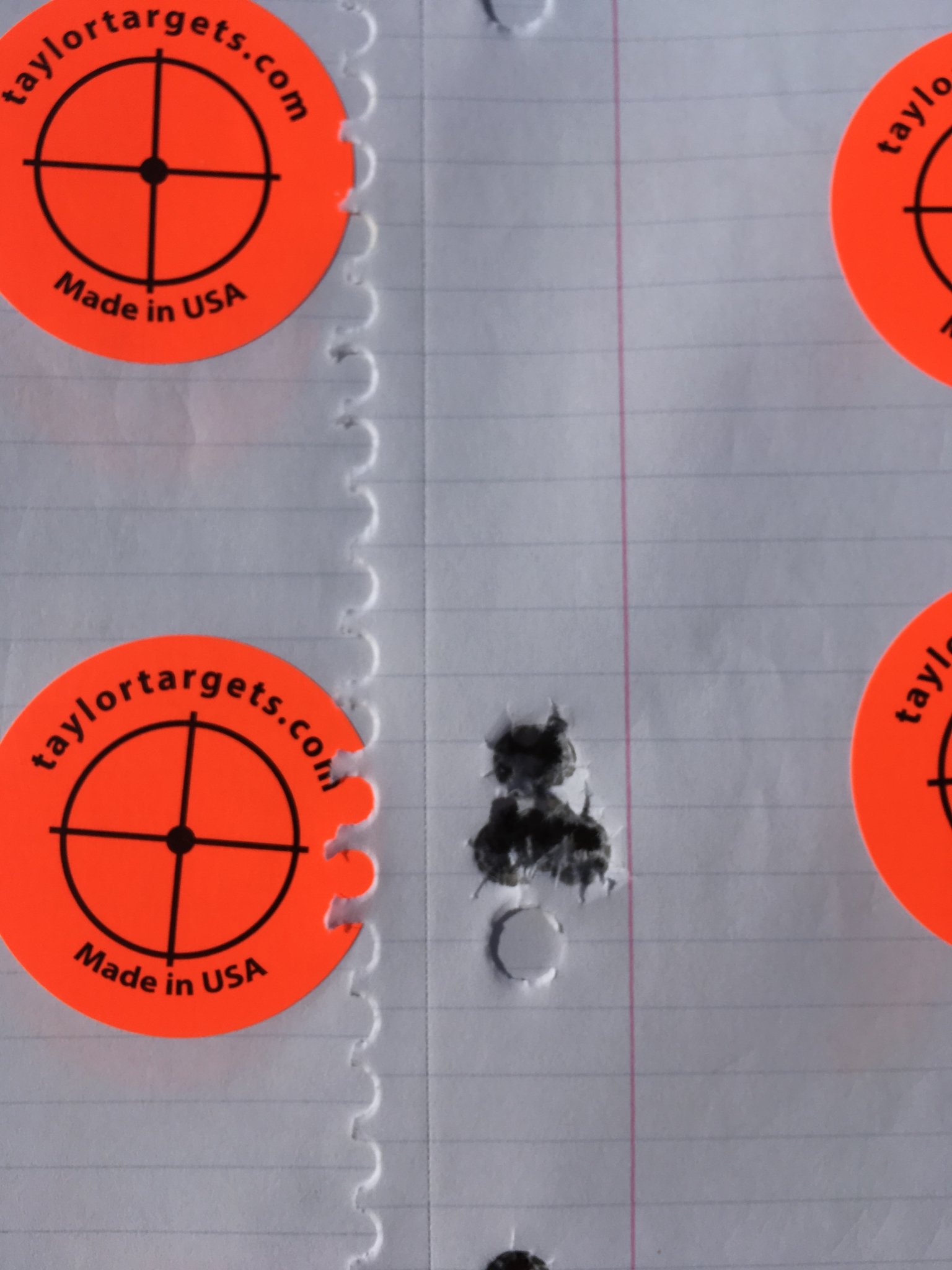

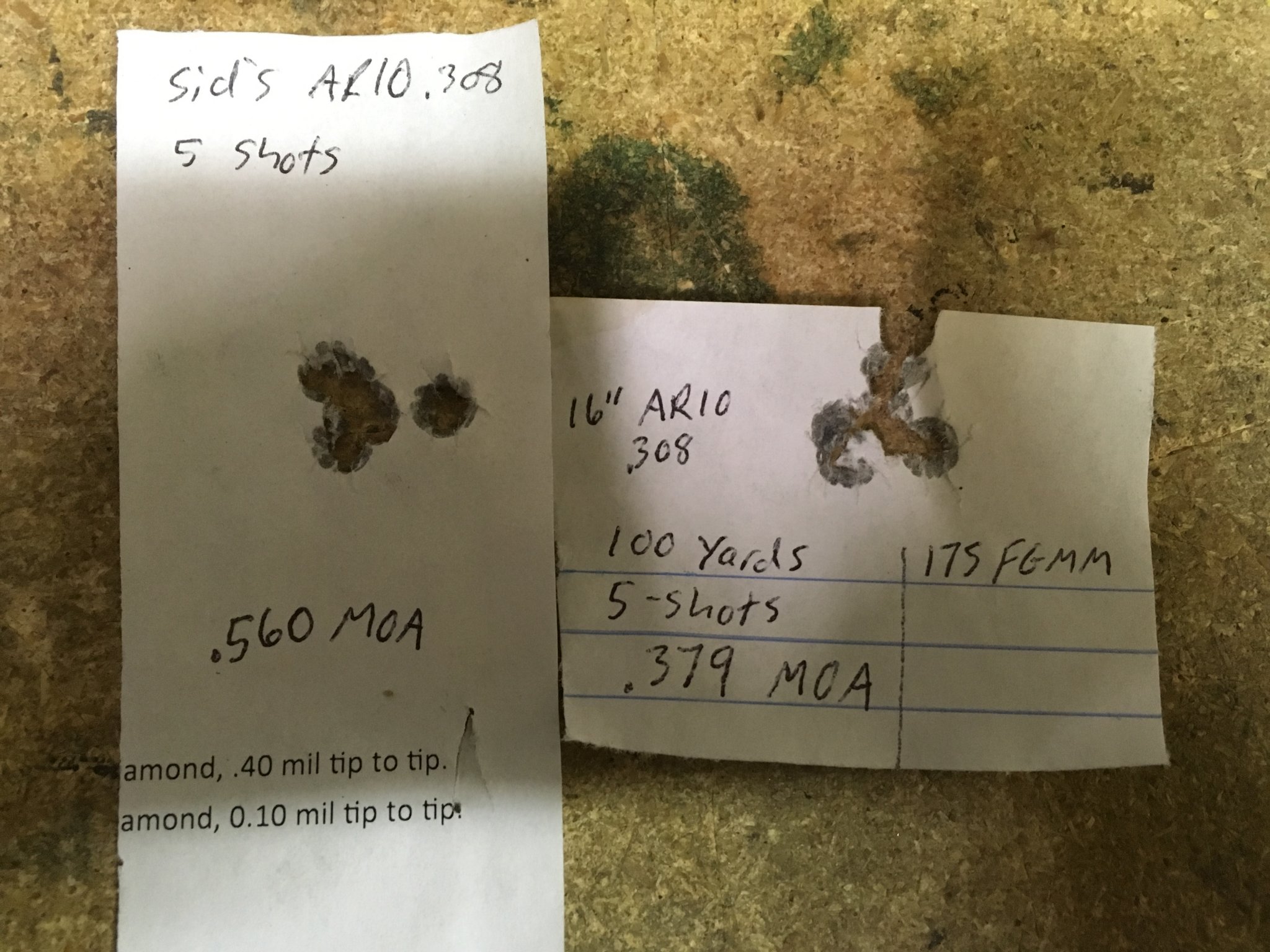

Here are typical ar10 groups

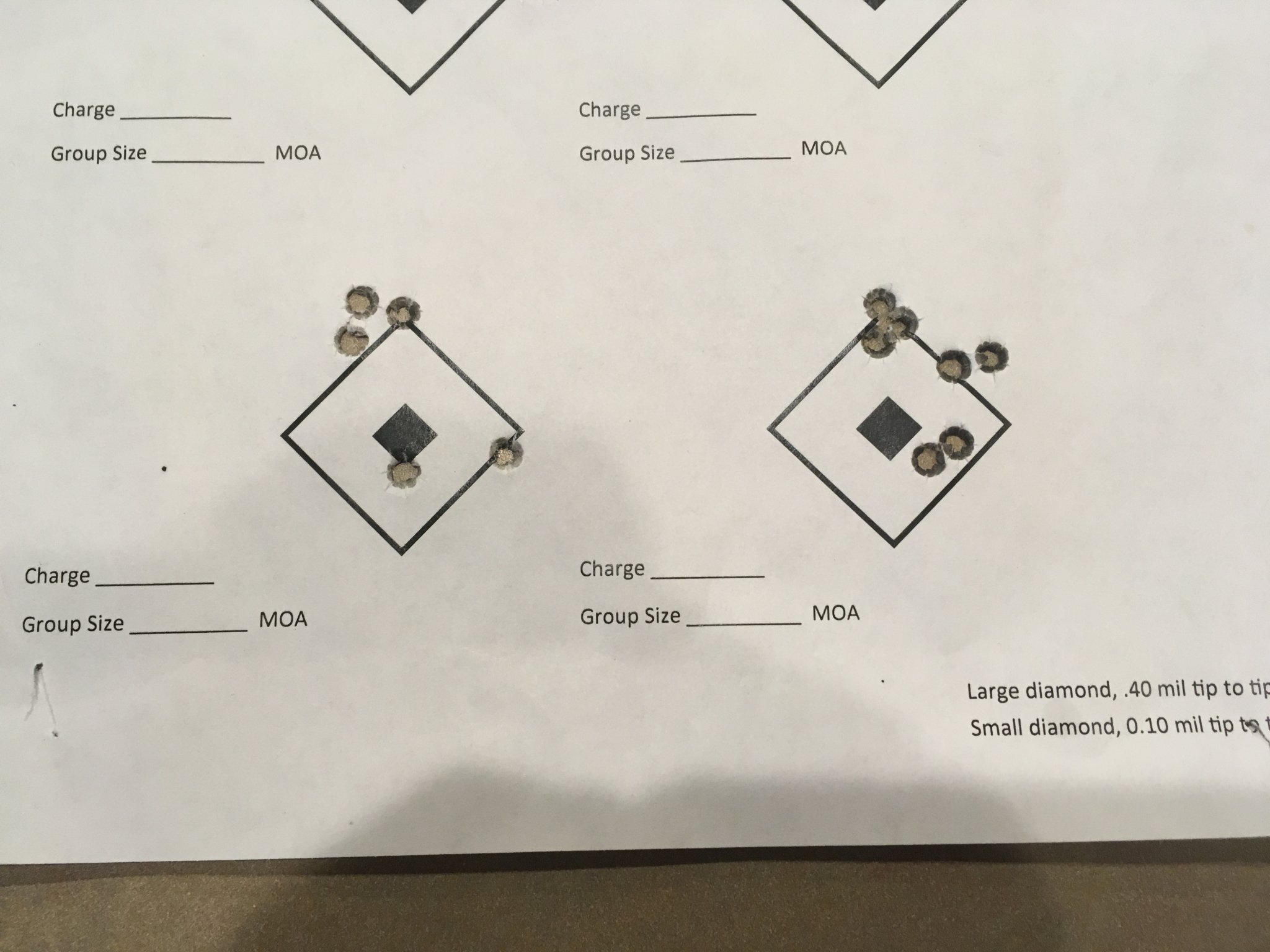

Then ar15's will shoot a group like this
But then the same load does weird stuff like this

These inconsistencies happen with finely tuned hand loads as well as quality factory ammo. The last picture on the left target is with 77 federal gold medal match. it has 3 into a small cluster and two that are low. I know about the first round/last round flyers, but in this group the last shot wasn't the last round in the mag. Also, I don't get first/last round flyers in my ar10's.

Assuming those diamonds in the second AR15 picture are 1.25" square, you still are shooting just over 1 MOA (perhaps slightly more) with the flyers which is perfectly fine. Test each loading at 300 yards and see what happens, collecting data as you go. If you are able to put everything, including the flyers into a 4.5" vertical dispersion or better (and only occasionally throw one beyond that which can't be attributable to you) then I would say your rifle is performing well and your loads are good (perhaps the hand load can be tweaked for some marginal improvement getting you under 1 MOA consistently out to your max effective range).
