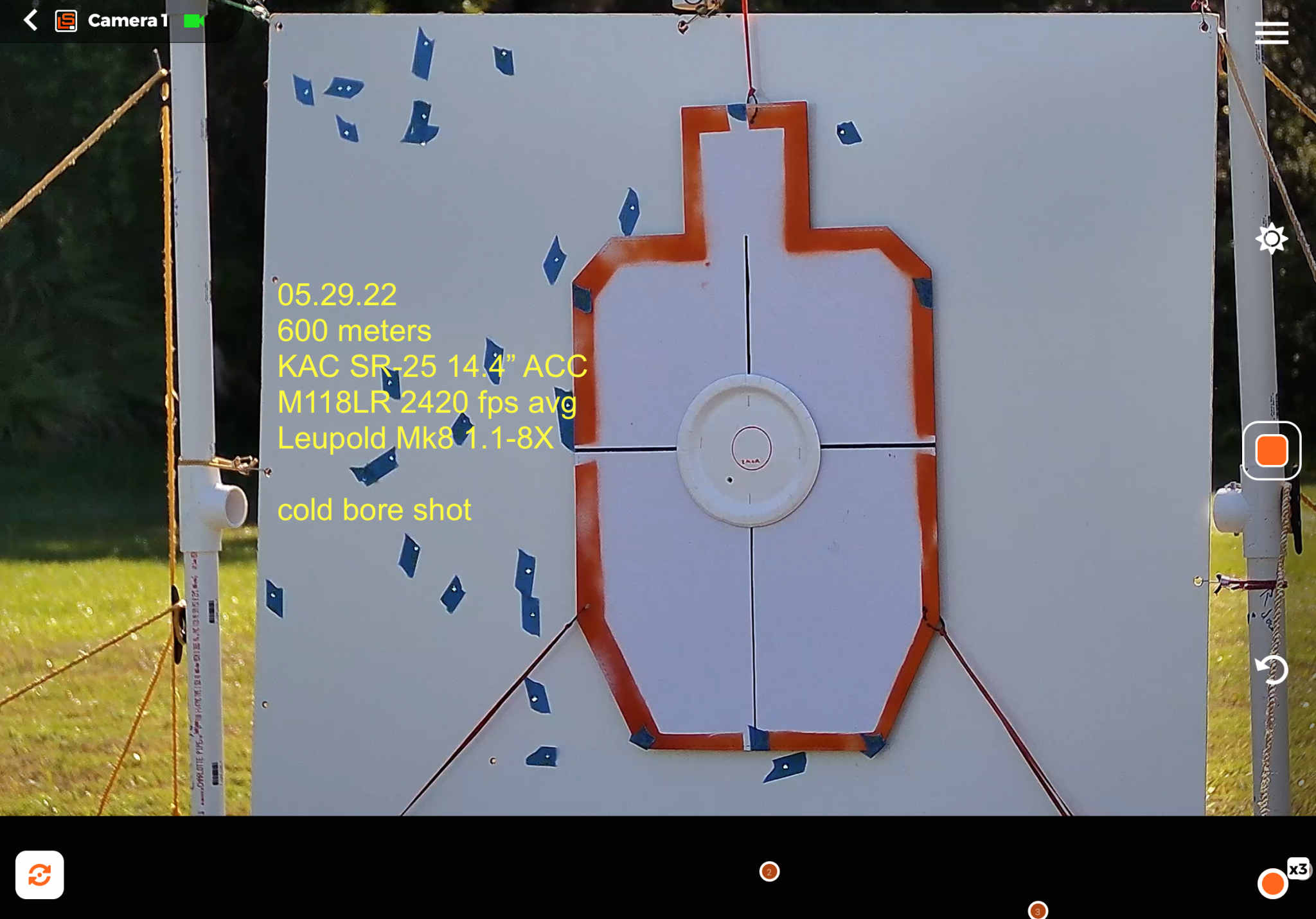

I respectfully disagree.

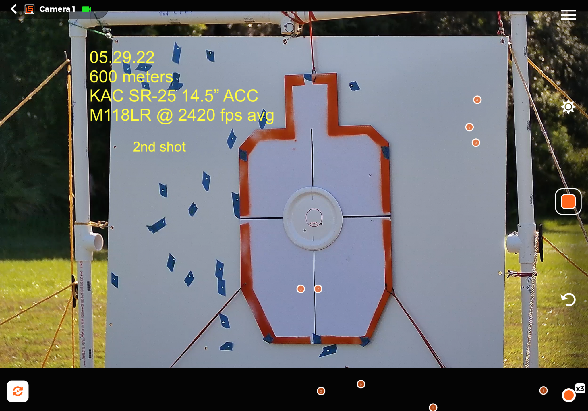

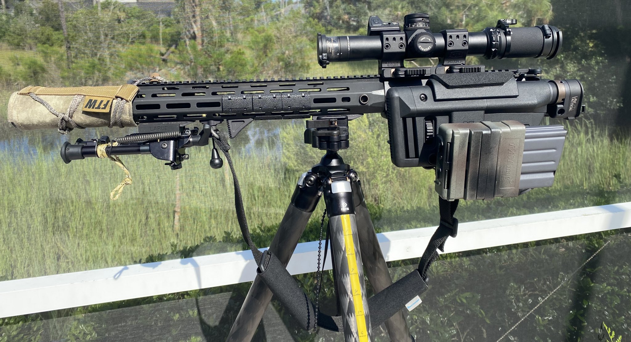

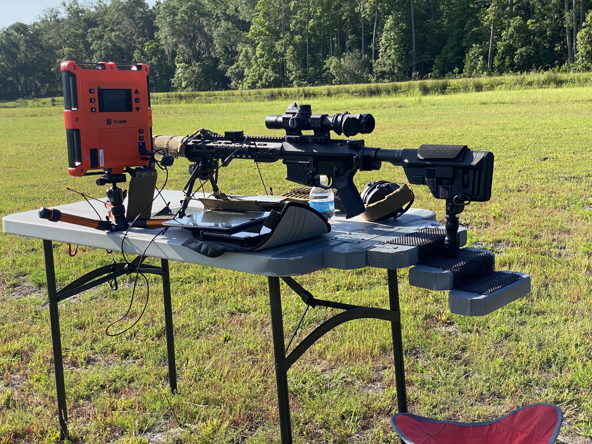

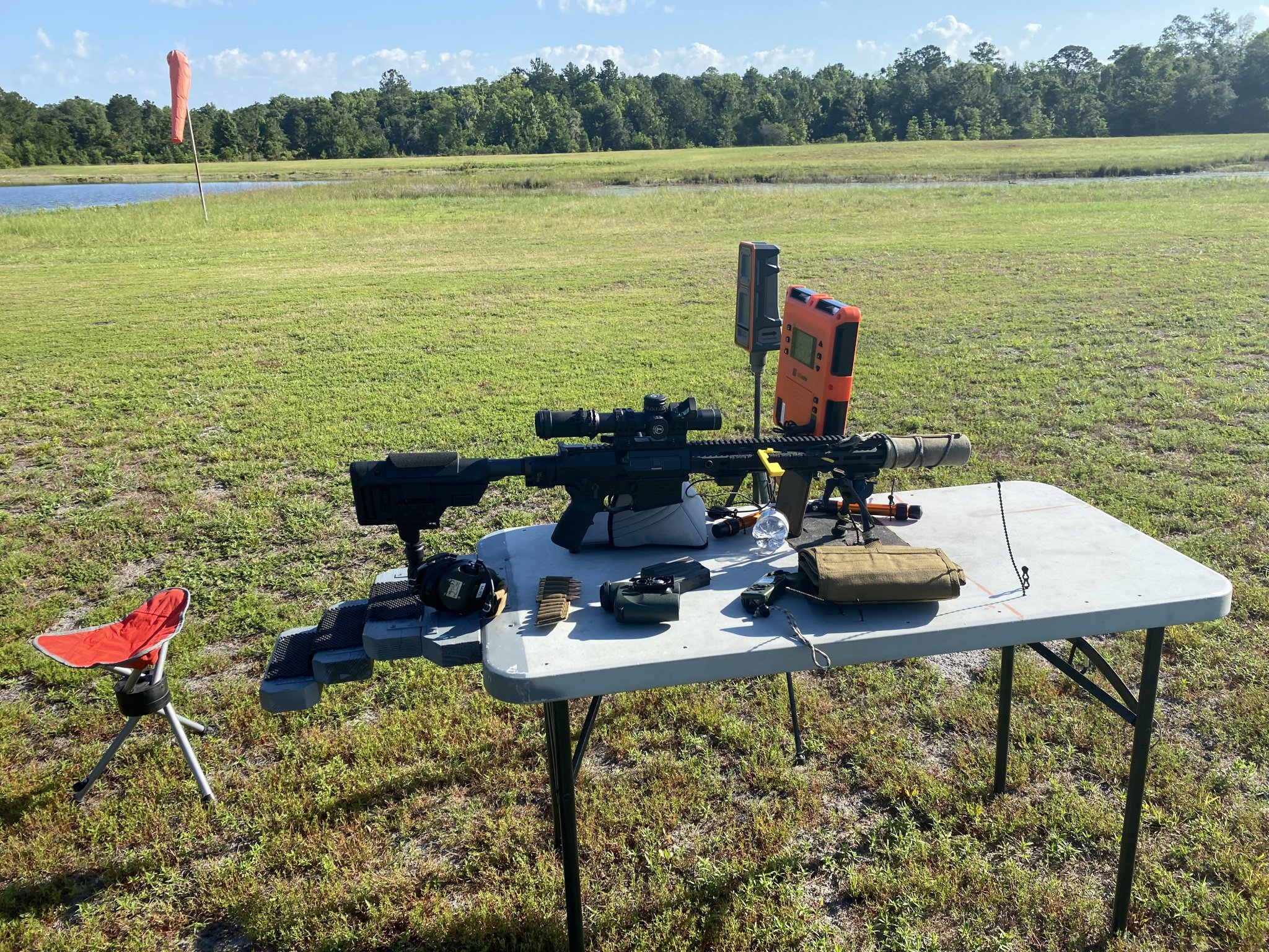

I use this 14.5" SR-25 that has a 14" LOP with Gen3 Law Folder which is well within 1/2" of "standard" LOP for precision rifles and 14" LOP is certainly not too long for myself as I usually shoot with several notches outward on the collapsible stock adjustments.
The tape measure doesn't know the anatomical configuration of the shooters, length of reach etc. so a generalization such as "it will always be too long" is sidelined as a reality for some shooters perhaps.
This setup is stable enough to get 1st round cold bore and 2nd round hits on target at 600 meters. Just sayin'.
View attachment 7978600View attachment 7978601View attachment 7978602View attachment 7978603View attachment 7978604View attachment 7978605View attachment 7978606View attachment 7978607

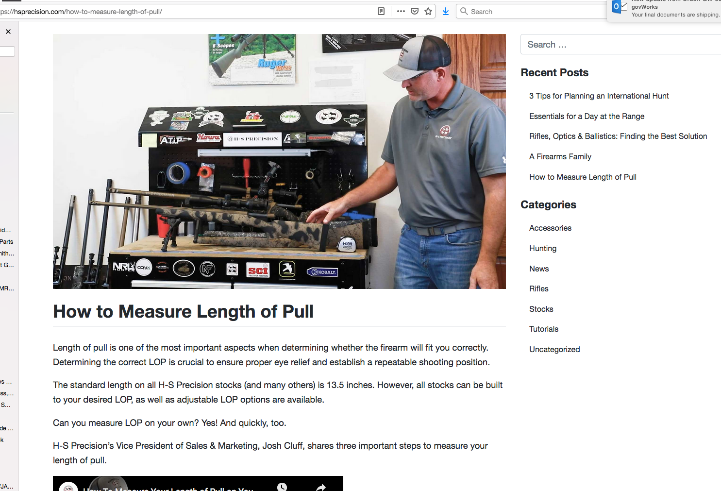

Let me clarify……in my opinion obviously.
BUT, the only reason that 13.5” is standard is because of the charging handle. If it were not required to clear the CH, precision stocks would be shorter as the standard with the ability to lengthen as needed. Throw in the folder and guys whe wear armor and you could be pushing 16” in your setup. The average guy does not have that gangly of arms.
But you do you. It’s your setup. It’s not wrong if it works for you.

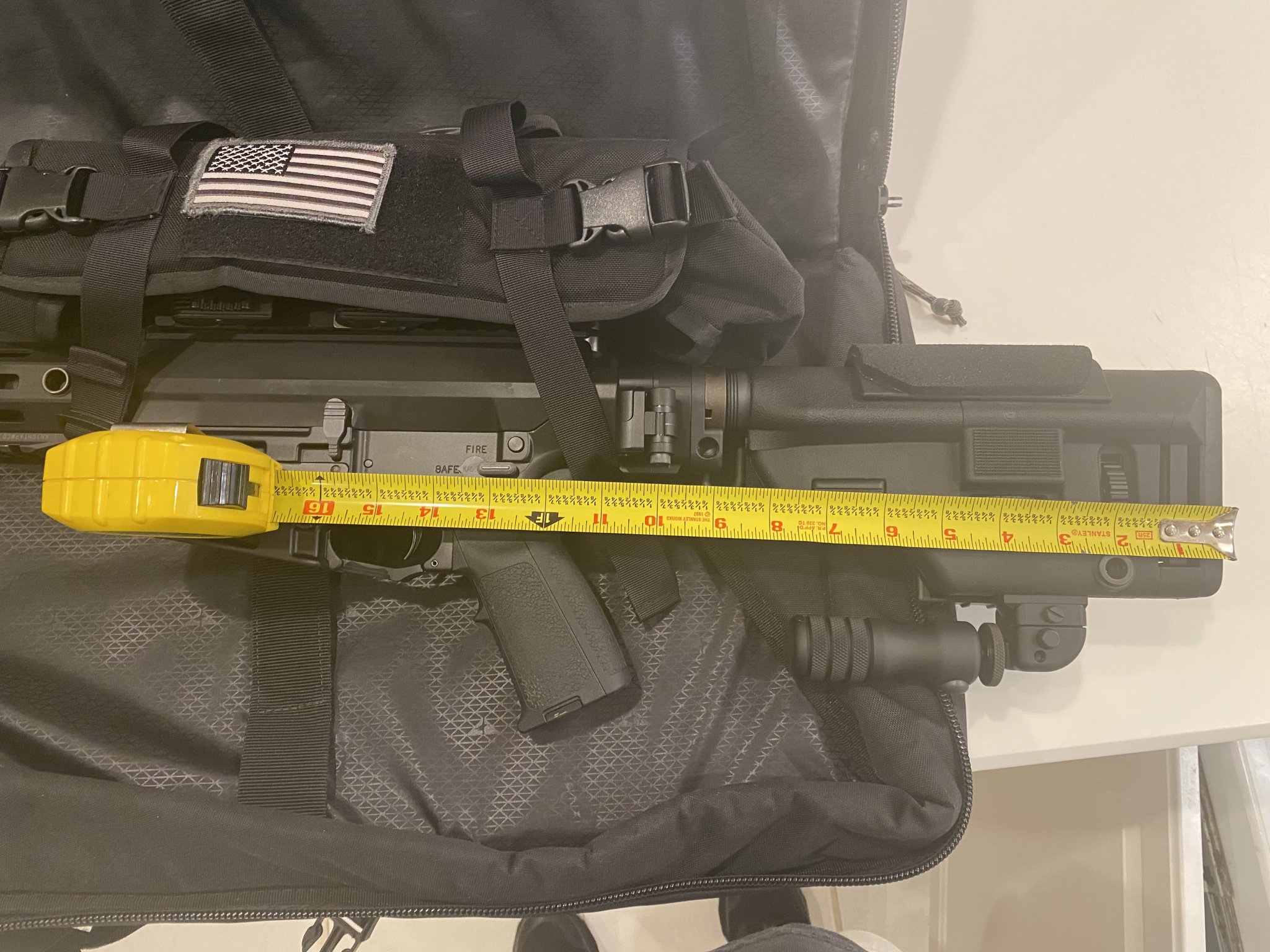

You can use strikeeagle1's pic with the tape measure and other info as reference.
LMT DMR with mil spec carbine RE: 9.25" collapsed, 10.5" extended
Magpul PRS Gen3: 11.5" collapsed, 12.9" extended
I believe that the 308DMR for an A5 RE is around 11/16" longer than the mil spec carbine version. The measurements would be from where the castle nut meets the LAW. The LAW adds 1.5" as shown in the above pic.

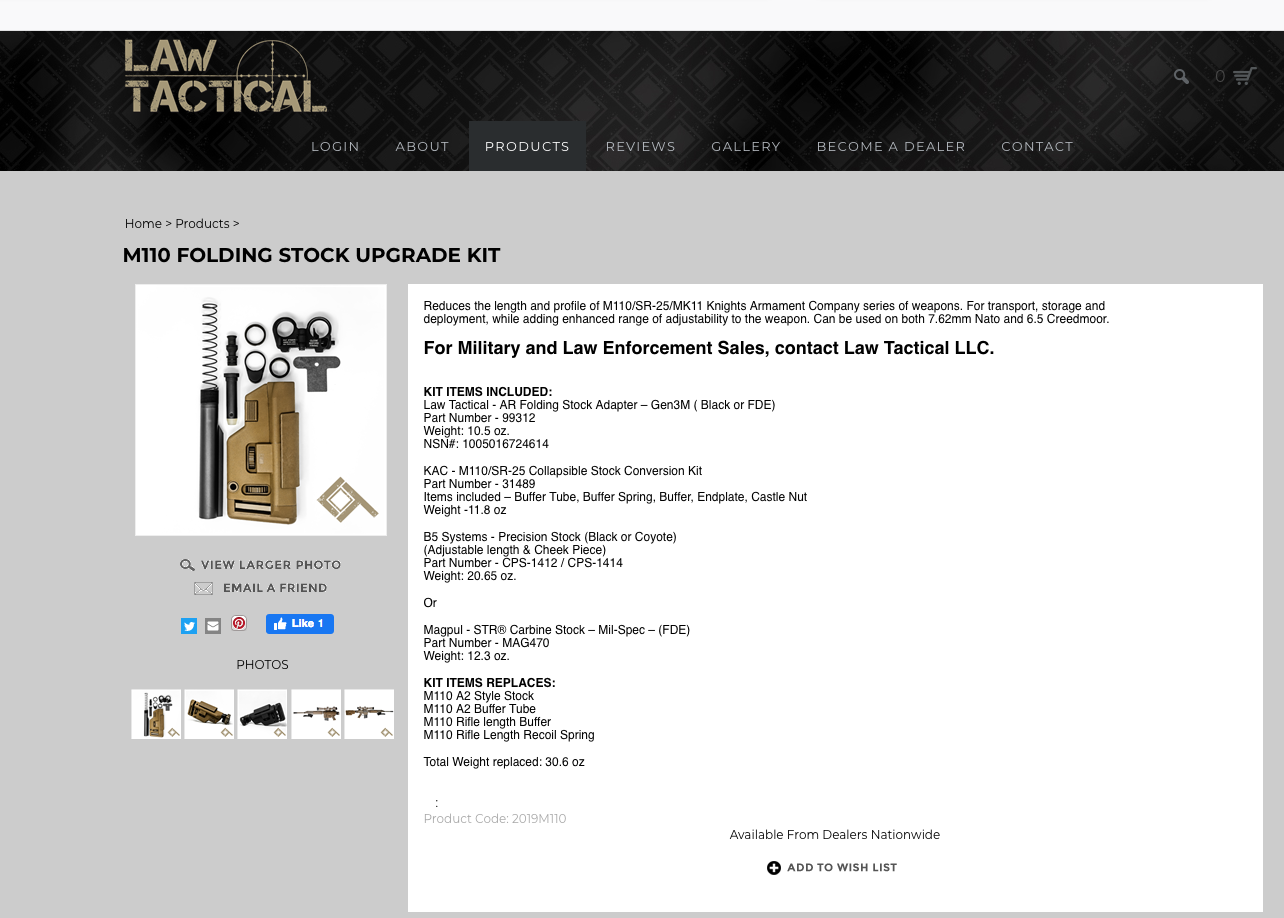

Law Tactical sells / sold a M110 conversion kit with either the B5 or Magpul STR stock. I chose the B5.
