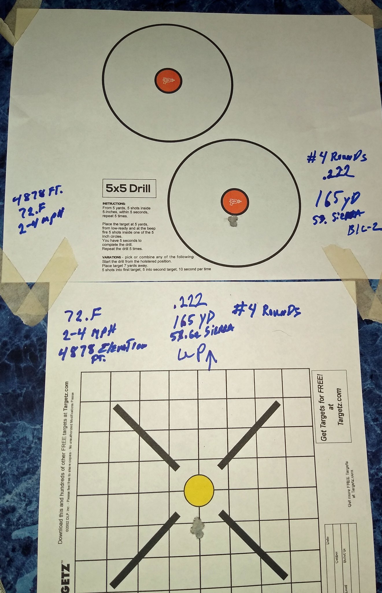

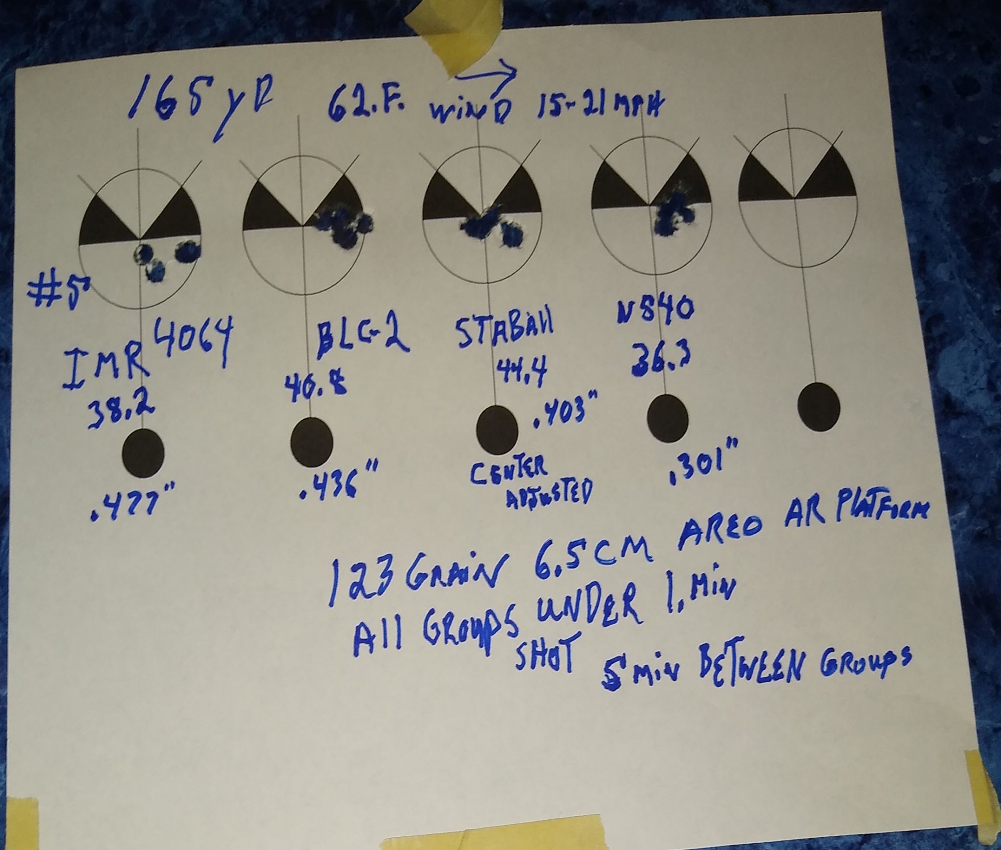

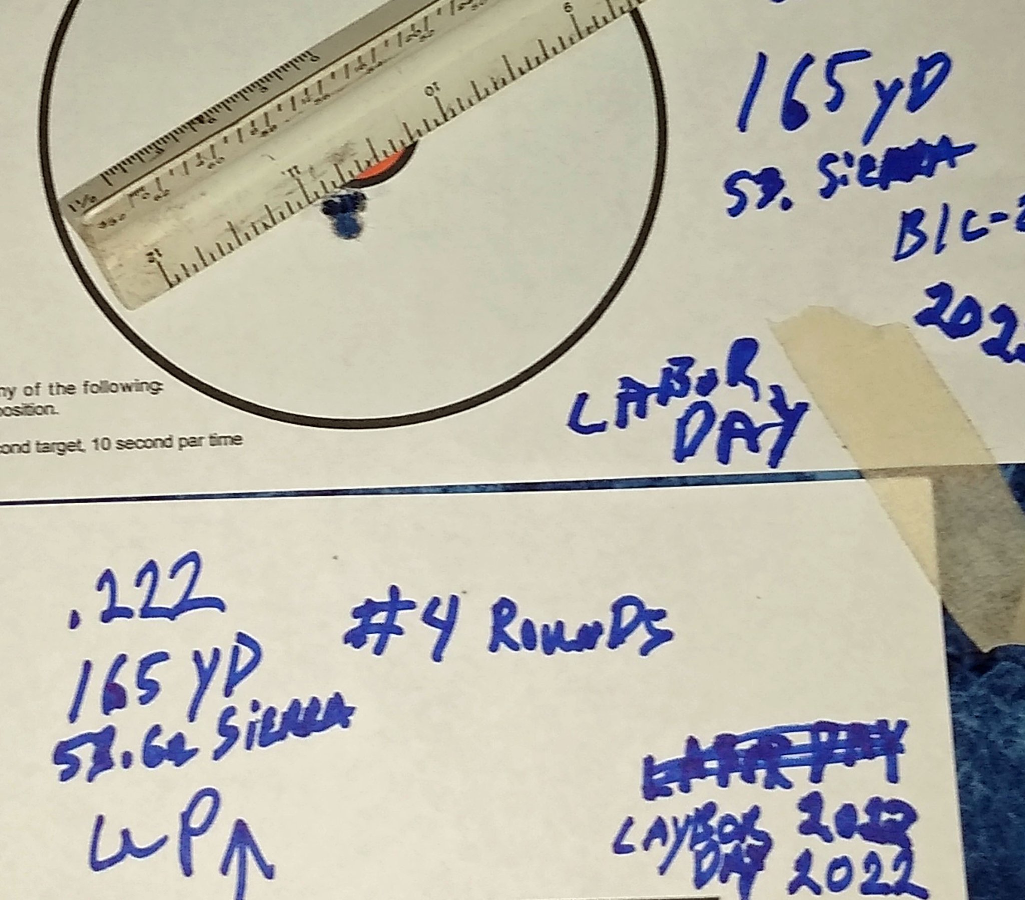

I own an inordinate amount of Dies more than #5 reloaders combined ,Why ?. Because I've experimented over the years having various specialty companies attempt to apply a specific coating inside the Dies . Coupled with the fact I reload for #22 calibers , excluding #3 Shotshell gauges . So Do My Forester ,Redding Dies reload any better than My RCBS or Hornady ; NO they don't . ALL Dies are made to SAAMI specifications ,unless they're custom Dies and do exactly the job intended .
Fyi : NO I've NOT ruined any Dies everyone of them still has the ability to reload Quality Ammunition . Only had #8 Rounds left from a 1993 reloading ,why #2 groups of 4 .

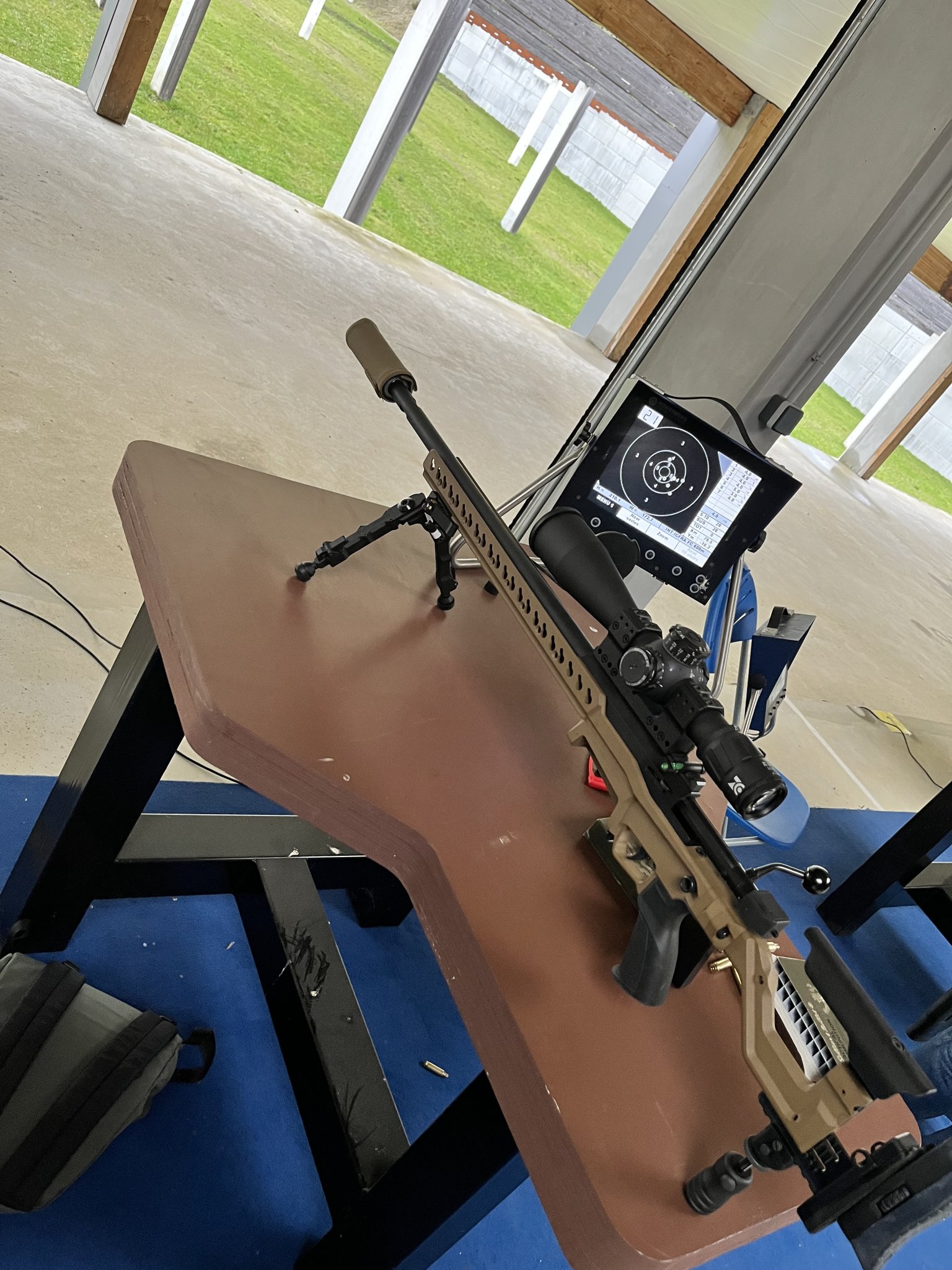

Following your advice, i started looking for T7 let’s see if i find some…
Yes, i’m in Europe and jealous of you people but that doesn’t mean we can’t own dope shit !
Here’s my gun for reference 😁😁ATX
