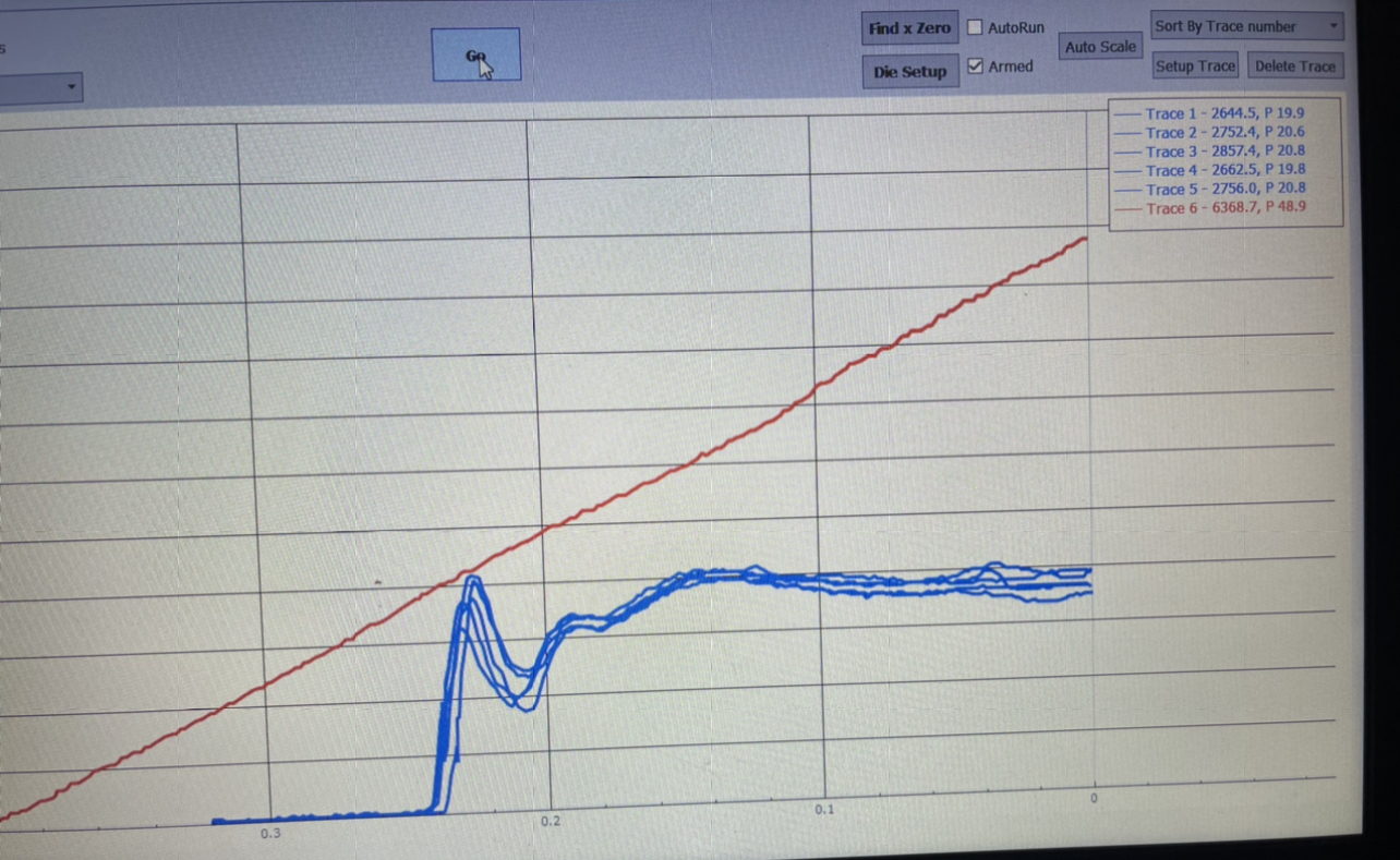

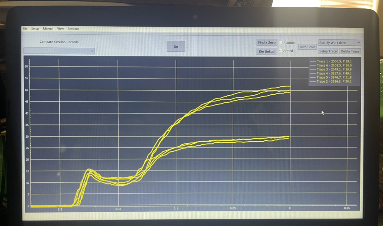

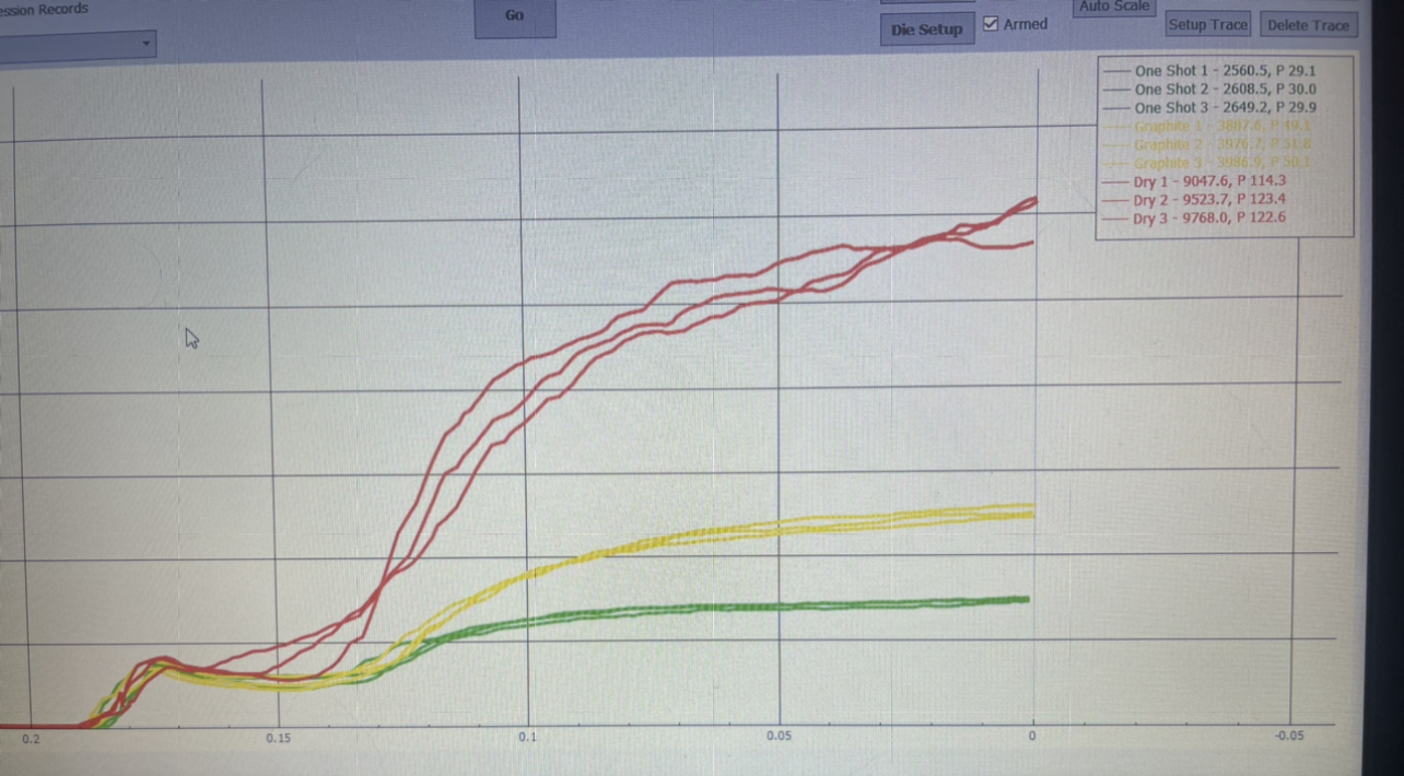

This information is incorrect.
You can absolutely have two or more distinct numbers and still have ammo that shoots fine.
Here’s examples of different kinds of seating force curves. They all shoot well.
There is thus far zero evidence or data that suggests a fluid gain is better then a gain with a release, or a gain/release/gain.
Much of it depends on bushing/type of bushing or non bushing die. As well as the finish on the inside of the neck. However 90% or more of it is just white noise.
I promise you will not be able to find or post long term data with any amount of statistical confidence that suggests otherwise.

As to the OP, force gauges and such are literally comparators, just like your calipers with inserts for headspace and seating.
For the most part, they don’t help you make better ammo, they allow you to make consistent ammo.
You will need to do the testing yourself, find what works for you and then use the gauge to keep ammo consistent.
For example you may find that your best performing ammo has a high of 55psi towards the middle of the seating. That’s what you pay attention to. Or you find that it’s best when it’s close to 25 psi throughout the entire seating distance. Then you look for that.
You will almost never find “when it does X it’s going to be a bad round.”
