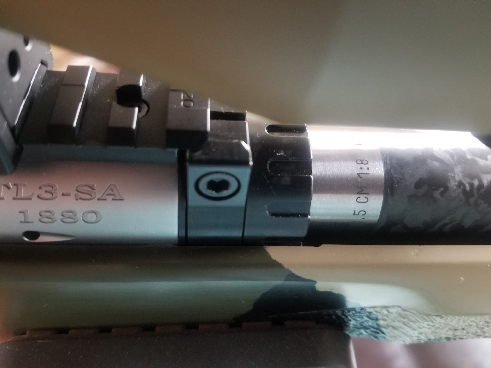

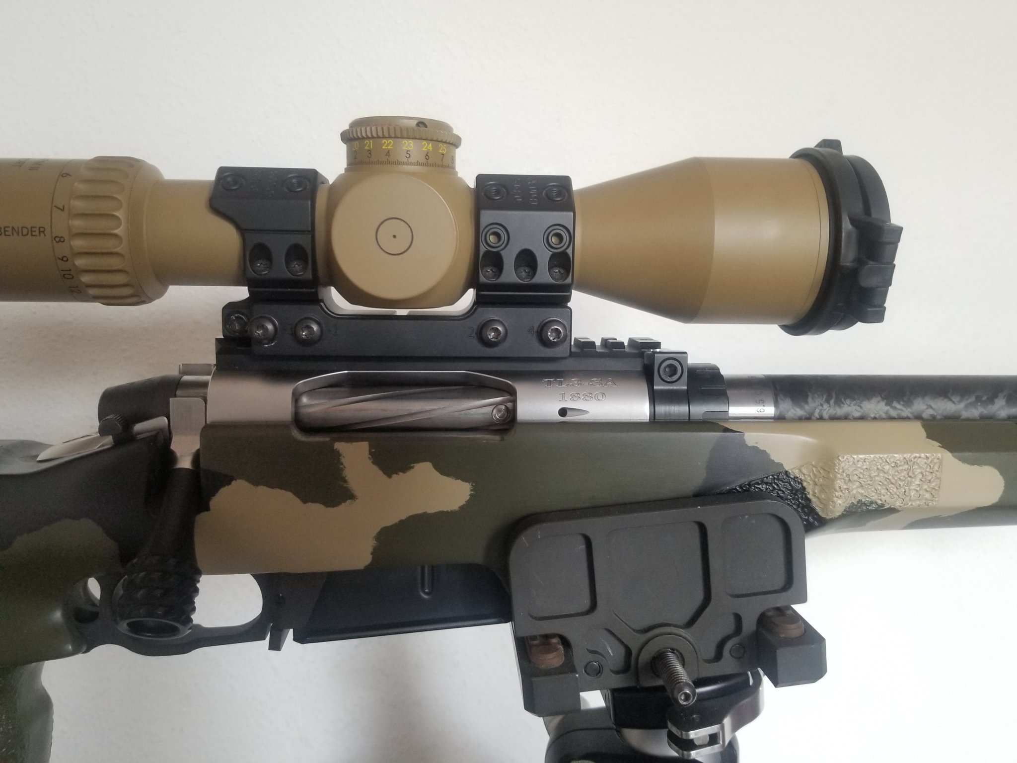

Well, I received my ARC Barloc, and assembled the rifle (still no headspace gauges though...so I can't finish). As expected I had to trim the rail on top of my Bighorn TL3 since it over hangs the from of the action. Everything went together smoothly. Ted really pushed the industry forward with this one! I plan to swap barrels on a somewhat regular basis, and I expect that I'll need to re-zero, but that will be fine for my needs.

Hmm, didn't think about the rail overhanging. Did you just grind it even with the end of the action?
You will have to cut it. It sticks out quite a bit. Big Horn does sell a shorter version. I got mine barloc in as well, looks great but I have not put it on...all rifles are already occupied so will be next barrel change.

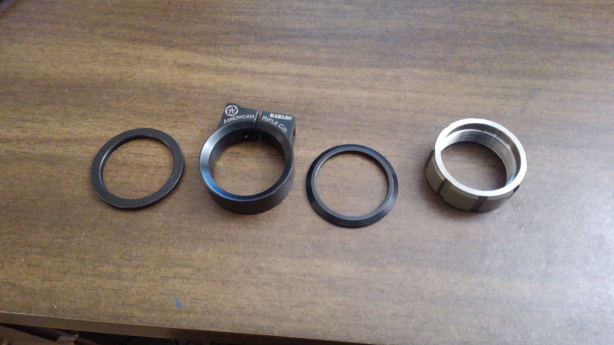

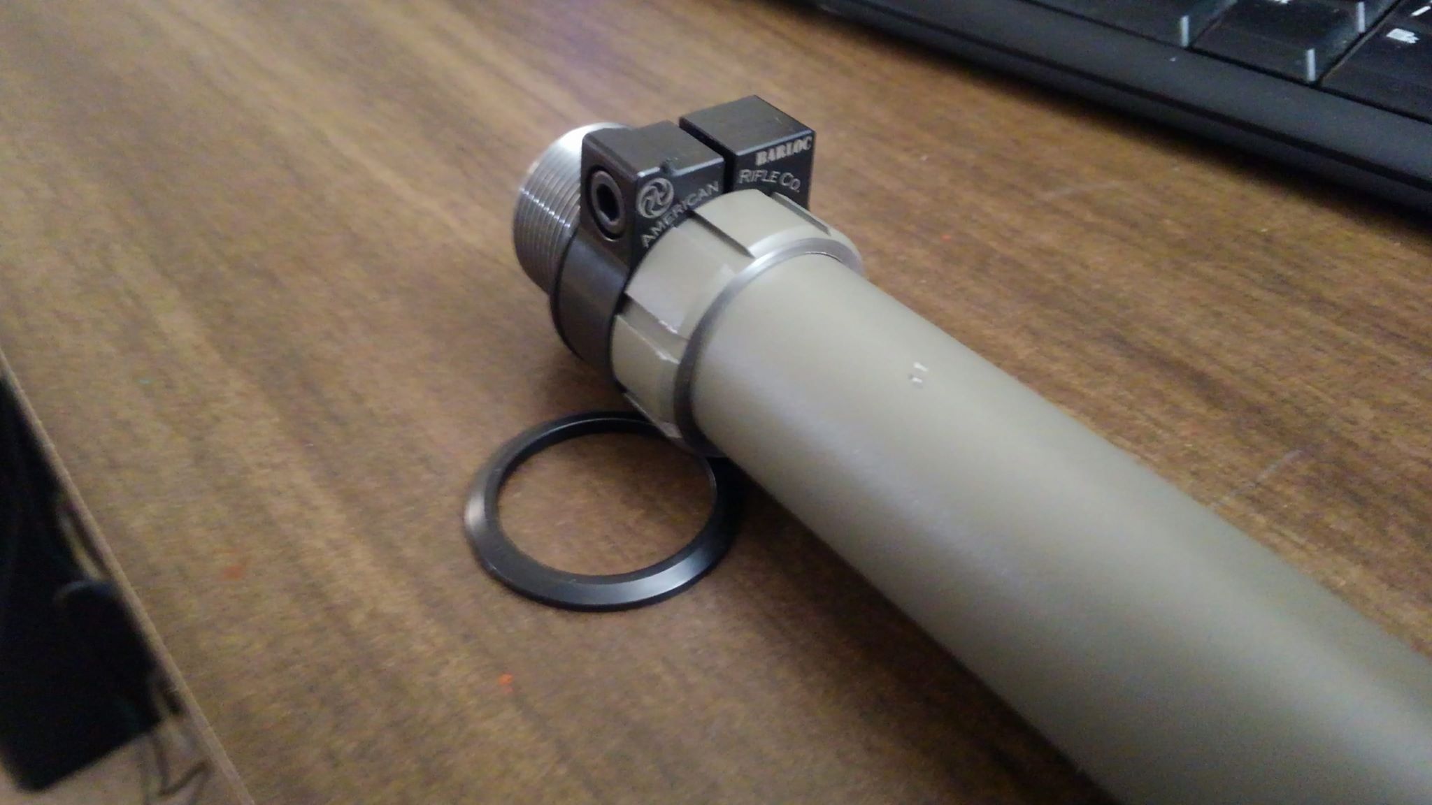

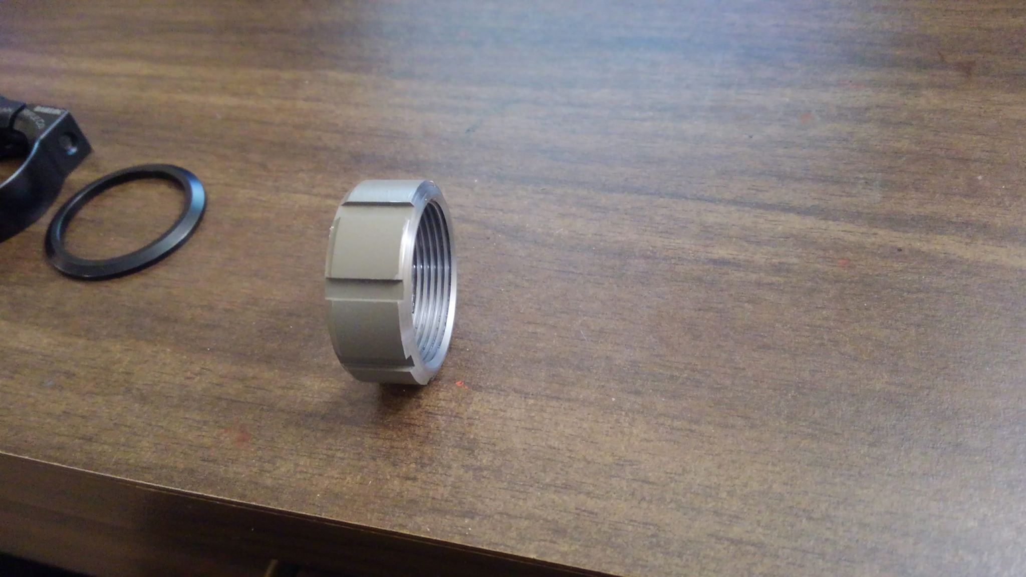

Finally got around to messing with my Barloc. I have an old .260 barrel floating around. It's a Savage prefit by Bugholes. My plan is to have the current 6.5 SAUM barrel modified to work with the Barloc (shouldered style, with 2 tapered rings), as well as ordering another barrel, probably a 16-18" .308 from PVA for throwing tracers and mid-range fuckery, maybe subs if Josh has a 1-8 twist blank. Anyway, I have about 2200 rounds on this .260 barrel and I figured it maybe has another 500-1000 rounds left on it if I wanted to push it. I still have a few loads stashed away in a corner somewhere for it. So I went to see if it would work with the Barloc.
Off the bat, no-go. You're going to need to either modify your savage barrel nut, or order an ARC barrel nut meant for the Barloc. I was going to try to run the shouldered barloc with the savage nut... The Savage nuts have too many threads on them, and not a long enough threaded section of barrel to squeeze the barloc system in. The fix is to lop off the non-keyed portion of the savage nut, then cut away (boring bar) several of the internal threads. I left 5-6 threads on the inside of mine, which should be enough to bear the load. Boring the threads away like this makes a "shelf" that covers up the forward-most barrel threads so it's just smooth barrel infront of the nut, not threads.
Finally, I flipped the nut around and cut a 30 degree chamfer on the back side, which appears to be pretty close to what ARC is using on the tapered rings. Below are a few pictures. It will probably be several weeks (months, probably) before I get around to actually using this, but I'm pretty excited for the switch-barrel capability.

A savage small shank barrel will work with the Nucleus several ways.
Typical Savage prefit:
1) Barloc style Nucleus lug ---> Barloc ---> Barloc savage barrel nut** ---> Standard prefit barrel
2) Standard Nucleus lug --> Barloc wedge ring ---> Barloc ---> Barloc Savage barrel nut** --> standard prefit barrel
Shouldered Savage barrel***
1) Barloc style Nucleus lug ---> Barloc ---> Barloc wedge ring ---> Shouldered barrel
2) Standard Nucleus lug ---> Barloc wedge ring ---> Barloc ---> Barloc wedge ring ---> Shouldered barrel
** You can machine/modify a standard savage barrel nut the way I did above in lieu of the ARC barrel nut (I'm going to say in most circumstances it's going to be more work/$$ than it's worth unless you have a lathe at your disposal and already have savage nut(s)).
*** Existing Shouldered barrels will need to have the shoulder pushed forward approximately 0.585" to accomodate the barloc system squeezing into the mix.
Finally, I flipped the nut around and cut a 30 degree chamfer on the back side, which appears to be pretty close to what ARC is using on the tapered rings. Below are a few pictures. It will probably be several weeks (months, probably) before I get around to actually using this, but I'm pretty excited for the switch-barrel capability. View attachment 6885190

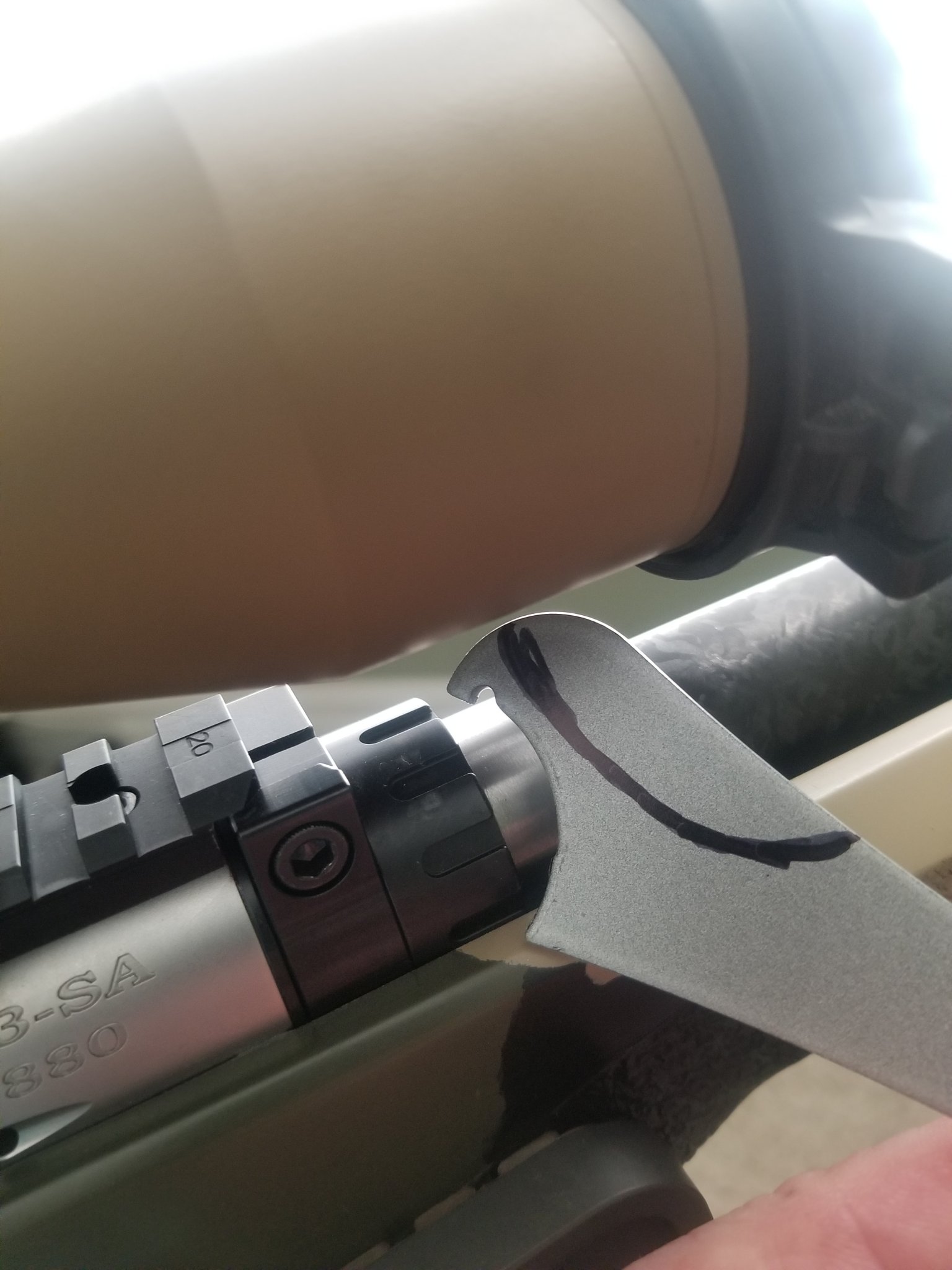

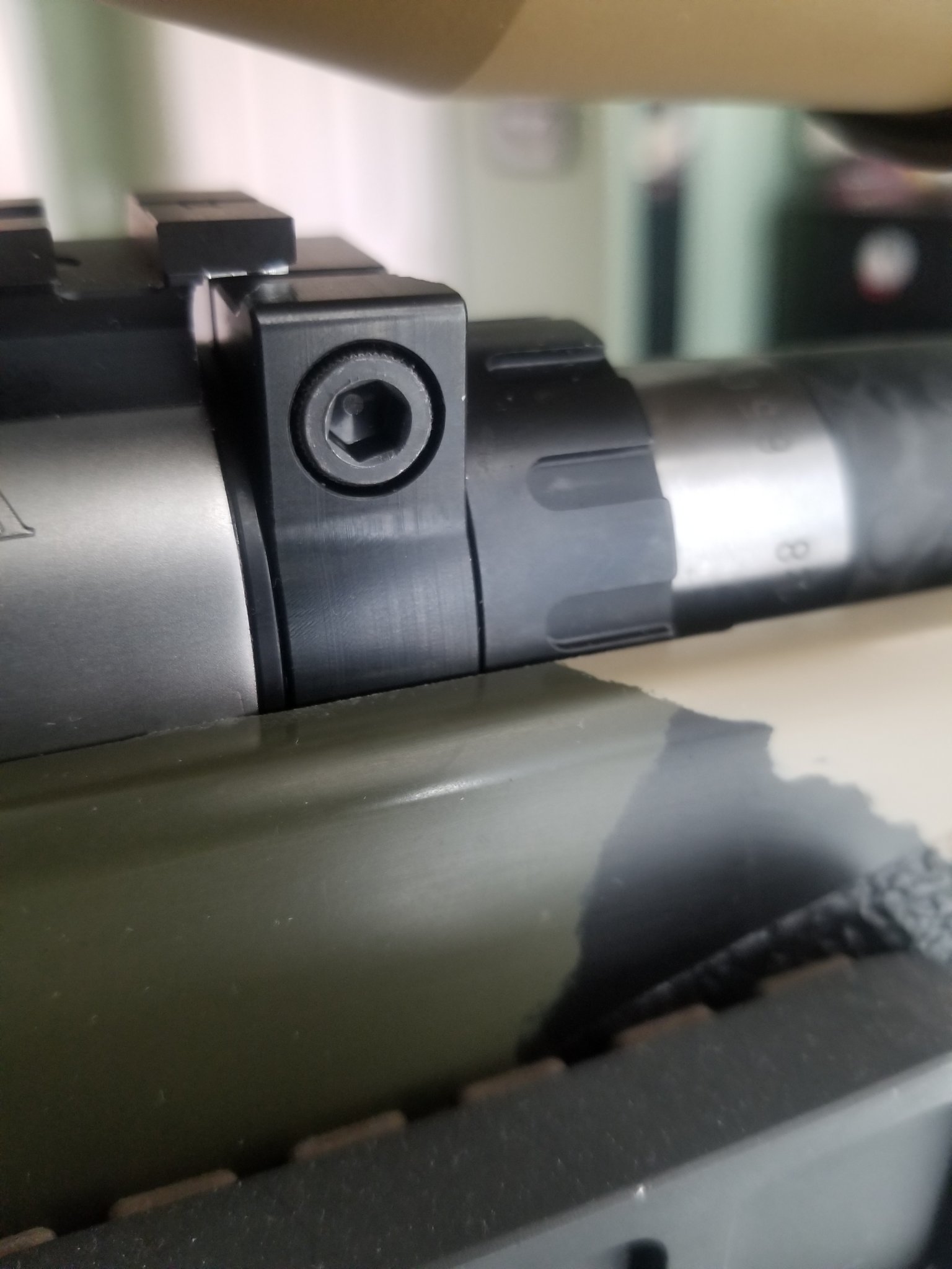

Yes, that's a Proof Research savage prefit. Using a go guage you screw the barrel down on the guage and tighten the nut with the supplied spanner wrench then tighten the barloc screw to 100in/lbs. I did have to remove scope to tighten the barrel nut.
Hmm ok, thinking about trying the shouldered barrel version in hopes that I won’t have to remove the scope. From my understanding though the tenon has to be cut a certain way.
You probably don't need to use a wrench on the nut. Hand snug before tensioning the barloc is probably fine. Or the wrench could be cut so that it doesn't form a complete circle.
Teds instructions say to tighten the nut until the gap in the barloc is big enough to fit the wrench between(which is pretty tight)
I'll probably take a drum sander to the top of the wrench so i can fit it under the objective.
