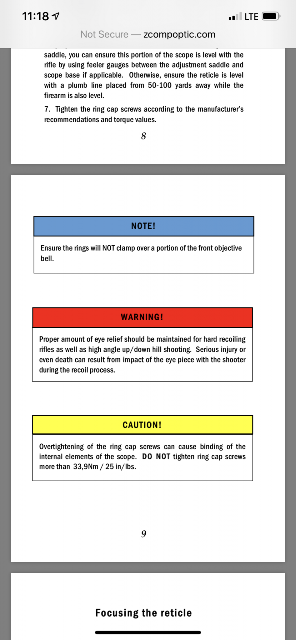

Need some help on what to torque my ZCO in ARC rings.
ARC recommends 50-55 in/lbs of torque and ZCO recommends not to exceed 25in/lbs.
Is 50-55 safe to use on the ZCO tube?
Just don’t want to take a chance in damaging a brand new scope.
This has been addressed before with ARC rings but not necessarily ZCO optics.

Yes it is. With ARC rings that’s the only exception to going that high in ring torque because of the 1 screw design. When I was using their mounts I always used 55in/lbs

The 25 inch pounds spec is for a different design. Still the 50-55 in/lbs on the ARC is more than sufficient with heavy recoiling calibers, so if you have a light or medium recoiling caliber you could try a little less on your ARC. I have a MRAD that I shoot mostly with .260 or .308 I torqued the ARC to a very gentle 45 in/lb and it has not slipped yet. If you have a lightweight unbraked magnum for hunting (or you want to be sure it will not move) you are going to want to go right to the spec.
It’s going on a Desert Tech and it will be taking recoil anywhere from 6.5x47 to 338 as I have a wide range of barrels.
I feel pretty confident with Teds design that it will take ARCs torque specs but I would like to hear from ZCO was well!!

I'm not sure where you see that we don't recommend more than 25 inch pounds. The literature and Operator's Manual clearly say to use the ring manufacturer torque specs. I know, I wrote the manual.
ZCO scopes will handle the ARC torque just fine as they specify. No worries at all.
I really appreciate you clearing this up!!
I saw the torque value in your manual.
Look forward to using your product!
