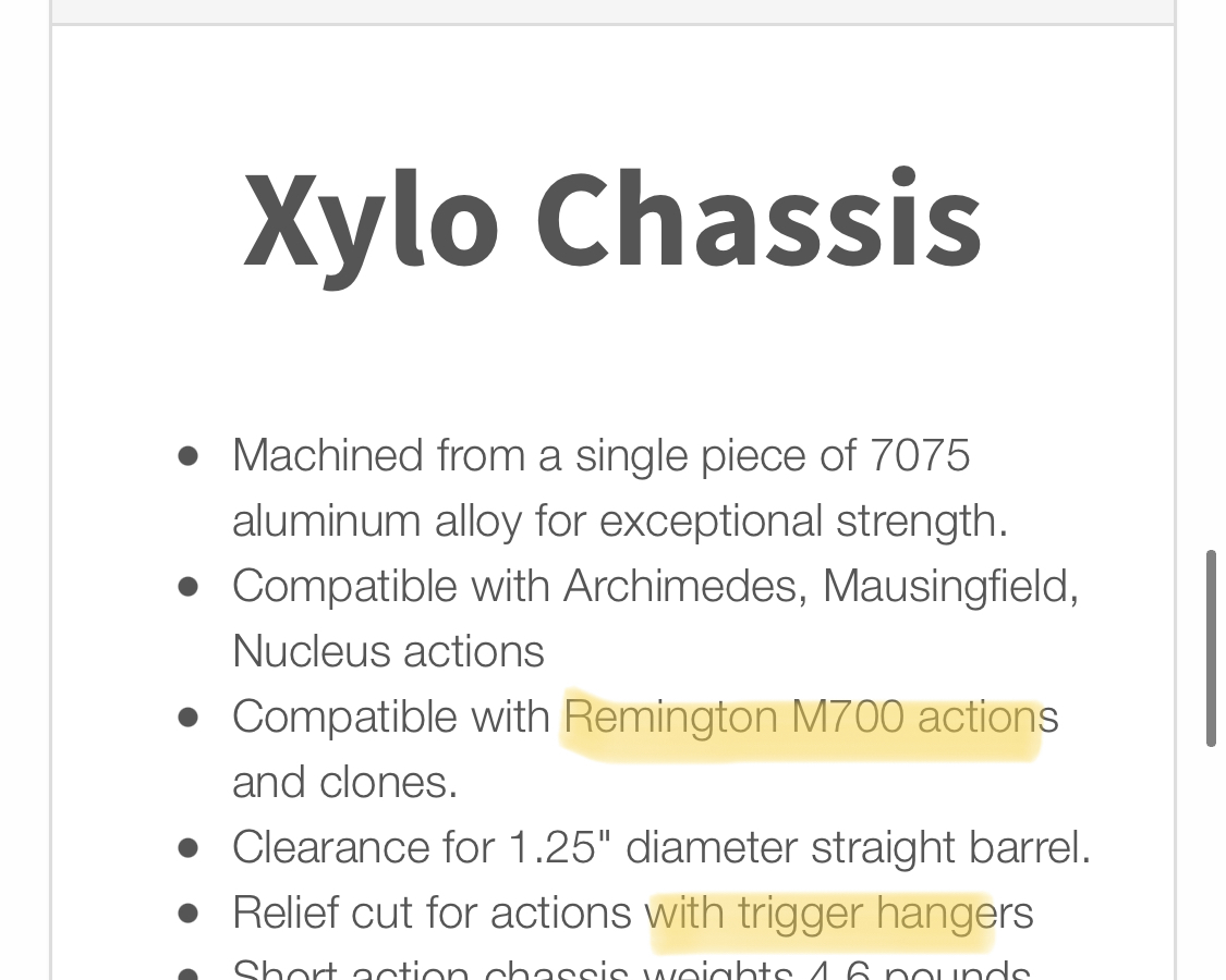

Wanted to use the Xylo Chassis with a stock Remington 700.

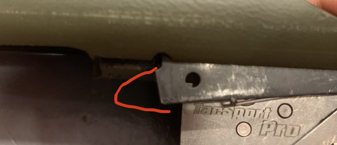

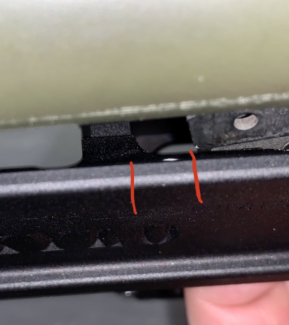

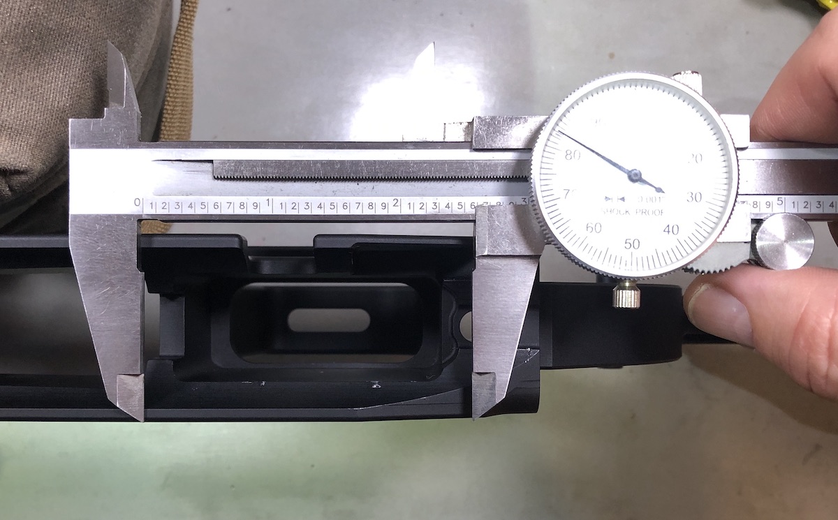

The area where the trigger sits is neither wide enough nor long enough to accommodate the bolt release of my Remington 700
And now to kill the resale value of this chassis with pictures.
Idiot marks on the left side from attempting to fit.
Managed to finesse the width.. but then the lever of the bolt release is too long to lower into the trigger well when actuated.

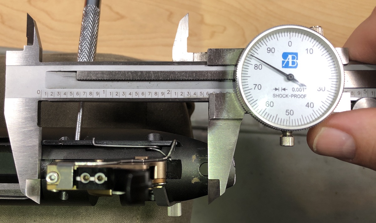

Tip of the extended bolt release to the center of the rear action screw
Center of the rear action screw to .. beyond the end of the trigger well.
Hope that helps.

We tried to accommodate as many actions and triggers as we could, and we just overlooked the standard Remington with the stock bolt stop. Lots of Remington owners have their gunsmith modify it with a custom bolt stop, and other actions have a different bolt stop mechanism.

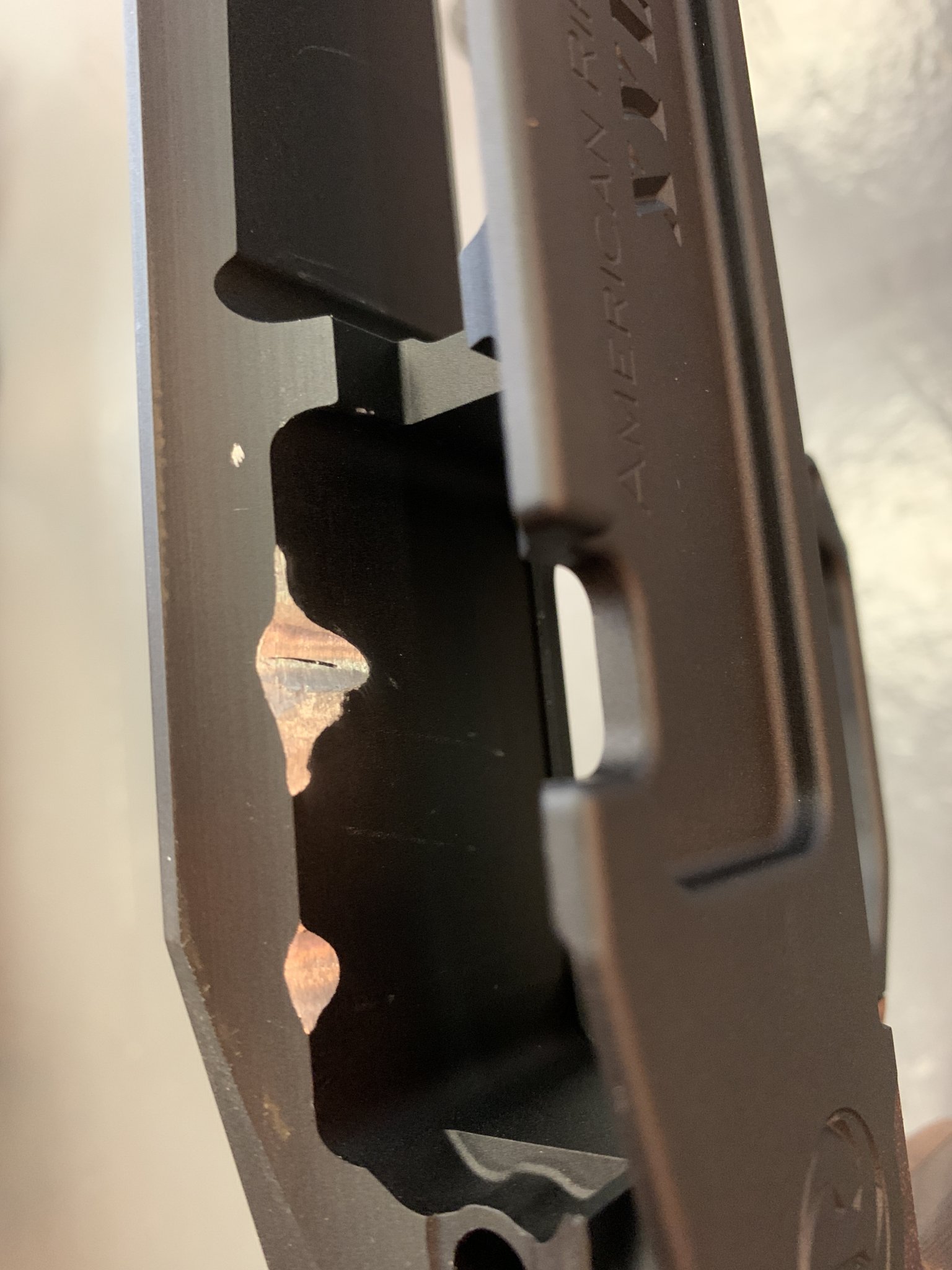

Son of a bitch. I’m going through this same thing with my new xylo from the July 4th sale. Went to clean the barrel and couldn’t get the bolt out. Went to google after I had already set about to fixing it myself… only see the first result is a thread where I’ve already commented trying to help diagnose it for someone else. :confused:
Factory 700 receiver with ptg bolt fitted to it.

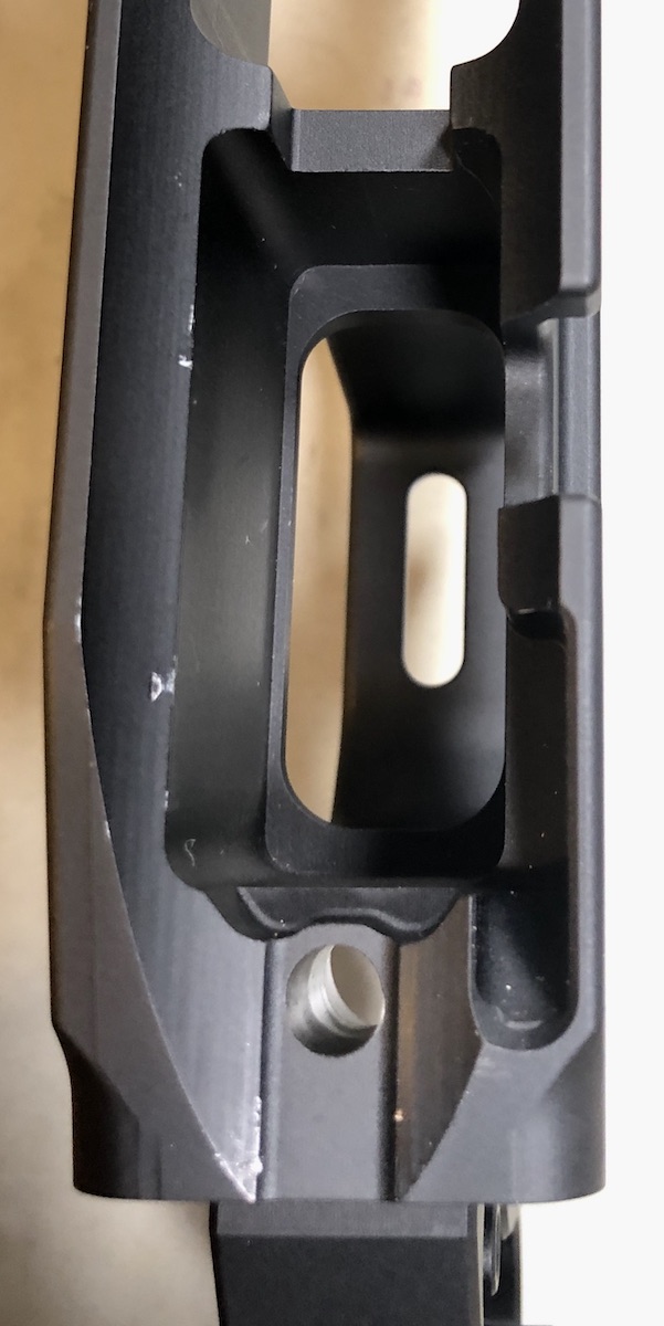

I was dumb and didn’t take a before pic, but the bolt release would go no where. So I started grinding where I can see those same interference marks from the OPs pic to clearance it. That wasn’t enough.
First off, they knew about it half a year from the OP before I got this chassis and as established above the pocket isn’t even long enough for the release in the first place. Could see a mark on the bottom of the release where it had been scratched against the chassis. So I had to grind like .3 inches off the end of the release to make sure it was clear of that interference mark.
This is what I removed on the bench grinder.
With the lug against the chassis but the back lifted up a smidge you can see down into it where the radius of the pocket stuck into the releases travel marked here back to the bolt stop. The little shiny spot between the red lines is where the bolt release was hitting originally with a matching mark on the under side of the release.
So I got that shortened up on the grinder plus a little bit for good measure. Still no go.
But I can tell the end of it is no longer impeded when I tilt it forward and see and check figment and if I rotate the action so the release is hanging down in free space it works. Now it’s just the sides of the chassis that need to be relieved. So I went to town with a dremel again.
The forward most mark is where the release was hitting originally, its way over on the side of the chassis!
You can see where the spring is scratching still where it slightly hangs over/onto the release but it can now drop enough and then, I guess, bend over a smidge once it’s low enough that I can now remove the bolt. So Ill say Ive clearanced it enough even though its still not "clear"

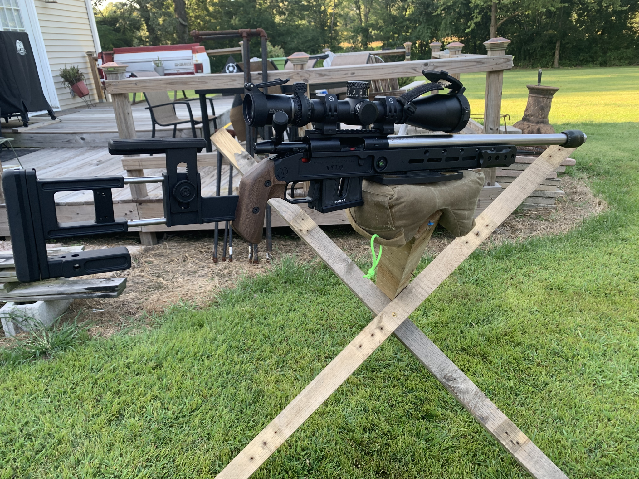

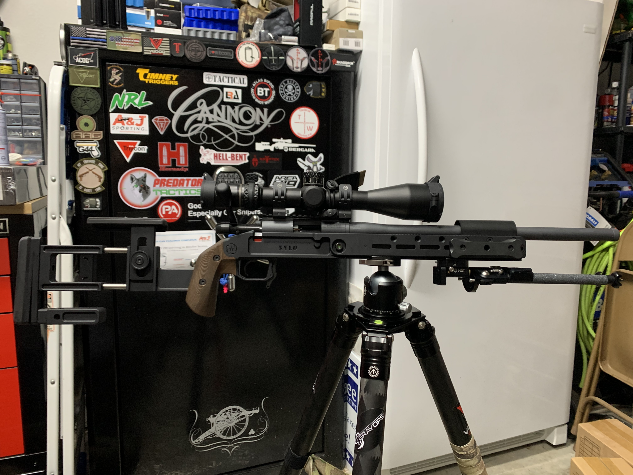

I have put RimX, Vudoo & Bergara Premier action in my XYLO without any issues at all. Pictures on the RimX & Vudoo. If you are worried about it not being right contact them before you buy it and tell them what is being dropped in it. I would be willing to bet they make sure its right before you get it. I am glad I have one as I was thinking about a MDT ACC.
