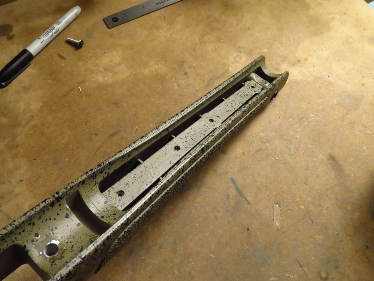

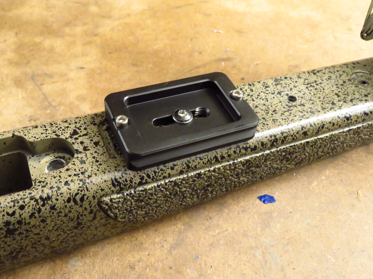

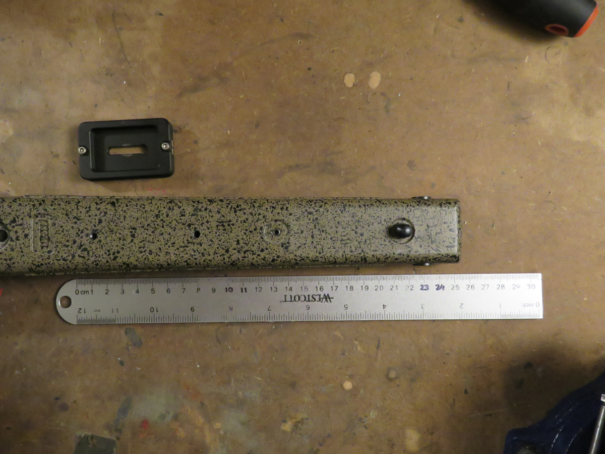

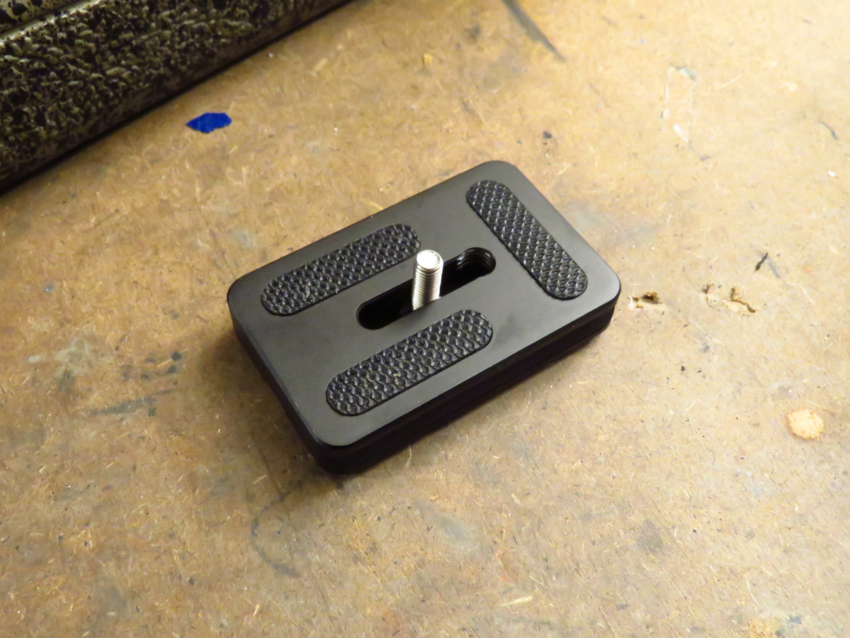

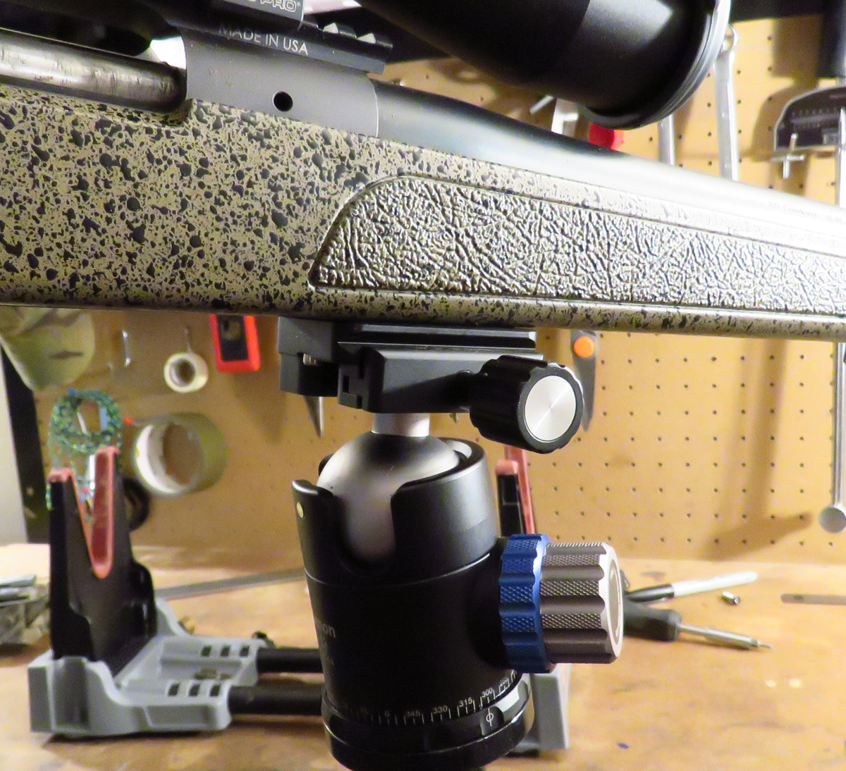

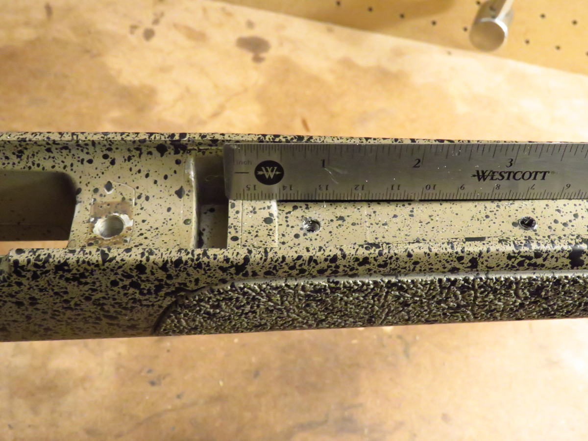

Here's some pics of how I did my HMR.
Drilled through the aluminum skeleton and tapped 10-32
If you're getting a long arca plate to attach to the bottom you'll have about 250 mm to play with.

Mind sharing what ball head ya got there and on what tripod? Appreciate the pics and would like to see the while tripod setup. Thanks!

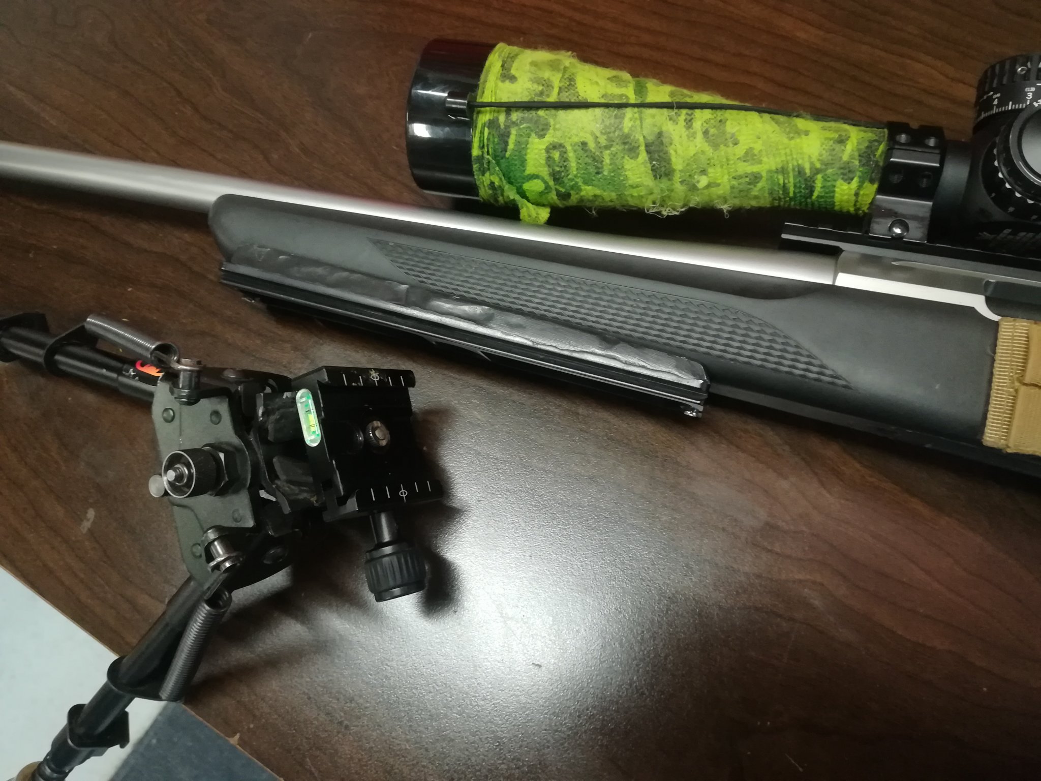

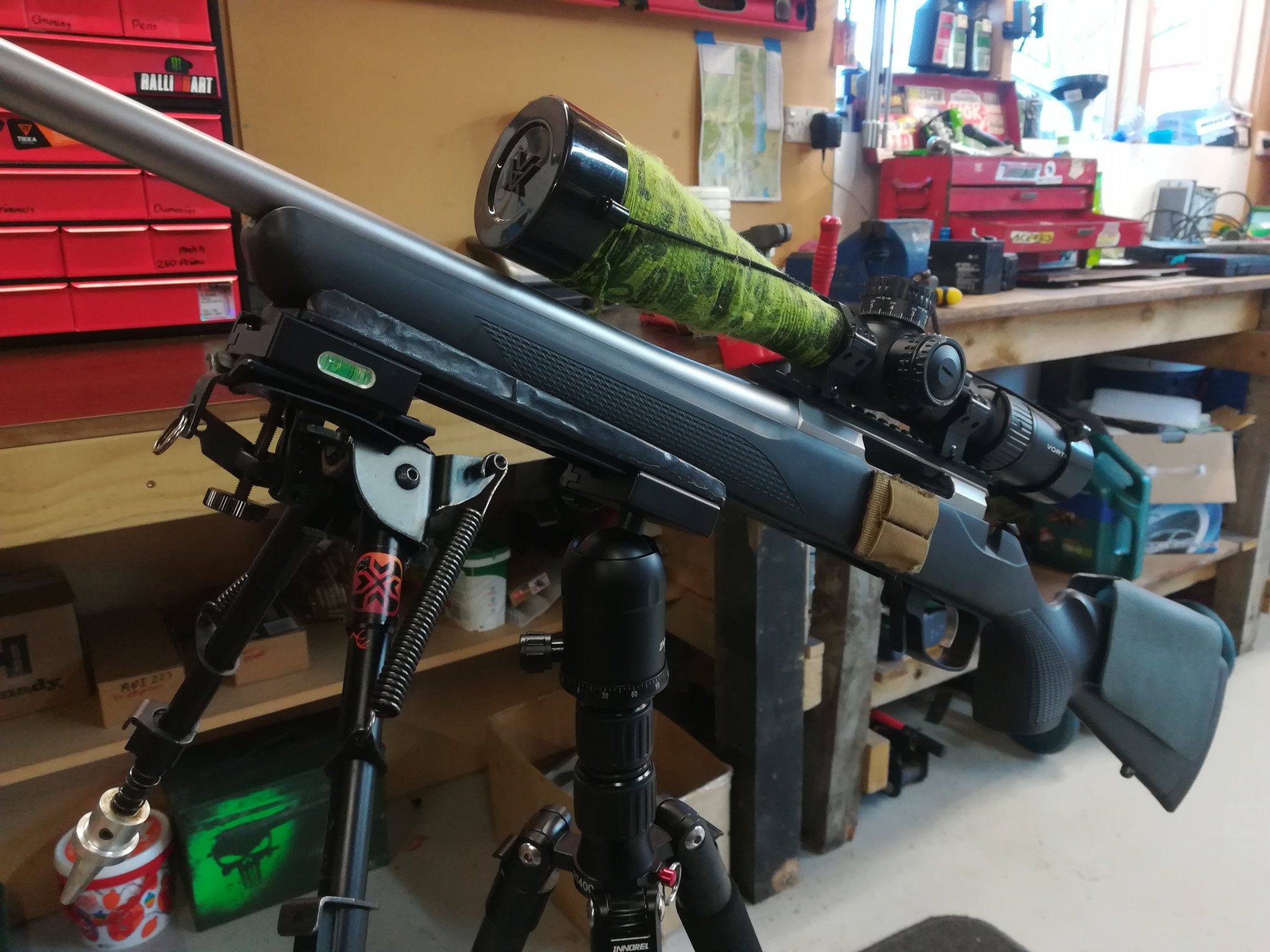

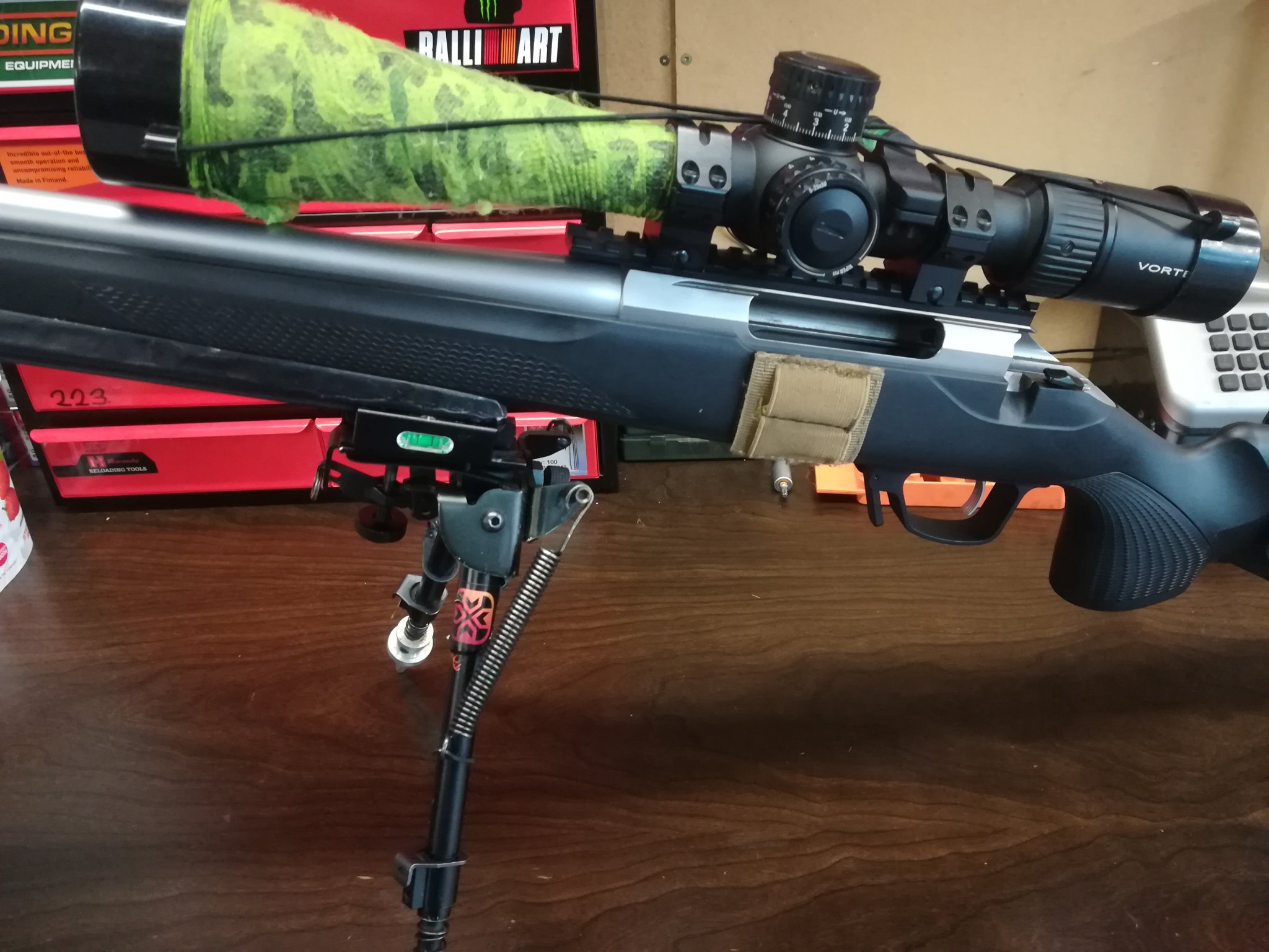

here is what I did to my tikka t3x plastic stock to fit an arca rail for tripod and bipod adjustablility. Used the 2 prefitted sling stud mounts(m5 bolt) and screwed the rail on to the stock but found with the narrow foreend it could twist a bit sideways so used some epoxy to make it lock into the stock better. Used a basic arca clamp(about $20nz) for the bipod clamp. I have now made a new direct mount clamp for the bipod.
