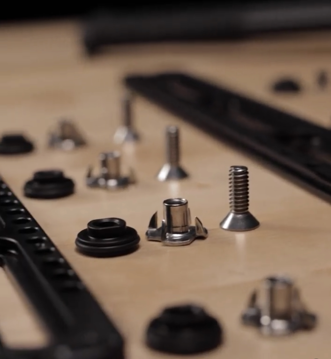

    Yes you can. One of our rails has a STOCK option that comes with the threaded t-nuts and bolts. The shuttles are threaded 1/4" to make sure the fit is a little tighter and we did a video on how we did it with normal tools at home. We are not gunsmiths. You could do this with most types of dovetail rails out there.
    Example of what I was talking about:
    USR-240 with Stock Hardware
    Screen grab pulled from our social media
    I also went with a full-length rail, the Henderson ultralight one, and had to add a T-nut such as mentioned above to my wood CZ 455 stock; in the Bergara HMR stock, I just drilled the aluminum chassis and tapped it to accept the same screw as the T-nut. Worked great.

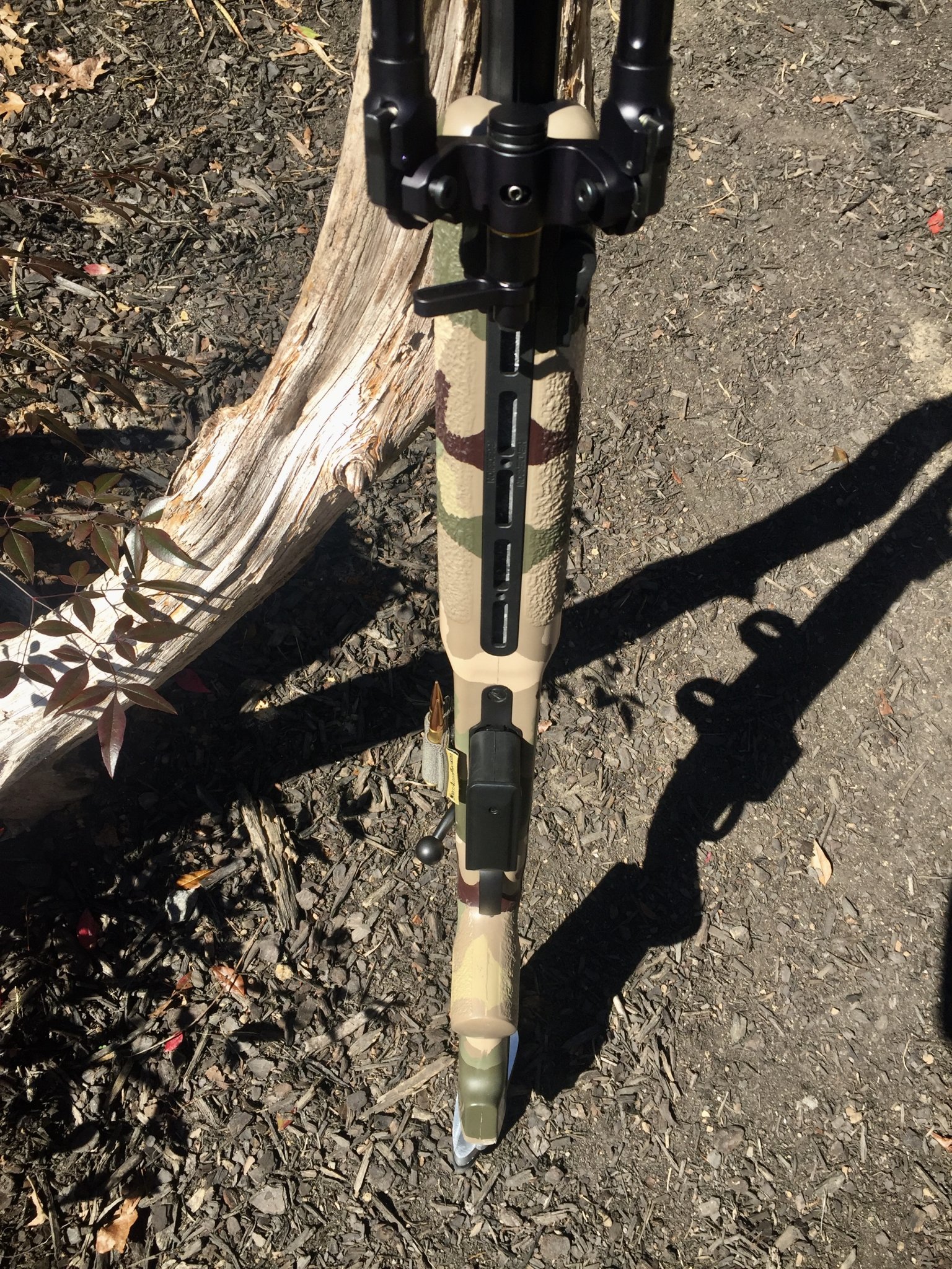

    I had this Henderson rail installed by McMillan to provide options for both picatinny and ARCA use as needed. Worked out perfectly.
