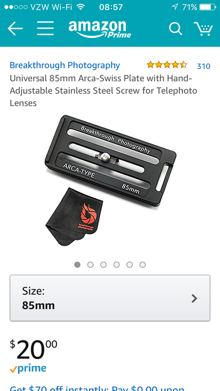

Is this what I'm looking for?
Best option by far is the dovetail cut directly into your chassis. You might reach out to Matt Yore at Sawtooth Rifles, he's done a bunch and is already tooled up to do it. I believe he was doing it before MPA started offering it.
If you just want a plate, buy a longer generic Arca style plate off ebay... something maybe 4" long with 2 screws and enough room to reach two of the threaded holes in the center line of the stock. Figure out what thread pitch they are and swap out the two screws from the plate so that you can screw it directly to the chassis. Might take a bit of drilling on the plate.
Last resort option would be using the picatinny trinity rail, then a Arca to Picatinny plate adapter like what RRS offers. That's going to be less stable and also a PITA since I think you'd have to screw on the trinity rail then screw on the arca plate every time you wanted to use it.
I got a spare plate for a Nikon camera with my ballhead. Drilled 2 holes in it and put screws with flat threaded MLOK'ish backers and was direct mounted in 10 minutes. Definitely get 2 screws or the plate will twist loose.
