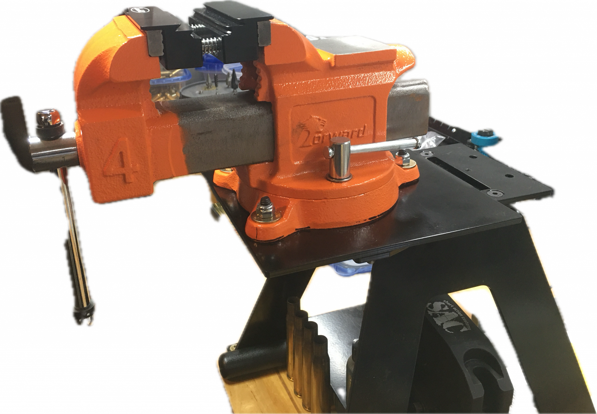

To my surprise, I can’t find anyone who makes a RRS dovetail / arca jaws that fit my vise. I am using a Wilton.
From my web surfing I found the “dependabite” which isn’t rated for barrel swaps, and the orange vise and area 419 kit (1600)
I was just thinking, there has to be a way to mount my SAC modular barrel vise in a conventional vise for barrel swaps. Anyone ever done a this or have an idea?

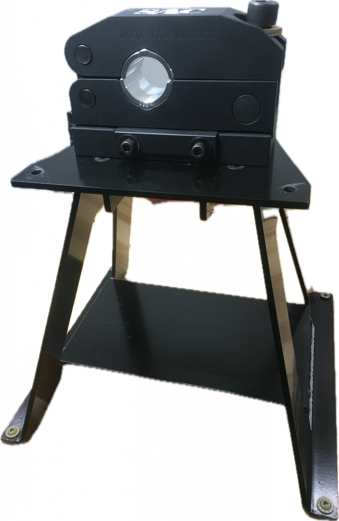

The modular barrel vise use a dovetail/arca in the base mounted to the bench.

If you make a metal block and bolt the SAC barrel vice to that, you can make it modular for fitting into a benchtop vice.
I just mounted mine to a work bench, and slide the vice in and out as required. The arca base just lives there. Its also able to slide arca of a rifle stock / chassis in there to use as a sort of work station when working on your said stock or chassis. Makes a good work holding for it.

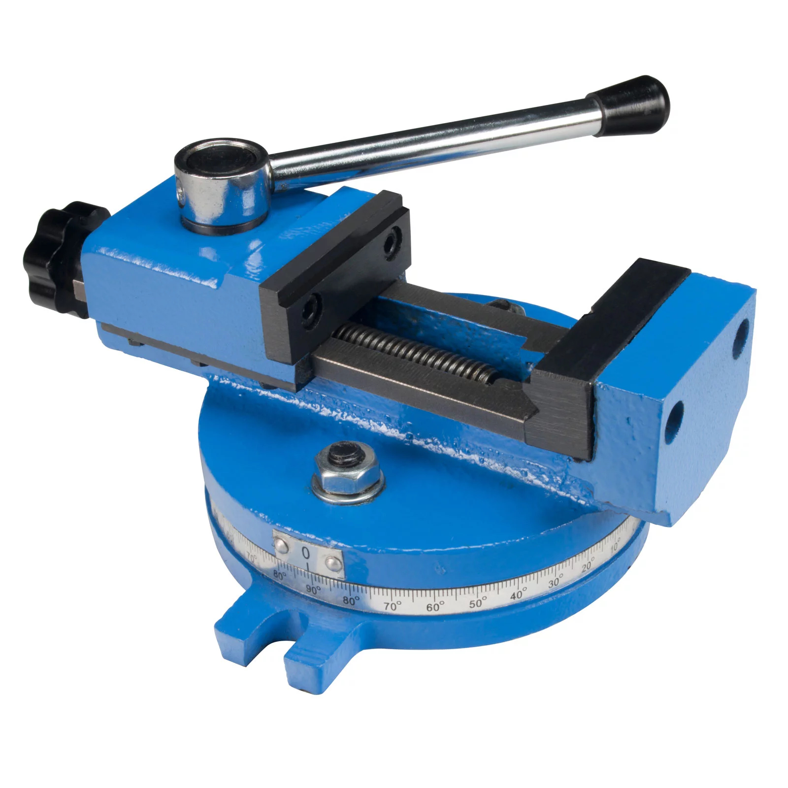

On my manual mill, i have hardened wear jaws, which basically most vices do. I manually cut a 45deg dovetail in the top edge. They still work as a normal vice, or if i want to hold onto not much, i can straight up clamp on alloy, or if i run a dovetail cut on steel, it locks super tight.
That would absolutely work. My (manual machine) vice looks like this:
see how this blue vice has a cut out at thr top of the jaws ??
This could easily be done to achieve whats needed ??

I have one of these that I use to mount my SAC Modular Barrel Vise in my bench vise for barrel work. They're strong and well made.
Reactions: FuhQ
Thanks for the feedback! This is probably the direction I will go!
The thing that makes it work well, is that you only need about 30 ft lbs on the barrel clamp (and some non-adhesive drywall tape wrapped around the barrel shank to avoid marring the finish) to keep the barrel from rotating in the SAC modular vise thanks to its design. And then it shouldn't take more than about 65-100 ft lbs to torque (depending on recommended action specs) to get the barrel on/off the action, which should be just fine on that setup.
