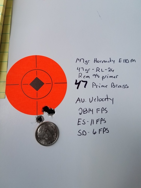

I was at the farm working yesterday, and took along the 6.5 with the plan to have a little time left at the end of the day to shoot a bit. Well, plans change and about the time I finished work I got a call that cancelled my shooting plans and had to leave early. Nevertheless, I couldn't leave without throwing a couple of rounds at the 1000 yard target. I only fired two rounds to confirm dope (overcorrected for wind a bit), threw everything back in the truck and went to grab this picture for this thread to add with the other two pics I posted earlier (all factory 147 ELDMs)
[IMG2=JSON]{"data-align":"none","data-size":"full","src":"http:\/\/i726.photobucket.com\/albums\/ww267\/darkhorsephoto\/IMG_1870_zpsbkbk6vml.jpg"}[/IMG2]
They're not doing too bad. In my 6.5x47, they would definitely prefer to be pushed by H4350 as opposed to Varget though.

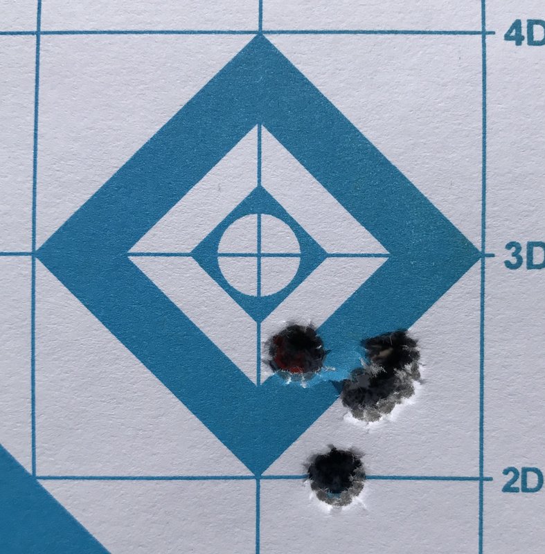

Went out yesterday for my first estimated load just to get MV and fireform some converted brass. The inconsistency from the sorry ass case and Magnetospeed can be seen on the target. 24" Rock Creek 1530 rounds down the tube. The Magnetospeed was attached at all times. Average MV 2695, SD 12.
Now I need to do the OCW and seating to tighten them up.

I started loading them .020" off the lands and they did great. I pushed them back to .030" and they shot the same. .020" off the lands is a good place to start though.

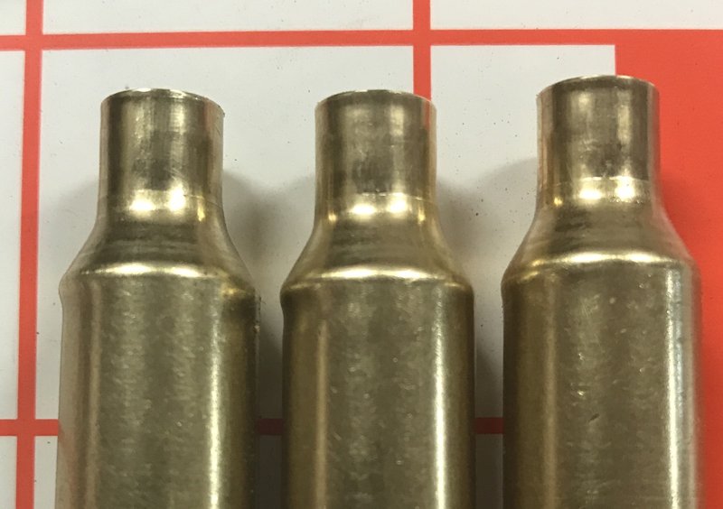

Went back out again with the same converted (deformed) cases in my above post. With a windy day in WY my OCW had to be moved in from 300 yards to 200 just to see the holes, too much mirage. Decided on 43.0, based on the node I could see, of H4350 to be my center point for seating depth testing. I now have enough fire formed cases to dial it in.
4 shot group, ran out of rounds. Very happy with the progress of the ELD-M 147's
Are you neck or FL sizing?
I took .308 Winchester brass, once fired and dremeled the neck to length (+.030 ish)
https://youtu.be/hg1lVSS38ME
Cleaned up the edges with a chamfer tool. Then used a Forster 6.5 bushing neck / shoulder bump only die and ran the brass through without a bushing in place. I tried with a bushing that would bring the neck to size but it was too much downward pressure for the body below the shoulder. Imperial wax and you have to run the press fast for the best results. This brought the neck diameter to + .011 and the shoulder to -.0015. I then trimmed to length and ran them through again with the bushing die in place, seated primer, loaded powder and seated bullet. Necks are not concentric with body but this is the process to take me to the next level with form fired brass.
So no full length sizing and just the neck bushing was used of distorted brass at this point. I plan on not full length sizing my 6.5 creedmoor unless I need it. My .308 brass has been working with only neck sizing and I'm at about 10x on a few hundred lapua cases.

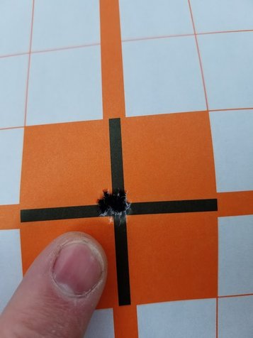

I had the factory loaded 147 eld-m shoot a 5 shot group into ragged hole last weekend when I was breaking in my new creedmoor rifle. I plan on trying reloader 26 behind these. Been reading good things about that powder and heavier bullets.

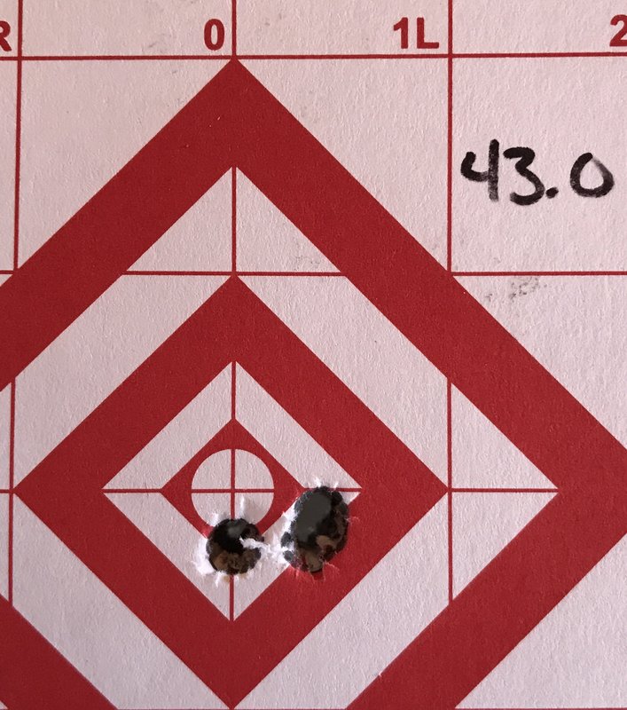

I love these 147's! A little luck on my side to pull off a nice 3 shot group (I know only three). Here's the kicker .115" from the lands was the magic number. Heading back out with annealed cases on 4th firing to confirm DOPE out to 1000 next week and shoot another group based on the number of rounds I still have left.
Hornady 147
H4350 / 43.0
F210M
Winchester .308 converted to 6.5
1.5375 / 1.920
2.215 / 2.850
.0025 Neck Tension
