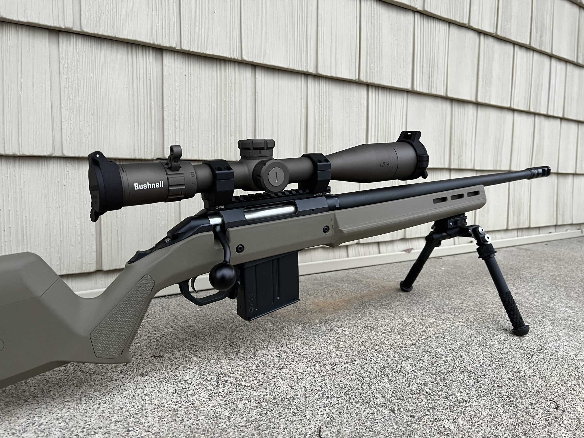

Any problem feeding out of AICs mags? I ask because I currently have a Ruger American 223 that won't feed out of them and it's a known problem with their 3 lug bolts and apparently only a problem on 223 stuff as the 308/6.5 have no such issues.
I’m running a Ruger American with the new steel MDT AICS .223 mags and they feed great! Much better than the Magpul’s.

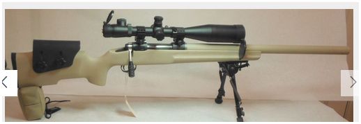

I built a 223 on a 1972 Sav 110 action with a Lothar Walther barrel.
I got the best groups ever from a 223.
I shot prairie dogs with it.
I still don't like Savage action.
