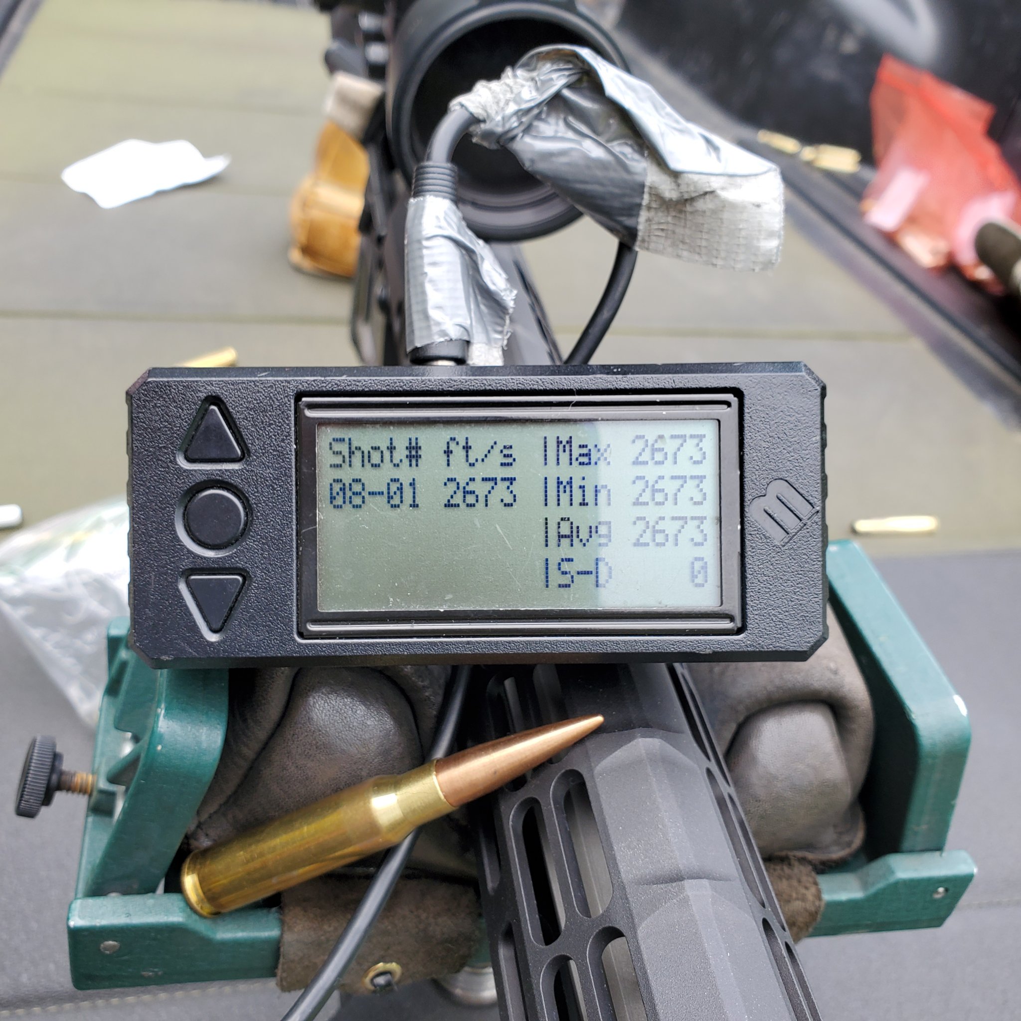

Building a 510 Whisper this winter in bolt and AR 10...so as to go elephant hunting with an AR 10. The Barrel and reamer guys are slow, modified a 338 Lapua mag for it today.
Example a warm 308 target load, 200 gr SMK .715 BC, fired in 18" AR 10 2673 fps, was 2856 fps, from a long barreled 308 Win target bolt gun.
In 6.5 Creedmoor AR 10 24" barrel 150 gr SMK 2867 fps, 140 gr Nosler 2962 fps with RL 26.
