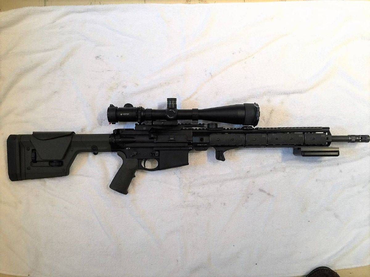

FWIW... My Criterion 18" M118LR Nitride Hybrid barrel is also a great shooter .
As pictured it was setup for accuracy trials.. it is now slimmed down, different stock and 1-8 LPVO.
Both assm. by me. ( So if I can do it.. anyone with a lick of sense can )

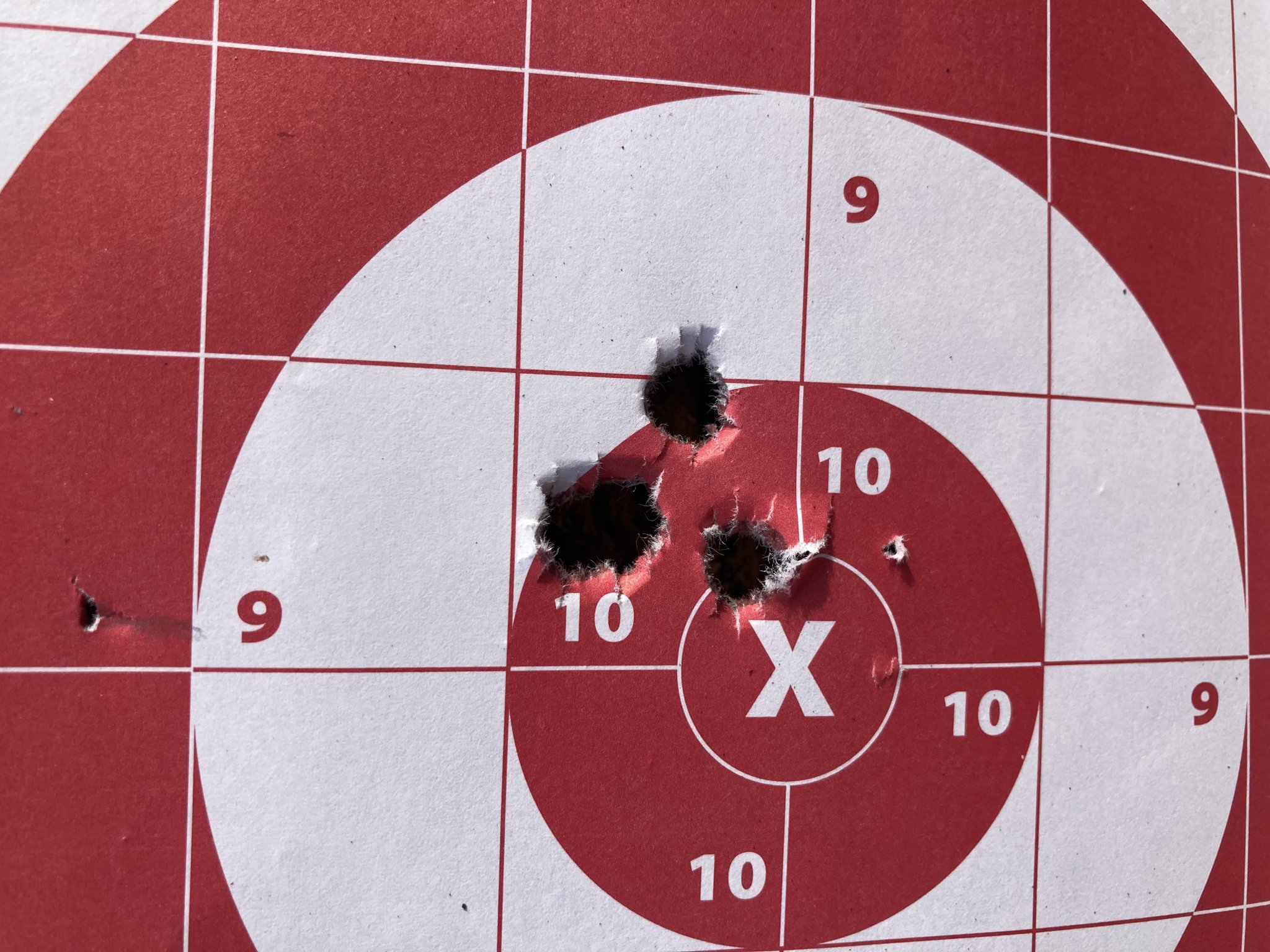

From one of my better days at the range.. and Yes I flubbed the flyer.
10rds Horn. 155gr AG , 100yds, benched, bagged... etc

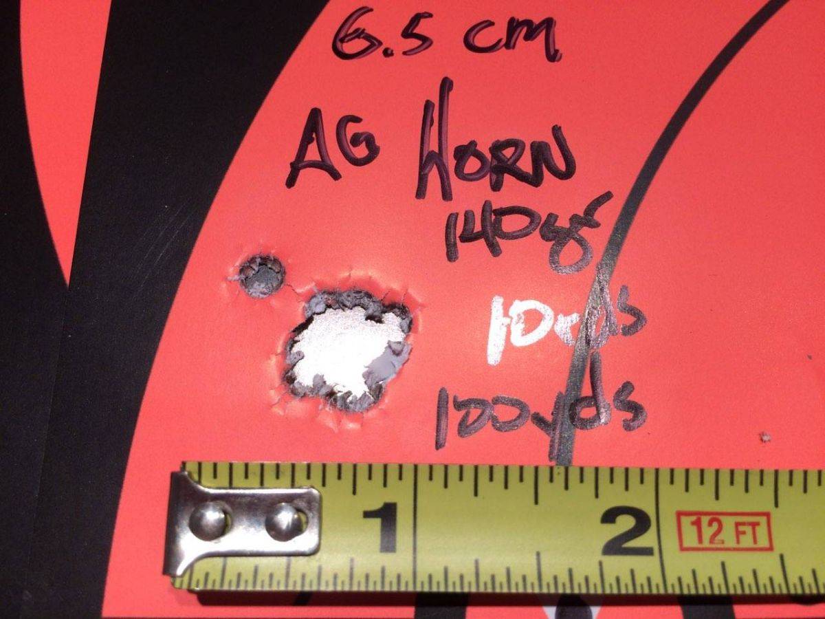

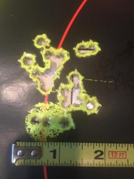

For that matter, my 6.5CM criterion barreled LFAR is also a great shooter when I do my part.
Yup, flubbed the flyer again, Lol
