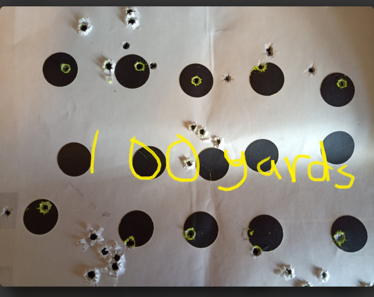

Just so people know. This is the 100 yard target he showed off on another thread. Lol
It was said here that "Bergers are the truth".

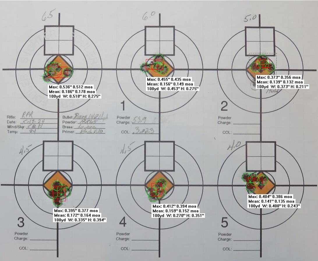

Here's some 140 Hyb Bergers from a 6.5 PRC barrel that has over 1,900 rounds through it:

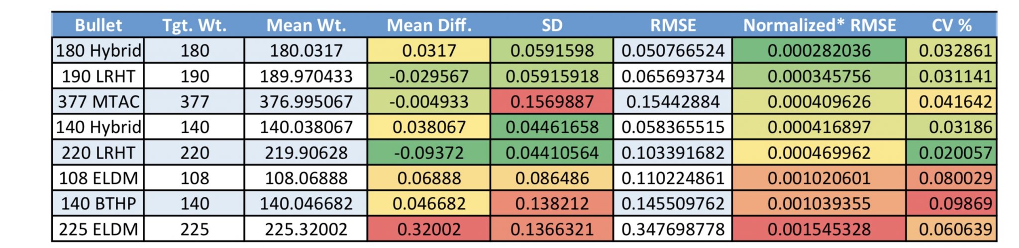

Easy answer, weigh and measure some. I find Hornady, for instance, to have a lot more variation than Berger. That will show on the target, really depends on your expectations which is right for your application.
^ This! People dont understand enough how much this matters not this fools 10 shot 100 yard groups out of what is most likely a factory gun
Yes, hence why I'm currently using Lapua as Bergers have gone missing over here for now. The Lapua bullet is not as "good" but is very consistent and shoots well in my factory Tikka. I looked at using some ELD-Ms but was surprised at the variation in just one box. My use is square range target so smaller groups matter. If I was shooting steel for fun I'd probably use something cheaper.
I'd definitely incorporate a randomly selected 20 bullet sample from each manufacturer on the next video, and test bullet CBTO, diameter (with micrometer), OAL, and weight variations.
Bonus if you repeat the test with another lot from the same manufacturer later and compare results.

Not a bad pattern at 100y really, for 00 Buck and a Full Choke.
It's funny because you fell for what the moron was going for. That target that his well aware of or just can't comprehend is all single shots at 1" dots. The top row is my son, the bottom row is myself. I was working with my son on hitting one target and moving to the next and it is a reused target flipped over.

IMHO, whether Berger's are worth it really depends on the precision you really want or need for the type of shooting you're going.
that is what I am setting out to find out for myself. I always here people say they are worth it. I have never seen them put against each other. I am compiling the data from the rest of the lot, then also going to go through some others for fun. Like SMK, Lupua etc etc.
I am trying to see how much of a diff. So far after 20 5 shot groups.....it's not much different. There is a difference though.

For myself I agree. I don't claim to be an F class shooter. I just enjoy getting out of the house once a month or so for maybe an hour to take a break from everything. When my rig, reloading skills, and shooting skills limit me to shooting just under 1/2 moa with either.....I will likely just enjoy playing around diff brands as much as sticking to just one but will shoot more with less cost.

and you would be wrong. I developed a load for the bergers. Then adapted the load to the hornady. But in that video you are only see the results of the beginning of testing.
The data you are asking for is irrelevant. It's same weight and type with a slightly diff shape. If the bergers are so much better I would not be able to get results almost as good. The question you aren't seeing for some reason is this isn't IF bergers are better. Do they make a big enough diff to merit the cost?
Both loads shoot better than factory lapua.
Am looking forward to seeing what you're able to find out. Unless you're shooting at a 1000 yds, I have doubts much difference, if any, can be see and 100.

Hey OP....what about BC consistency...ya know...the thing that ACTUALLY matters for down range performance.
Look at all the br, fclass and prs guys winning championships and setting records with hornady....oh wait..they aren't.
Seen a ton of hornady bullets blow up at matches and in training classes. Have yet to see a berger do that. Want to take a guess what that indicates?
Click bait from people who no one should be listening to. Dudes trying to get people to watch his vids, and it looks like no one is.
Nope. There are dozens of forums and users who will attest to the large variance on hornady in weight and oal vs the Berger.
It's not so much the OAL as the ogive, the bearing surface and tail dimensions.
I asked litz about this when I discovered oal variance between lots of 109s. He said not to worry about it as the bearing surface and ogive dimensions are the same and it should shoot the same lot to lot. I tested it and found to be true.
Hornady is an order of magnitude worse is variability from jacket thickness to critical dimensions. It's one of the reasons they start to blow up once they hit 290k+ rpm. Fast twist and high velocity ( such as a 6 creed going 3k+ and a 7 twist barel) is bad juju. Meanwhile they tested 6mm bergers with a 4 twist barrel to see if they would shoot better and they held together. Do the math on that.
