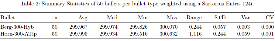

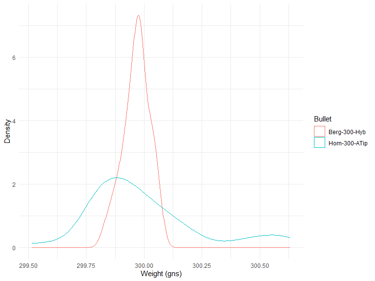

Since Berger made the move the points on the 300 grain Hybrid OLGTM look like shit.If you just shoot 100 yards you wont notice it.But shoot 1500 yards and farther to 2900 or farther like are horrible. I should have stayed with Hornady ATips or Cutting Edge Lazers. I did not know Bergers quality had gone done so much.They used to have pretty bullets.All unifoirm and ice meplat/tips.Now they are knarly. So no they Are Not worth the money.
Try weighing those hornady then come back. Metplat deformation is like a 2% error in Bc. Having bullets with crazy variance in length and weight is a way more obvious and intrusive problem
If you’re seriously shooting past 1500 then tipping and sorting components starts to become justified as well which will easily take care of that.
Reactions: TreyMeTrey
I weigh and sort all bullets.Ive had less problems with A Tips mand Cutting Edge than these new Bergers by far.Since Berhger made their move their nstuff has suffered..And Im not they only one saying and seeing.
You’re the first person to ever report hornady weighing consistent. Thats a bit suspicious. Most people I know are shocked when I tell them to go weigh 25.
I’d still take the Berger over hornady but I’d be tipping regardless if I was shooting elr.
Reactions: simonp

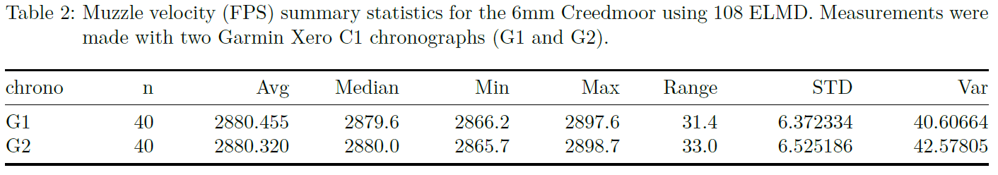

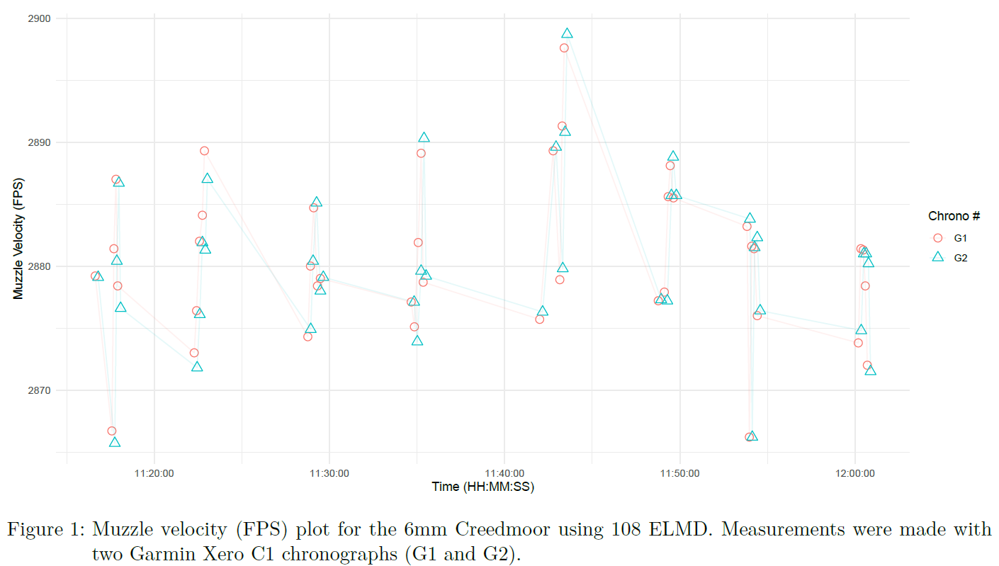

I don’t compete but I do shoot seriously out to 1200 yards. With the garmin chrono I am getting speeds a lot more often. Despite what I feel is a reasonably solid reloading process and match components, I’m still seeing way too much ES and SD.
After weighing some of the Hornady 140 eldm I am convinced they are the issue.
Price certainly is a factor but my main problem with Berger is availability. On this Hornady excels. I’m considering just having two different loads for my rifles, Berger when they’re available, Hornady when they’re not……
Hornady are definitely all over the place as far as weight and the bergers i have been weighing are very consistent. With 105s I didn't see much of a performance difference (there was some but not HUGE) between bergers and hornady. I tried some barnes and I got mich worse results.
Now I am loading some hornady 140 match and berger 140 hybrids. Now I want to see how big of a difference between those. Not even going to waste my time on barnes MBs.

of note, when I tested the 6mm, I used all Lapua brass. I have poop ton of once fired Hornady brass as I have shot a lot of factory ELDMs (and some friends have as well). My intial tests showed really poor ES & SD with that brass, so I am going to procure some Lapua for that as well to remove a variable.
I decided to share this info NOT for people like deathdismount who know everything, but newer folks who may find it helpful and those like myself who enjoy seeing the experience others have with similar products before using them and being able to compare their results.
@tinker thanks for posting. I find this information interesting as I’ve never had a Hornady bullet in any rifle best a Nosler CC, even the scratch and dent ones. I’m about to try some Sierra’s for grins, but haven’t messed with Berger’s because of the cost and availability not to mention I only have a 600 yard range to shoot on and would likely see very little difference.

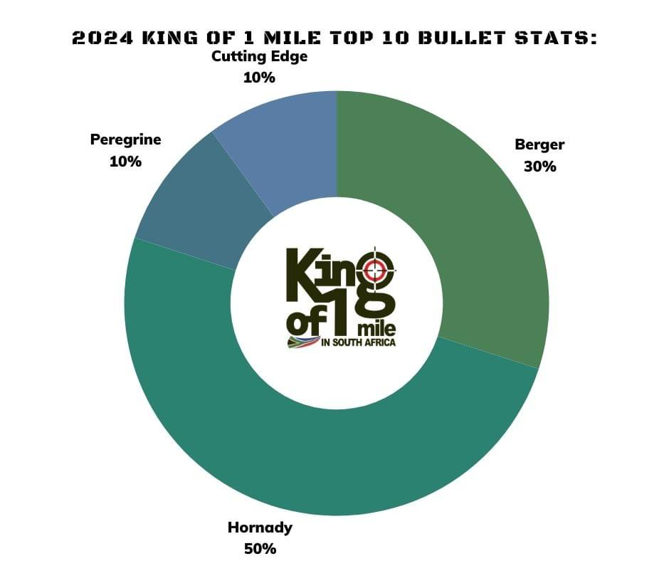

Thought this was interesting. Anyone with three (or one) statistics degree knows that this isn’t enough information to conclude anything. Still, interesting.
Maybe it’s influenced by supply issues on getting certain brands of bullets in that part of the world. I was just looking at the 2022 U.S. Ko1M equipment and the Berger and Hornady percentages were reversed.
Supplies, sponsorships, shooter representation (or lack of), scheduling conflicts, and probably more issues.
None-the-less, we know that inconsistent ammo does poorly in ELR matches. It’s hard to narrow down the factors when all we have is a proportion chart.
