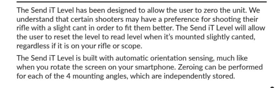

You can zero it to whatever you want, you can use it to level a scope, battery life is better than Send-It, you can upgrade the firmware, etc.
I have no ax to grind about the SG Pulse...never saw one. But:
1. The Send-it also allows user zeroing and can later be reset to factory settings and calibration
2. Battery life....not sure I'd need more than 100 hours. How many battery hours on the SG Pulse...do you know?
3. Use to level scope - I don't see why this is a distinction between the two? There is no reason you can use the Send-it to level...well, anything. Its a level, eh? :cool:

The zeroing process for the SG Pulse is way, way easier than the send it. It's a simple push of the button on the unit OR pressing the calibrate on the app.

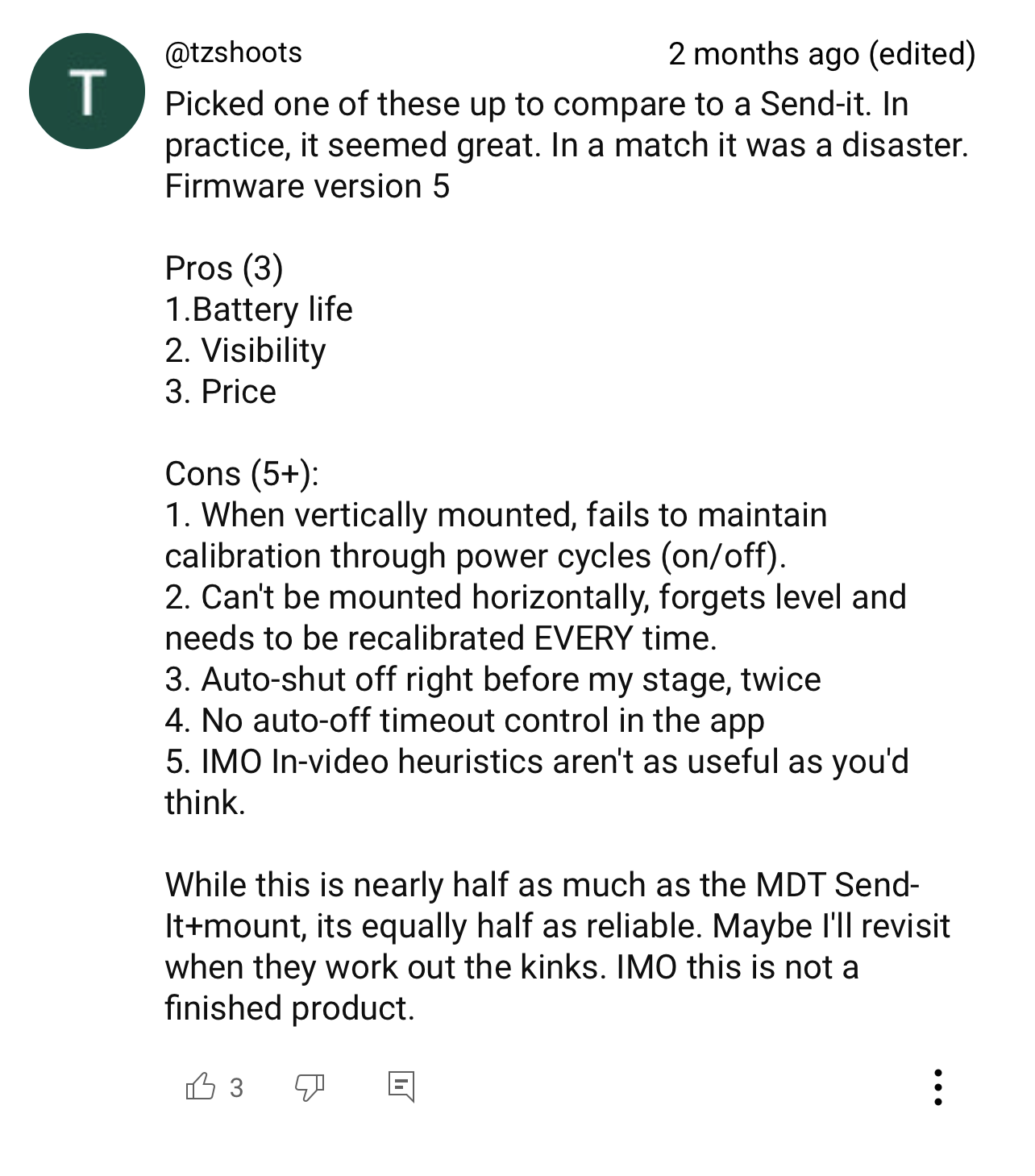

Some of the comments in xring’s review are not confidence-inspiring.
For example, YT user named tzshoots says this:
This review isn’t great either
Maybe the company has corrected these issues?

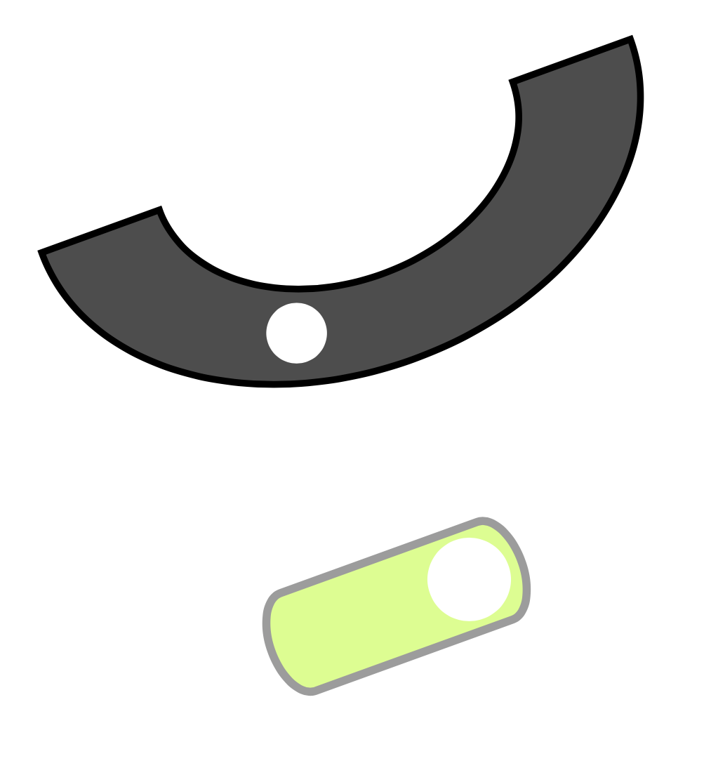

Even though Frank poo-poos using a level on the gun (he’s prob right), since I already had a couple I slap them on.
I like my Accuracy 1st level the most, which reacts quicker than a bubble level (uses a ball, not a bubble) and can be more intuitive when correcting the cant. Also have the little bubble level that comes with the Mbrace mounts.
For example, I think we’ve all been there with bubble levels at one point in our lives. “Which way do I move the < insert object > to level it?” I’ve often thought. In my case, I then move the gun the wrong way lol. (If you use levels a lot, this mistake can go away)
I’ve gotten better with bubble levels, but there’s always something a little counterintuitive going on with them. Probably because the cylinder models we use are so short. And I suppose many people don’t tend to work with “floating dynamics” that much in their day-to-day lives.
See my below rough sketch. I find the Accuracy 1st (top) “interface” much more intuitive vs the bubble level (bottom). With the latter, there always seems to be an intermediary mental step that happens in my brain when I go to level.
Of course, a bubble-type level does you no good if you cannot focus on it. I’m struggling with that now.
Top drawing also looks like one from Badger Ordnance.
