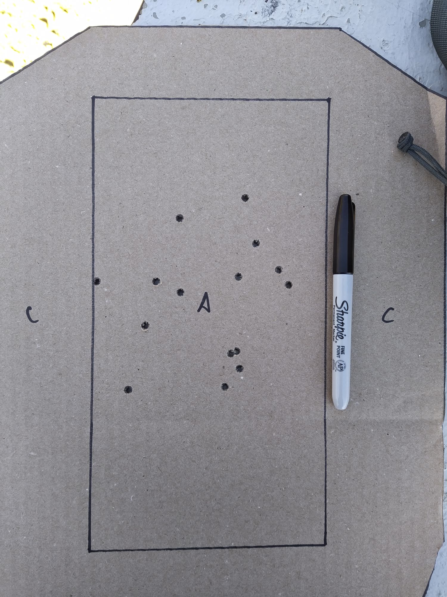

Disclaimer: Yes, I'm a decent shot. I've shot well under 1MOA with my bolt gun from the prone. Yes, this was my first AR build, but I'm pretty competent and handy so I feel like I assembled it to the best of my abilities.
Context: Put together my first AR this past year. 14.5" Criterion CORE barrel, Brownell's BCG, DSA upper, Steiner T5Xi 3-15. It has right around 200 rounds on it right now. Shot 77gr S&B at like 3MOA, and this photo is from today with Freedom Munitions reman SS109. Sharpie for scale, but it's like 4.5MOA.
Now, this rifle was never meant to be a dedicated precision platform. I wanted a good general purpose rifle that I could stretch into whatever role I needed it to be. I tried to be as realistic as possible with this rifle. I wanted 1.5MOA with match grade ammo. S&B isn't exactly the epitome of match grade, but I thought it would perform better than it did.
Blaster ammo: My expectations weren't exactly high, but 4.5MOA doesn't really cut it for me.
I should probably order some FGMM or something good for absurd prices and see how it performs before I do anything drastic, but if that doesn't do it do I just tear down and rebuild the thing?
But maybe my expectations were too high?

I'm guessing that something might be loose. My first build shot about like that, I didn't know what to expect. I swapped scopes and double checked my mounts and the groups tightened right up.
That's the first thing in my mind. I'll double check the Spuhr to be sure, but the whole thing's spray painted and it doesn't look like anything's moved.
Reactions: CMGesell5.56
you can always get better , if your willing to put in the effort . People aren't born with the ability to wipe there own buts you learn how hopefully . Id say keep your expectation high , and shoot for the moon believe in your self cause only you can make your dreams come true or is it only you can prevent forest fires either way best of luck hitting that one hole 5 shot group at will at almost any range . :rolleyes: :ROFLMAO:
SS109 has a steel cone inside the nose that isn’t exactly perfectly-concentric to the overall projectile form. Especially in a 14.5” light weight AR-15, looks like you shot a great group with them.
The last time I shot on a KD range with M855 from an M4, I was lucky to get a 24” group maybe, and I was using the magazine as a monopod from prone, rear support, really good position laid-in on a grass range. That was from a rack-grade barrel of course.
With my personal rifles at the time, including AR-15s and an AR-10, I was shooting MOA or better easily.
Noted. No more SS109/M855 for me 😂

Shooting off bipod and rear bag when I'm shooting for accuracy. I've verified, everything is free-floating as it should be. I even tuned the gas tube when I did the install.
Muzzle device is a Smith Enterprises G6-A2 flash hider. Upper and lower have a bit of slop to them (how much does that matter aside from fit and finish? All the accuracy happens in the upper, correct?)
I'd like to avoid removing the handguard if possible. The BCM MCMR is going to be a pain in the ass coming off. If I get to that point, I'll cuss it then. Barrel nut on that should be steel .
