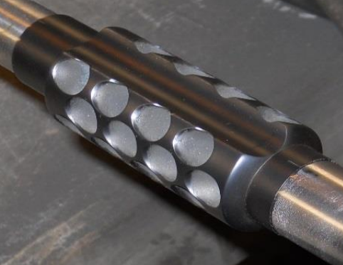

I have not touched base with Mic McPherson since COVID-19 began. I would recommend a simple little high-evacuation-rate brake on the straight walled 45/70, no matter how hot you might load them. I used bulk packed Remington 300 grain JHP bullets at 2300 fps for plinking from Winchester high-wall and Marlin lever rifles. No MB needed.
The difficult machining of the LAW MB is installing the gradual straight inside taper: step drilling followed by step reaming. I recommend using a leaded steel alloy such as 12L14 for the LAW MB, given the amount of stock removal required. That is what mine are made from with a nice chemically applied finish.

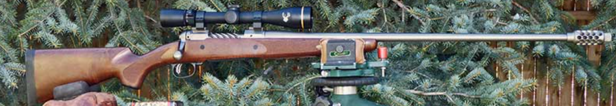

A photo of my 338-caliber LAW brake installed on a Schneider test barrel along with some shop-made barrel tuning devices is included near the end (Page 25) of the attached paper on rifle barrel vibrations. The data used comes from QuickLOAD(c) and my own (freely available) Excel spreadsheet calculations.

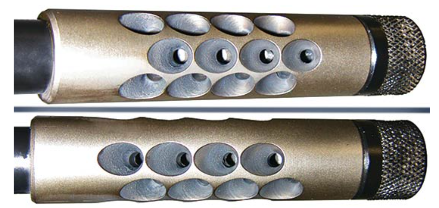

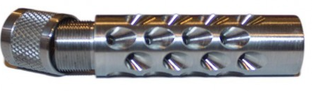

Here are all the variations I've found online, so far:
This one from Guns Magazine looks to need timing. Also looks like the holes go from cylindrical at an angle to conical at an angle.

You'll recognize this one of course. Looks more unique compared to the others and needs timing.
And finally here is the "knockoff" that Pacific Tool makes which looks like a hybrid of the 1st and 2nd pictures. Seems to have cylindrical holes at an angle that open up into conical holes at an angle, but no timing needed
My 6.5 and 338-caliber LAW muzzle brakes were custom designed by Mic and me for hard-mounting Magneto-Speed chronograph sensors. The bottom groove is for clearance of the shop-made offset sensor front-mount, and the top groove is for symmetry. The top plane of the inductive sensor must be parallel mounted 0.25-inch away from the bottom edge of the rifle's bore.
Timing the MB to the barrel is quite simple, as the muzzle of the barrel seats inside the MB on a 60-degree conical shoulder. Just trim the muzzle corners at 60-degrees until barrel/MB timing is correct. This conical mechanical interface provides great mechanical strength and alignment accuracy.
