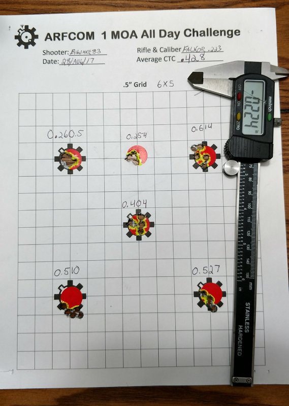

I would love to see that 5x5 target. Ive only seen a handful of gassers in my life that shot consistent 5x5 "WAY UNDER" 0.5moa all day long groups. Pics or it didnt happen. I can show you cherry picked groups in the .1's and sub 0.1's too.

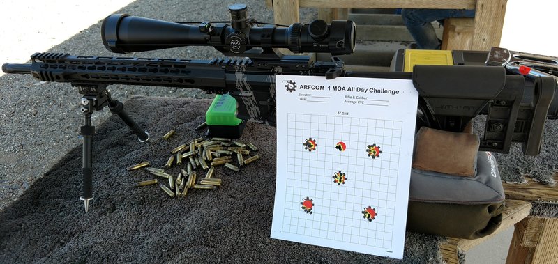

This is my latest build using a CLE Bartlein Barrel and Hand loads... I did a thread showing in detail how to achieve this result it doesn't take much to do a bit of research..

Just a small point, however, my experience has been that the mark on a target left by a bullet is always measurably smaller than the bullet diameter. And, the margins of the tear are usually poorly defined...
