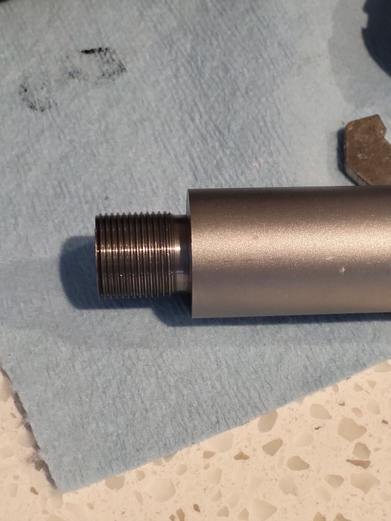

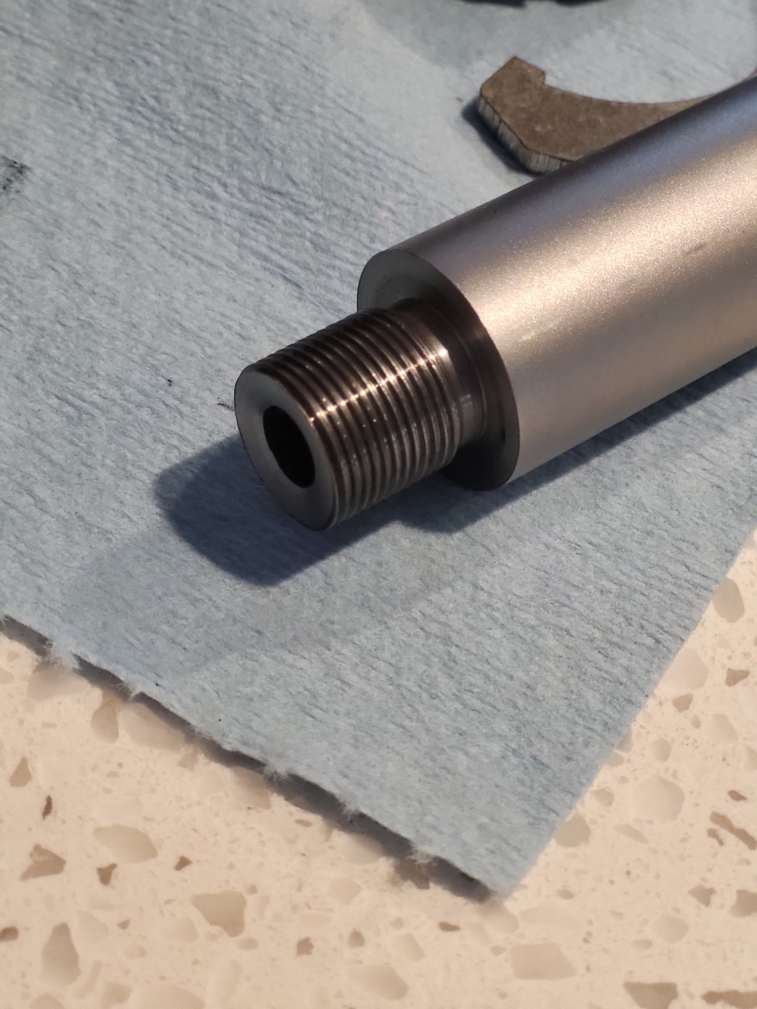

Are these threads OK?
mzvarner
Mar 7, 2013
510
378
Spokane, WA

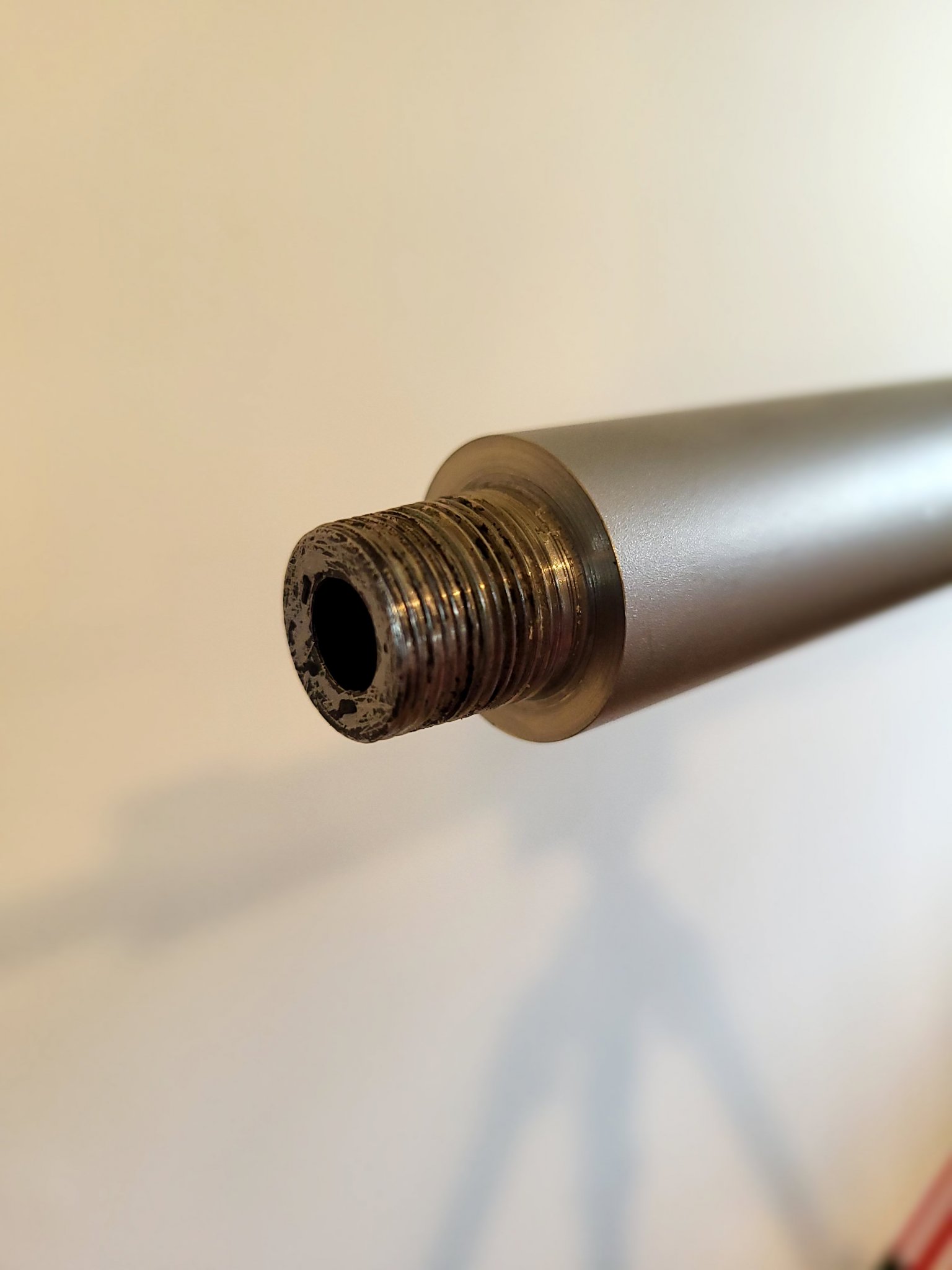

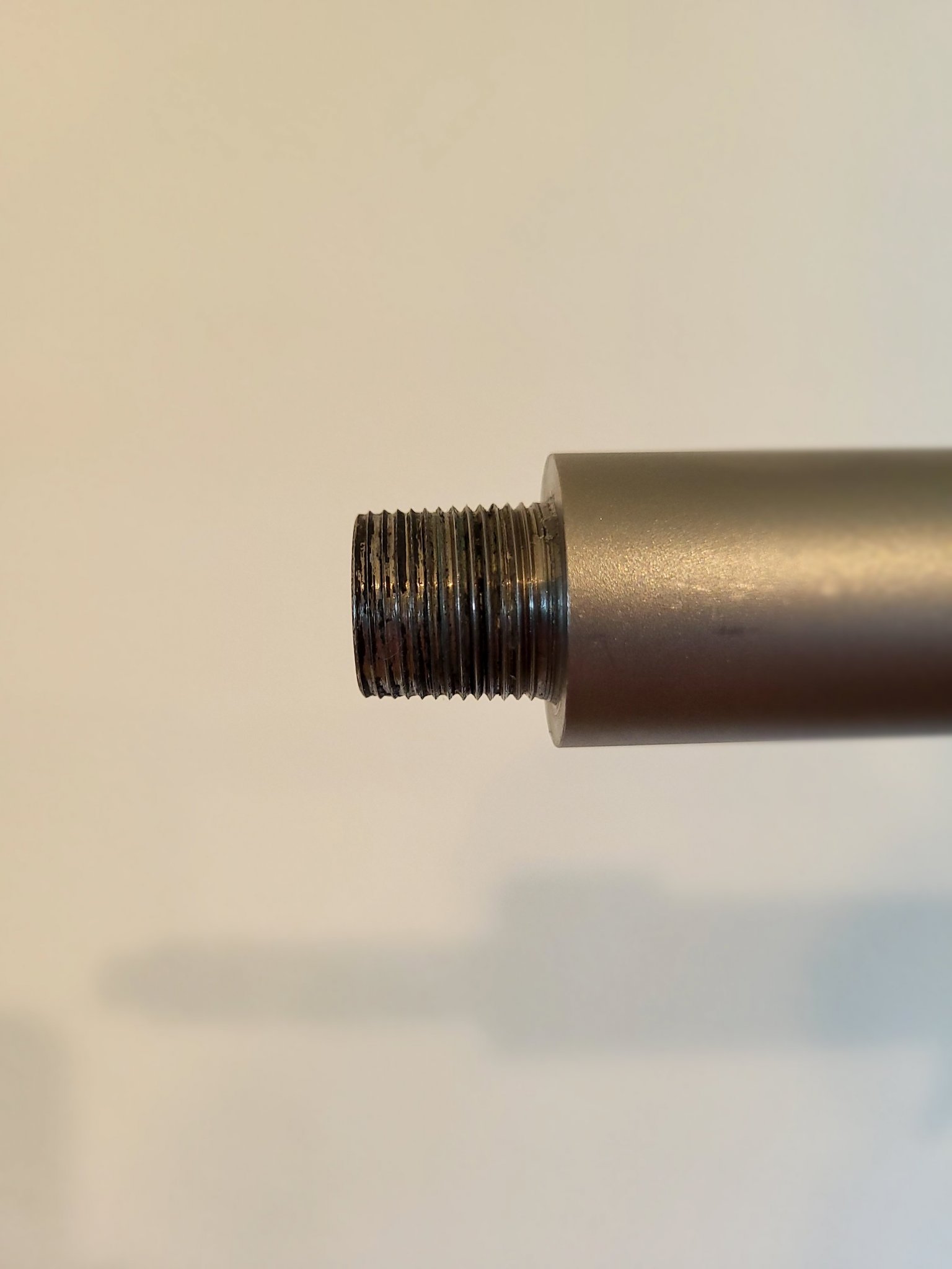

Wilson Combat barrel in 308 win. Had threaded by a local shop in anticipation of suppressors. Had a Dead Air Key micro brake with a touch of Rocksett for the Sandman S while I waited for the Nomad Ti. The sandman s set up shot great.
Boiled the MB to release the Rocksett. Brake came off easy. No die to clean threads so used a dental pick to scrape the gunk off.
Since I was so close with the pick, I noticed they look wonky to my untrained eye.
Looking at tap and clearance drill sizes 5/8 x 24 major diameter is 0.625 and minor diameter is 0.5739
Mine are tapered so:
Major diameter at muzzle are 0.591- 0.630 at the shoulder
Minor diameter 0.573 at muzzle to 0.594 at shoulder.
Not sure about the threads, however I’d say the threads should leave a 3/16 gap and not be threaded up the the “step” back to full diameter (or whatever the correct term iso_O
...Those are terrible. Whoever cut them shouldn't be let near a lathe (assuming they used a lathe) until they've learned how to properly cut a thread. They also didn't cut a relief at the shoulder against the barrel. The inconsistency in the root of the threads is almost comical.
Happy to help.

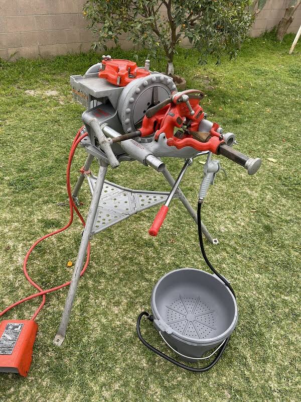

A while back I inherited a small lathe, watched a few youtube videos, and cut my first thread. It looked similar to that.
When I measured it I laughed and said pipe thread.
No way should anyone that charges people for cutting threads deliver that.

By the way, Wipe Out does wonders in getting that stubborn carbon off the crown/face of the barrel.

Contacted Eric at Mountain Shadow Arms, in Spokane. He was shocked the original threads left his shop. He asked for 5 days to make it right. Id say he did a great job with excellent customer service. i offered to pay him partially for the quick repair and he turned it down. See how it shoots later this week.
