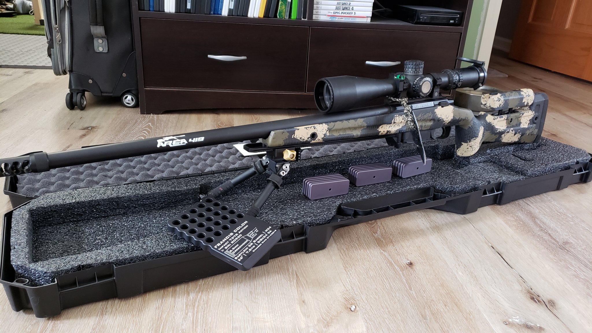

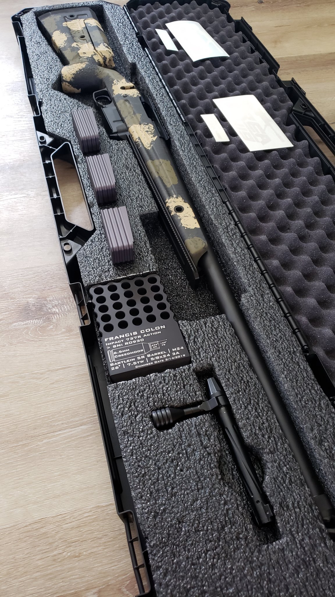

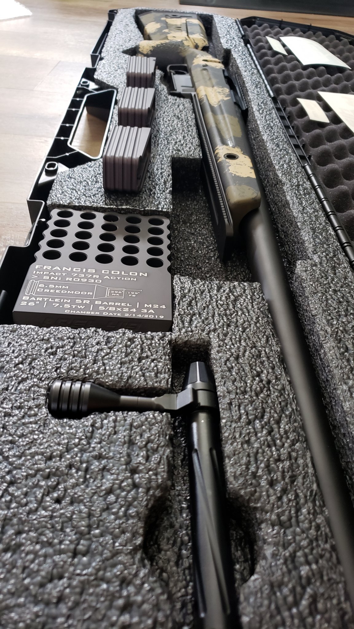

Quick post on new build and huge thanks to Area 419 team! I was back and forth between a 6.5CM and 224V bolt gun build but decided to go with new competition setup.
Craig, Simon and Jon @Area419 were awesome to work with thoughout the process and super fast turnaround! Door to door less than 2 weeks!
Build:
  • Impact Precision 737R
  • Manners PRS2 Area 419 Camo with Gen2 Barricade Chassis
  • Bartlein 26" 7.5T M24 6.5CM cerakoted black
  • Triggertech Diamond Pro Curved @1lb
  • Area 419 Hellfire 6.5CM Brake
  • Area 419 Arcalock 14" rail
  • (3) Area 419 mag extensions

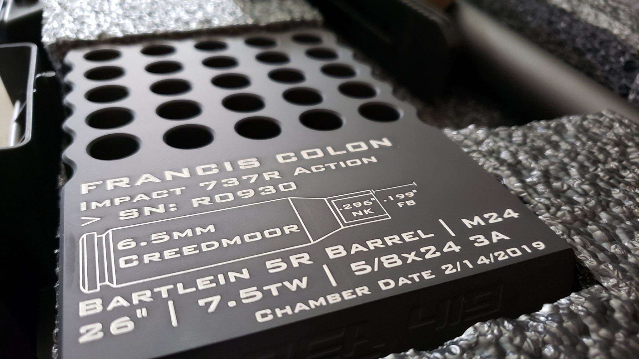

Cool personalized touch/surprise: the personalized Area 419 billet loading block cerakoted to match my barrel/action! Includes name, cartidge details, and date barrel was chambered. Super slick way to cap an awesome experience!
Also, I wanted gun metal mag extensions but they were out of stock as of Monday... Called them Monday afternoon and they said "We will see what we can do.". Rifle shipped yesterday and low and behold they made 3 gun metal extensions and shipped in less than 24 hours. AWESOME!
Photos of build:
Pumped to get some time on range with new rig and put it through the paces!

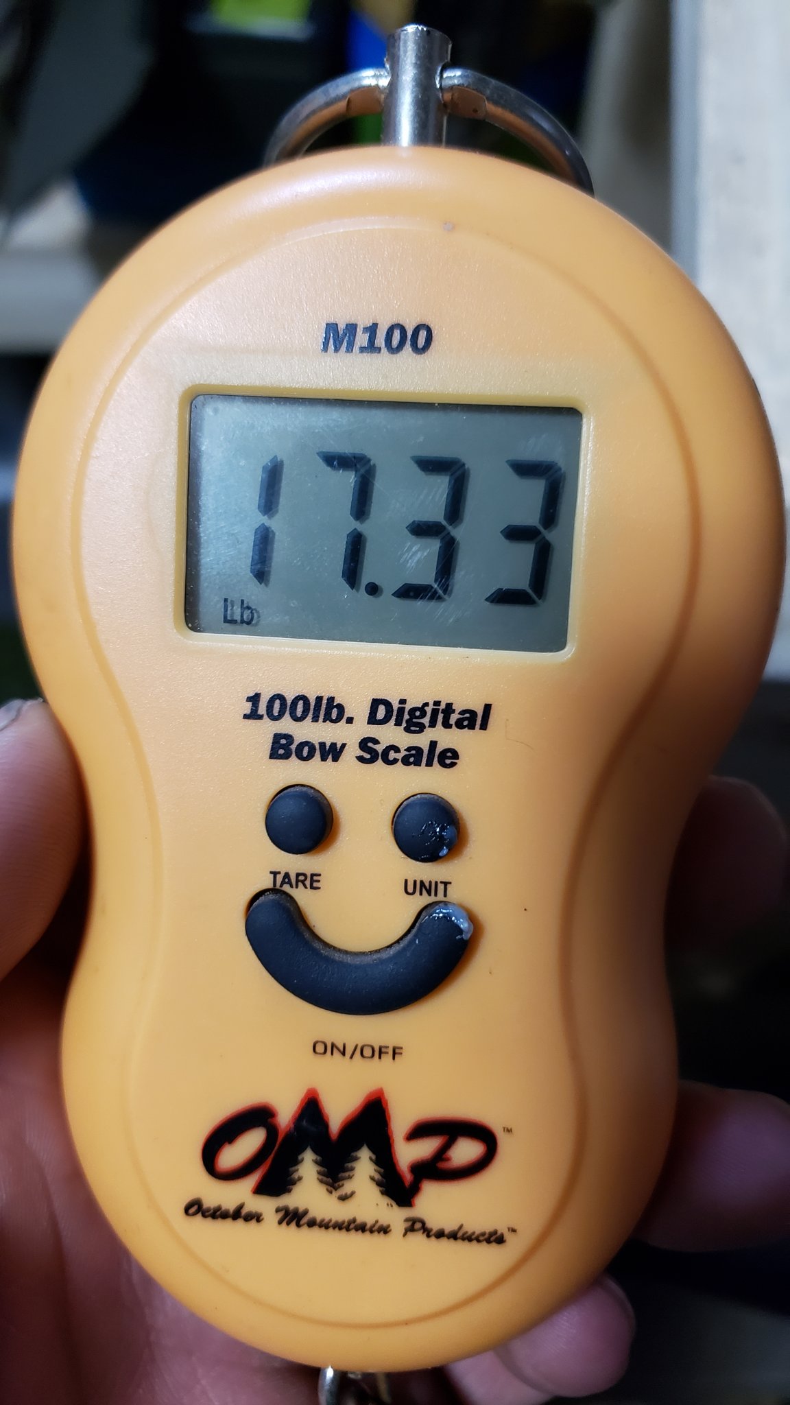

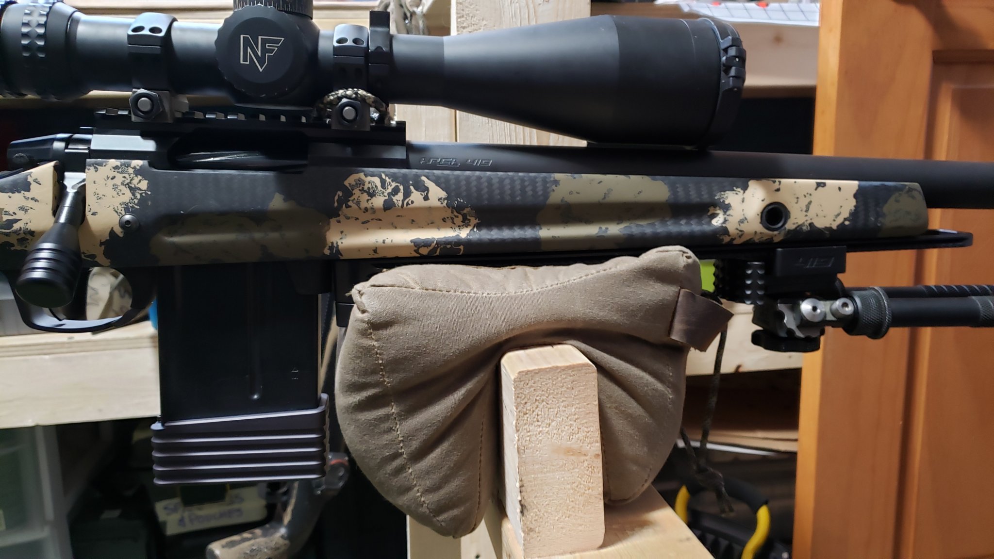

With scope (NF7-35 and NF rings), empty mag, bipod and ready to shoot sans ammo, 17.33lbs.
Stock shaved 2lbs over my prior build but action is a bit heavier on this one so 1.5lbs lighter than my backup gun.

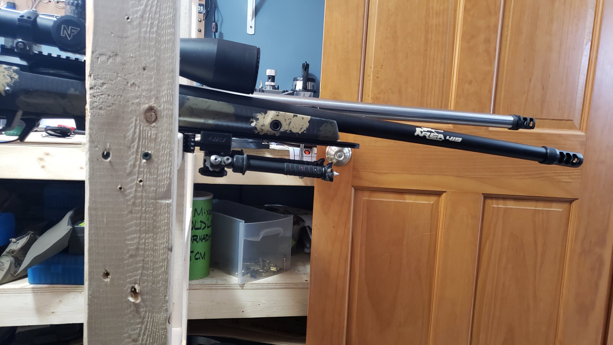

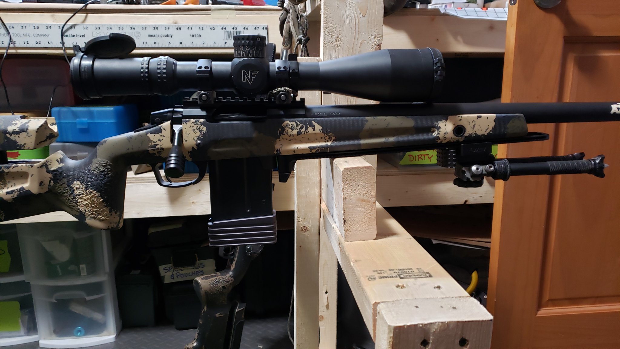

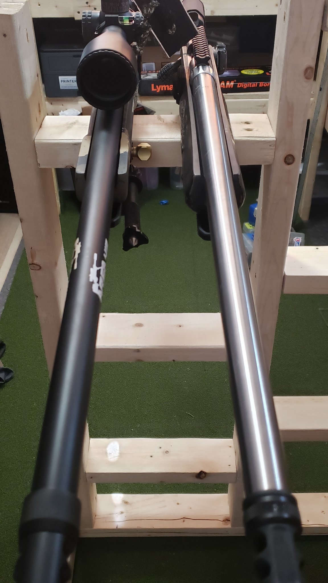

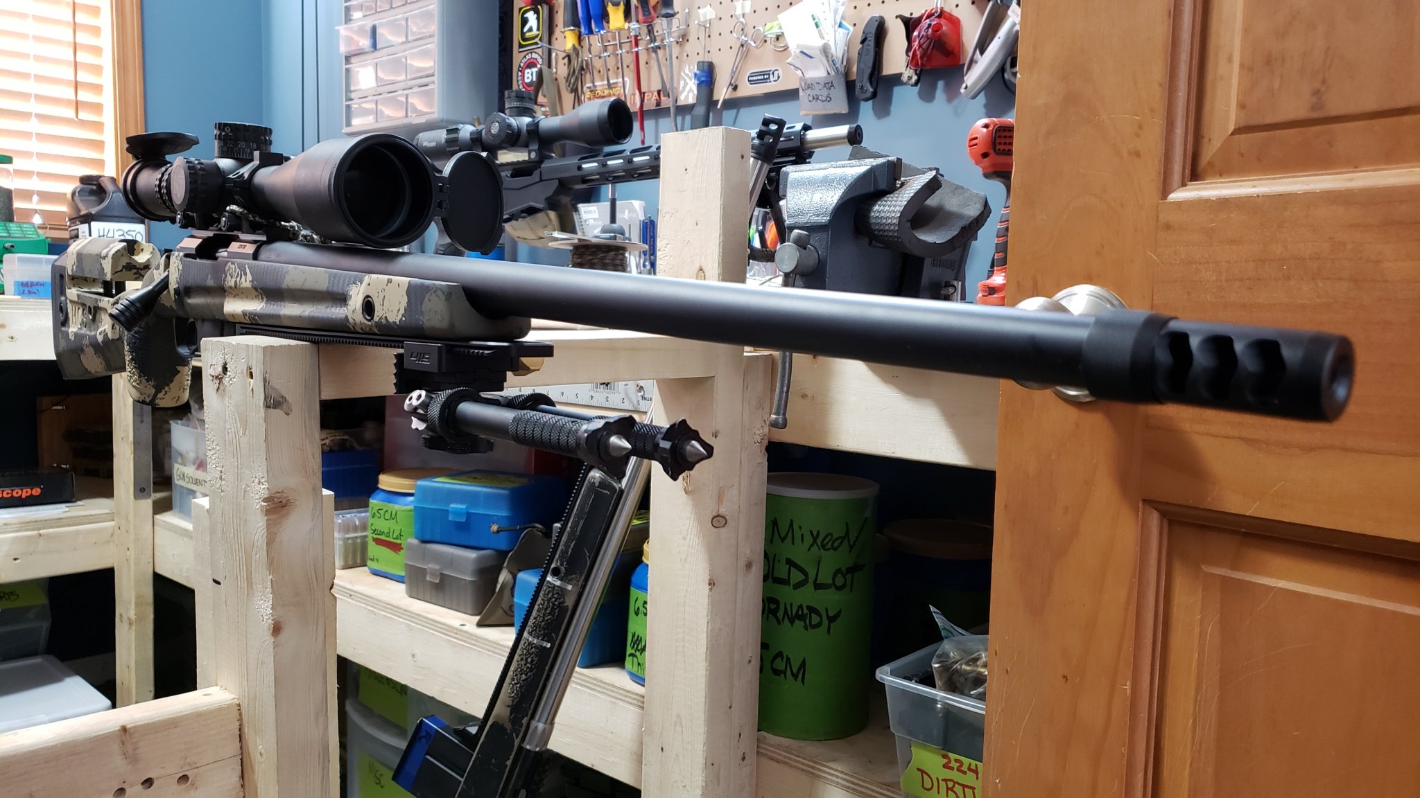

I wanted to change balance point slightly further forward of mag well. My last build was close but it was about 1/2" forward of barricade stop. This stock accomplished that that by being lighter in the rear and allowing CG to move about 3" forward of barricade stop :
It's exactly centered on pint sized game changer which is 6" across the top (center is 3") just like my rifle CG:

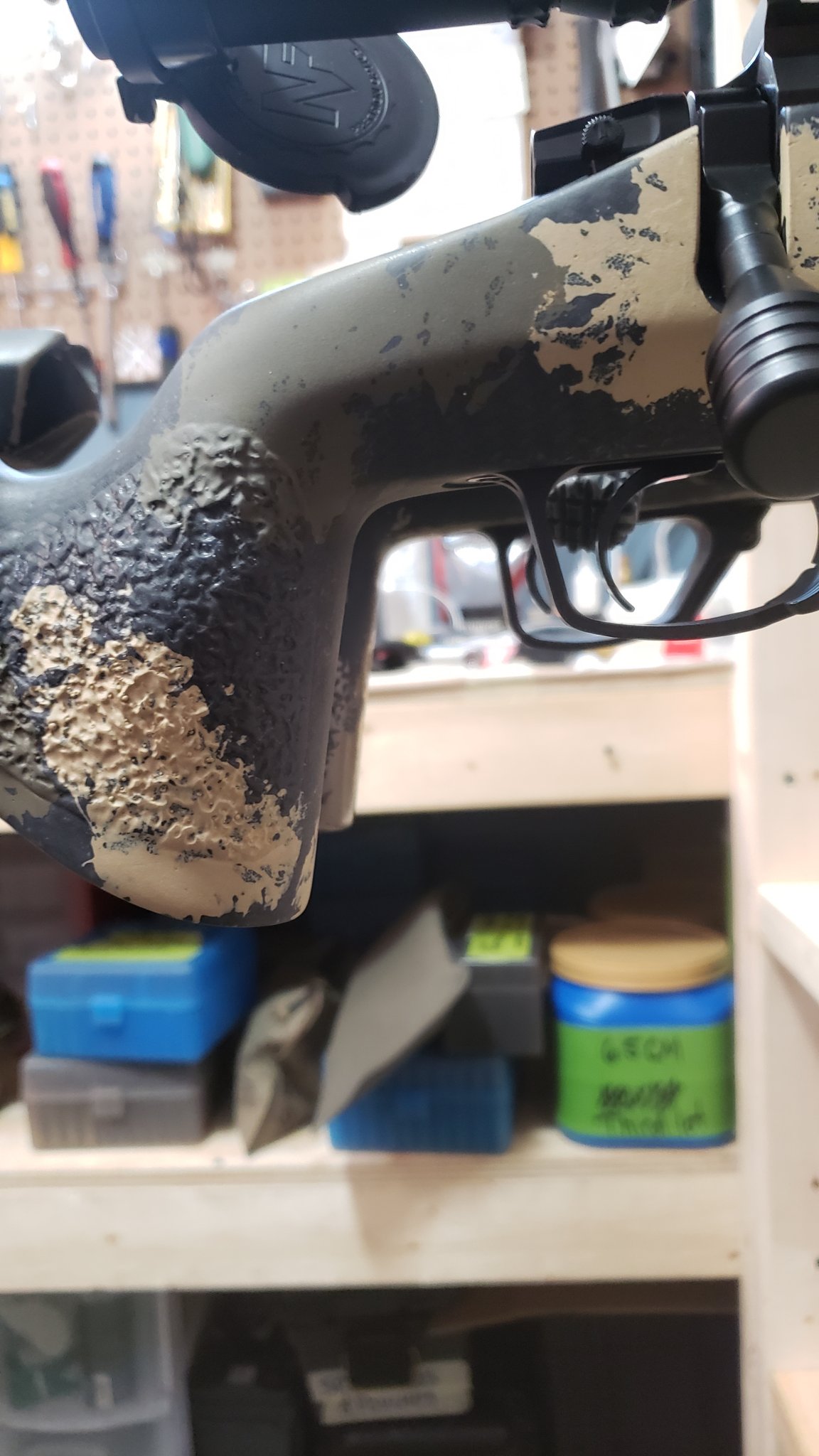

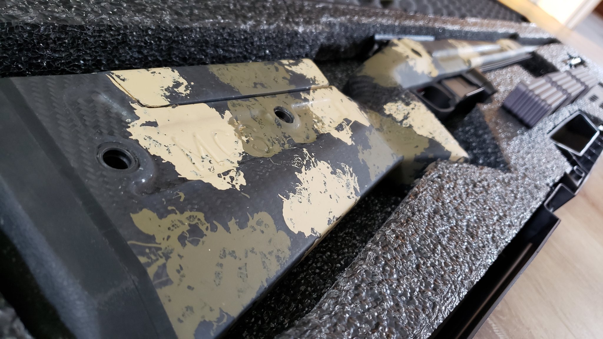

Doe you happen to know if the PRS2 stock has the same grip angle as the T4a?

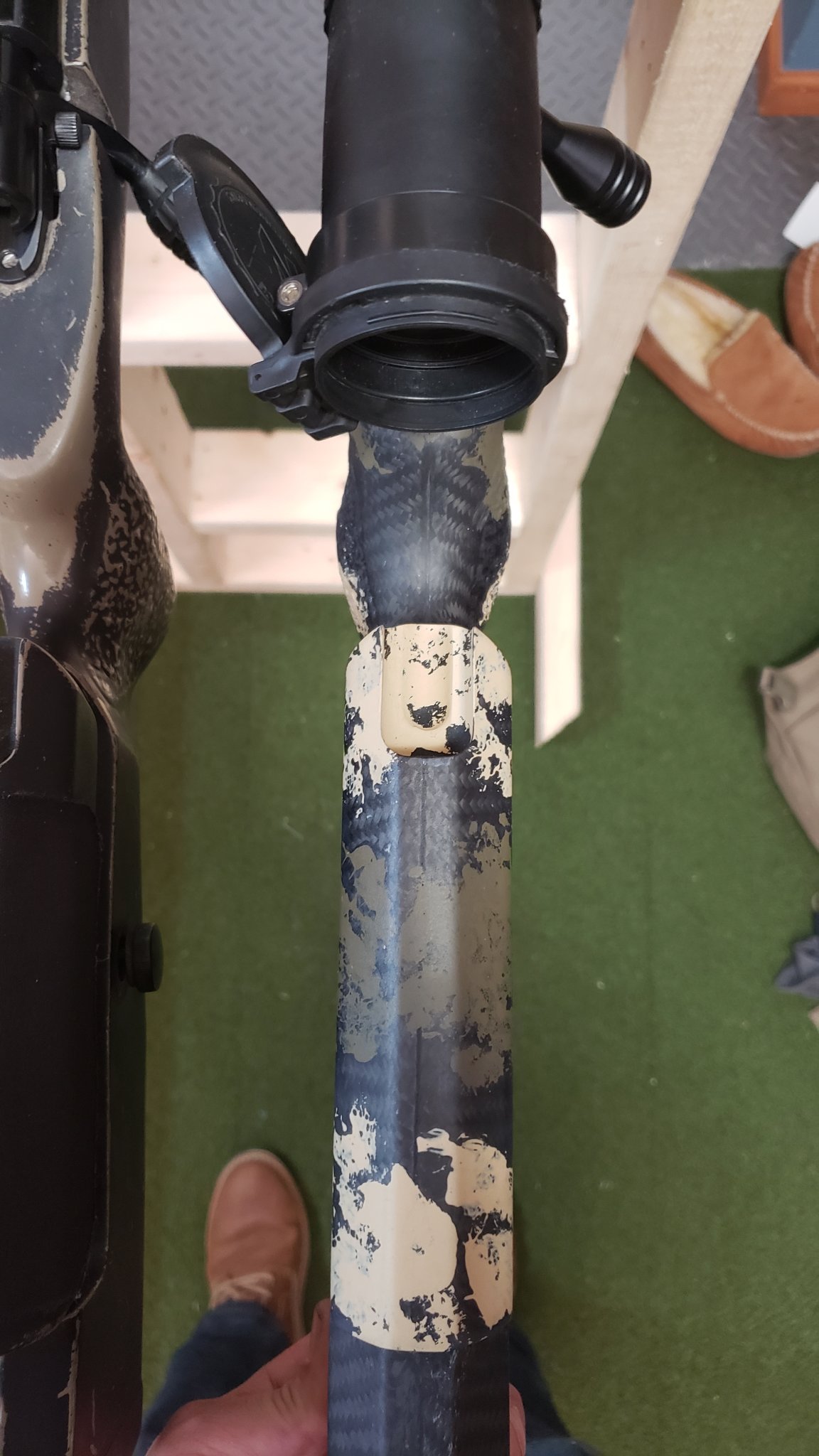

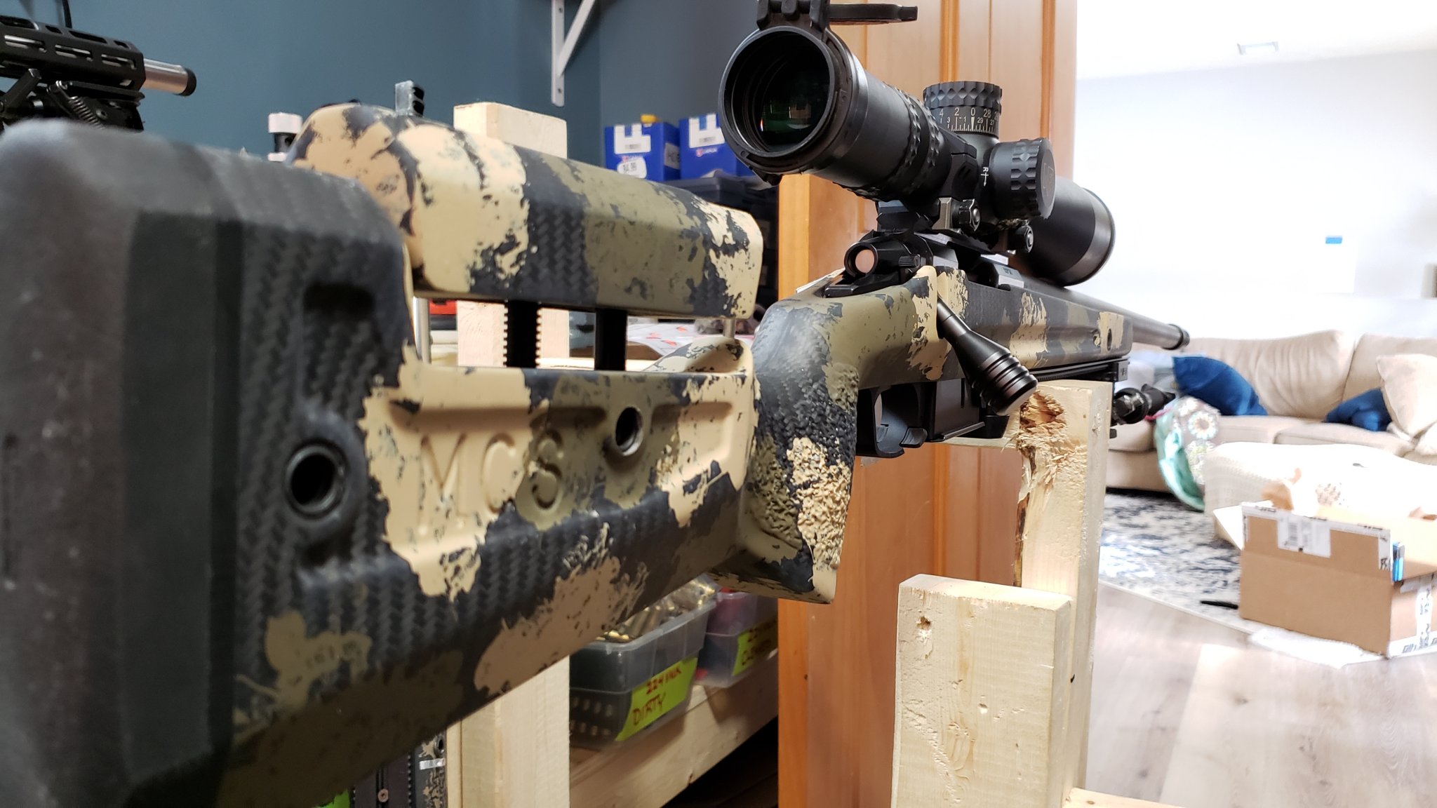

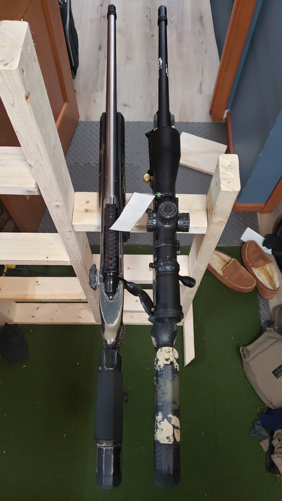

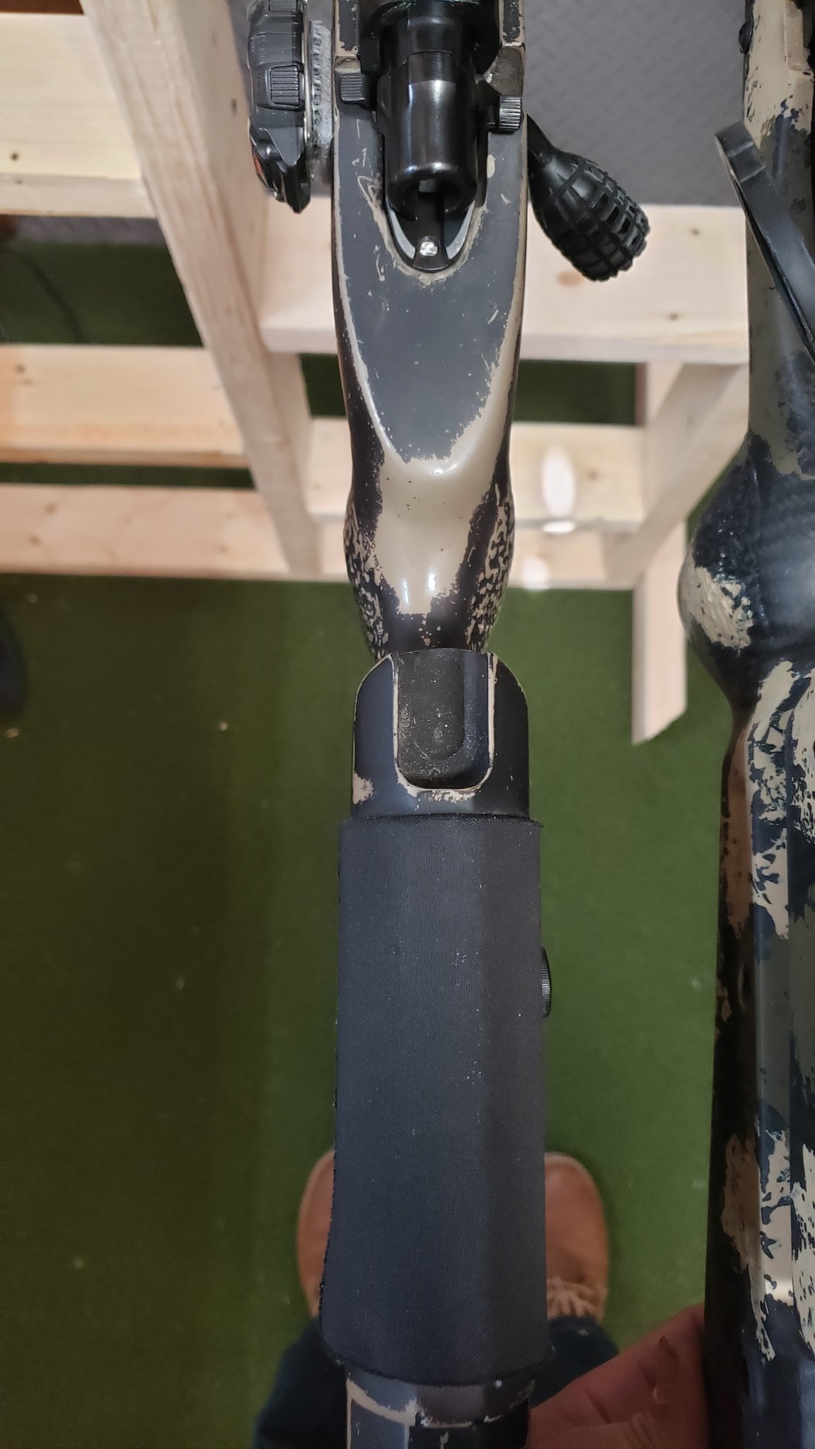

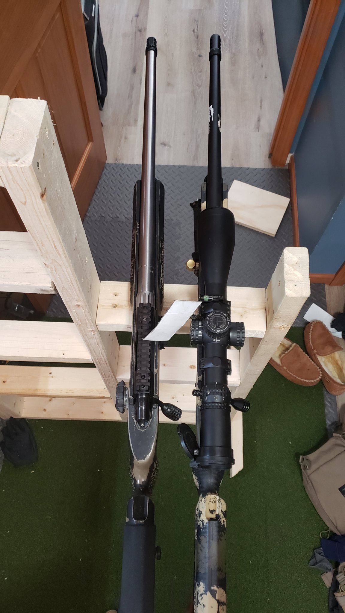

Yep, or at least as close as I can tell. T4A black/tan and PRS2 in OD/tan camo.
Only difference in grip I can measure is widest point of grip on PRS2 is 2.15" vs 2" on T4A. It's slight, however, just noticeable and feels better to my hand. Only other meaningful angle change is slope of foreend. The PRS2 pitches the muzzle down whereas the T4A is level when sitting flat on barricades (both have same Arcalock rail installed). Pictures below.
