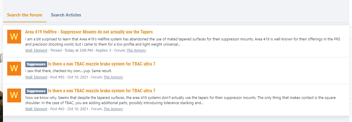

I am a bit surprised to learn that Area 419's Hellfire system has abandoned the use of mated tapered surfaces for their suppressor mounts. Area 419 is well known for their offerings in the PRS and precision shooting world, but I came to them for a low profile and light weight universal suppressor mounting system that offered the advantages of tapers including concentricity, repeatability and lockup.
Originally, the Hellfire suppressor mounts did use the tapers - but according to Area 419 the tapered surfaces which are still machined into the mounts no longer mate. So you gain none of the advantages of a taper from the tapered surfaces mating.
Instead, you add parts but still are simply relying upon a square shoulder.
In the case of adapting your TBAC to Area419, you go from a tapered system that was designed to provide concentrity/repeatability and rely upon square shoulder all the while adding parts which runs the risk of stacking tolerances, etc.
I first read this elsewhere, tested my own and found this to be the case with the parts I have. Now Area 419 has confirmed this.
Am I the only one not aware of this? I cannot find this information anywhere in the materials from Area 419.

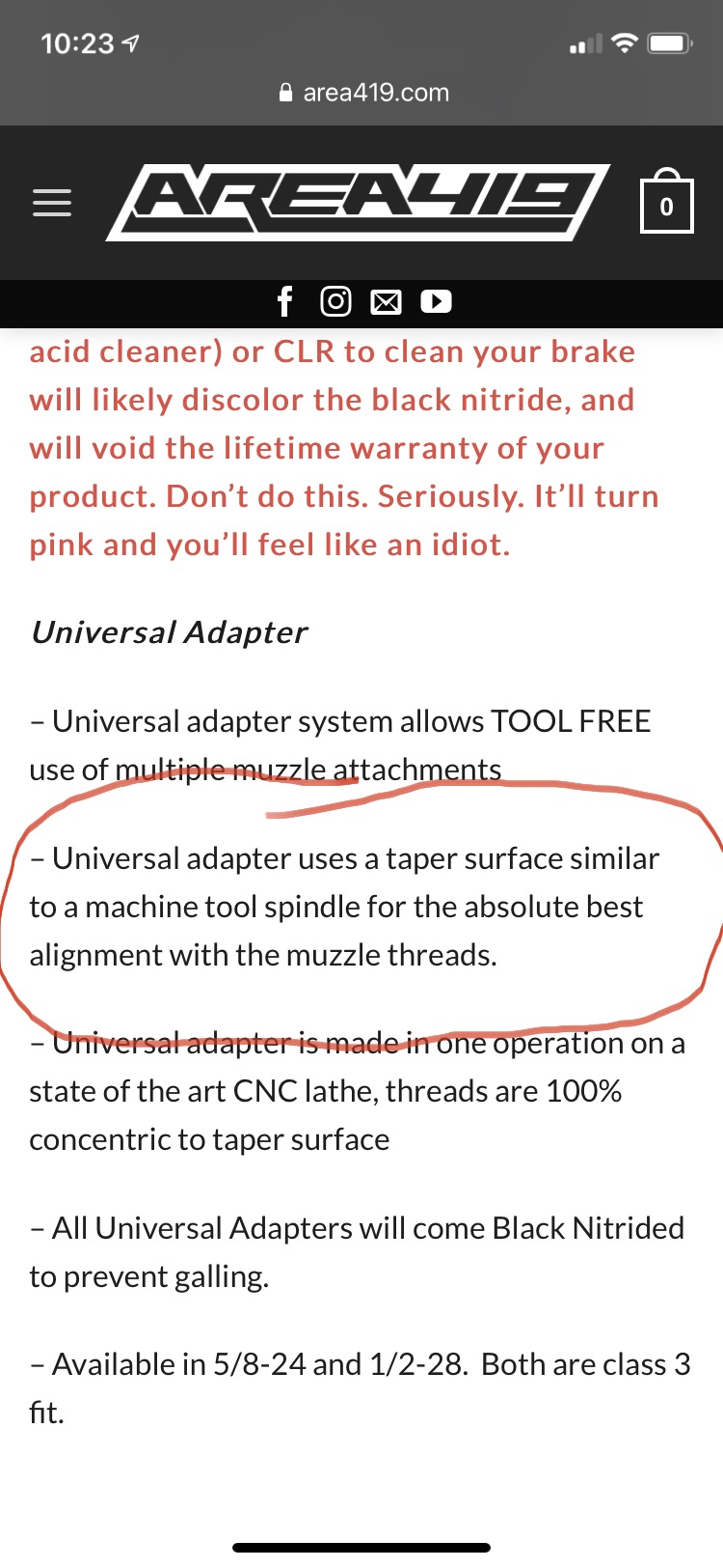

FYI, I copied this from their site just now:
“Universal adapter uses a taper surface similar to a machine tool for the absolute best alignment with the muzzle threads.”

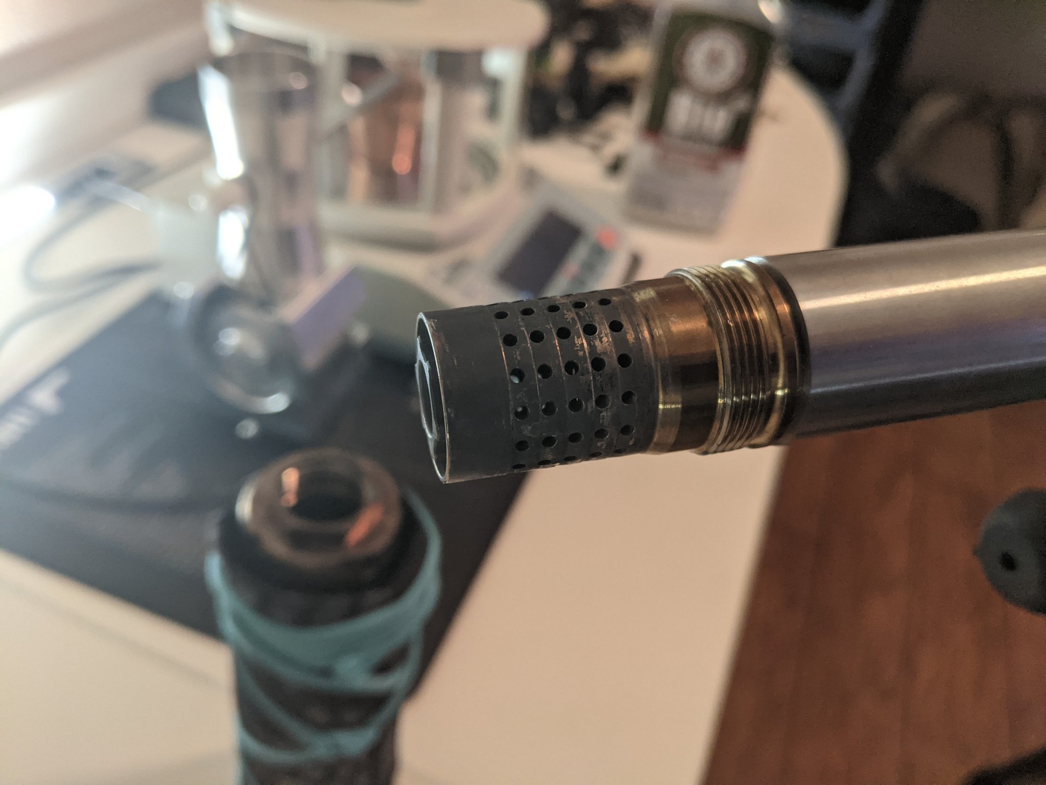

I'll give you an anecdotal story since that's what we're basing all our evidence upon.
Here's my zero target before the last match I went to. First shot circled in red, adjusted, 5 more.
My rifle has a 26" barrel, and my 338BA Ultra won't fit in the safe on the rifle. It's got a 419 adapter because I run it on a 223 and a 300BO from time to time as well.
Screwed it back on night before the match when I loaded up the car. Managed a 6th place finish at a Border Wars match with around 45 shooters attending.

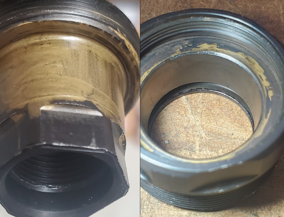

The Area 419 Hellfire system does not use mated taper surfaces when mounting suppressors.

Area 419 representatives confirmed this, when they were contacted. If I had public Area 419 materials which made this clear, I would link everyone directly to that, but I do not. Everything I have been able to find discusses tapers and their advantages.
The representatives indicated that the suppressor adapters originally did rely upon mated tapered surfaces, but they have since abandoned the mating of those tapers in the suppressor adapters. This would not be obvious to consumers of the same as the tapered surfaces are still machined and present on the suppressor adapters. These tapers are so close to mating it's not possible to tell they do not without leveraging special techniques.

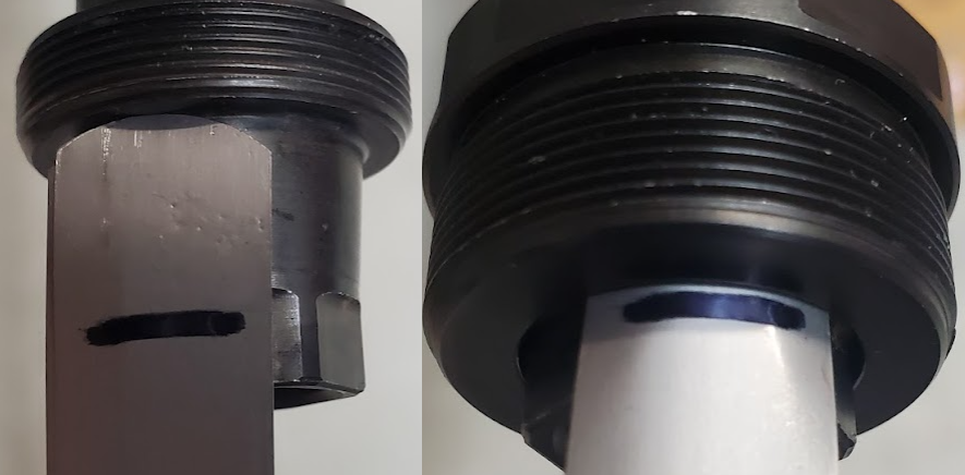

As @E. Bryant alludes, there are fairly simple to employ techniques one may leverage to demonstrate this. Of course, this alone doesn't preclude the possibility of out of specification parts. Sample size is relevant, which is why one needs confirmation from the manufacturer themselves.
Credit to the others who discovered this, devised the methods and provided the materials. With permission.
For all tests, remove any o-rings.
With an open faced hellfire suppressor adapter - such as Alpha or Bravo pattern - one would assemble the suppressor mount to a universal adapter then slide a .004"/.1mm or thinner gap gauge between observing the gauge bottoming out on the square shoulder.
With a closed face hellfire suppressor adapter such as the one made for TBAC, one can use a transfer medium to demonstrate the same. Clean the apparent mating taper surfaces well, on the male universal adapter taper and square shoulder apply a transfer medium such as grease marker, paint marker, metallic marker. While still wet, carefully thread the suppressor mount to the universal adapter while keeping everything centered and not allowing incidental contact, then torque. Remove and check for the transfer of the medium to the female part. There will only be transfer from torque contact on the square shoulder.
Lastly, one can also use masking tape. Masking tape must be less than .006" thick. Take a small square and apply it to the male taper surface of the universal adapter, ensuring no overhang intruding onto the square shoulder/proceeding radius, so that the tape is only on the taper surface and not anything else or hanging off. Ensure it is flat and flush as applied. Thread on a suppressor adapter and it will bottom out metal to metal. The tape will not be touched. One can add another square of tape on top of the previous, now we are at or near .008" thickness and one can feel the tape contact and compress when installing a suppressor adapter.
