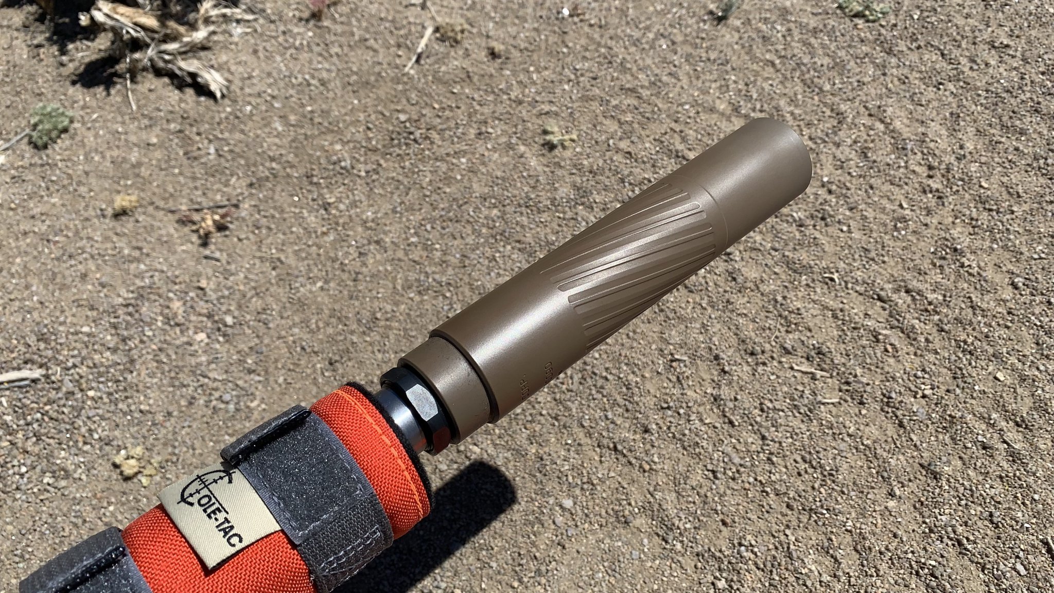

    Since I'm out here shooting at the moment, I figured id do a test for
    you.
    Using my AIAW 25 creemoor with 25” Bartlein HV. Gen 2 Ultra 7/30 with 419 mount. It has a coletac Python cover on it. Different can from the second vid above.
    Top row is unsuppressed, bottom suppressed. .1 MIL grid on the target.
