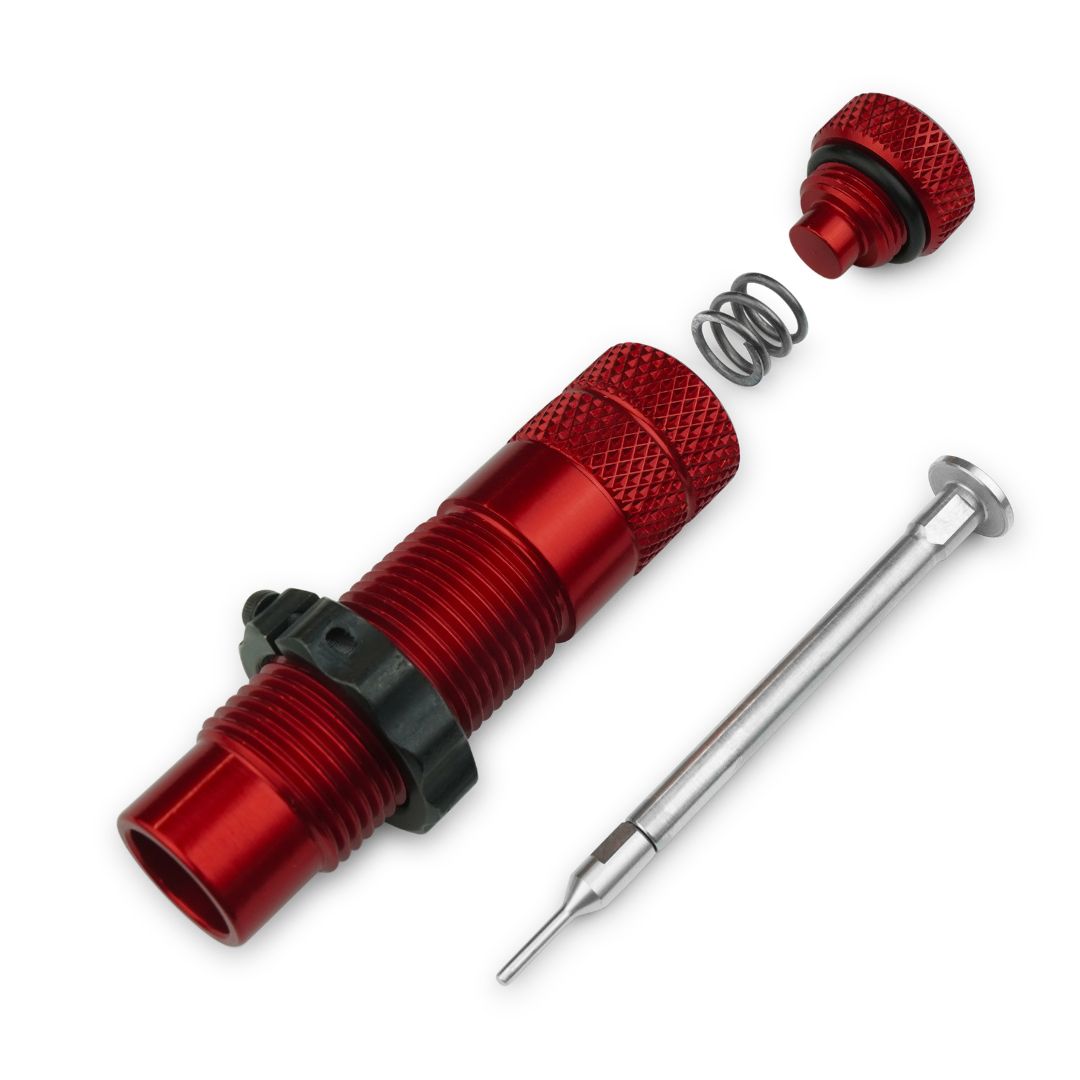

    Have you looked into the Mighty Armory decapping dies? I’ve known Wayne for years, and he’s a great guy making amazing products. I’ve been running one of his Magnum decappers since 2018, and still haven’t broken a pin in 25,000+ rounds. The machining is exceptional, too, and so is his customer service. 👍🏼
    Reactions: Devildog
    Since moving up to the Zero, the trusty T-7 is now my utility press hosting a variety decapping dies, bullet pullers and swaging dies.
    Have you seen all the Creedmoor Sports upgrades for the T7 presses? I was going to get one of those, and then do all the upgrades, but by the time I did that, I'd be halfway into a ZERO. But since you already have the T7, you can upgrade for a really good price.
    Reactions: Dogtown
    That’s probably what mine will mostly end up being, is a collet bullet puller/decapper/.300 BLK range subsonics bullet seater/whatever I need a spare press for. 👍🏼
    I just got in yesterday two Mighty Armory decapping dies, I picked up a new 223 die as well. They look great, I’m anxious to see how they work. I got one to set up a dedicated tool head on my Dillon 650 to decap and swag mostly bulk 223. The other is for the chucker.
    Reactions: FuhQ
