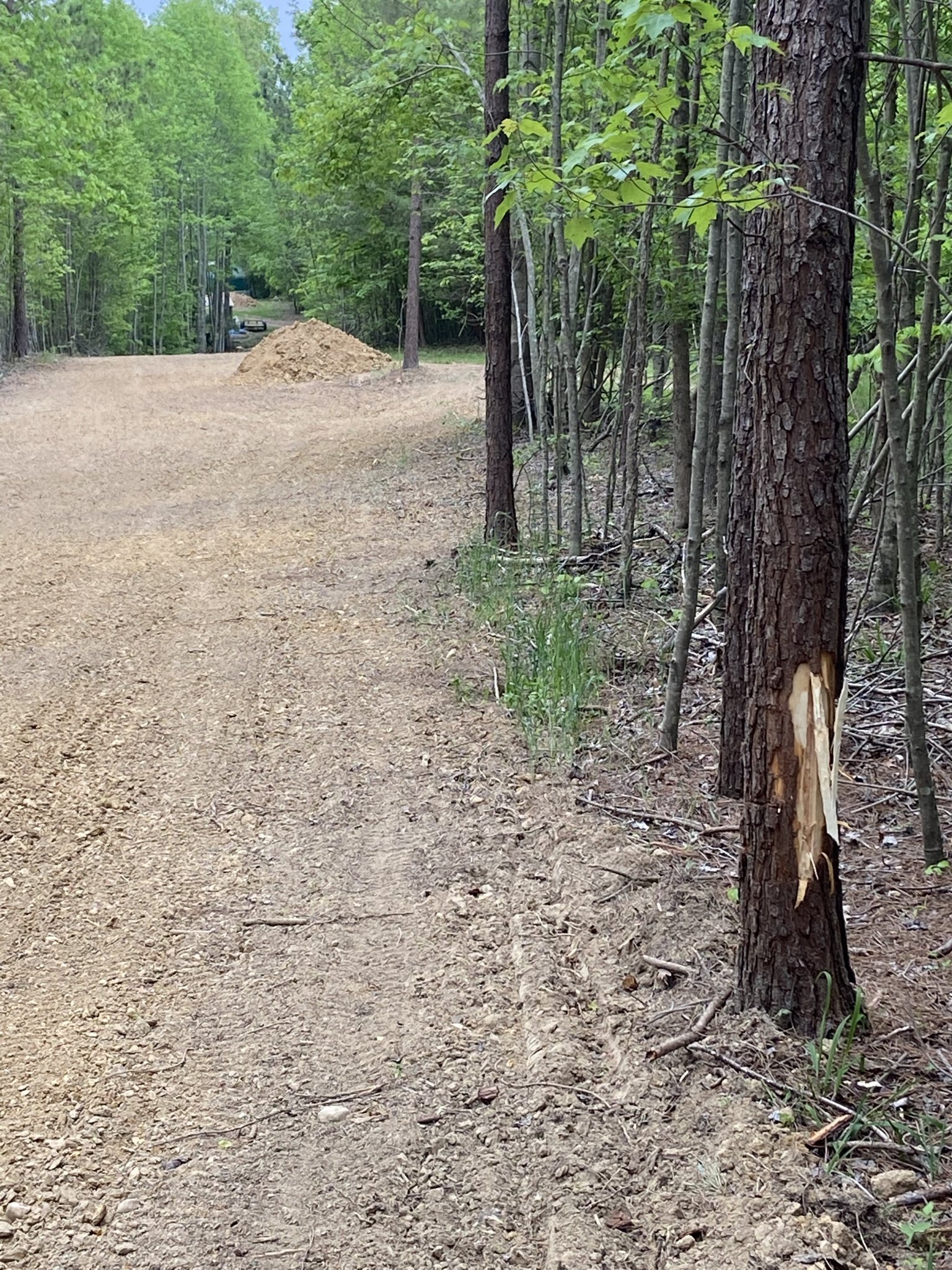

Has there been any other ep5 that have had tracking issues. Got mine Saturday got it mounted today zeroed at 25 then moved to 100 for my final zero and it's not even on the paper. Bring it back to 25 and it's dead on my elevation from 25 to 100 is 1.6 and even if I don't adjust it still doesn't hit the paper. Everything on my rifle is torqued down and I know this is good load. When I adjust the turret the reticle moves. This is boggling my mind

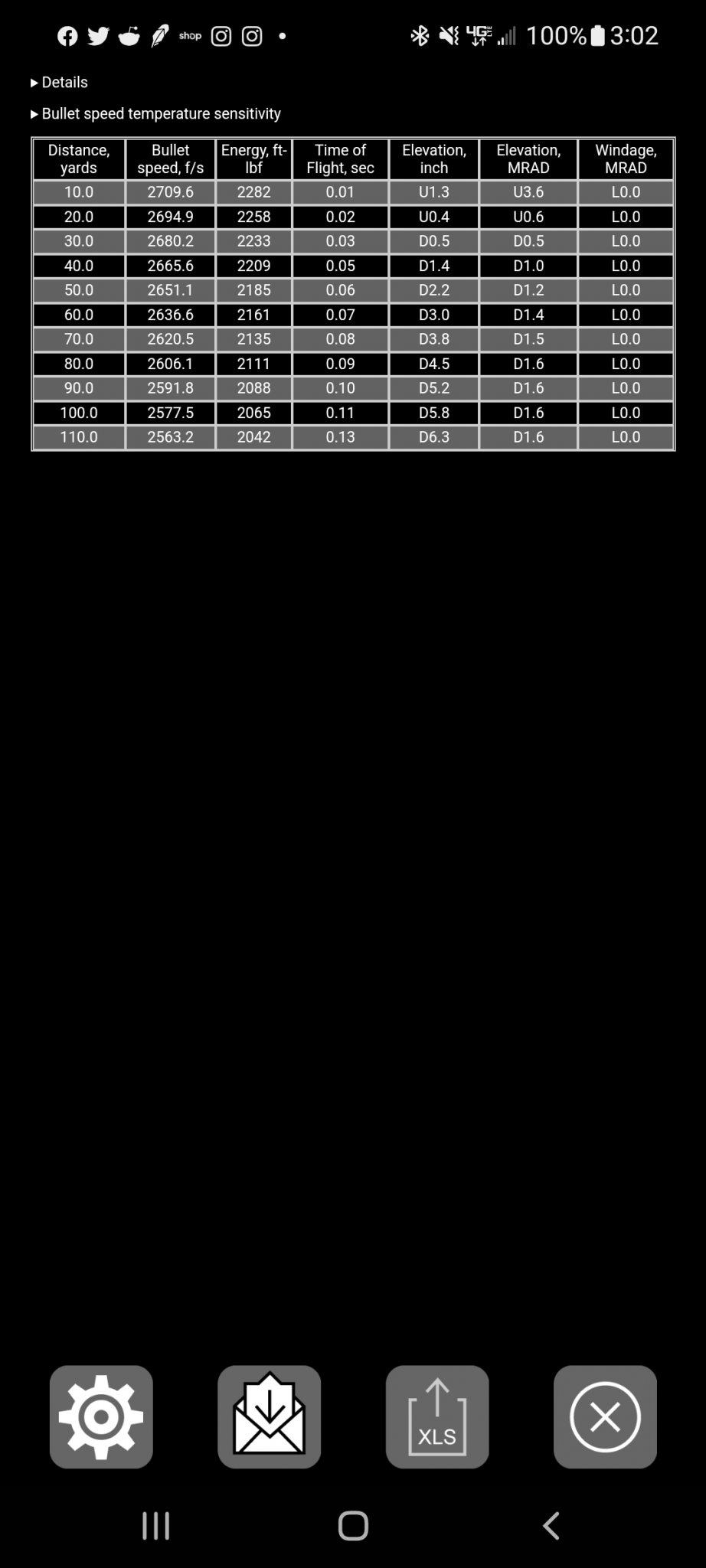

Ok I'll bite if he zeroed at 25 yards why would moving the target to the 100 yard line make him 30 inches high?
It wouldn't
Reactions: 338dude
Did that too it wasn't on paper. Emailed them last night and they said to boresight it at 100. Thats gonna be fun to do with my chassis. Probably gonna have to take the buttock off and try
Reactions: 338dude
Just pop your barreled action out of your chassis and bore sight it.
Easy peasy.
OR, as pointed out above, put one into the berm at 100 and see where it lands.
Even easier, peasier...
that makes no sense then. that's a massive target
and if you hold 1.6 up (POA below the reticle center dot) and that doesn't hit paper either?
throw another scope on to try but i doubt that's the issue
Reactions: 338dude
if neither dialing nor holding 1.6mil doesn't work to get on paper i highly doubt it's the scope

If you have an appliance store in the area might be able to get some large cardboard for free. Failing that a sheet of plywood or furring strip frame with Tyvek stapled to it for something lighter.
Just from personal experience and the fact the miss is larger than his entire target, the base angle is larger than the target and no splash under the target was noted.
We still don't know how high his scope is or anything else.
Reactions: 338dude
That'll have to be at an established range my berm is about a 40 acre forest lol
So then, pop the BA out of the chassis. It's two screws.
Lay it on a bag. Set a target out at 100yds with a 2×2" square/diamond/triangle/ circle of bright colored tape on it.
Do the bore sighting and do it carefully. (You will probably have to loosen your zero stop)
You should now be less than 3" away from actual impact. Probably closer....
Put your action screws back in, torque them and put two on paper. Adjust zero and have fun.
BTW, don't forget to reset your turrets and your zero stop.
