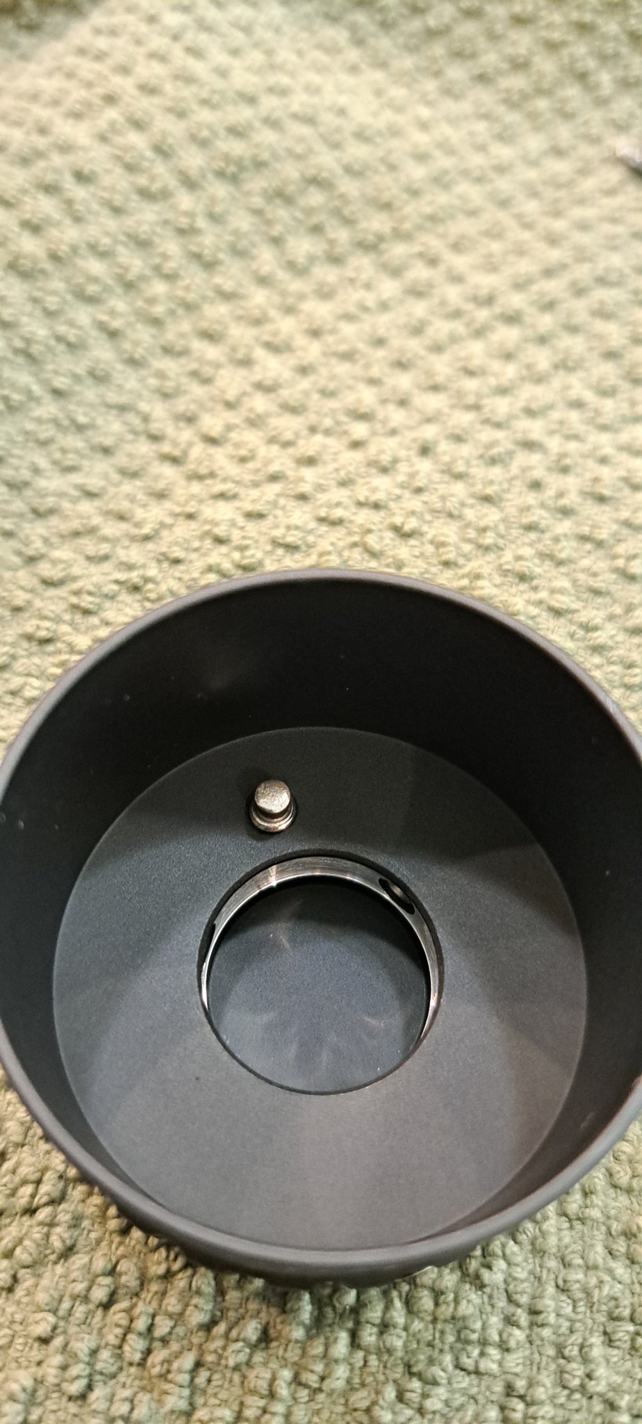

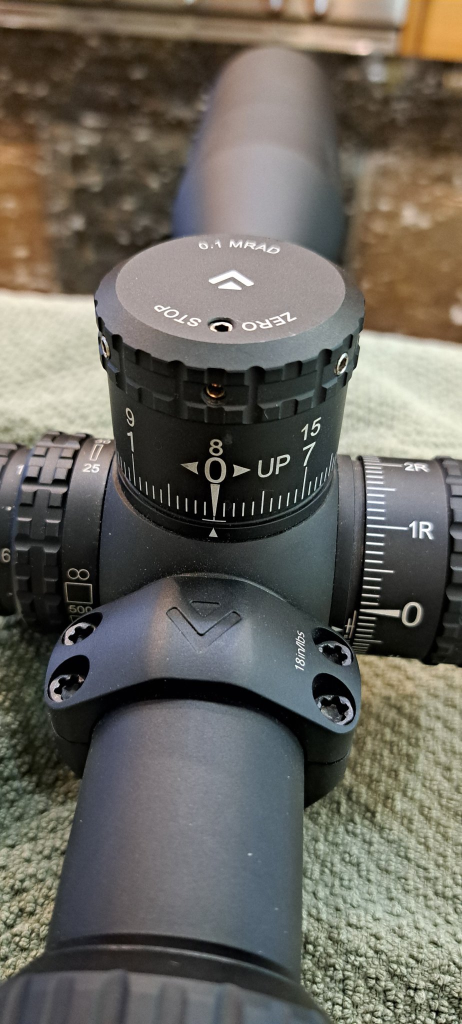

Here are a couple of images of the pieces and parts, and how it works.
This little machined ridge is the actual zero stop.
This is the adjustment screw that bumps against the bottom and the machined ridge.
It is held in place with the horizontally mounted brass set screw above the 0.
This is the turret with the zero stop adjustment screw at the correct height and held in place with the brass set screw.
If you raise the zero stop screw to clear the machined ridge, you have no zero stop until it makes the next revolution.

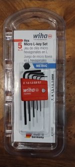

YES you can adjust the zero stop to go below zero. I have done so myself. That inner ring with the ridge has some set screws using tiny Allen keys I believe. I had to buy special tiny Allen keys for that, forget if it’s metric or imperial. Anyways, loosen those set screws, put the cap back on but not tighten the screws and rotate the cap with the zero stop down to rotate the inner ring, stop when you rotated enough down for the stops you want.

you dont need to touch the inner ring.
just loosen the top set screw, dial to what you want the "zero stop" to be
- say -1.0mil
- then run the top set screw down, lock it down with the brass one
- now your "zero stop" will stop at -1.0mil, instead of zero

It doesn't work like that
ok, just checked on my 7-35 EP5
I can get it to go 0.4mil under zero
yeah, anything under that, you need to mess with the inner ring.

Micro key set - 0.9mm.jpg Thought I would resurrect this thread as I recently purchased the DNT 7-35. I also wanted a zero stop below "0" on my rimfire. The size of the small allen head screws is 0.9mm as seen in the set I purchased on Ebay. I unthreaded the small screws and before attempting to turn the ring with the machined portion, I marked the inner turret noting the postion of the machined potion relative to the turret. Unfortunately, the ring would not budge. It's almost like the ring is loctited in postion. Rather than use more force or an instrument of mechnical advanatge, I accepted the stop at 0.
