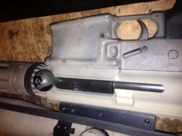

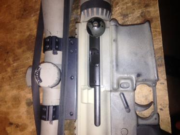

If you want to modify an existing Armalite AR-10, +1 for Scott Medesha's work. He built this AR-10 for me several years ago. Machined the upper receiver (note the brass deflector has been milled off - necessary as ORD has pointed out) and drilled/tapped the bolt for the charge handle. No problems at all with the integrity of the upper receiver over several thousand rounds. This method will definitely compromise the finish of the upper receiver. Didn't matter a bit to me, just sprayed it with Krylon and moved on:)
The JP system is tons better (I have an LRP-07 also) as the charge handle is on the left side and folds down nicely when not in use. Better system in all respects.
