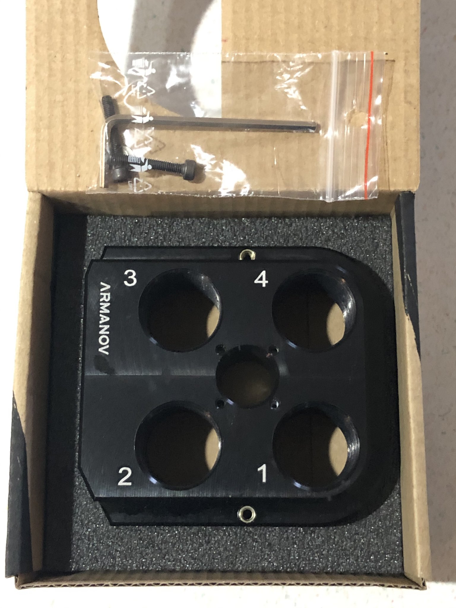

    The come very well packaged with all things needed to set them up. The toolheads are around $35 or so, and the lock rings are about $12. The lock rings use a threaded bolt, not a roll pin like the whidden toolheads, which I liked. I felt like the bolts were not any easier to get in considering you have to fit them in the hole of the lock ring and get it started. On the first die its not bad, but I would imagine the 4th die would be a little trickier. That being said, I don't need to float 4 dies on mine.

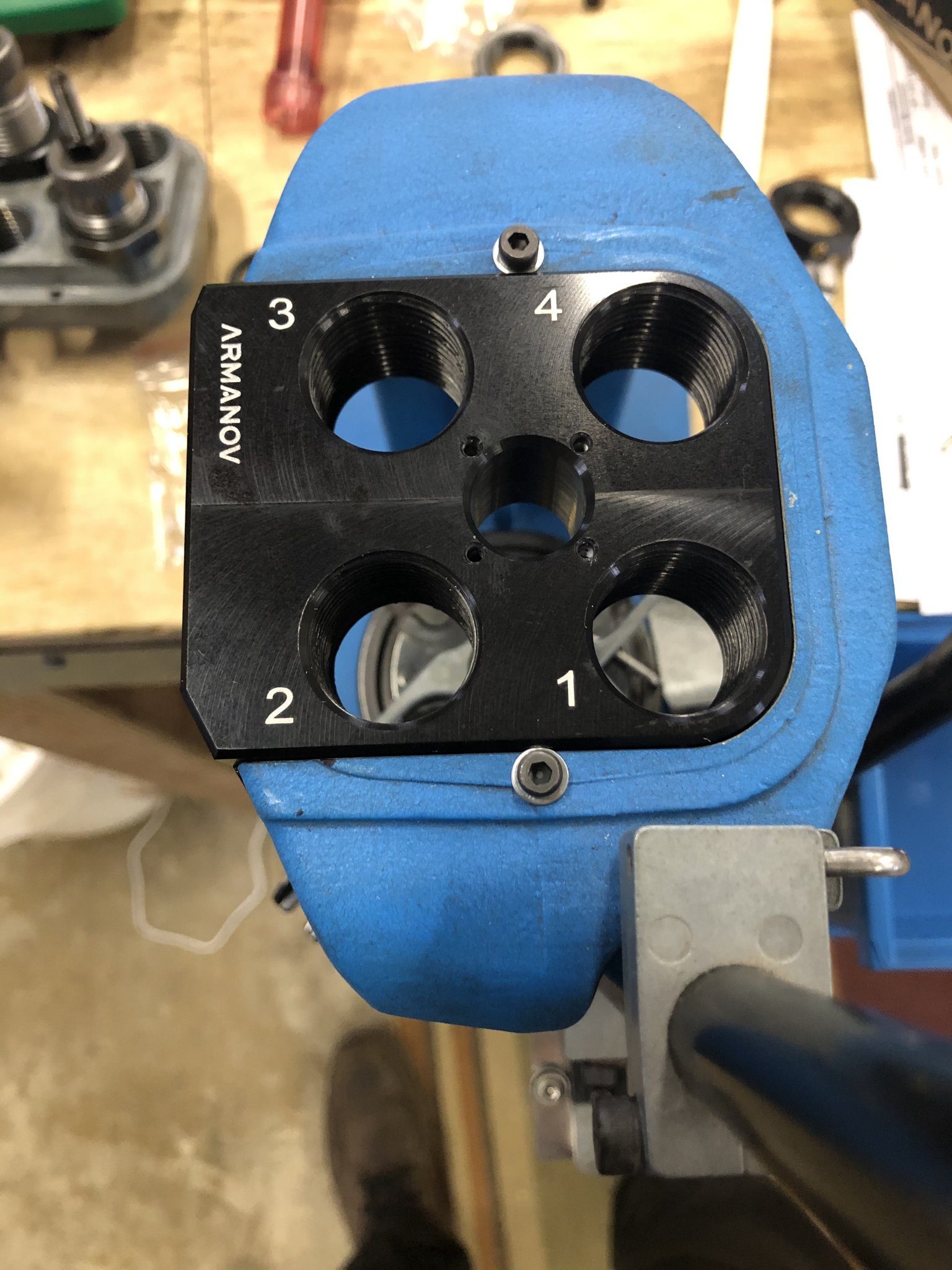

    The tool head is well made in my opinion. Edges are clean, threads are sharp, both looked great to me.

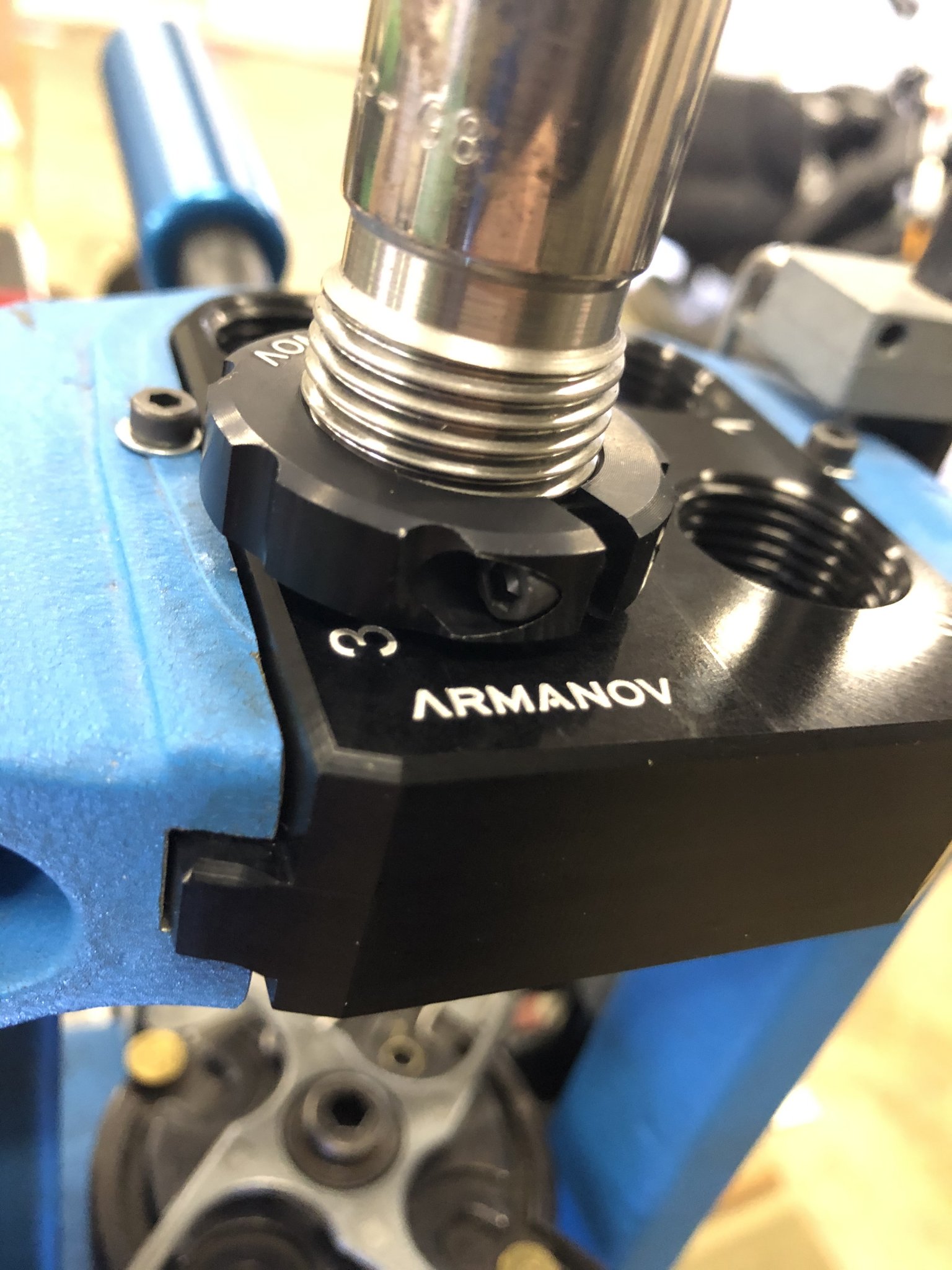

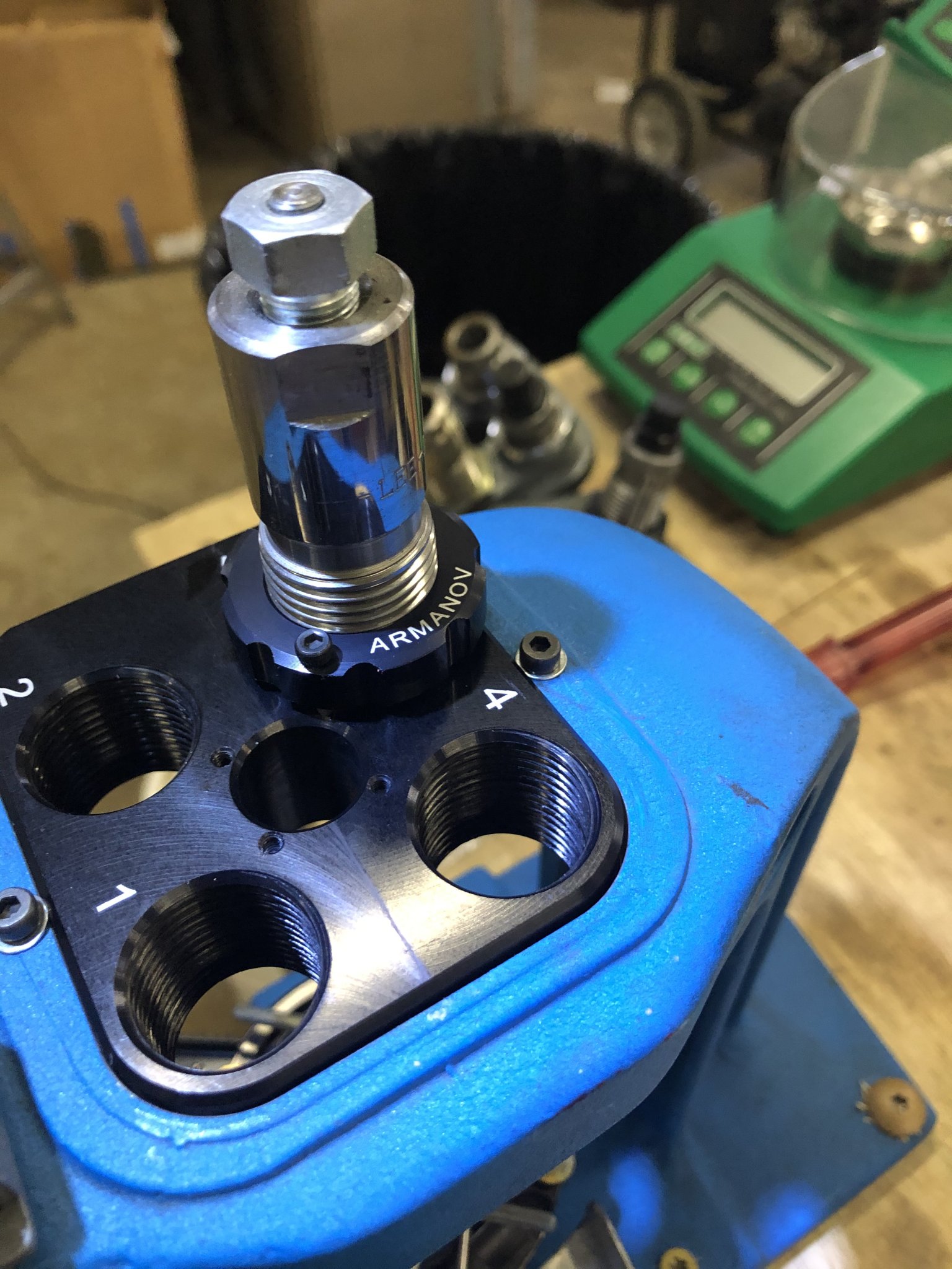

    The toolheads slide in like normal, then you use the provided M13 bolts and washer to lock the toolhead in the upper position. Like the Uniquetek clamped toolheads, they recommend putting all your dies in, loading in 4 cases and taking the shellplate up to imitate what the exact positions will be while reloading with the shellplate full.
    With the ram all the way up, you should the lock the toolhead into place. It locks into place well and you can tighten the bolts easily. Its a solid setup and obviously doesn't move AT ALL. I can definitely see how this could help the process of consistency, once paired with the floating dies.

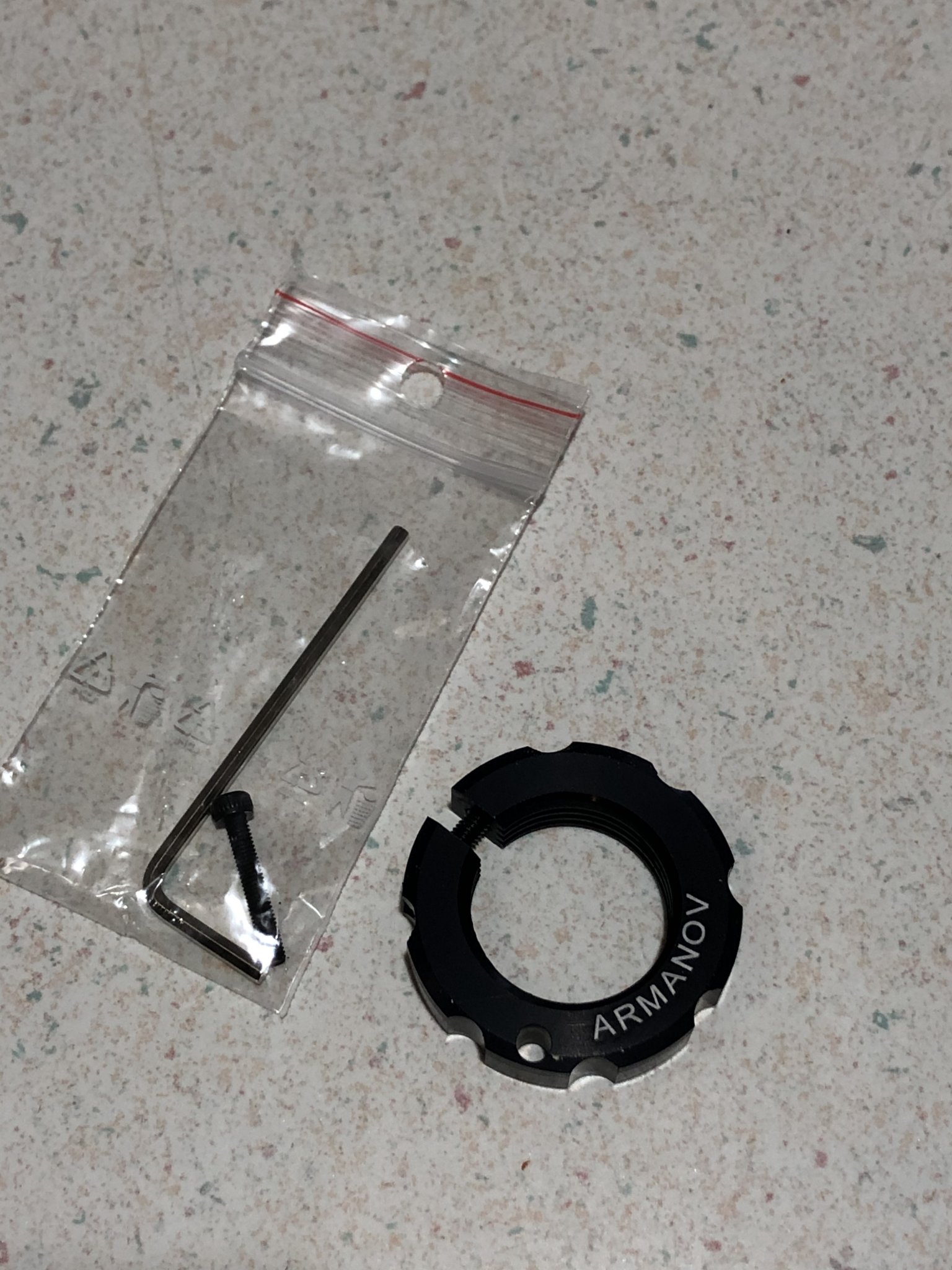

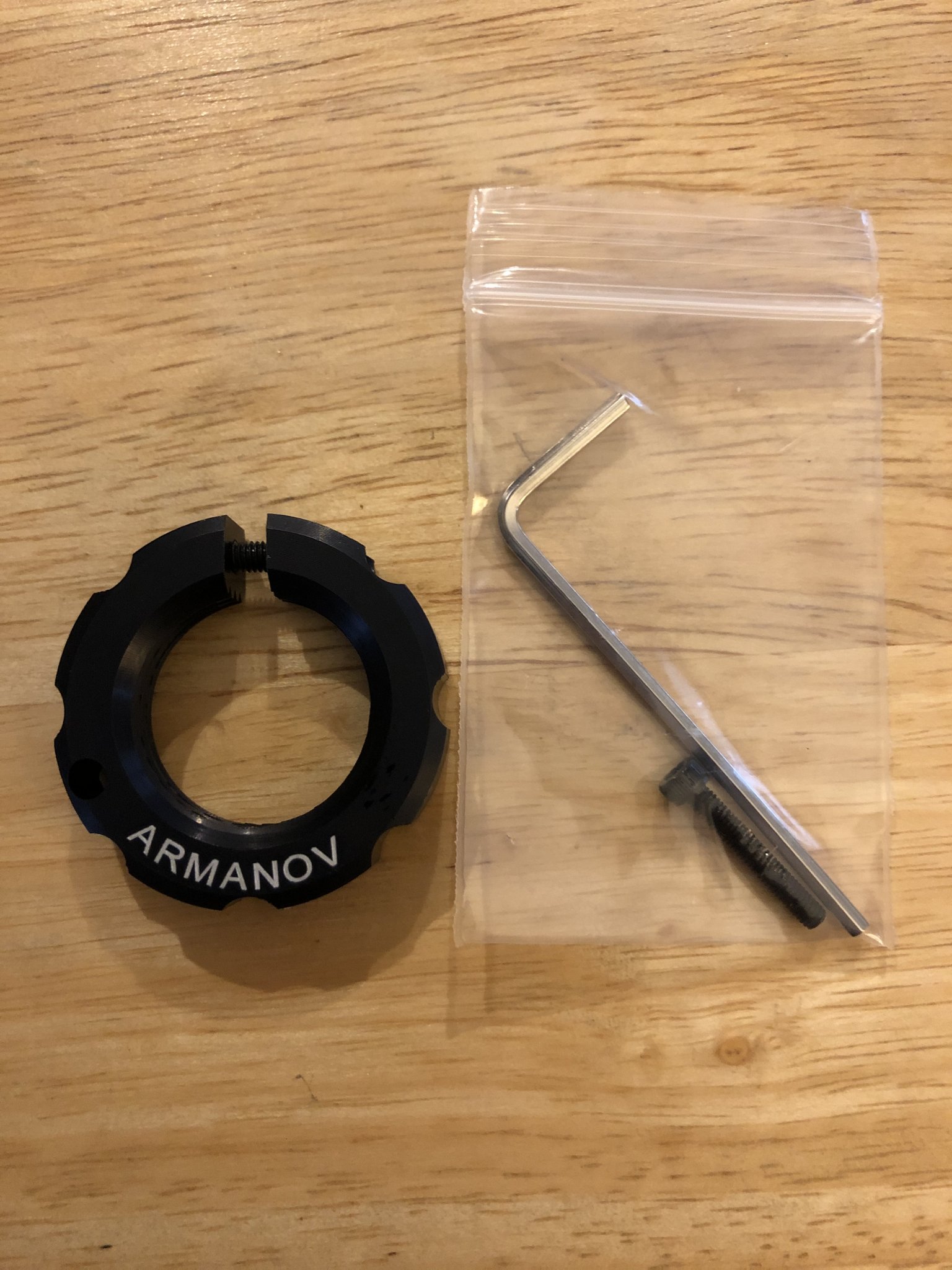

    Lock rings fit great on dies, and use an imbedded allen bolt to tighten around the die, NOT screwing an allen bolt into the threads. This is the preferred lock rings that I like. The lock rings are timed so they are exactly one turn back from flush when the bolt fits into the hole on the lock ring. What I did was just screw the die in until it was close to the final position I liked, then screwed the lock ring down all the way until it hits flush, back it out one turn until the holes line up and screw the M13 bolt in the hole. It will tighten with about 2mm to go as you can see in the right photo. Then I set my FINAL position of the die and tighten the lock ring to the die.

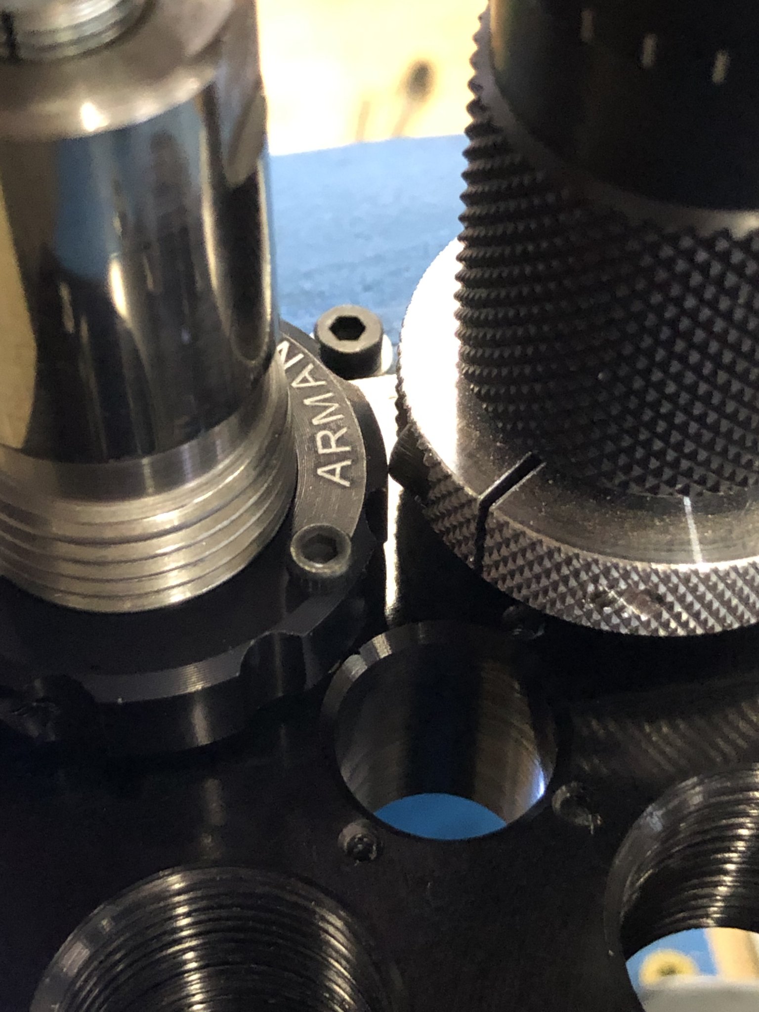

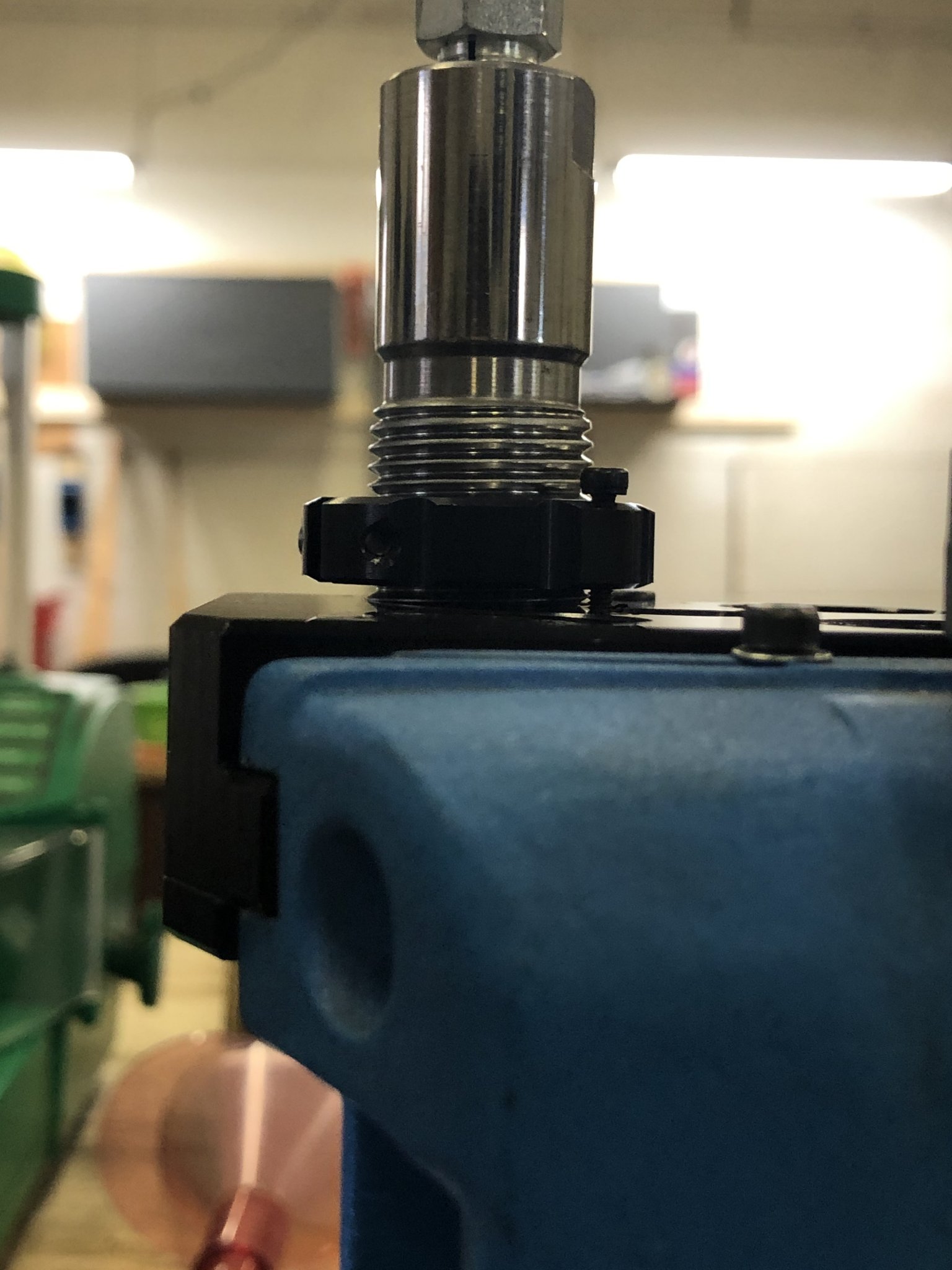

    If you notice on the first photo, using a different lock ring with allen heads that extend out will not really work. ON the photo on the right you can see the Armanov rings are imbedded into the ring. The allen heads are also time so they will be on the outer edge of the lock ring so that can aid in tightening the lock ring down, so its not stuck in the middle or something. Really like these lock rings, albeit sort of expensive, but worth it....especiaily for these toolheads.

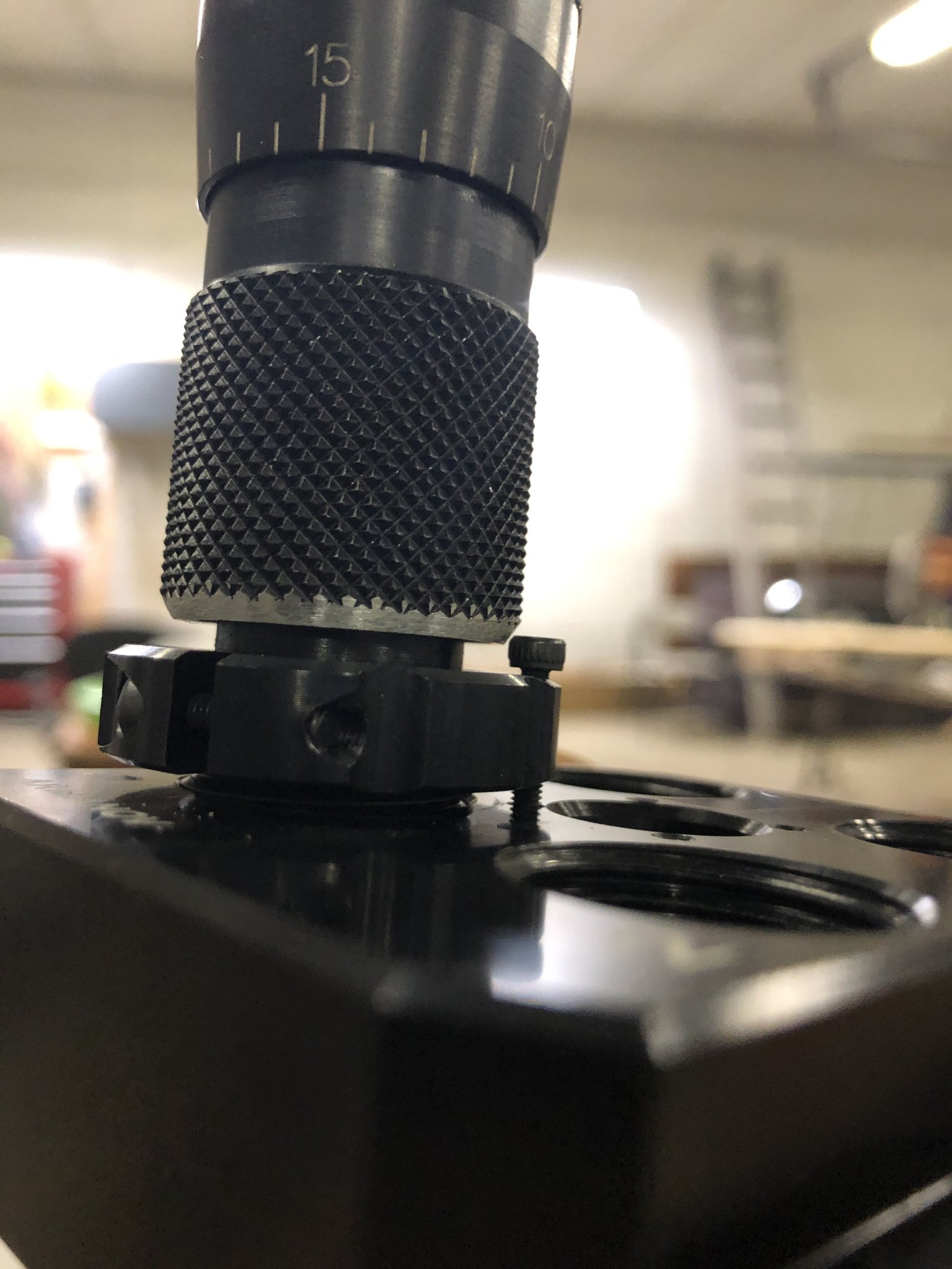

    The only other problem I had was with my Forster Micrometer seater for .223. The damn die has to be screwed so far down into the lock ring to follow forsters die set up procedure, that the housing contacted the M13 bolt in the lock ring that free floats it. I had to take a little skin off the bottom on the edge to make it work. I have to screw the die down this far to depress the spring mechanism in the seating die, as Forster recommends. Has anyone not done this and still get good seating?

    Will the lock rings fit under the tool head? The Forster seating die does don't have to be timed with the lock ring, you can use the stem itself instead.
    There is enough room to, but the hole for the free play bolt isn't on the bottom, only the top. I think its up to par now, I need to try it a little more and just make sure.
    What do you mean by using the stem itself?
    Decide where you want the die body graduations and tighten the die body lock ring. Loosen the seating stem jam nut and then back out the stem from the top. Set the micrometer to zero and then screw in the stem until it is the depth you want (or matches an existing loaded cartridge). Tighten the seating stem jam nut.
    Decide where you want the die body graduations. Loosen the seating stem jam nut and then back out the stem from the top. Set the micrometer to zero and then screw in the stem until it is the depth you want (or matches an existing loaded cartridge). Tighten the seating stem jam nut.
    Oh, yes I know that. Thats how I adjust mine for seating depth.
    But for setting up the die initially, Forster recommends that you screw the die in until the Sliding Die Chamber is almost fully compressed.. This is how they word it....
    "C. Continue screwing the die clockwise until you have fully compressed the sliding Die Chamber. Next, back it off at least one full turn because the Die Chamber should never be fully compressed when seating bullets."
    I'll ping in with some experience - I had some 550 toolheads and lock rings.
    The big downsize I found was they are taller, from the slot to the top of the toolhead, than standard dillon or whidden toolheads. If you're loading short cases like 223 or 6BR, this becomes a problem. The dies (sizing dies in particular) were too short to use with the floating lock ring and still get the appropriate amount of shoulder bump. And don't plan on running any critical dimension die without the floating lock ring, because the toolhead is locked in place. I ended up crushing necks because of the forced misalignment.
    If you're doing longer cases, like creedmoor, it's not an issue, and they work to float each position fairly well - but I did an A/B test with a standard dillon toolhead and the armanov heads. I couldn't see any difference downrange or on the labradar. You may be able to see some improvement on a runout gauge but I didn't test that.
