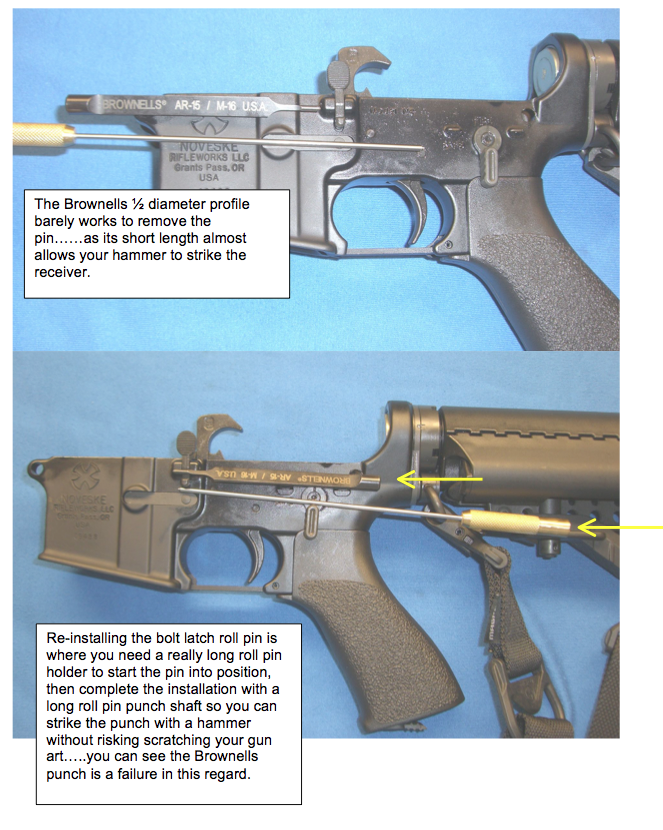

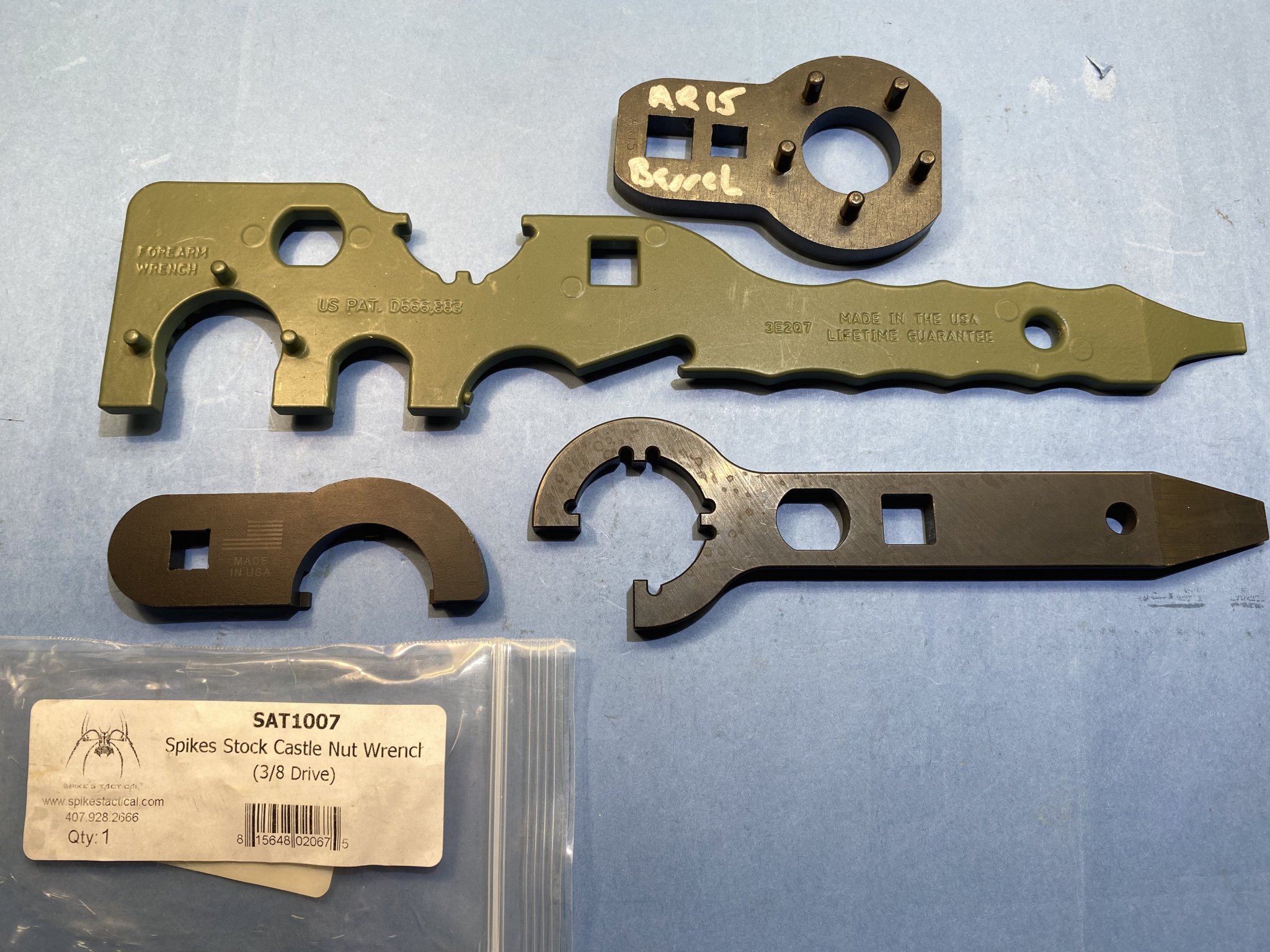

Not much needed. Upper and lower receiver blocks, roll pin punches...

Looking around I think its hard to beat brownells offerings for roll pin punches. Pin punches, probably go with Mayhew.
Magpul Armorers wrench gets good reviews.

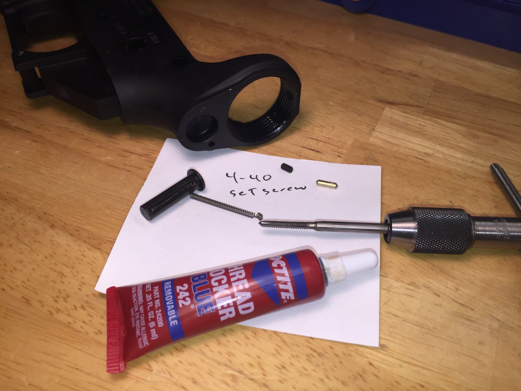

Two tools to eventually add to your arsenal, I found the first awesome for AR's, the 2nd is useful for working all kinds of gun-related and other tasks around the house:
* Tapco AR15 Armorer's wrench (my fave general purpose armorer's wrench)
* Torque wrench in the 10 - 75 inch-pound range (this is almost the perfect range and will handle 99% of optics mounting and firearms related torque tasks). I really like my Lyman Pro drive 10-80 inch-lb torque wrench. I realized the other day it was made in China, I've been trying to avoid buying any Chinese-made products but in this case I actually thought it was US-made and didn't realize until later. Anyway it's still a great wrench. If you can find a US or US-ally made equivalent, even better. Brownells carries a Seekonk that is 10-75 inch-lb that is extremely high accuracy and US-made, but wow $200 for a wrench!

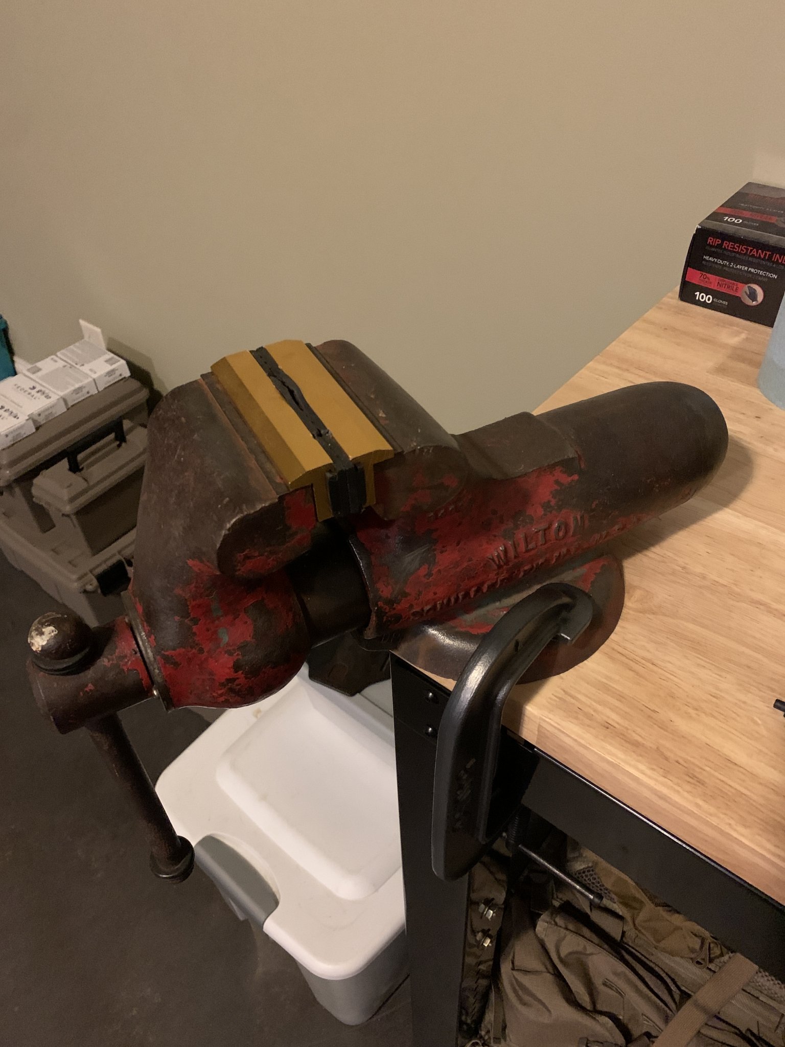

So many good old wiltons on Craig’s list. It’s worth it. I bought a 1943 for 150 bucks. Took some time to restore it. Worth every penny.

4” or 6” jaw. This is a 4 I bought recently I’m going to restore.

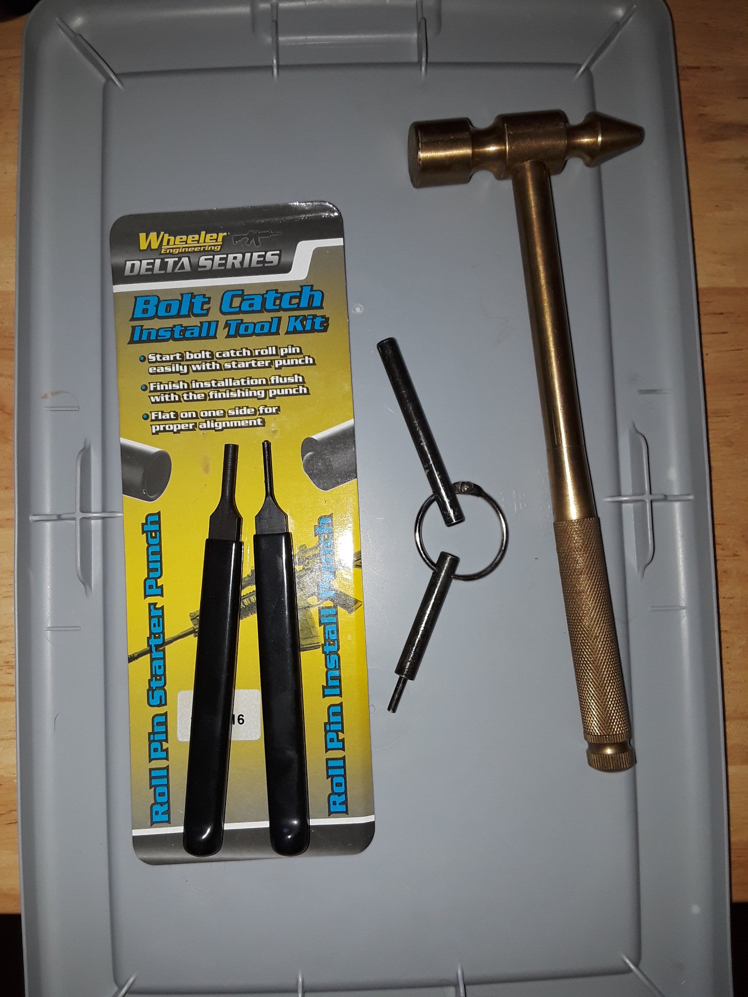

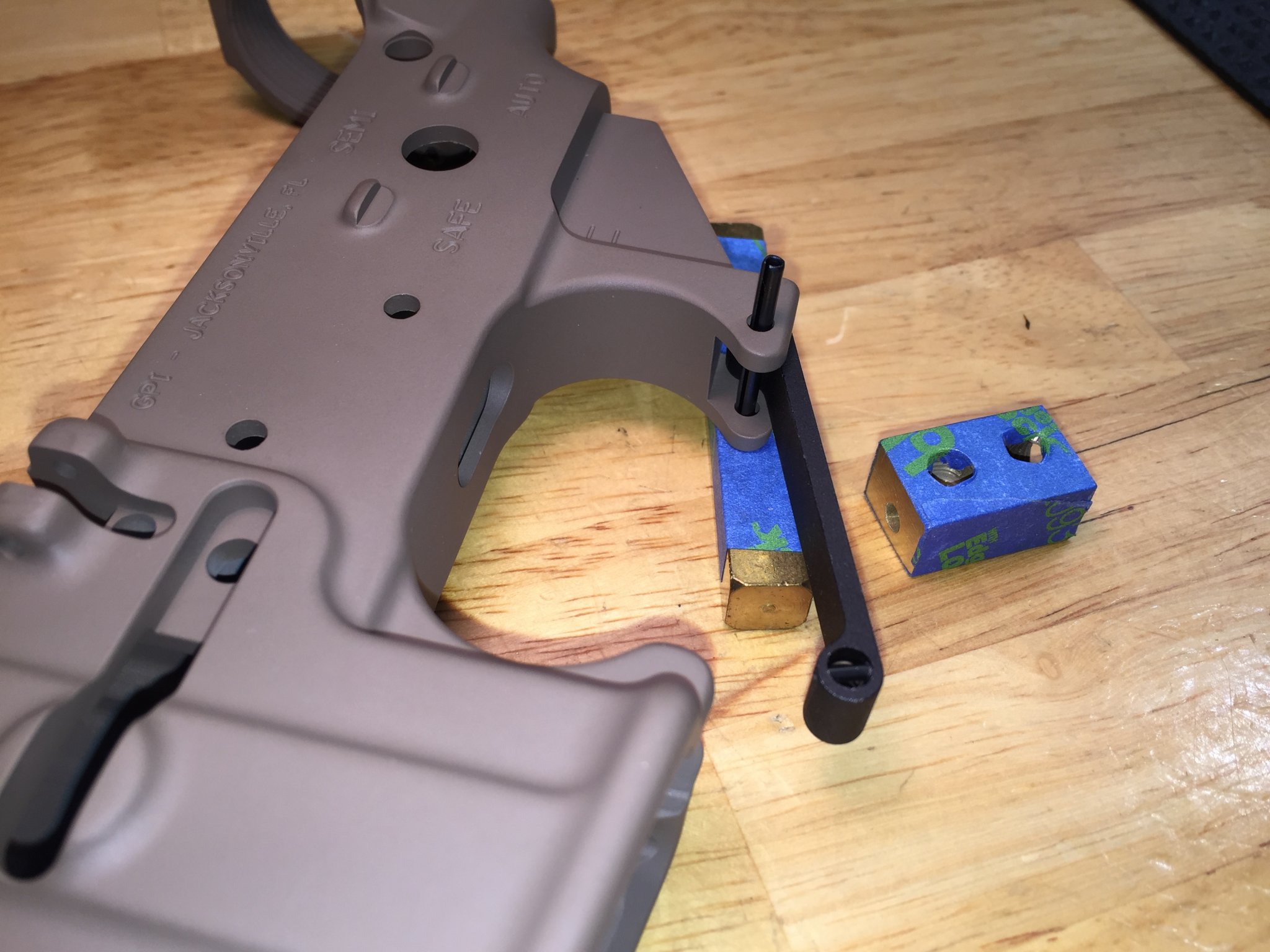

Just yesterday showed my son how to make a good tool from a zip tie.
Drill a hole nice and strait through a zip tie to match your roll pins.
Start the roll pin in the zip tie and have it protrude slightly.
Easy to start roll pins with till you figure out where the damn roll pin starter set went.

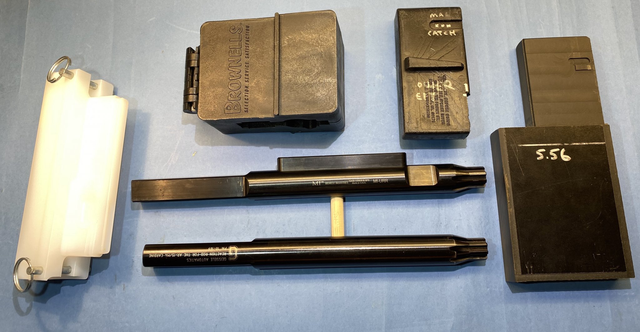

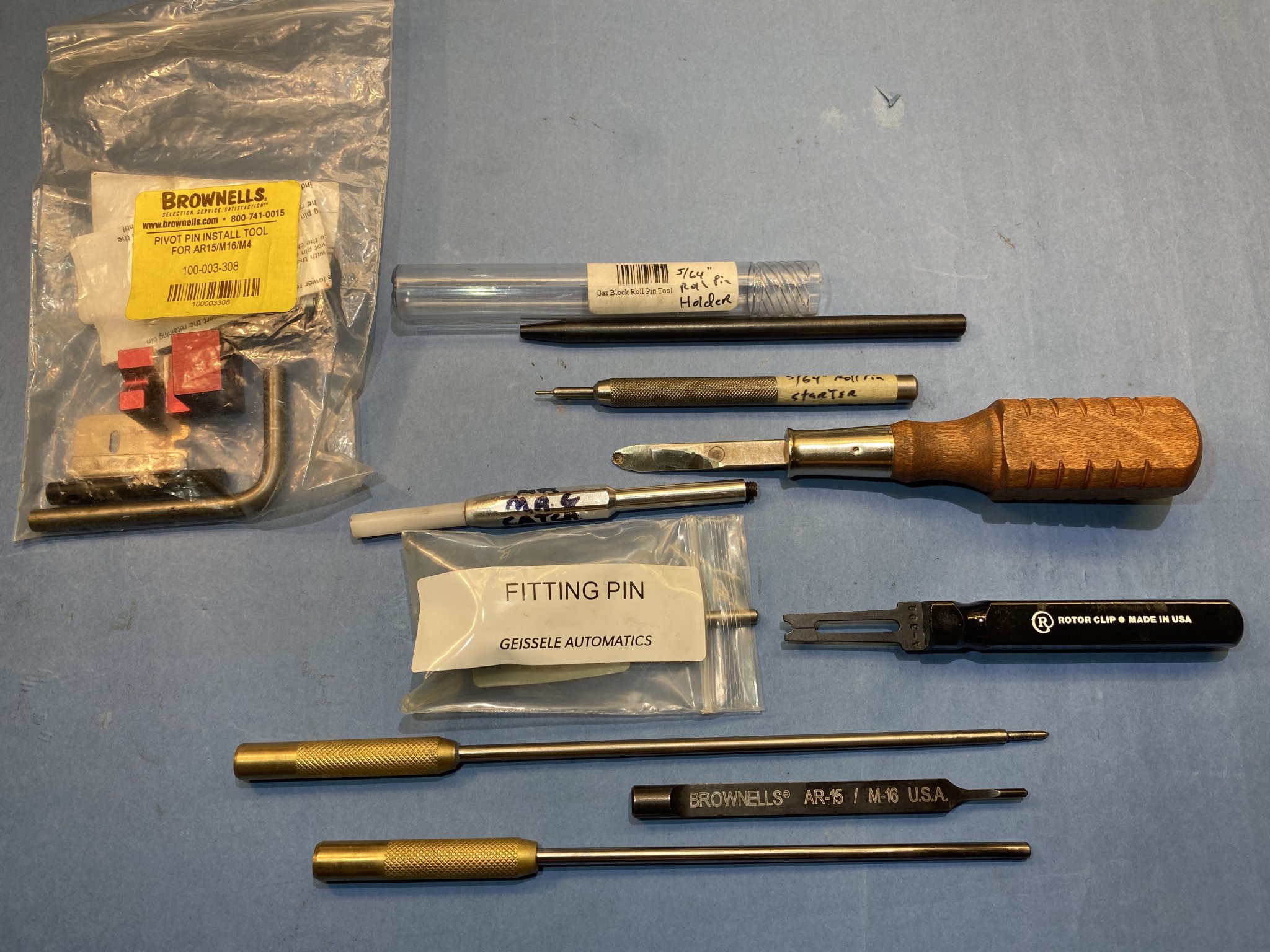

A set of pin punches
A set of roll pin punches
Roll pin starter set (magnetic)

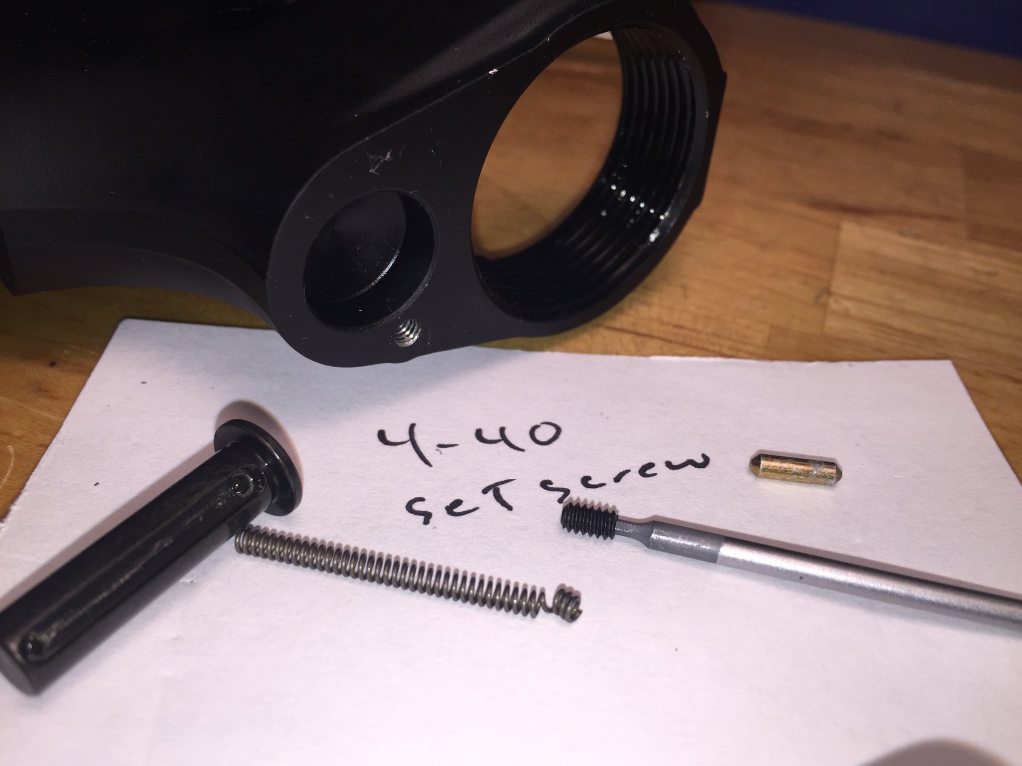

The detent tool for the take down pin, trust me.
The flat sided set of punches for the bolt catch.
Wheeler fat wrench (screw driver) to torque scope screws etc.
Armorers wrench
Torque wrench
Upper clamshell holding block
Lower holding block
Slave pin to hold trigger springs / trigger
Ani seize
Locktite
Rocksett
A decent working vice
A set of magnetic soft vice jaws
Small hammer
That is about all I use
There are some upgrades
Scope ring lapping
Reciever lapping.

Armorers wrench
Lower holding block
Small hammer

There are magnetic roll pin starters?

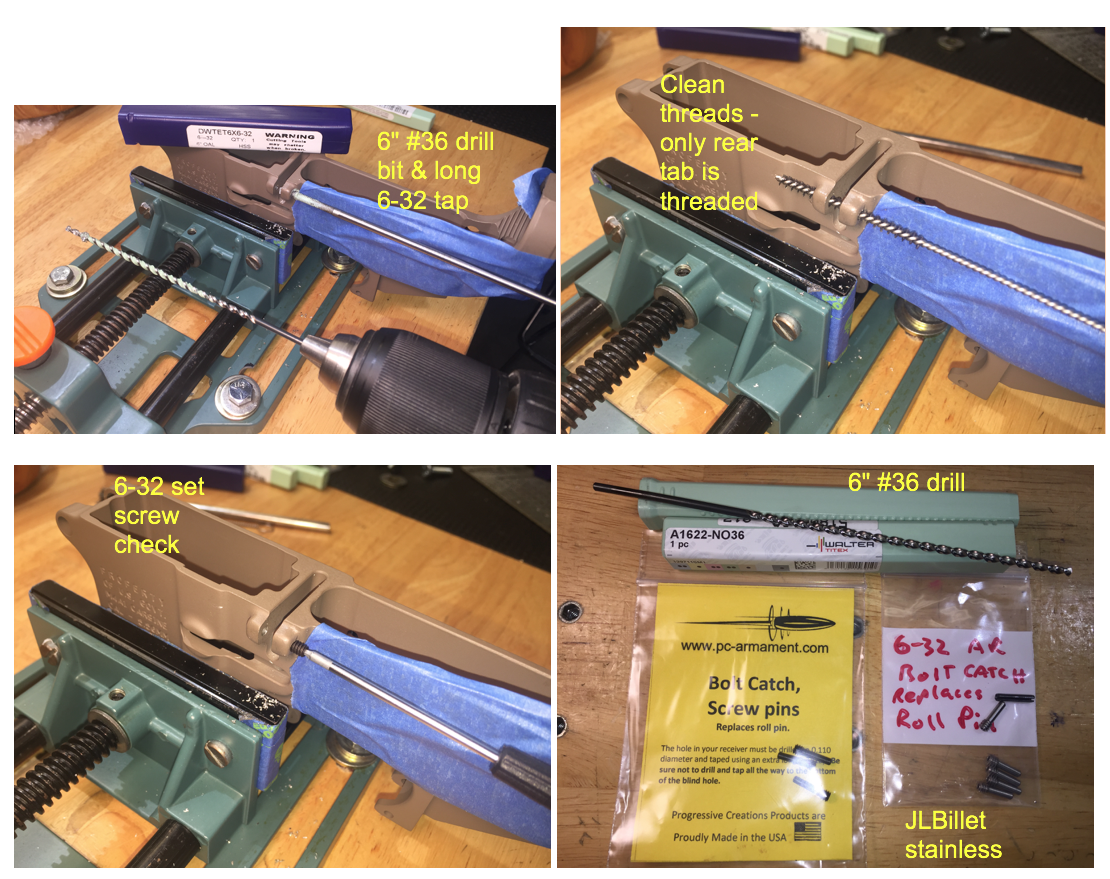

My small hammer, a set of wheeler flat sided punches for that pesky bolt catch pin.
On the ring is the wheeler pivot pin detent tool.
Definitely worth the money unless you have machine shop to make your own.
Here is another tool my son made with a hacksaw and super glue.
1/4 inch by 8/32 stand offs cut and glued into cheap bit holder.
A reaction rod (Geissele or MidWest Industries which is better) and some vise block upper / lower stabilizers and after a while you will fabricate some simple tools to make some of the critical tasks easier. Consider replacing the bolt release roll pin with a set screw as many mfg.'s are now doing; roll pins need to be long much longer than Brownells offering for this task. Simple hardware store brass or delrin "bench blocks"to prevent trigger guard roll pin installation from screwing up the lower when the "ear" breaks off before your eyes. A variety of receiver extension castle nut wrenches. E/C-clip tool for bolt cover installations. Consider the easy conversion of take down pin spring retention with a 4-40 set screw so it does not go missing upon disassembly.
